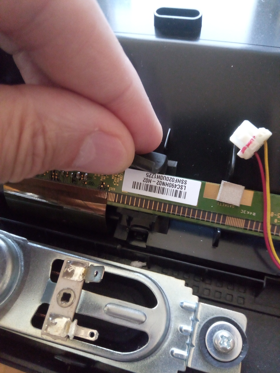

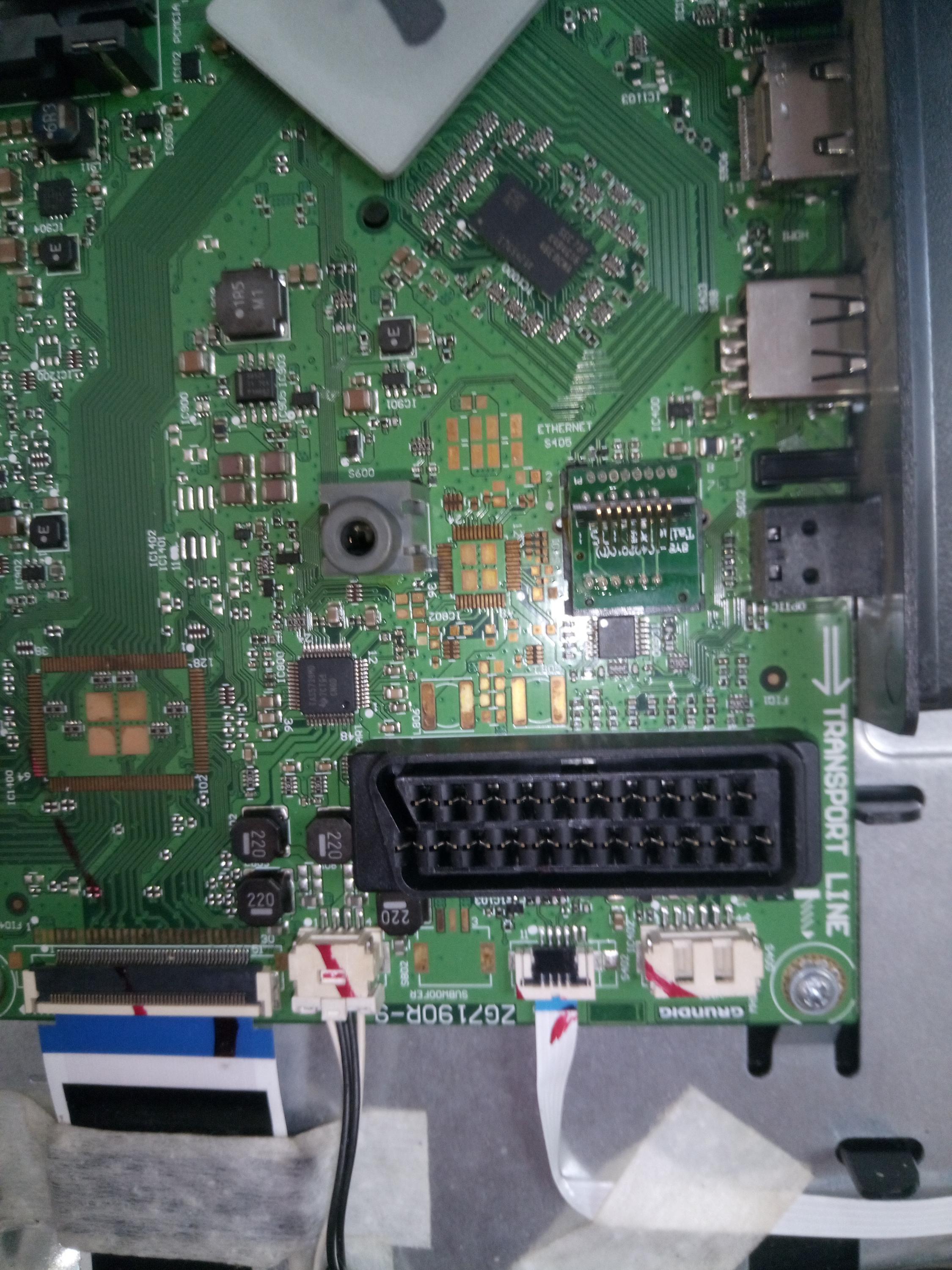

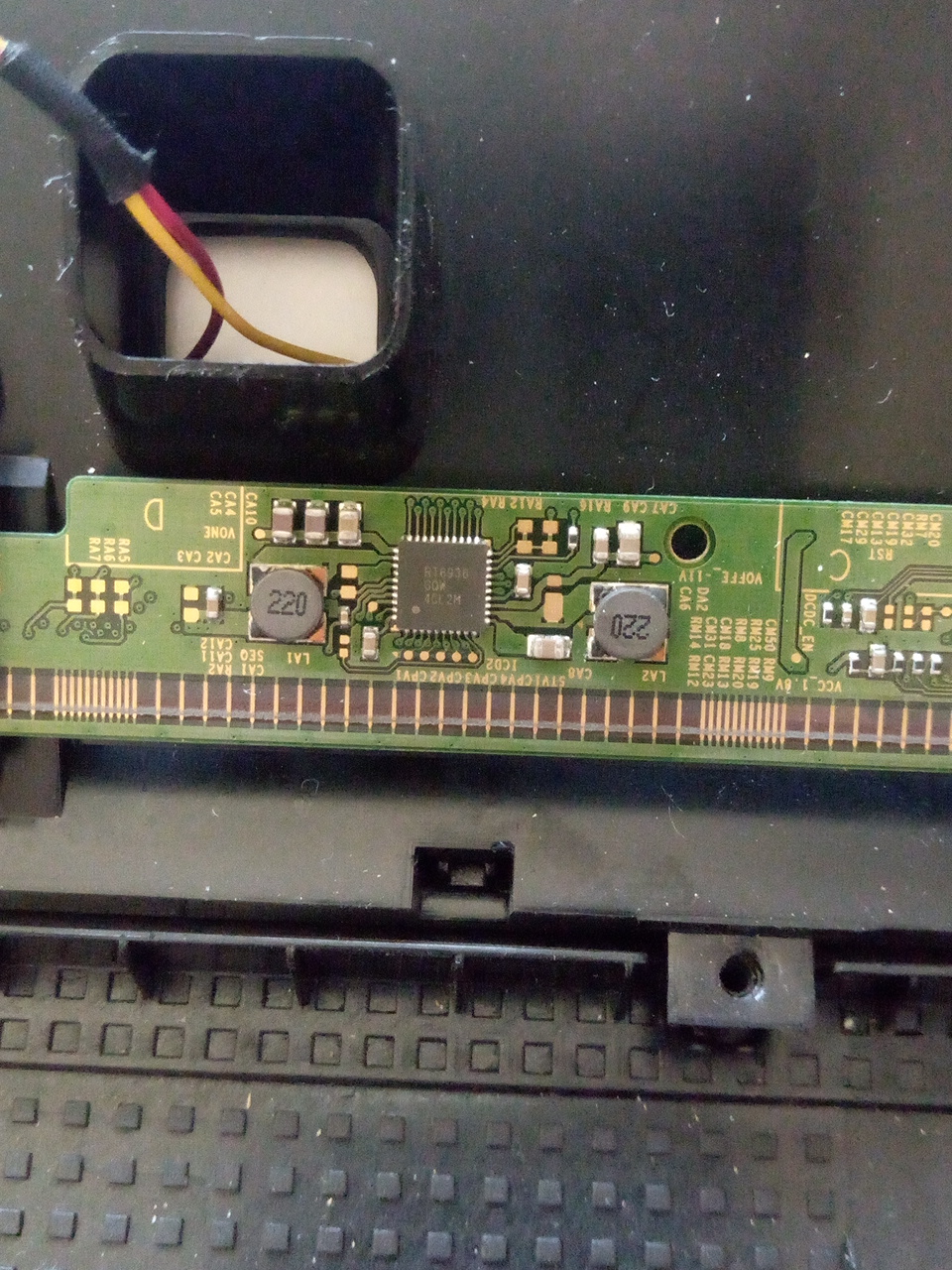

              I disassembled tv today, remove both plates and the tin cover to get to the t-con.
              Two capacitors, marked 220, have resistance 1ohm or less so they are now suspected as bad.
              It is strange to me that both are bad because it looks like they are not in paralel, but I don`t have scheme for it.
              Any idea?

                Re: Grundig 49 VLE 420 BN - no picture
                remove one and check it out of circuit, might only be one bad, you can recheck the other in circuit to see if it still checks bad, can check the pads it came off of also to see if still reads bad.
                  Any idea?
                  With the marking "220" this is your choke (inductor) and they should be short.

                    ok, wasn't paying attention, thought he was on caps.
                      Those are coils.

                        Ok,
                        then I am back on motherboard, I can`t find another one for now.

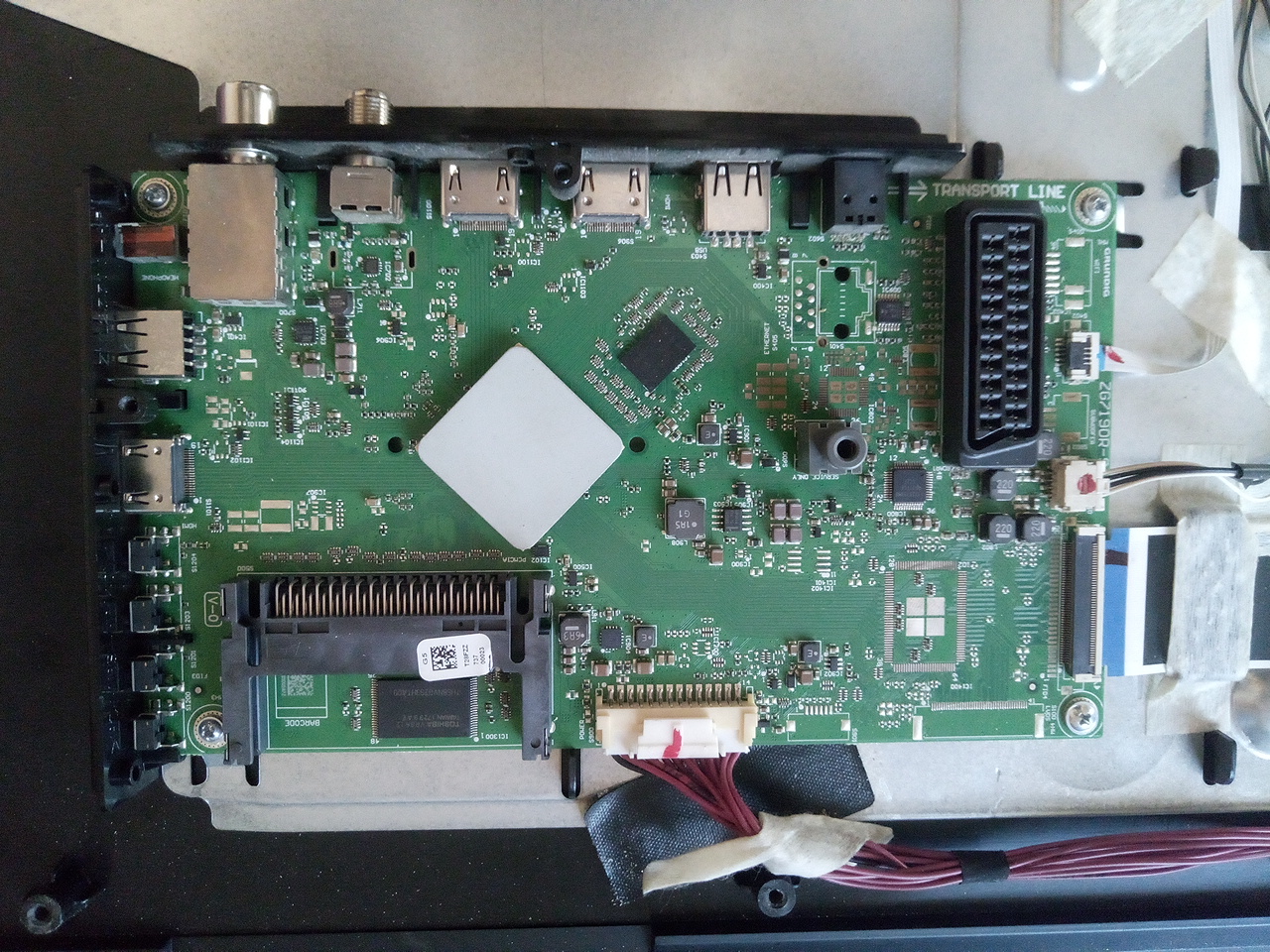

                          I measured voltages on the panel board, there are different voltages, from 0 to 12 V.
                          On the chip RT6936 there are 11,8V, 3,11V but no 8,2V on the top, but on those pins I don`t see any connections to any elements on the board.
                          When tv is turned on backlight turn on with no picture on the screen, but tv turn off for about 5 minutes, I suppose because there are no program on tv.
                          That mean that motherboard or part of it is working.
                          I will try to get used motherboard but I don't have it for now

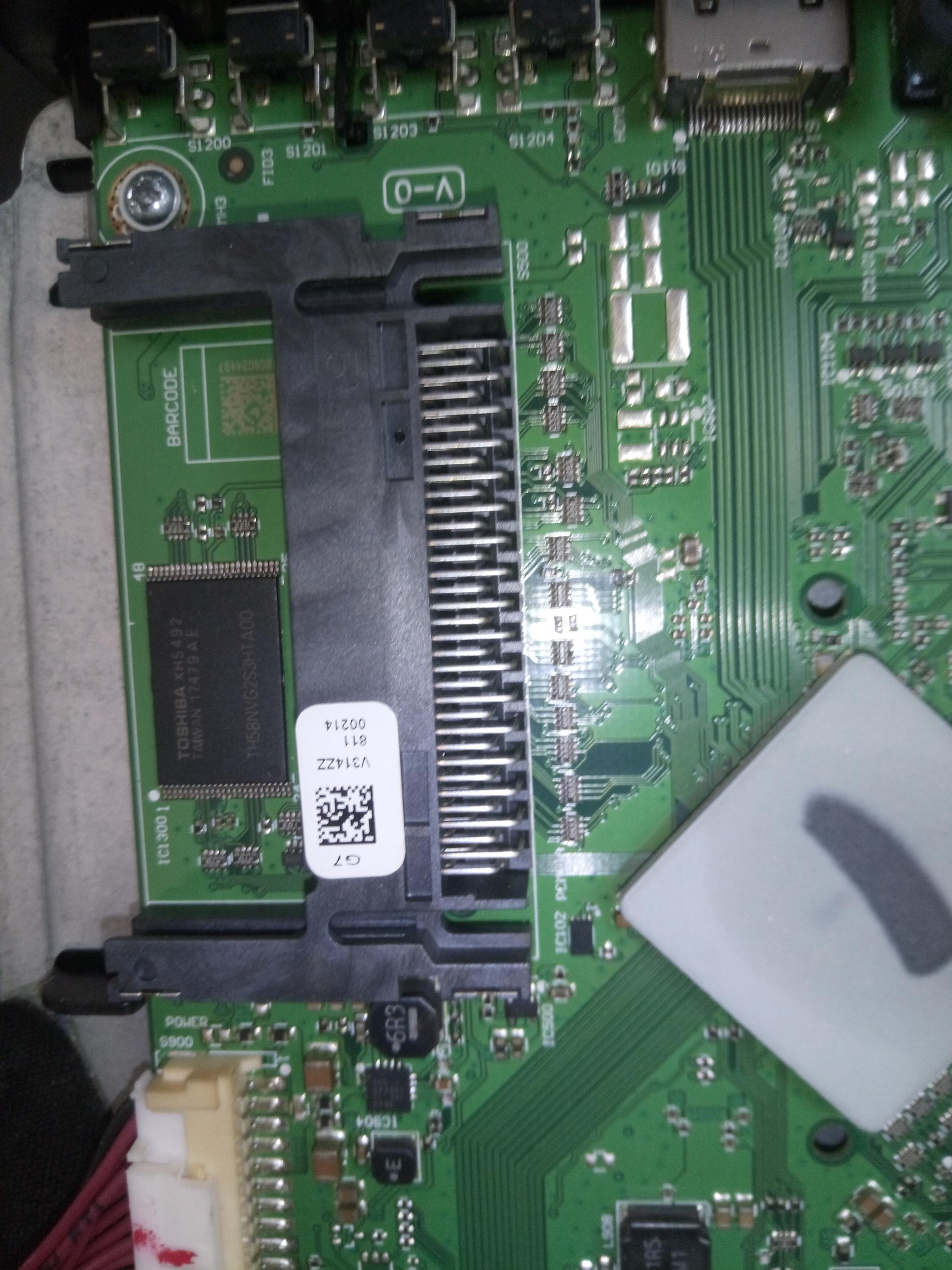

                              Sticker on CI slot on my motherboard have mark T28FZZ.
                              I would like to find in localy.
                              I tried to google it but no result.

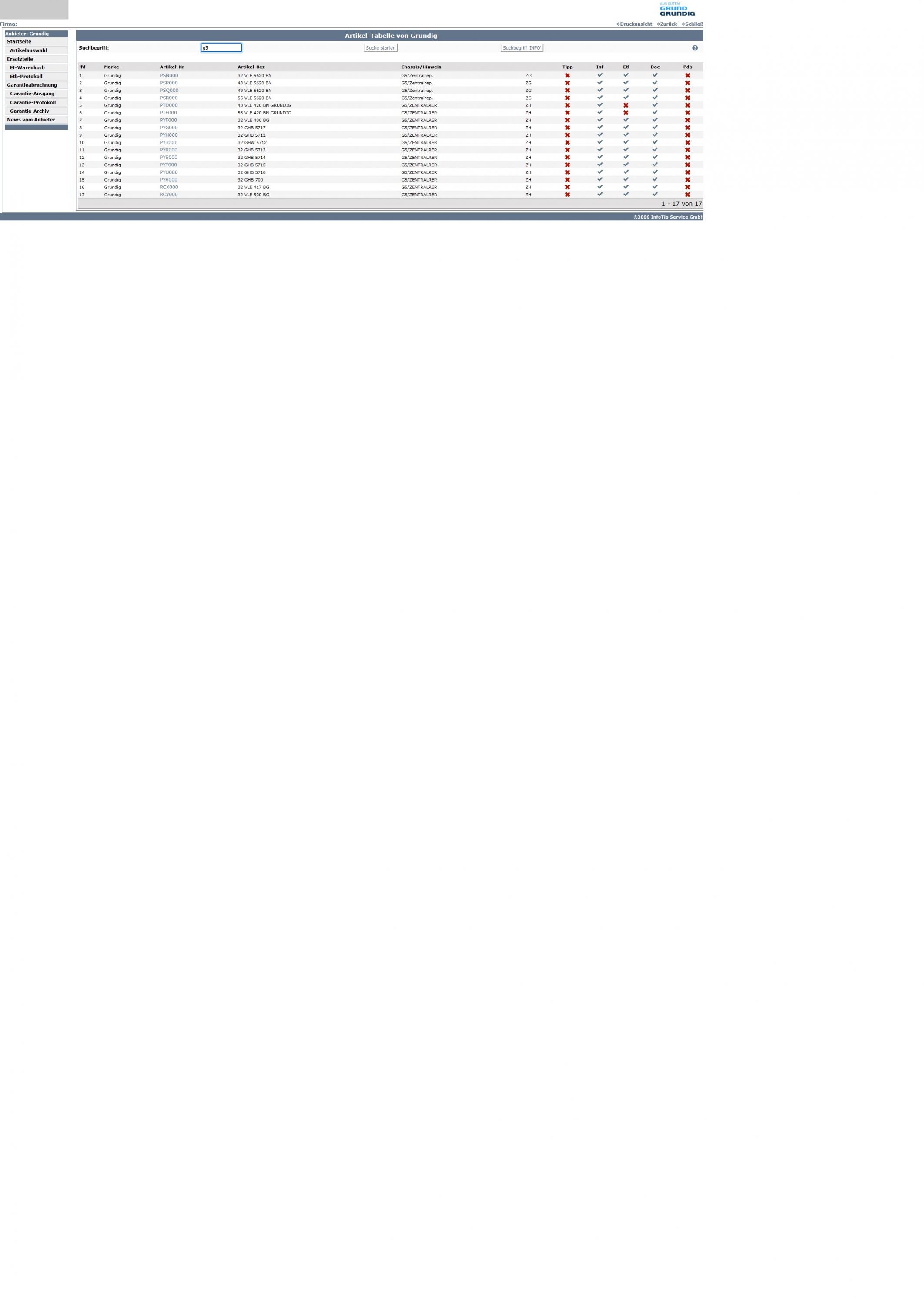

                                Look here.
                                  Is it possible to install any motherboard ZG7190R-9 and then install software for G5 chassis, regardeles of marking on CI slot sticker?
                                  • thommyX
                                    • Apr 2016
                                    • 96
                                    #37
                                    G5 and G7 have the same software, the same power supply and the same mainboard. Both devices are actually the same. Only the panel is important, that should be identical. I also have the individual panel data that can be used in the software. But I haven't done that myself yet. So if you can buy a cheap mainboard, I can send you all the data and you have to try it out.

                                          #40
                                          Today I installed new motherboard with same label like my, ZG7190R-9, but from smaller tv screen (my is 49" new is 43" and my chassis is G5 and this is from G7).
                                          The small sticker on the cCI slot has a different label.
                                          When I connect all and turn it on nothing hapened, same like before.
                                          When the TV turned on, I noticed a gray line of approx. 5-6 mm at the bottom of the screen, which I don't think was there before.
                                          That gray line disappears completely from left to right after approx. 10-15 seconds.
                                          Is it necessary to insert the panel file into the new motherboard and what is the procedure if necessary?
                                          My panel is LSC490HN02-H02.
