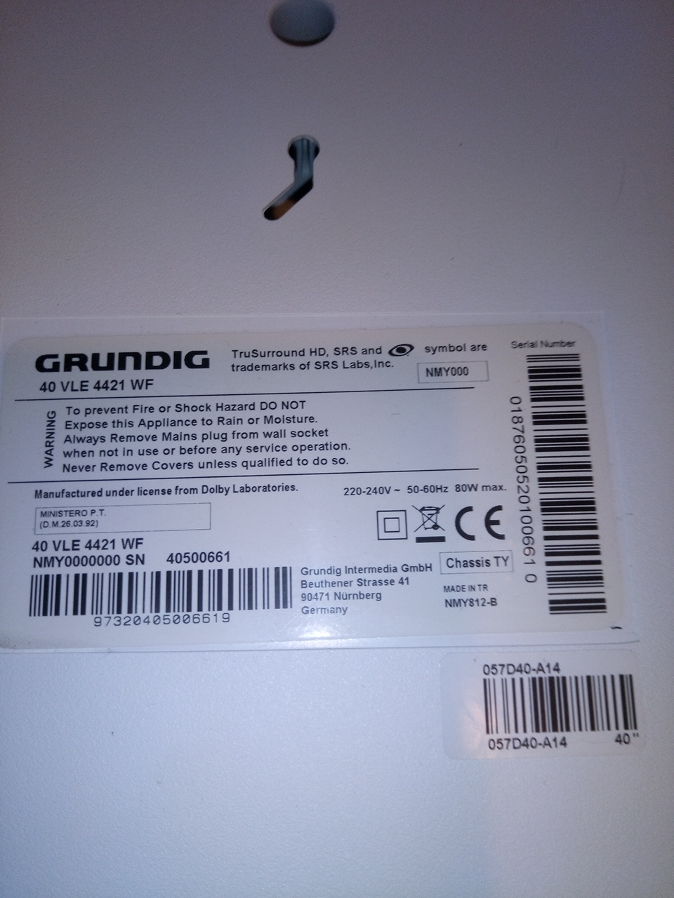

                  • betmen
                    • May 2019
                    • 90
                    • Croatia
                    Re: Grundig 40VLE4421 - no picture
                    Tv chassis sticker is in attachment.

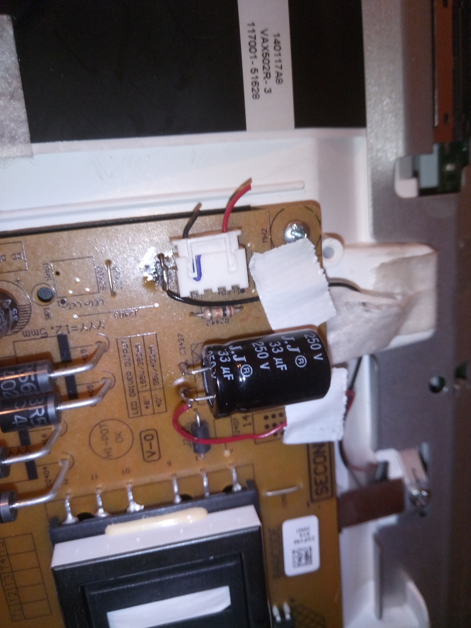

                    I think it is not bad solder joints because I soldered wires from connector directly to the elements on board which are connected to connector.

                      show us a picture of your work.
                        yours chassis share same firmware with TT/TY
                        try to downgrade to V5, to close out if firmware did clitch at panel section.

                        • betmen
                          • May 2019
                          • 90
                          • Croatia
                          Picture of soldered wires...
