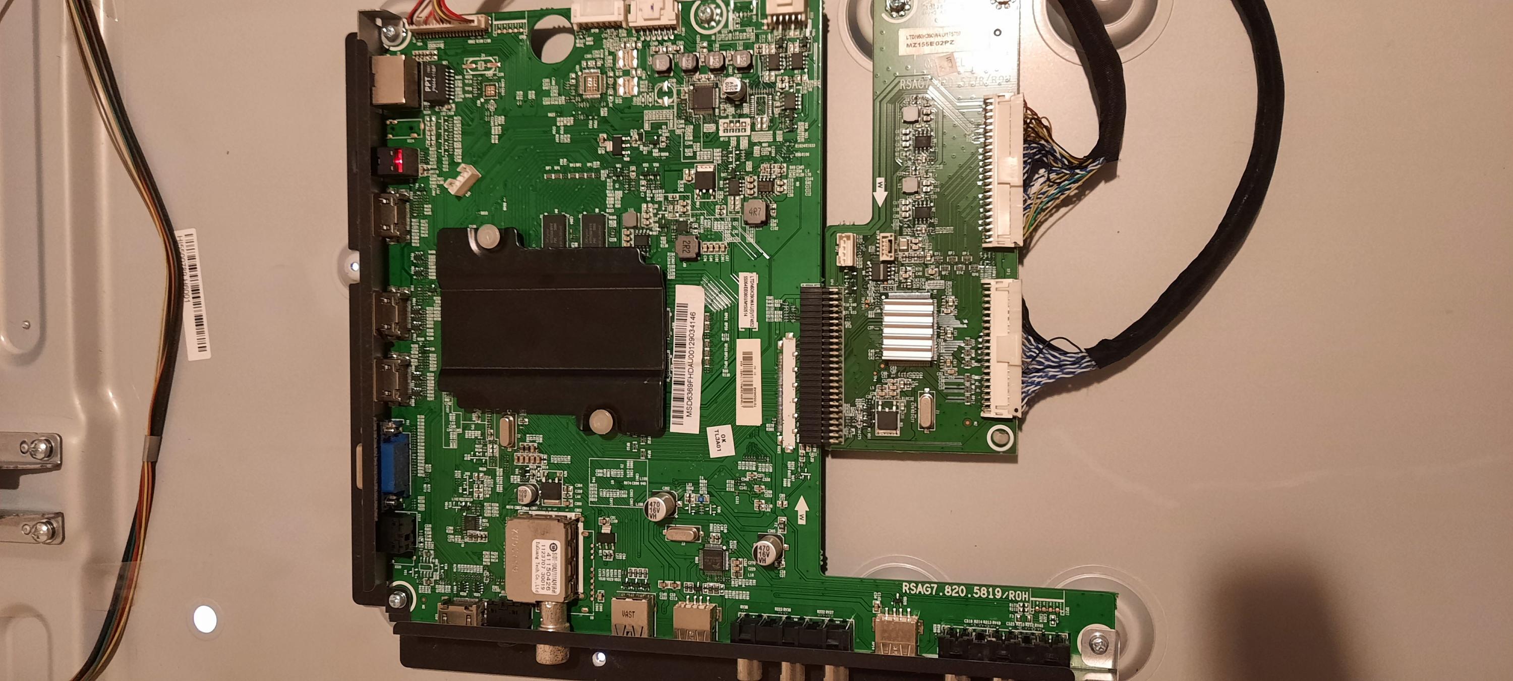

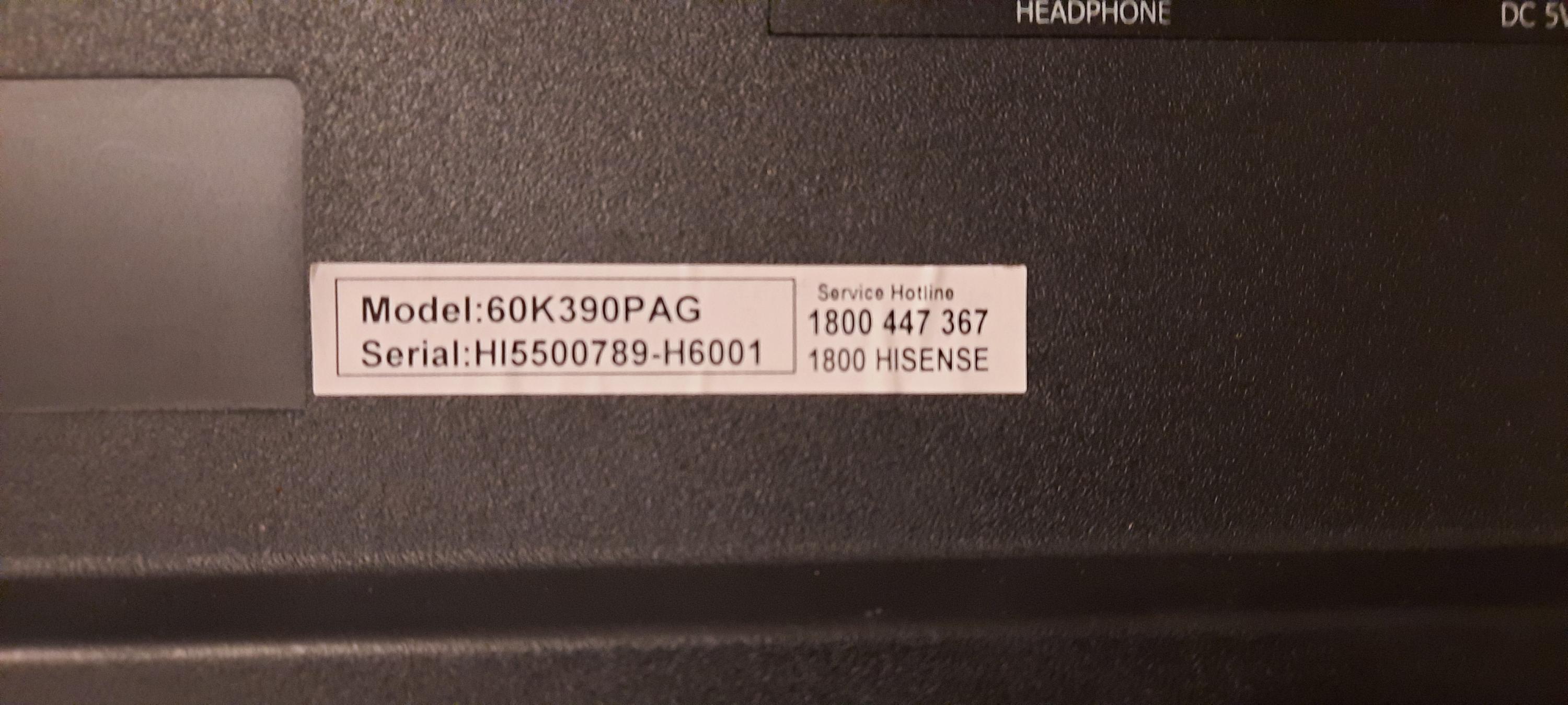

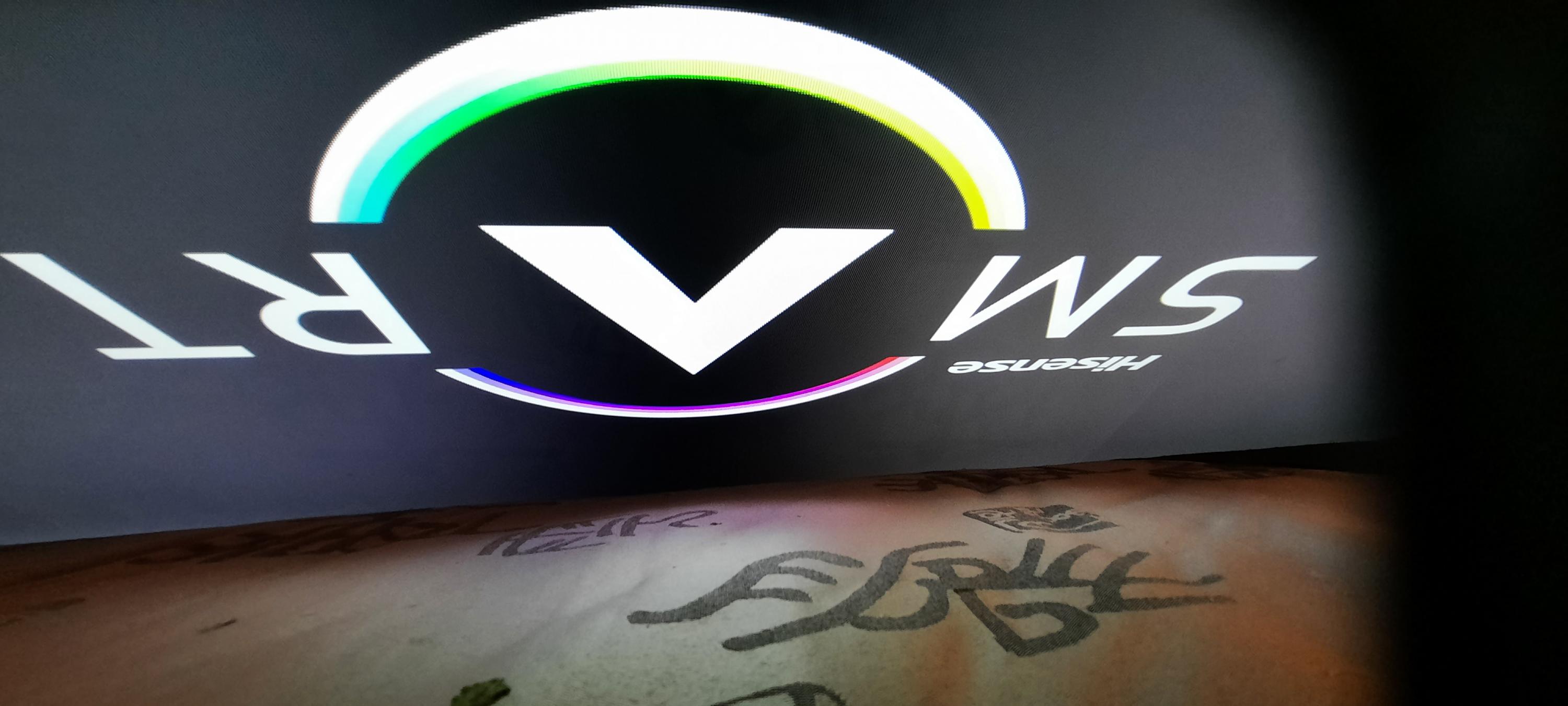

    Hi this is my first question here so hopefully I can stay out of the naughty corner. I have spent time looking on here for solutions and now will ask.
    The TV was given to me as it stopped working. It is almost certain there was a power surge around the time it stopped. When turned on it says Hisense powered by android. Then the screen goes black then displays the next image which the colours change a bit but never goes past that. I have tried all sorts of reset etc and believe it has corrupted firmware. I have contacted Hisense Australia and they say they have no firmware available for it.
    I was suspicious of one of the power supply caps so have just replaced all three with no change. All voltage regulators test in spec as per the post on here.
    I did find a post here with similar post and a firmware by usb fixed it. Just cant find any to try.
    Pics as per site rules.

    Re: Hisense 60K390PAG stuck on boot
    you might be on he right track, had that problem with a sony a while ago, storm borked the firmware, update/re-pair brought it back to life. If you do find it. be sure to save it in case it's needed again.
      I have spent hours looking for some firmware for this thing with no luck. I have seen the board for sale in sizes from 50, 55 and 60 inch. I would be even keen to try and see it will start an update with any firmware as if it does not do that I may as well take it to the dump. Any links to something I could try as a test?
            Maybe one has a firmware dump file. Then all you need is a flash programmer
                            i have just watched a video on youtube the area by the hdmi ports etc is there a reset button point? you may have too use a pin etc to press it for about 20 seconds with tv switched on

                                • binoyroy
                                  • Sep 2017
                                  • 51
                                  • bangladeah
                                  Here is firamware link check
                                  https://www.kazmielecom.com/rsag7-820-5819-firmware/

                                    • tricky74
                                      • Jun 2022
                                      • 12
                                      I believe the reset button is on the ROKU tv and not the android ones.
                                      I have tried the link provided and cannot work out how to make it work. All it wants to do is install adblockers and other bcrap. I watched the video on how to do it but it does not really work the same foe me. Seems dodgy.
