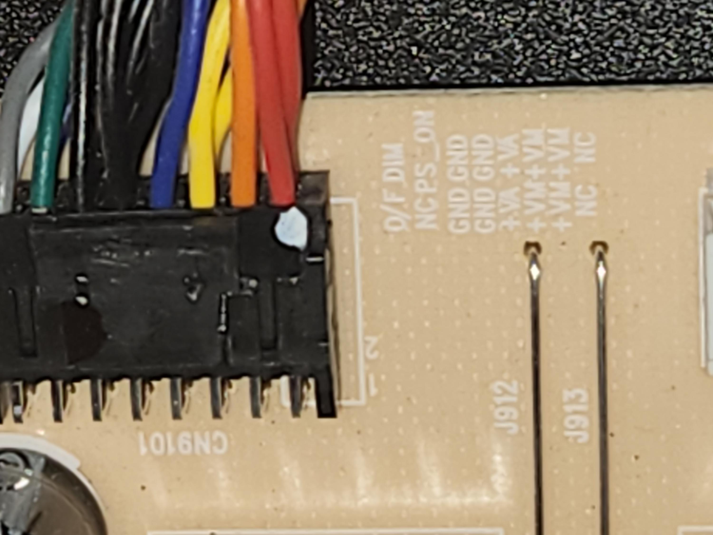

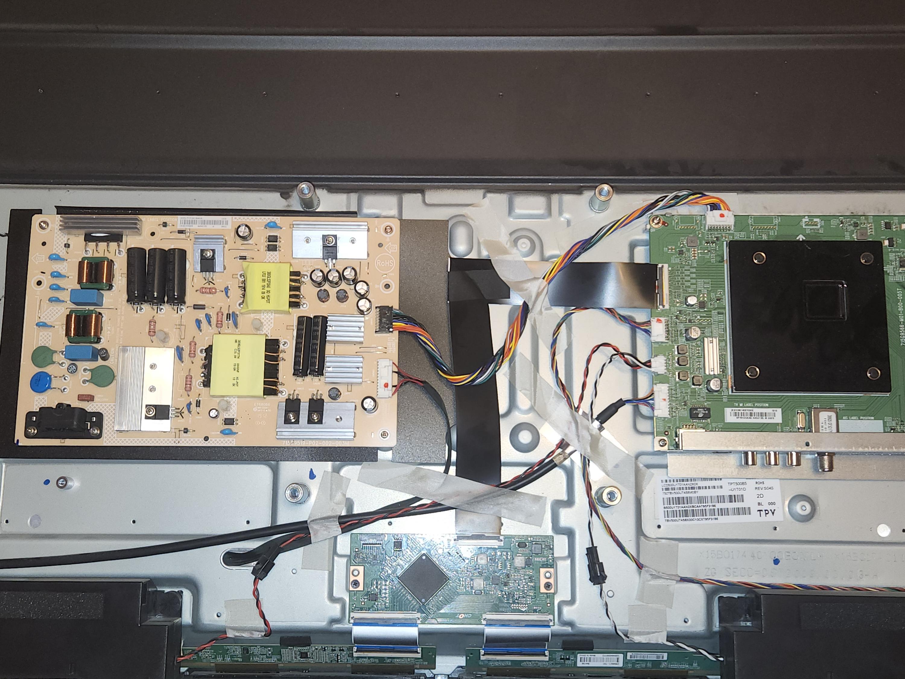

    Hoping for some help as i am perplexed by this one. Backlight comes on fine, unit is responsive to remote, and all indications are good. VM and VA rails coming from power supply are around 16 V. Green LED on the TCON comes on.

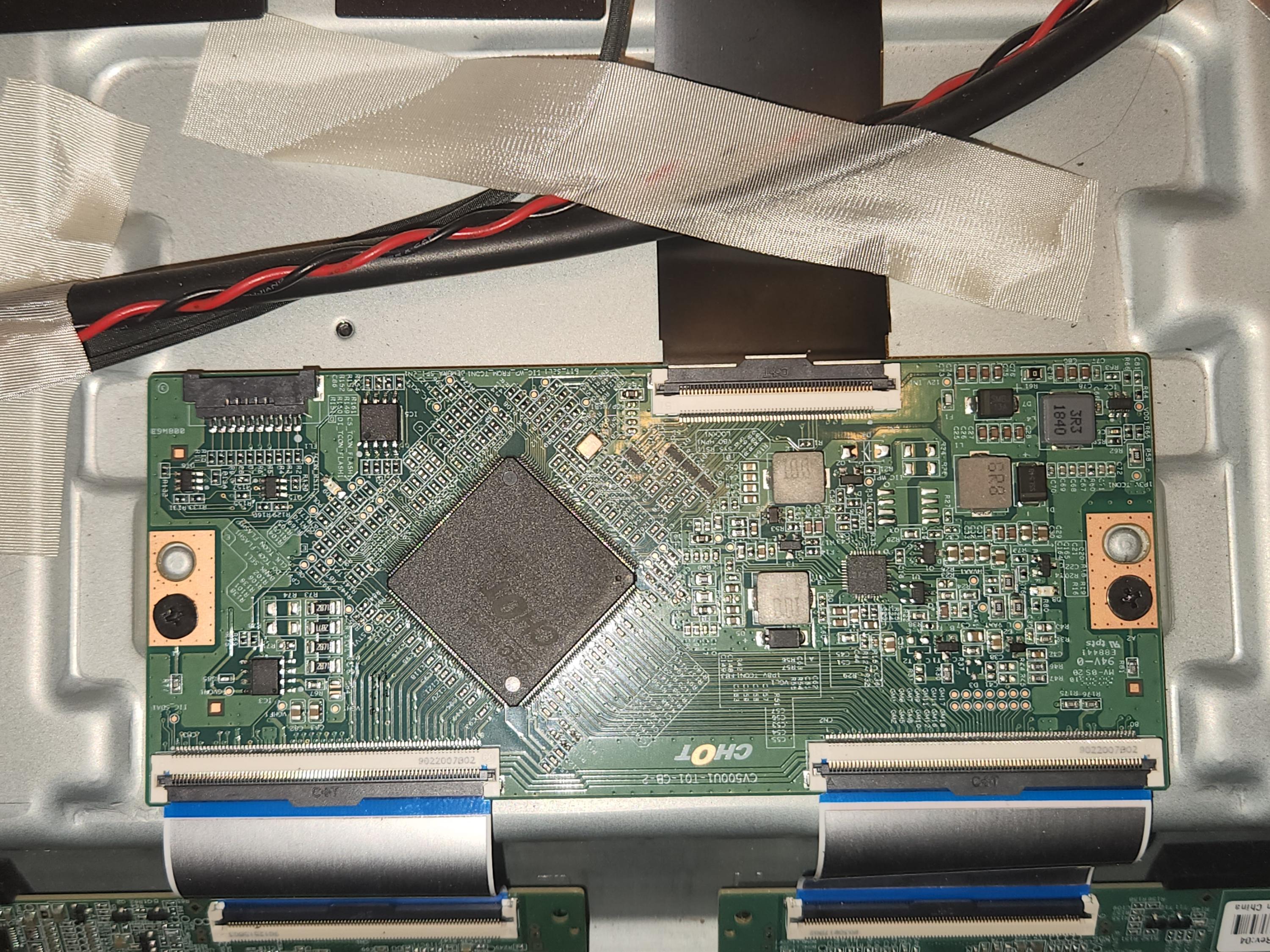

    2 ribbon cables from TCON 2 panel act normally i think. Disconecting the left one results in right hand side of the screen white. Disconnecting the right ribbon, has no effect (full dark screen)
    So.. thought it's TCON...got one but TV acts the same (just backlight and no picture.) So i got a main board, and the TV still acts the same. What the heck. Could be bad panel? Visual inspection shows nothing burnt or odd.
    Any thoughts? Tried disconnecting the wifi / bluetooth module. No effect. Help!

    Those two ribbons on the tcon go to another board each. My bet is the board on the side that stays black.

          Only because it looks good, it doesn't mean it is good. It doesn't have the right symptoms for bad tab bonds. But symptoms also do fit for those little small boards to be the problem. There should be test points called like VGL etc check them and compare them.
          Also only on the assumption to swap a new board in, also doesn't mean you got a working board. That has been proven here many times.
          Nomoresonys mentioned the tape cutoff method. That would be my last resort. Get some help if you do this, to make sure to cut off the right one.
          For starters, I'd put a TV show or something on one of the inputs and probe the LVDS with an oscilloscope. If you see small changes as the picture changes, the main board is good. Then your off to the tcon checking for voltages, panel Power etc.

              With panel boards, shorted chip caps will be a likely suspect if a new tcon didn't fix it. There is a youtube video of a guy isolating the short with a milliohmmeter. https://www.badcaps.net/forum/showthread.php?t=105788
              Tape cutoff typically works if you can get one side to show a good screen since you are blocking signals to the bad side with the good side compensating.
