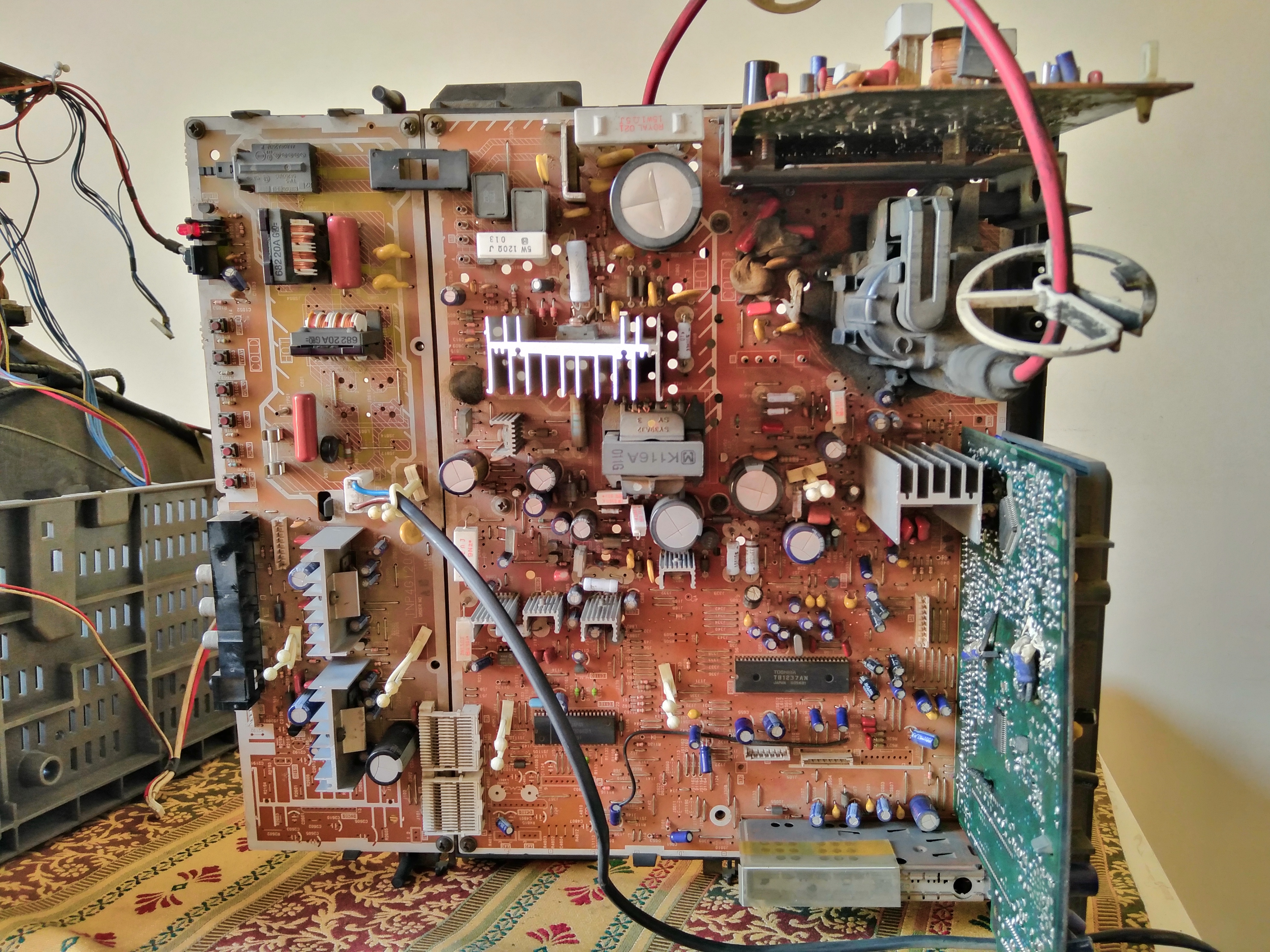

    The Problem :
    TV is flickering and colours are not aligned (convergence issue ? ), not all input channels (composite/RCA) act the same and the Component Input acts differently I think. The video will speak a thousand words I'm sure.

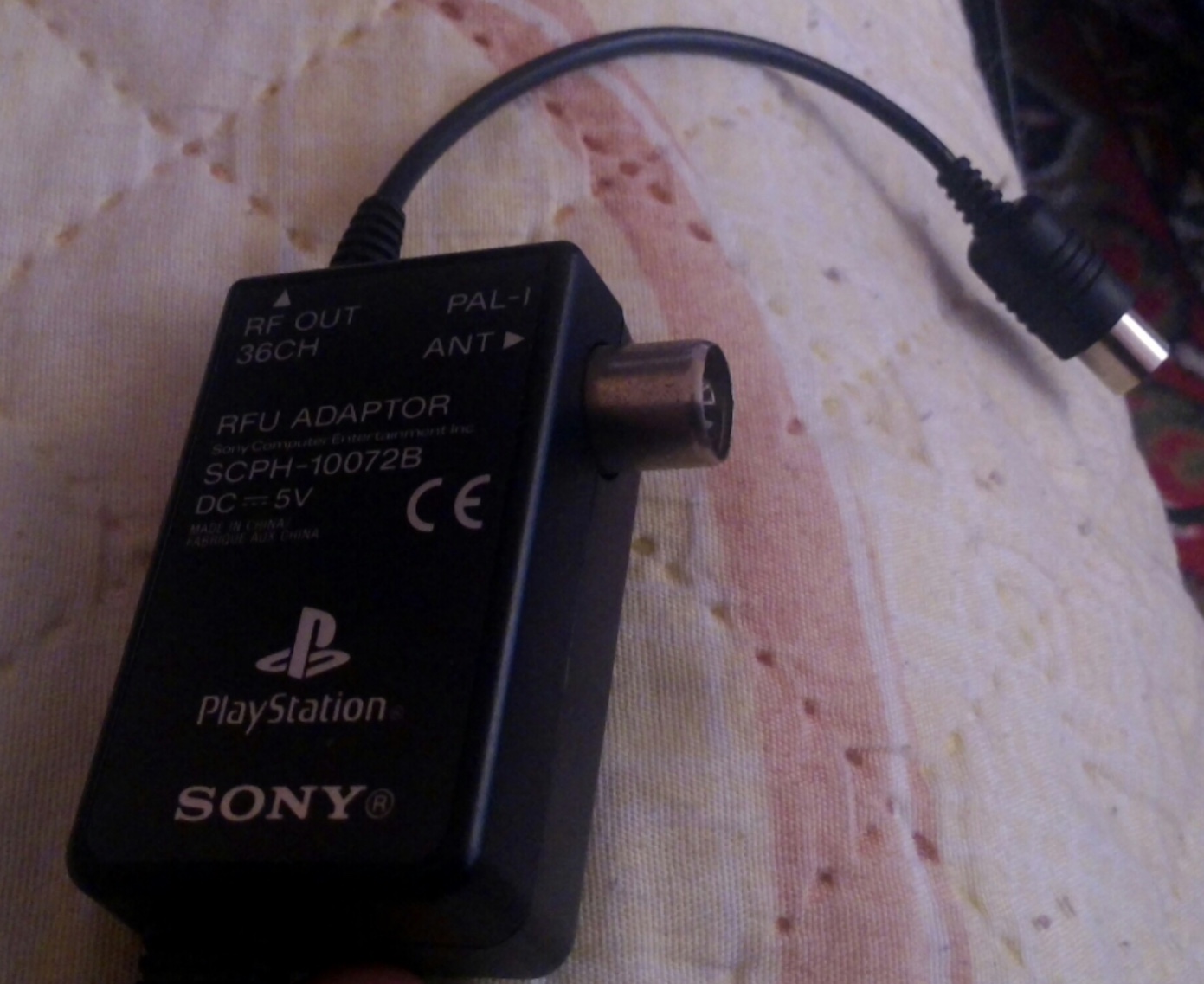

            Re: [REPAIR] Help in diagnosing my Old Panasonic Quintrix F TC-21P50R CRT TV
            Does the PS have an rf module included ?
                Sadly no

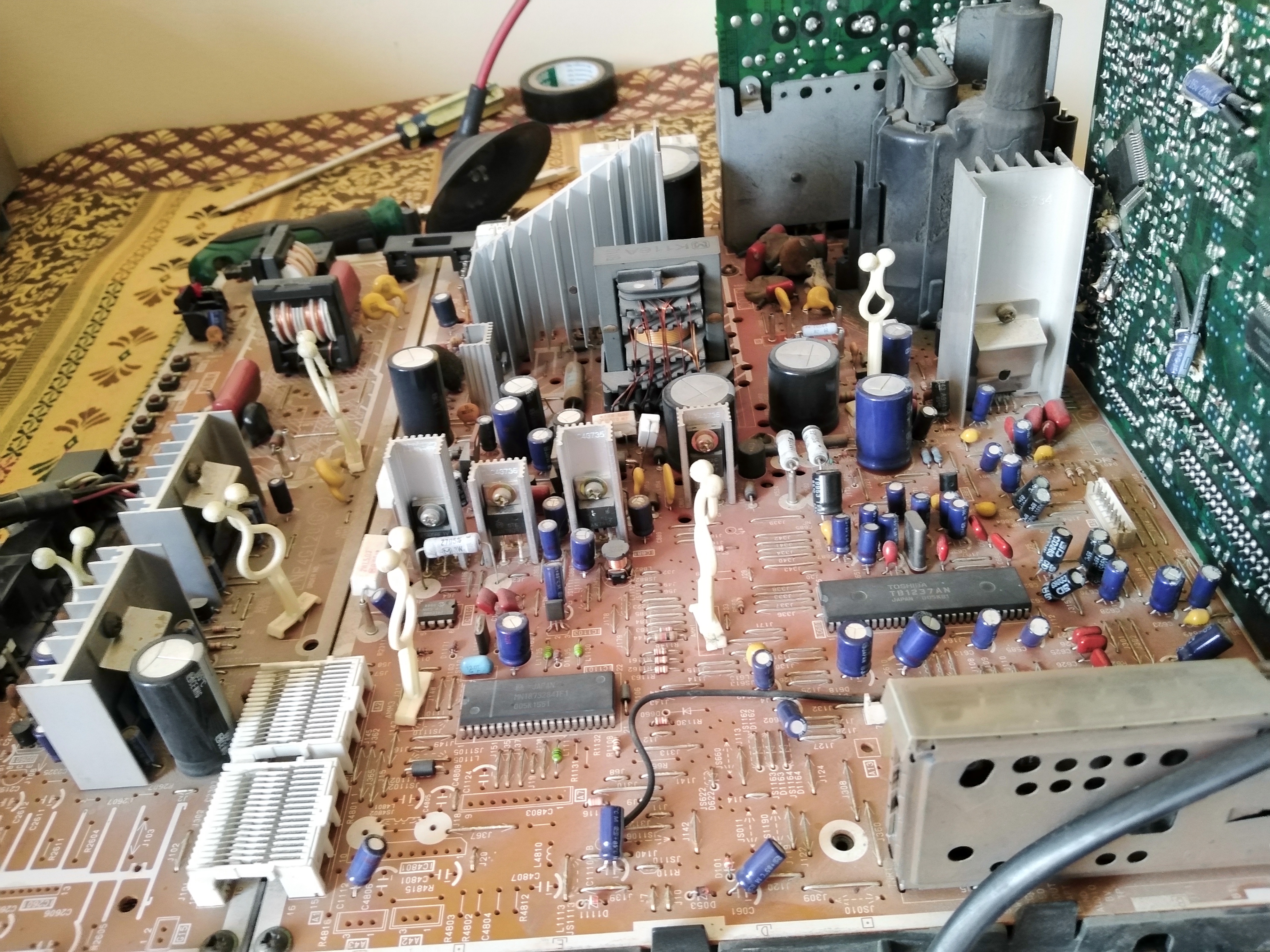

                                Hello , my apologies for the late response. I've uploaded a couple of photos for the Chassis PCB as per your request.
                                Also I've opened up the TV and took out the Chassis ( Main PCB ) and measured voltage rails and they are very low. Secondary all are very low and the main offline regulator IC I've measured it's Vin Supply and it's supposed to be 16V but its 12-13V and it's fluctuating. Please let me know if you have any ideas I'm at a road block
                                Note: Since I have the service manual, I've used the schematics as a guide but I spent an entire day pulling out suspected components and measuring them ( caps and diodes ) but nothing was out of the ordinary.... please help .....

                                  • Jun 2012
                                  • 9623
                                  Start by replacing C811 47µf/50v, it is likey weak, I would also replace C826 47µf/160v as a precaution.
                                    thanks for the suggestion, I replaced those and alot more at critical areas. Still the same .
                                    BR
                                    • sultanpepper
                                      • Jul 2017
                                      • 13
                                      • Egypt
                                      I borrowed an old VCR and connected it to the RF input and the screen is showing same distorted picture .... any clue what that might mean when all inputs give bad screen ?
                                      Also I've discovered that by hooking up the chassis board back to the crt the voltages readings were good; mainly voltages at the flyback IC were fine and at the secondary windings the voltage regulators outputs were fine as well.
                                      I changed the vertical IC just for kicks but it did nothing .Also I tried recapping around the voltage regulators and the vertical IC .
                                      BR
