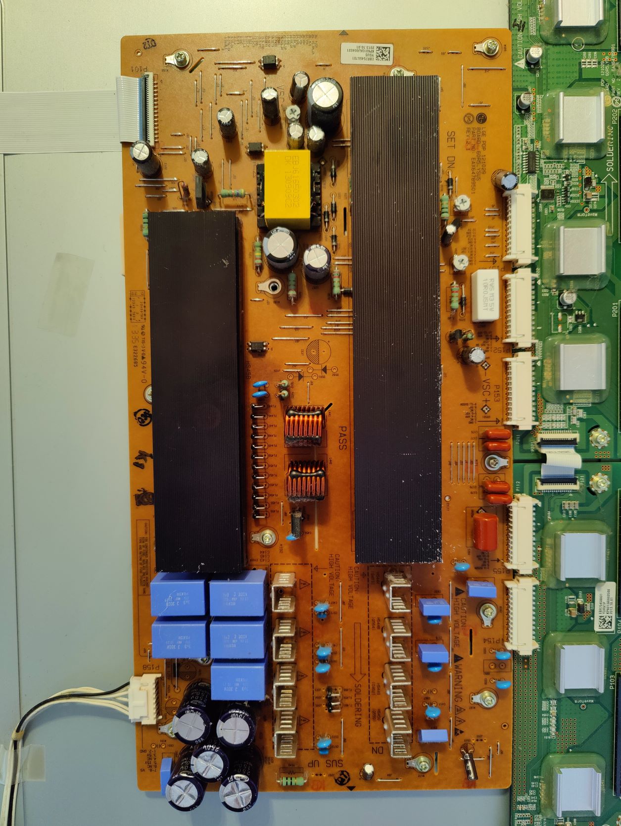

    TV Plasma LG 60PN5000 ZSUS 15v missing
    All Voltages are OK except ZSUS 15v.
    YSUS board disconnected still 15v missing.
    ZSUS was replaced: 15v missing.
    Any help will be appreciated
  • Biruslapio
    • Nov 2013
    • 552
    • Brasil
    Re: TV Plasma LG 60PN5000 ZSUS 15v missing
    15V is produced by Y-SUS, so follow the traces on that 15V pin and see where it leads.
      I will check the Y-SUS
      • alfredomfr1
        • Oct 2014
        • 318
        • usa
        3ohm R251 Open, Replaced.
        Now I have 15v but fluctuating to 16v and 15v and a metallic sound like tin, tin tin. All other voltages fluctuating a little bit but in range.
            Further inspection on y-sus is required, test every IGBT and gate drivers for shorts, big resistors (those green ones) cannot be open.
              D603 shorted
              After replace D603 TV works well but instead of measuring 15v it measures 17.8v
                If memory serves correct the 15V on LG plasmas is almost always close to 17V, so 17.8 is a small offset from the norm, no need to worry if nothing is overheating and the picture is fine. Is D603 at Y-SUS?
