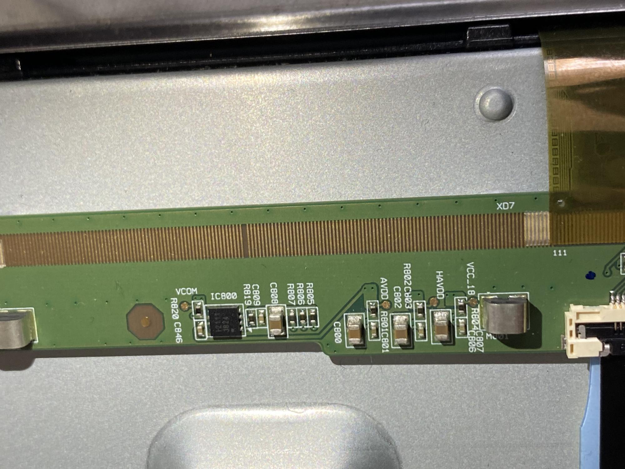

        Hi! How could you make it work? I’ve got a TV with the following issue:
        If I remove left cable, I can measure VCC, VDD etc voltages on the right LCD board. If I disconnect right cable, and only left cable is connected, I can not measure any voltage on the left cable.
        More interesting, I tried the “tape fix”. I covered CK lines One by One and all together too, but No changes. Do you have any tip for furthet fixes?

          Additional info:
          If I disconnect the left ribbon I can measure VCC, VDD on the right side, but IC800 is getting very hot. It's an i-2111 J824 IC. What it does? Has anybody info about it?

            Re: LG55UK6950PLB backlight but no picture
            i2111 - High-Current VCOM Drive
            Op Amps for TFT LCDs (IML2111CL-TR ( MAX9650 = ICN7211 = ANX7011))
              Lotas, thanks the schematics!!!
              Based on them I could disable the IC800 / i2111.
              ( removed the resistors before and after this IC. R801, R820 )
              It seems, that I still have a short on HAVDD line. I removed the big cap from this line ( C806 ), but the short is still there.
              Do you have any additional tip for the repair?
                C807 is also on the same line as C806 (maybe other capacitors located elsewhere, or maybe in the panel itself ...).
                  It seems that the panel itself is faulty
