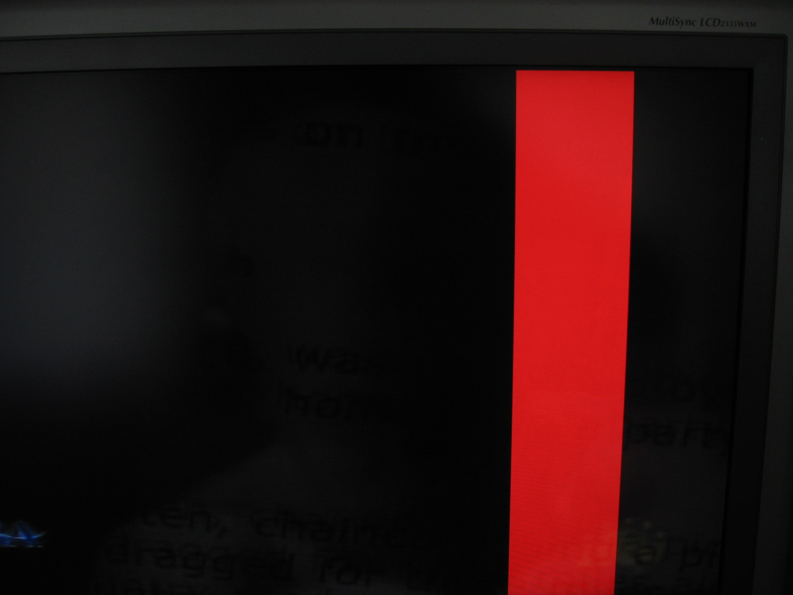

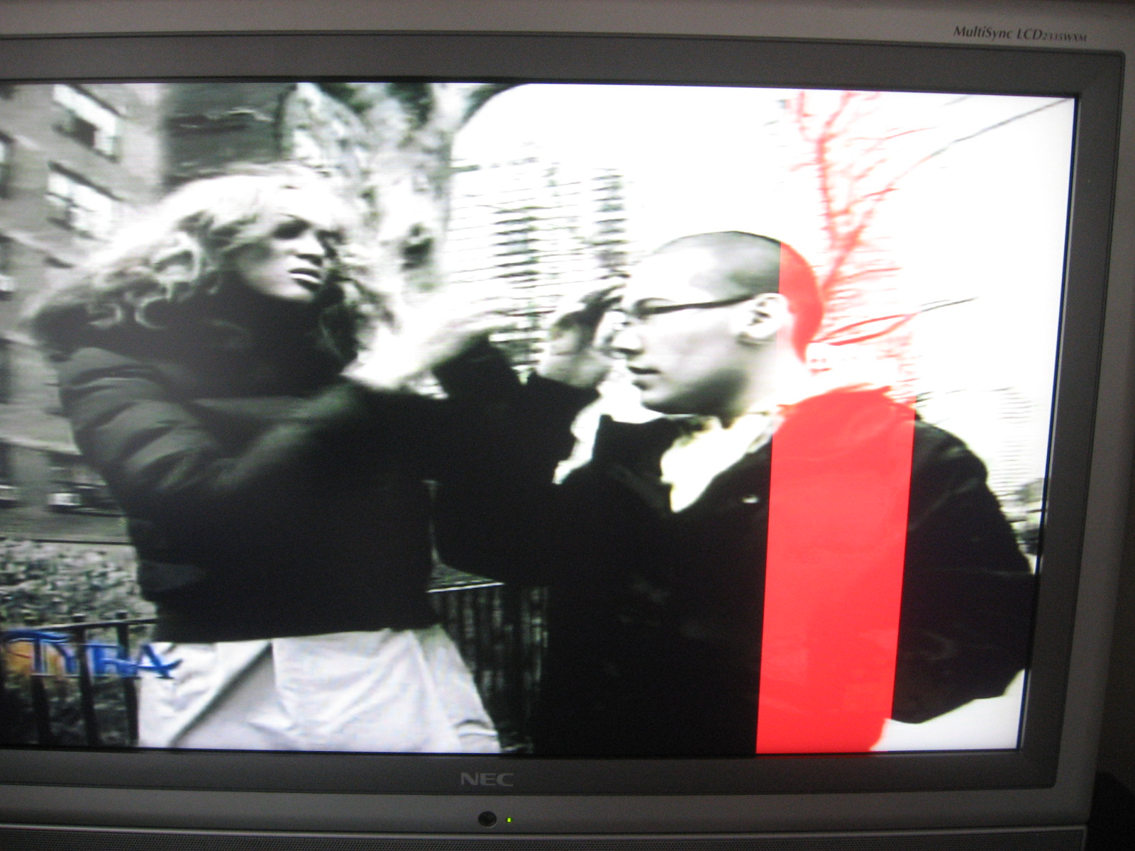

    I have posted this problem but it appears worse. I have a great picture but this huge vertical bar down the right side. This is not under warranty and I was wondering where to look for the problem or is it something that can be fixed? I though it might be a loose connector but I checked them and reseated.

    Wizard is the expert on these, don't take my word for this diagnosis.
    It's obvious that the red driver (buffer?) for one column is not working. I THINK that those are on the flex strip that connects the tcon to the panel, and are not repairable.
    Again, trust Wizard's diagnosis.

      Thanks PlainBill sounds familiar and it may have been Wizard who diagnosed it the first time I posted it. Sorry for bringing up an old thread, was hoping for a miracle I guess.
