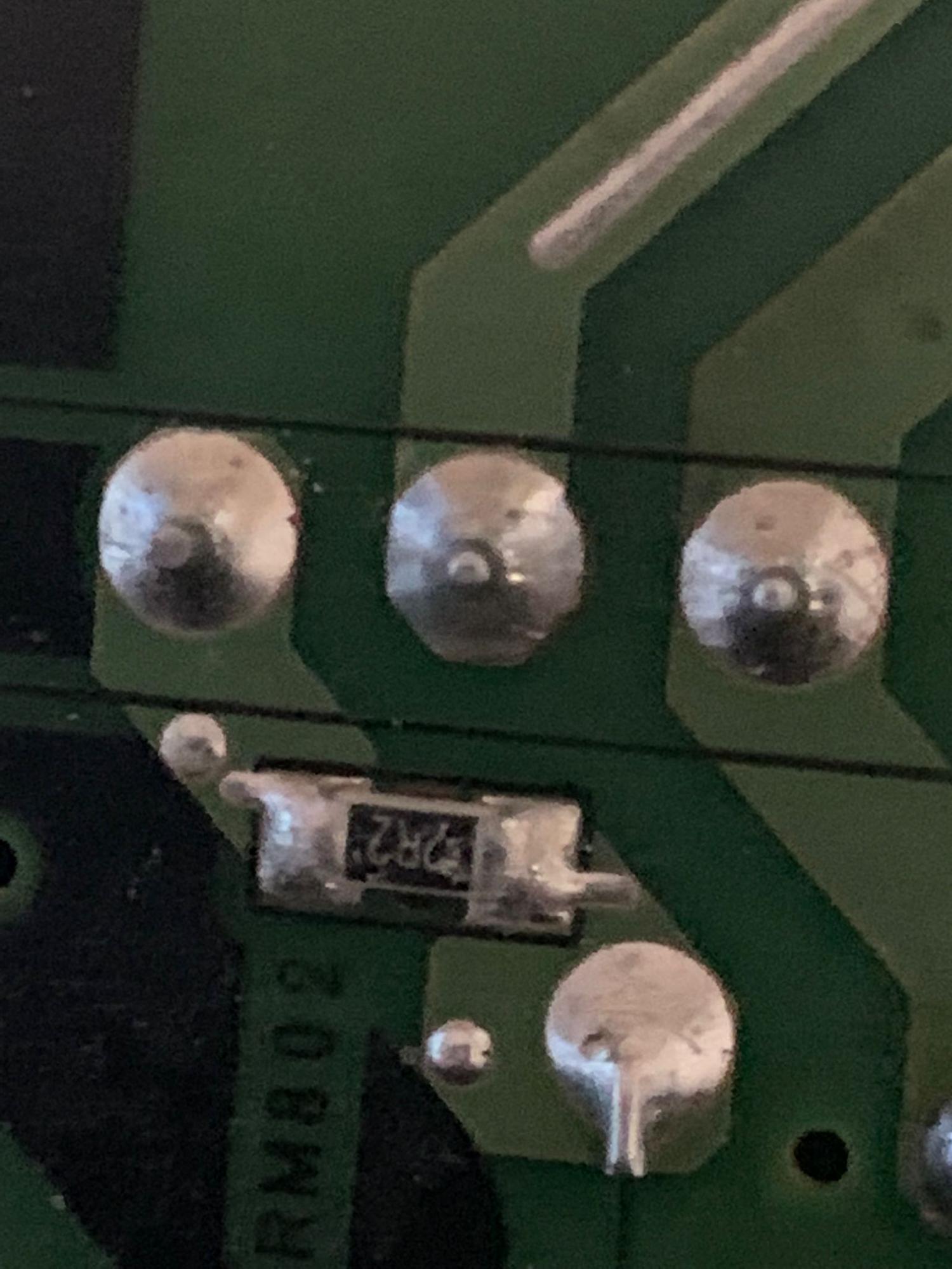

    Hi I'm trying to repair the Samsung lt22b300 power supply. I replaced the srtw6052 chip that was shorted together with the blown fuse and a blown 222 1kv capacitor.
    Now if I check the output voltages they all seem ok, but as soon as I connect a load, led or mainboard, all the outputs become oscillating (backlight flashes).
    To rule out problems with the LEDs or the main board, I tried to replace the power supply board (PD23A0Q) with a borrowed one from another working TV and everything works regularly.
    I checked all the diodes and non-smd capacitors both with the curve trace and by disassembling them and I have not encountered any problems. On the soldering side, I checked the smd diodes in the area of the strw integrated circuit and I also found nothing there. Please I would like to know if someone has solved a similar fault and if you can advise me how to proceed.
    Thank you

                                  Re: Samsung T22b300 power supply problem
                                  I checked rm802 (close to the transformer output) and it is open! Tomorrow I try to replace it, I have to look for it on some other board.
                                      Thanks everyone for helping me!
                                      That would do it.
                                        I think that resistor feeds the vcc to srtw6052
