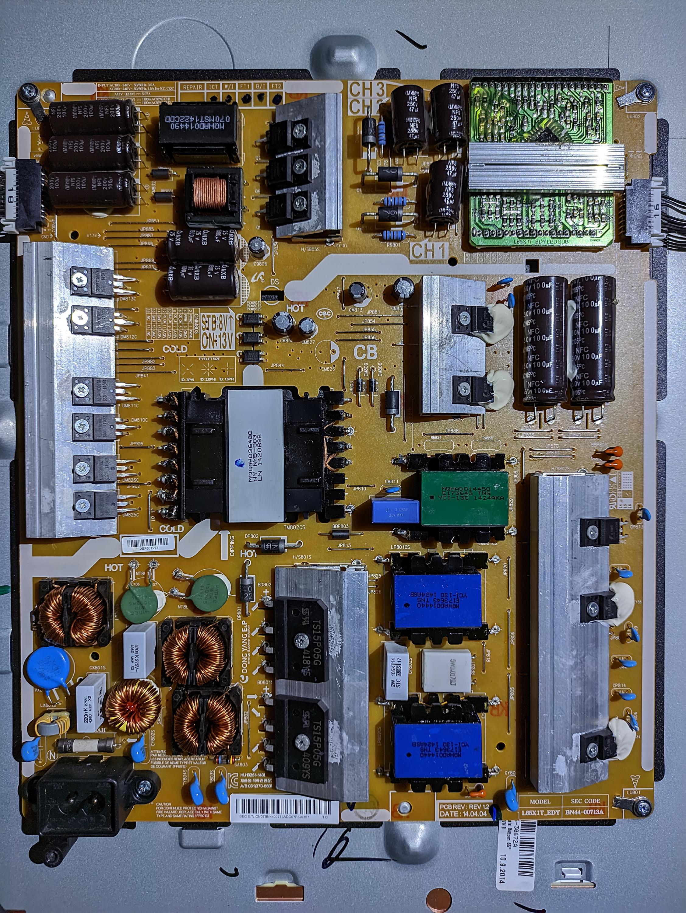

    Hey everyone!
    I have a Samsung UE65H6400AW tv here that won't turn on.
    What I have tested/checked so far;
    • no visible burnt or blown caps or other components
    • power board seems in working order, voltages are oke, fuse is fine, with cable to main disconnected the LED's come on and stay on
    • have done various variations of resets by holding down the power button
    Edit: remote is ruled out.
    I am hoping that some of you can tell me what to check/test next. I am no stranger to soldering, and am totally committed to learning.
    Thanks for reading!

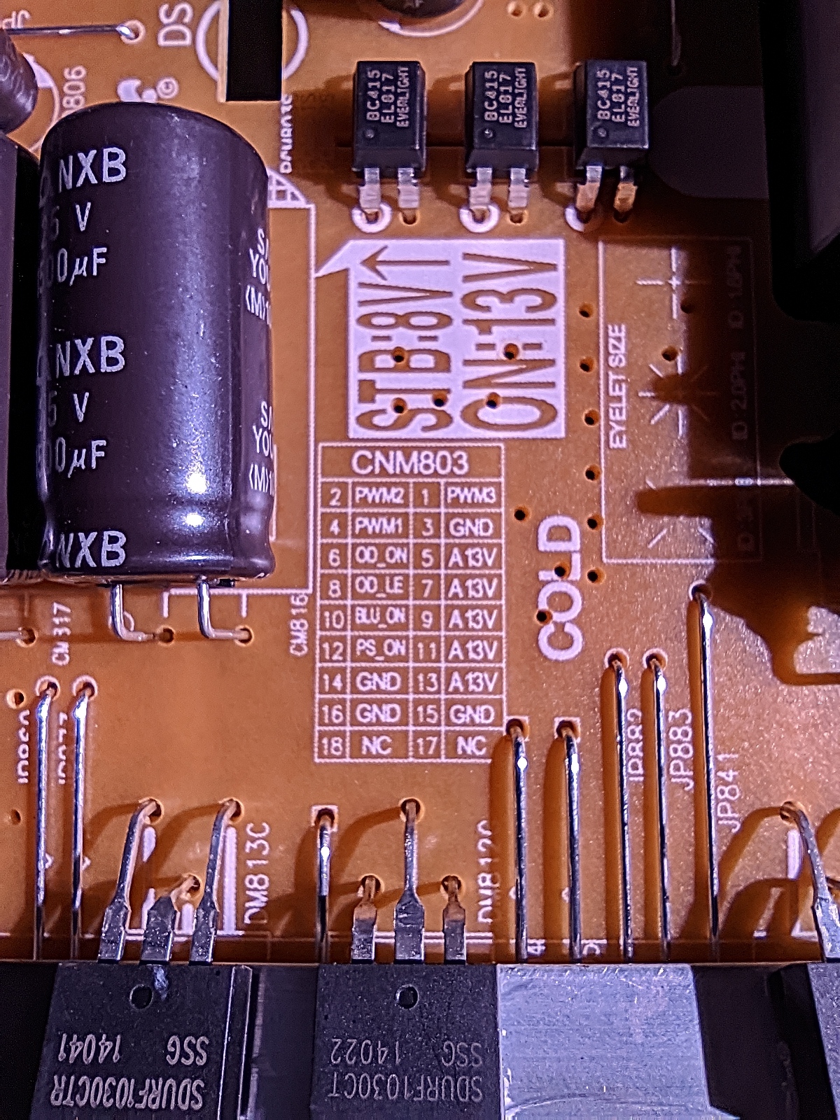

      According to the imprint on the power supply board, pins 5,7,9,11 & 13 should have 13V.
      Upon plugging in the power coard, I measure 12.88V on all of these pins, but they drop to just over 9V about every 2 seconds before going back to 12.88V.
      After pressing the power button, there is no change in this.

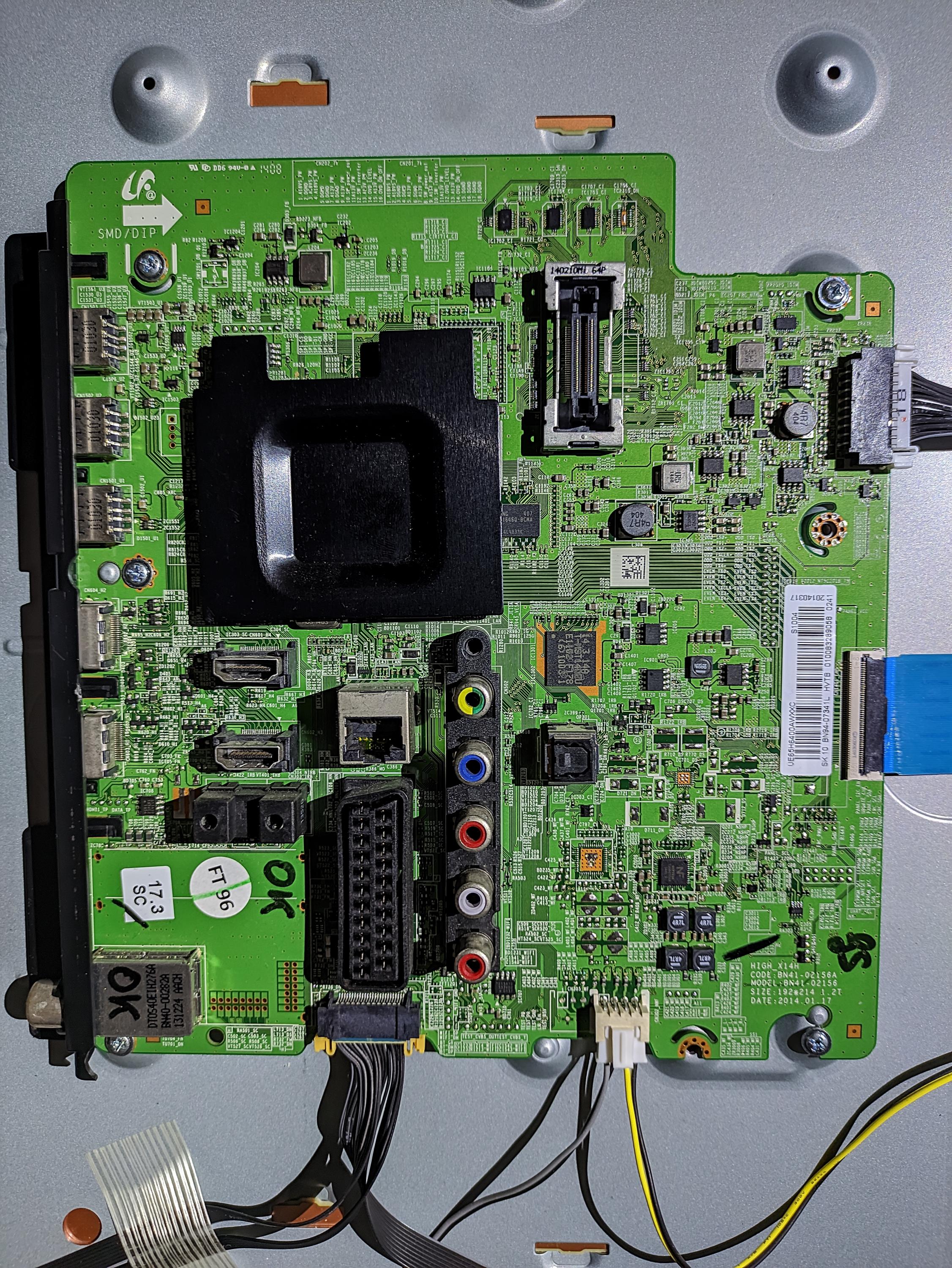

                    Can you post good pics of your mainboard
                    • DutchDIY
                      • Feb 2022
                      • 51
                      • Nederland
                      Re: Samsung UE65h5400AW Won't Turn On (Has Red Standby Light)
                      Here are some pictures, are they good?

                        Standby;
                        Pin 1: 0V
                        Pin 2: 0V
                        Pin 3: 0V
                        Pin 4: 0V
                        Pin 5: 12.88V (expected 13V)
                        Pin 6: 0V
                        Pin 7: 12.88V (expected 13V)
                        Pin 8: 0V
                        Pin 9: 12.88V (expected 13V)
                        Pin 10: 0V
                        Pin 11: 12.88V (expected 13V)
                        Pin 12: 0.188V (idk what to expect? Legend says PS_ON)
                        Pin 13: 12.88V (expected 13V
                        Pin 14: 0V
                        Pin 15: 0V
                        Pin 16: 0V
                        Pin 17: 0V
                        Pin 18: 0V
                        Next I will post the voltage after pressing On button.
                        About the above voltages, those drop every second to just over 9V (and pin 12 drops slightly as well), and it coincides with the ticking of what I believe are the mosfets.

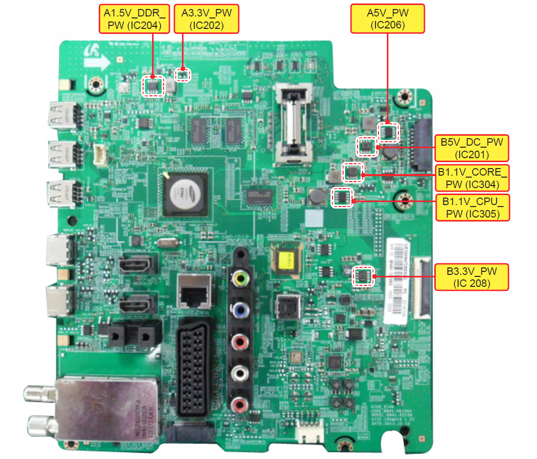

                            Check the voltages on the converters on the motherboard.

                              Will check that, thanks, which pins of those chips should I check?

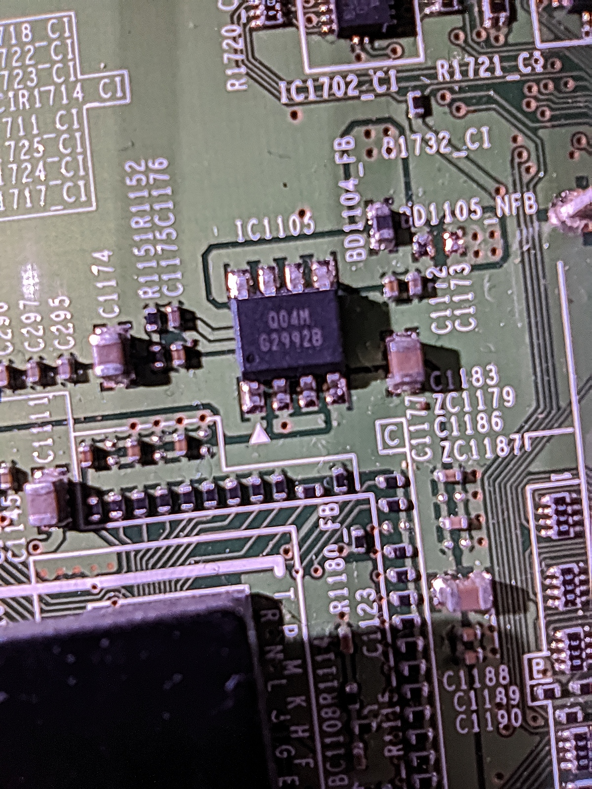

                                  I'm sorry I don't know which of those feet to probe with the multimeter.
                                  I added a closeup of one of the 8 legged chips.

                                    Start checking the smd capacitors and diodes on the main board. Where ever you see an 8 pin ic I would probe around there first. If I’m not mistaken I fixed this board before and it was a bad diode
                                    • DutchDIY
                                      • Feb 2022
                                      • 51
                                      • Nederland
                                      I am finding a bunch of smd's beeping on both ends (with one probe to GND). That must not be good?
                                        See datasheet.
