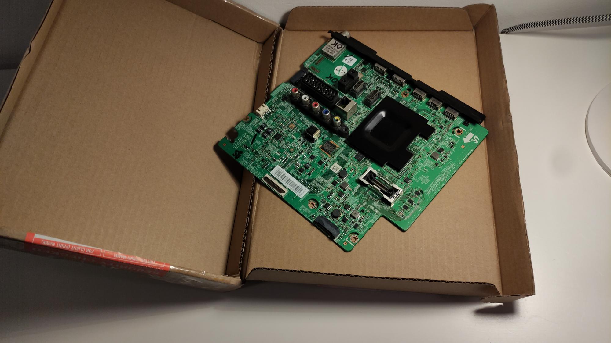

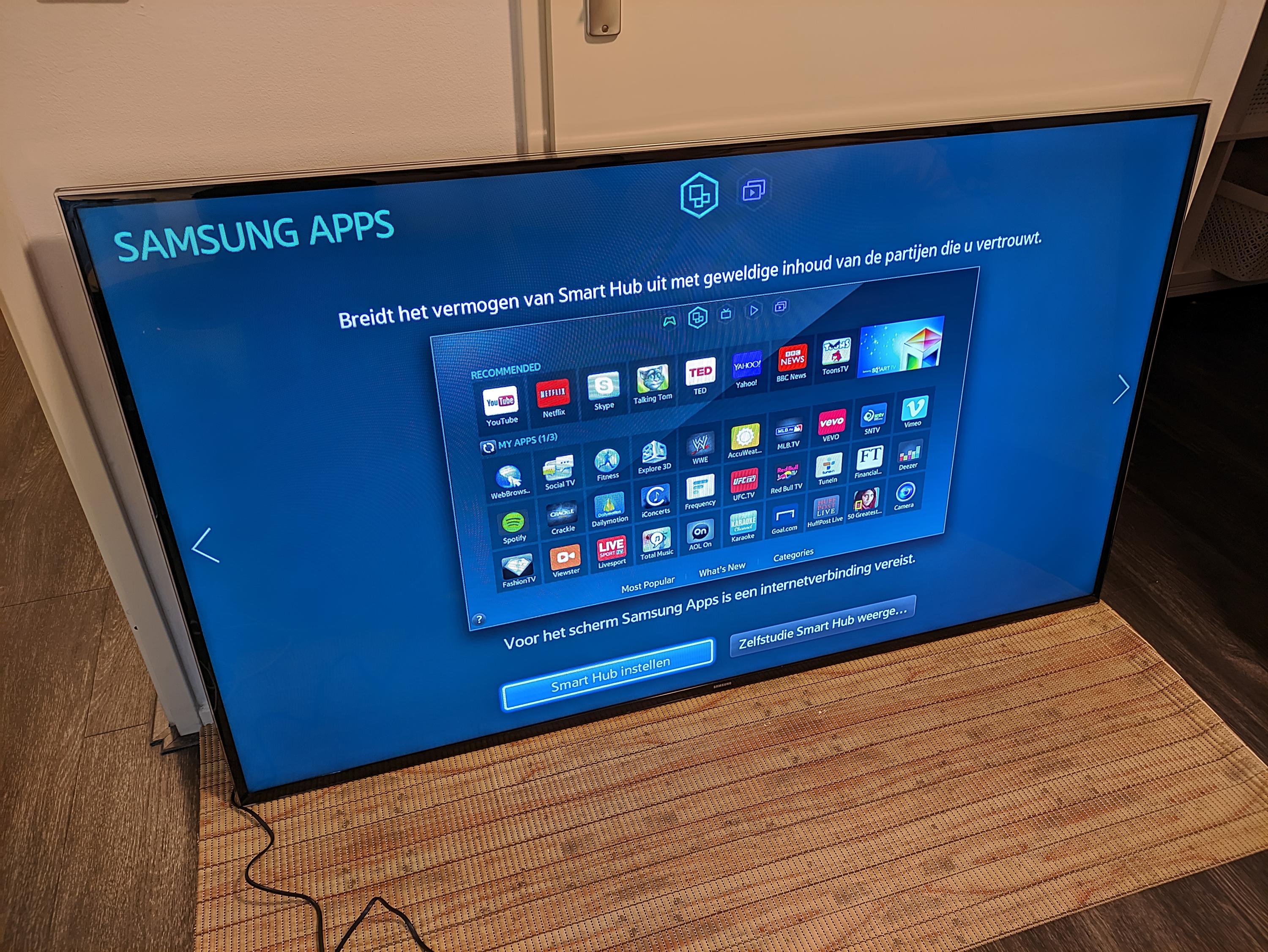

                    This tv has been revived, thanks guys!
                    Put in a new motherboard (literally new.. came from new broken screen tv), for €80,-.
                    So this tv is good to go for years to come!
                    (The board on the photo is the old one that came out)
