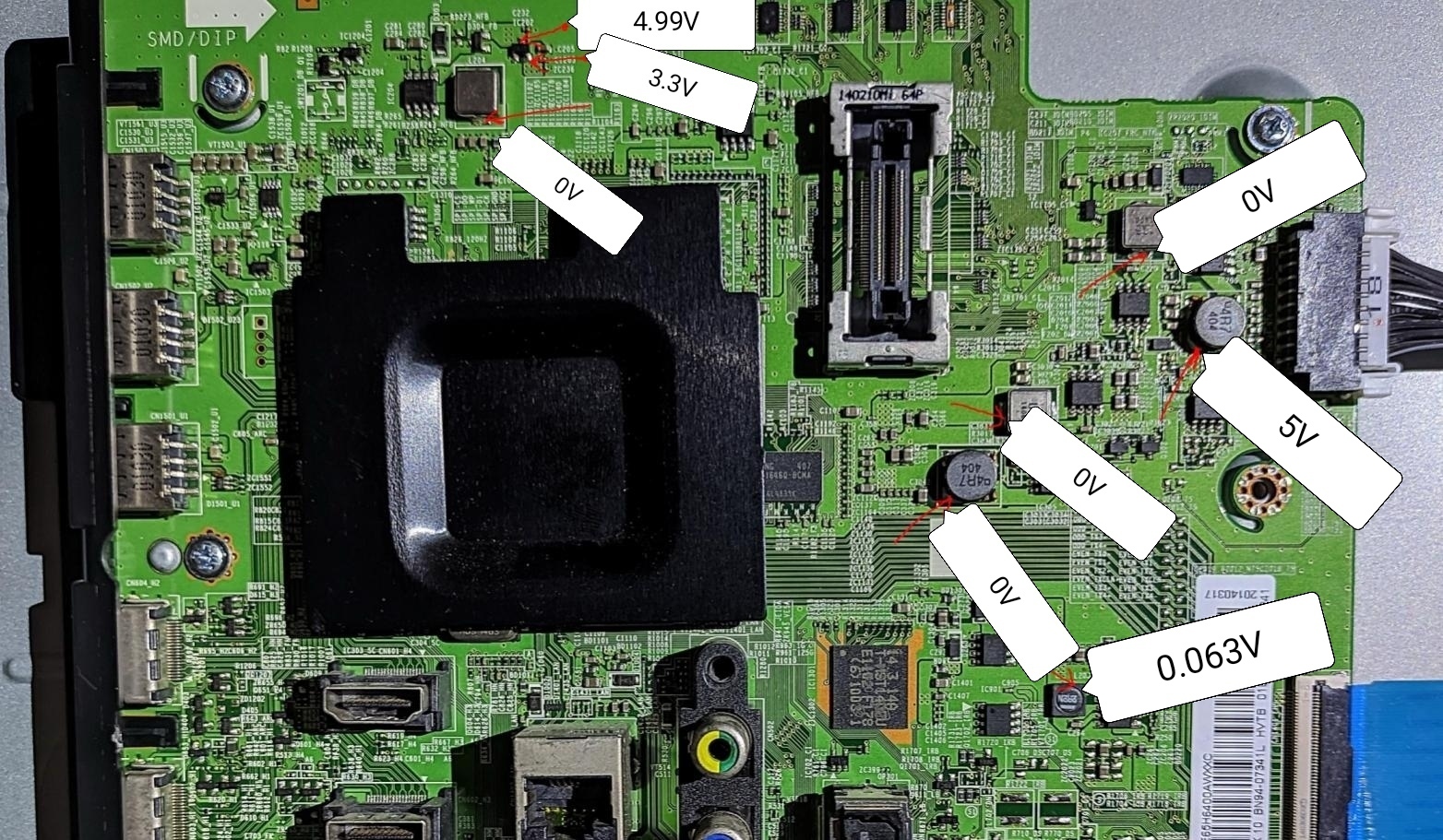

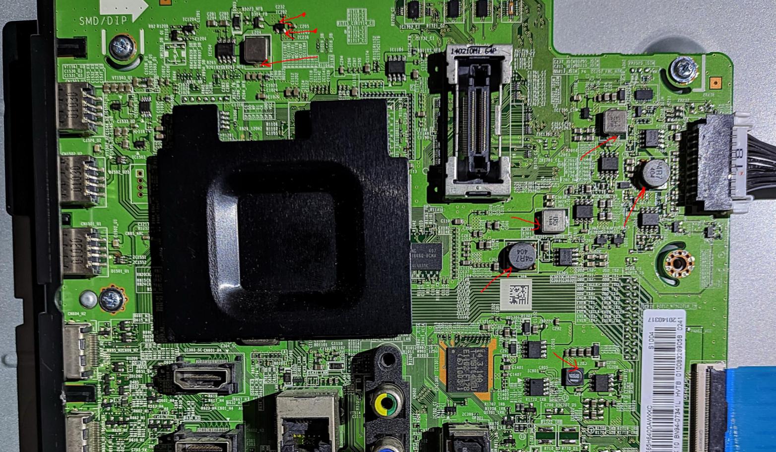

    Check the voltage between gnd and these points where the arrows are.

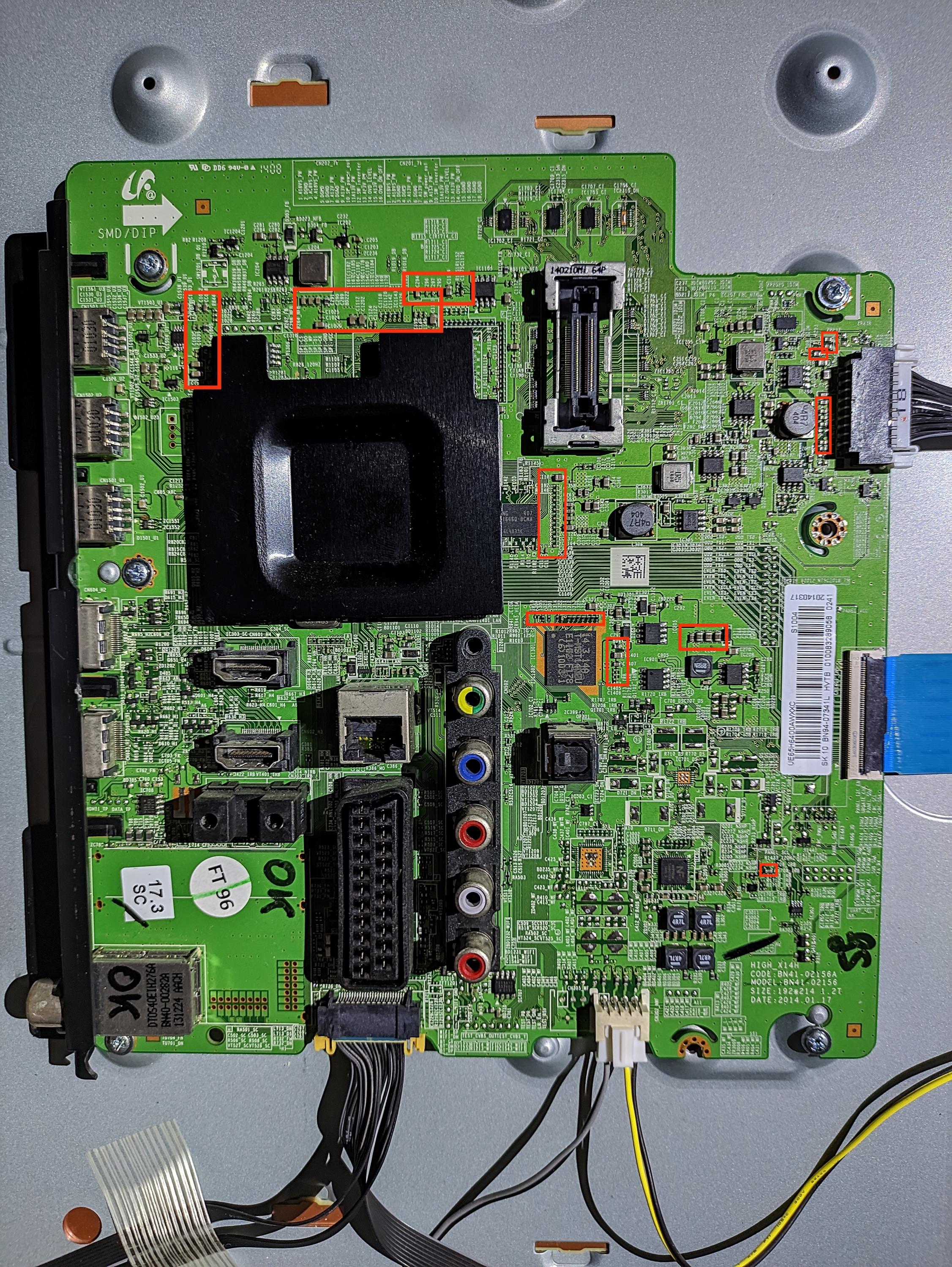

      Originally posted by DutchDIY
      I am finding a bunch of smd's beeping on both ends (with one probe to GND). That must not be good?
      No not good, but making progress. Now their should be a small black diode near those capacitors that are short. Check those diodes for continuity to find the short

        Re: Samsung UE65h5400AW Won't Turn On (Has Red Standby Light)
        Thanks for showing me! I very much appreciate it!
        I have measured and added the image.
          These all beep continueously, see image. Might have missed some though.. not sure what those diodes should look like on the board. Could you maybe point them out?
            unhook the other cables from the mainboard (isolate it) and see if all those remain short, they probably will, the good news is there's probably lots of substitutes for the mainboard so it should not be hard to find a replacement if you have to.

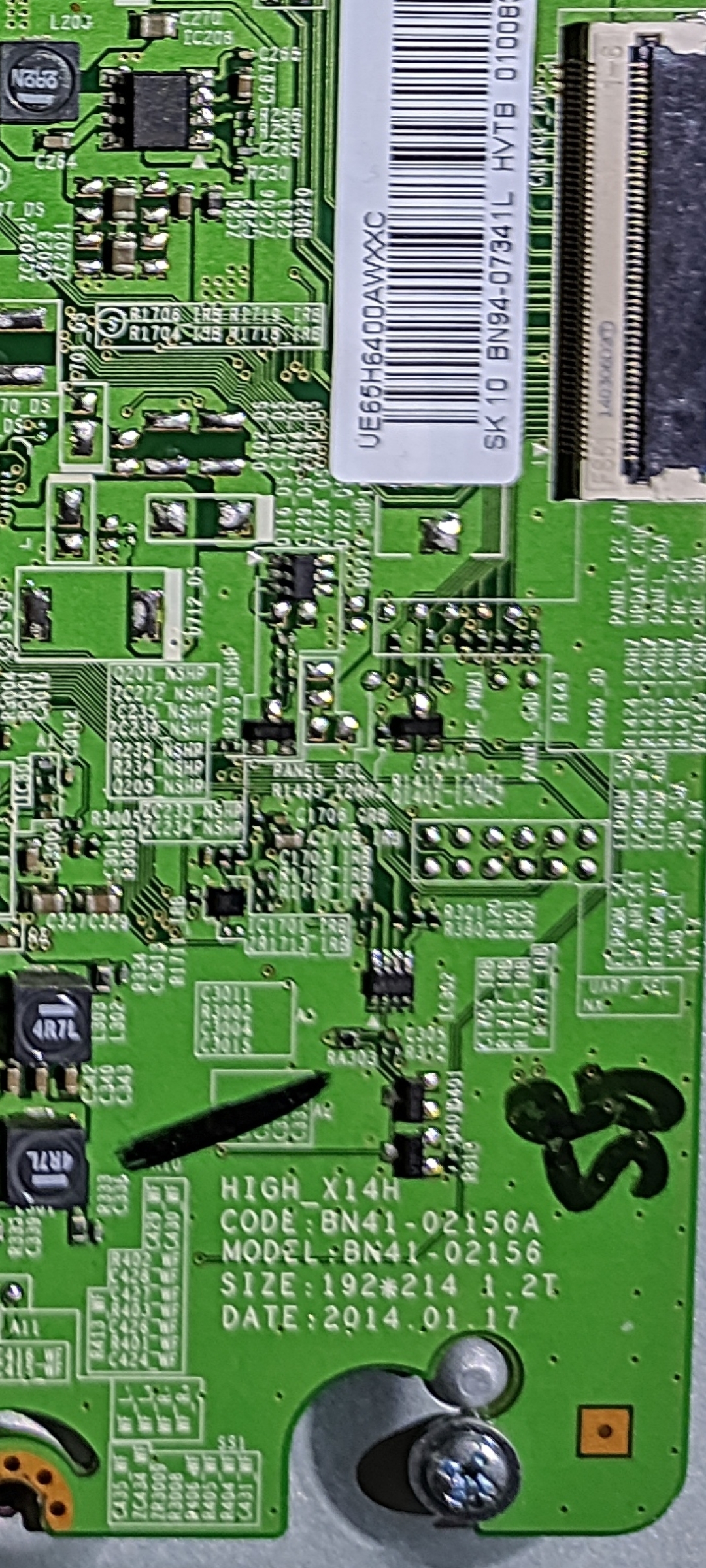

                        #31

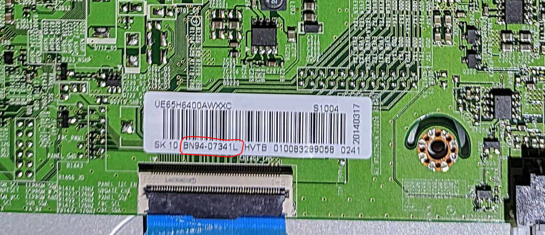

                        Main board says; bn41-02156a.
                        • nomoresonys
                          • Jan 2013
                          • 12129
                          • U.S.
                          #32
                          are those the numbers on the white sticker?
                          • DutchDIY
                            • Feb 2022
                            • 51
                            • Nederland
                            #33

                              #34
                              Bn94-07341l
                              • DutchDIY
                                • Feb 2022
                                • 51
                                • Nederland
                                #35
                                Oh I was checking here, oopsie.
