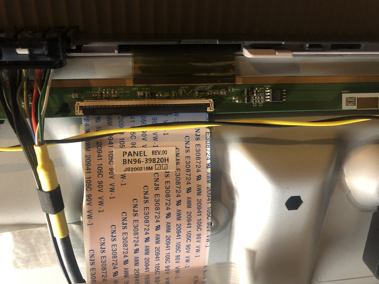

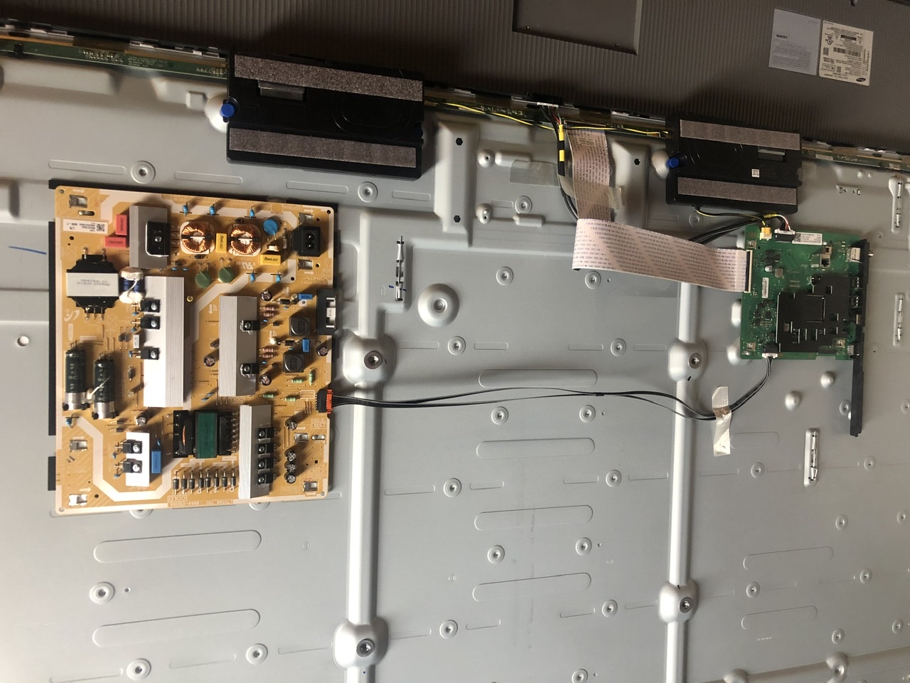

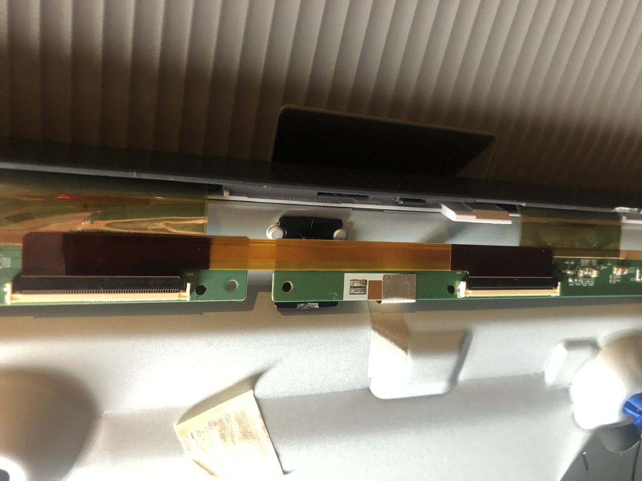

    This tv has no image, but does have sound and backlights, when I remove the cable between the ps and main board I have lights. And main board to the panel driver board It goes dim. I did notice the two other panel boards on the edges left and right if I remove the jumpers from the center board the backlights stay on if I connect the jumper the tv goes dim and flickers and 2 red blinks. Need help

    may be a problem with the panel, maybe try the tape cutoff method: https://www.youtube.com/watch?v=pfrRhw7-ZII

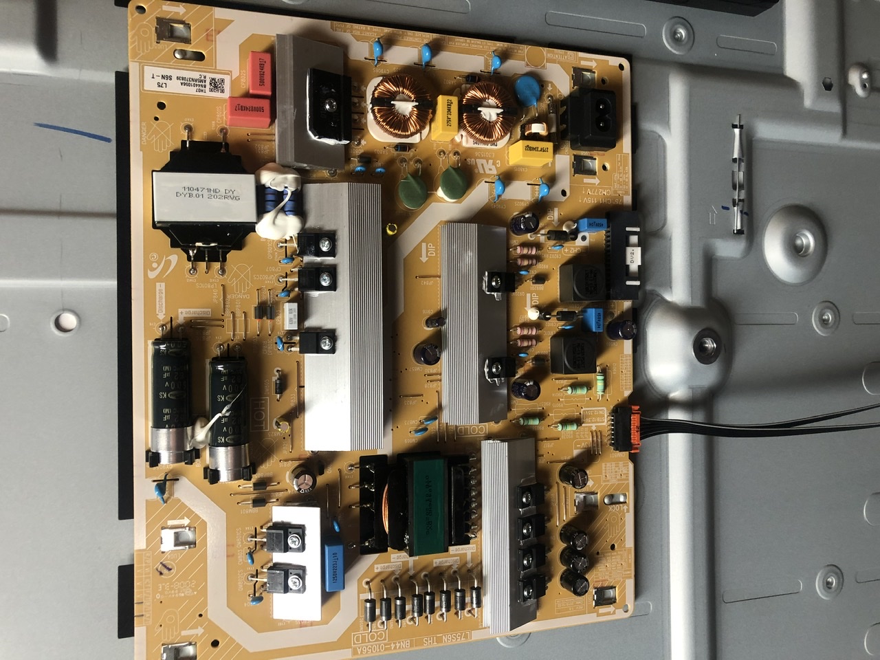

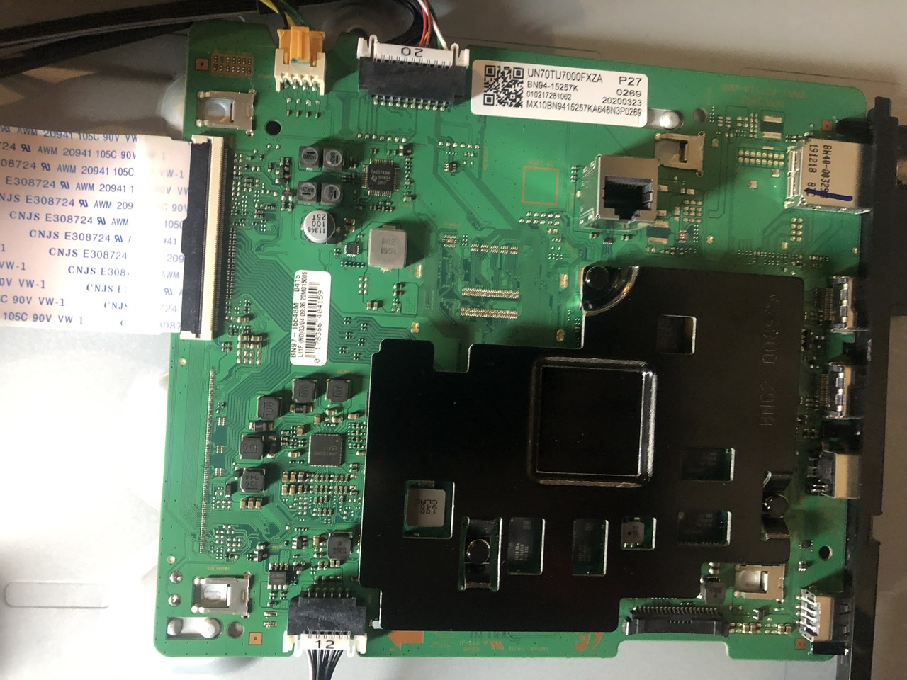

      Need some good pictures of boards.

          Here are pics of the boards

            Looks like panel issue, you can try scotch tape on the jumper cable between panel boards.

                  Probably a short in one of the panel board caps.
