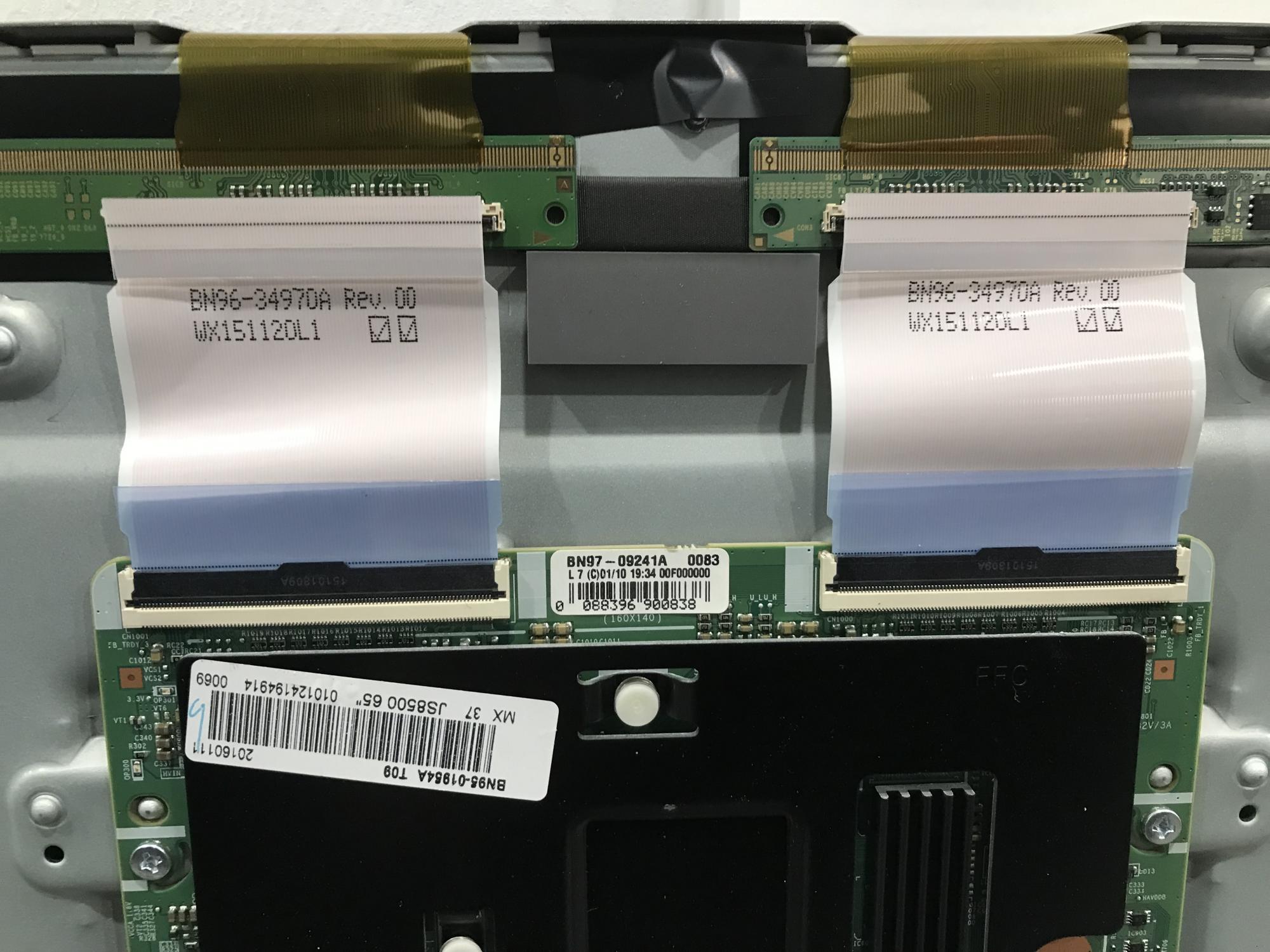

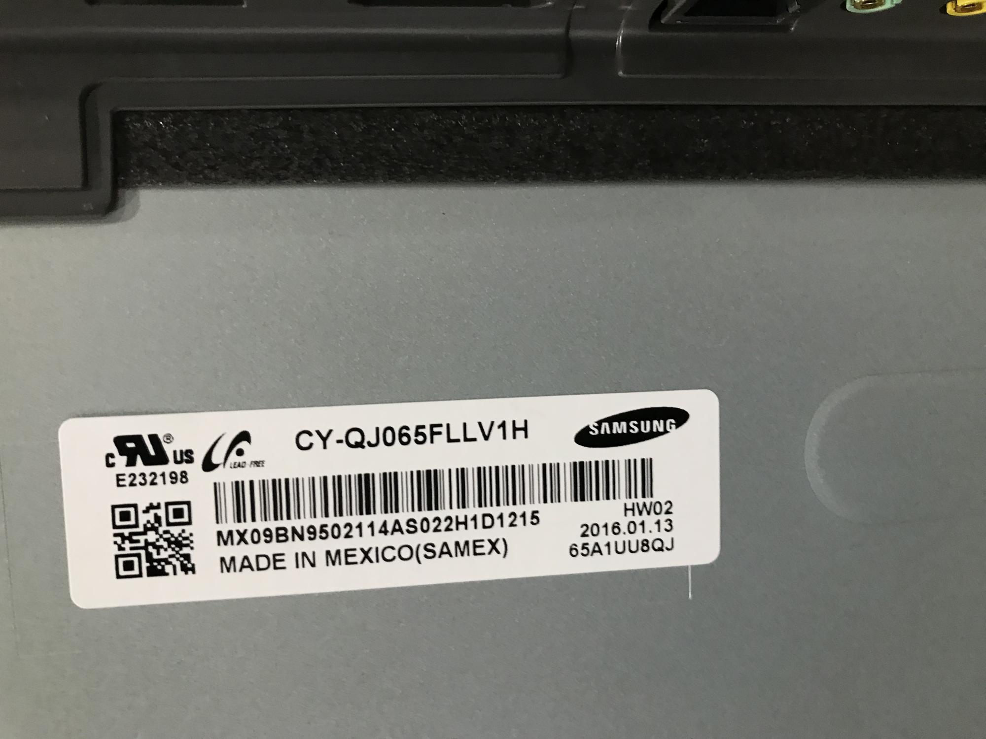

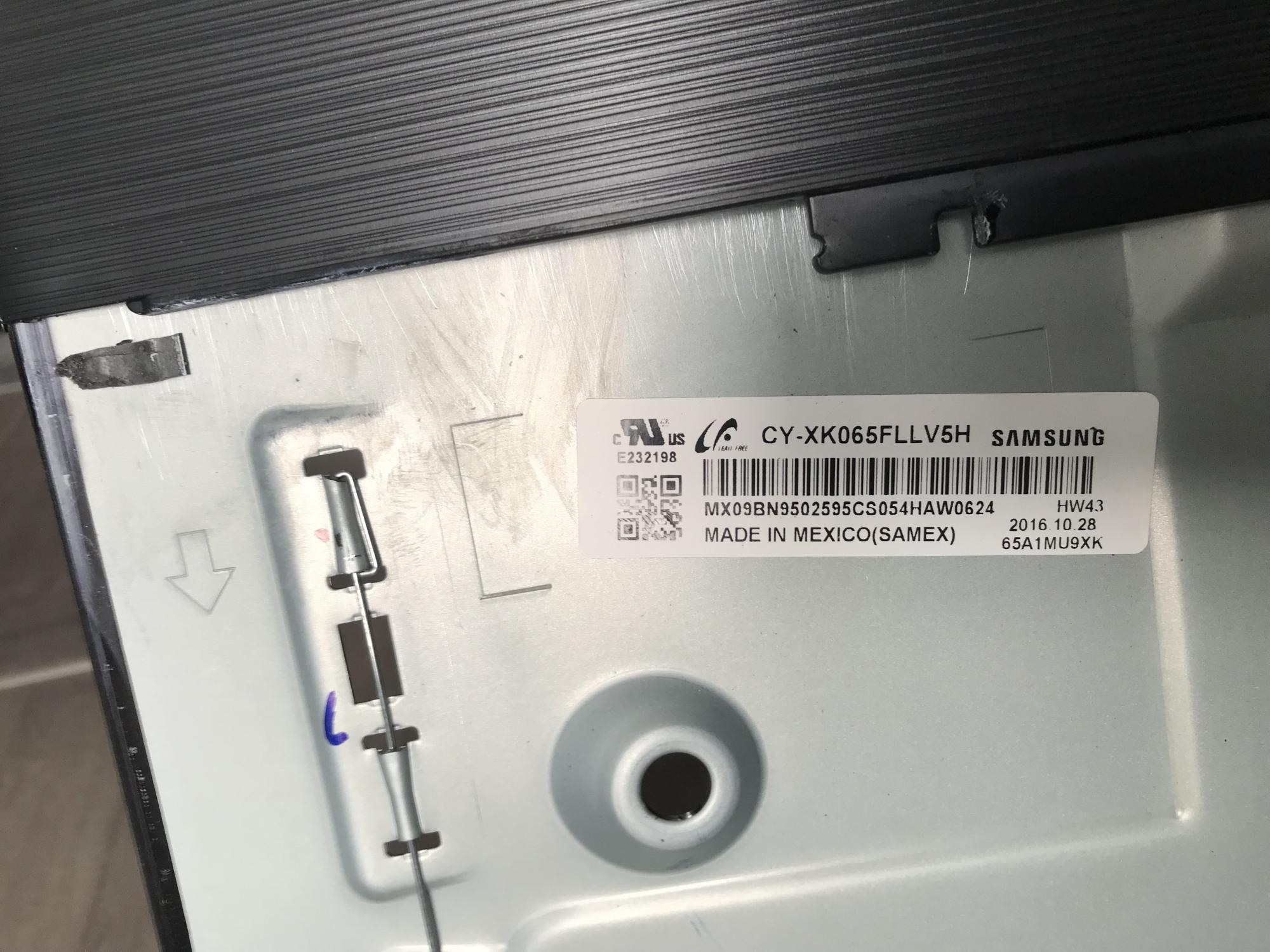

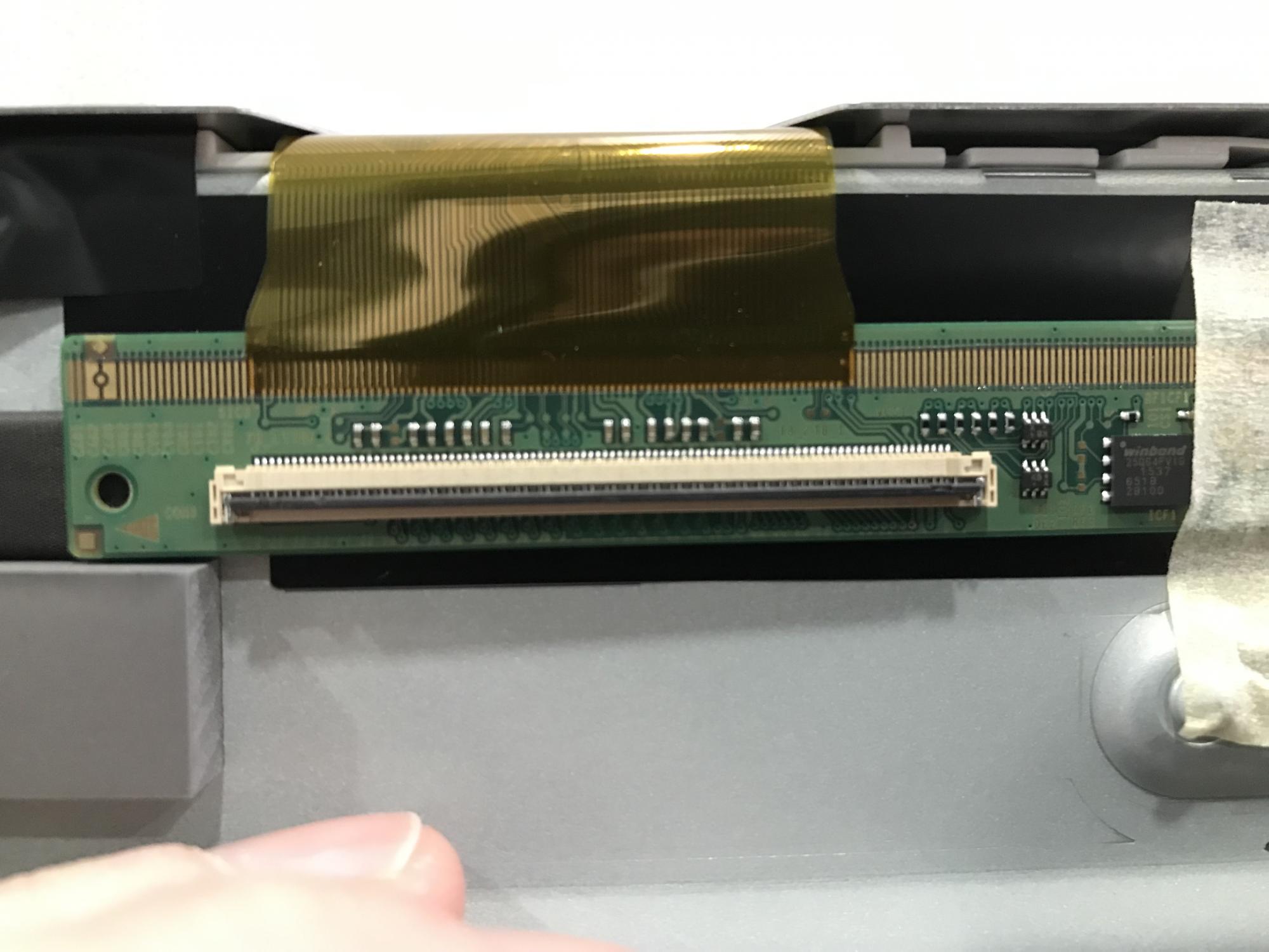

    Can someone help me find out if these 2 Samsung panels are compatible?
    I tried to compare on panelook.com but they don't have them listed.
    1 is from a un65js8500 the other from un65ks9500
    Picture attached of the labels on both.

    The KS9500 seems to have the mainboard+tcon in just one board, and cables that run directly to the panel, the JS8500 has a separate t-con closer to the panel, even if the cables do fit, that does not guarantee that it will work.
    I would say, don't risk it unless you don't have to spend money on parts and have the two TVs side by side.

      One is 3D, another is curved, very unlikely.

        I have both tv's and parts in front of me. They have the same connections even though 1 has a tcon and the other does not. They are both 10 bit SVA panels and both are Samsung brand.
        Just not sure if the power and grounds are in the same location

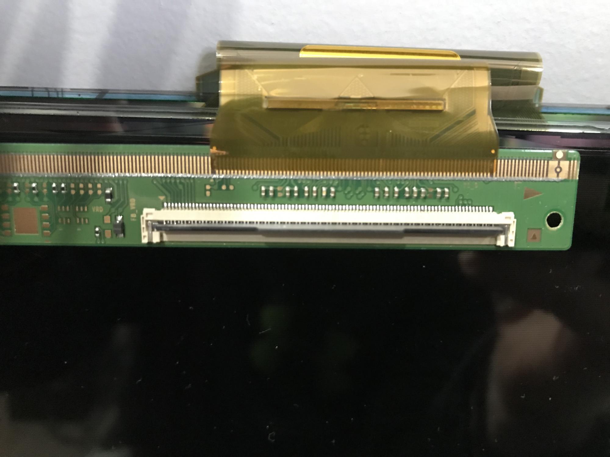

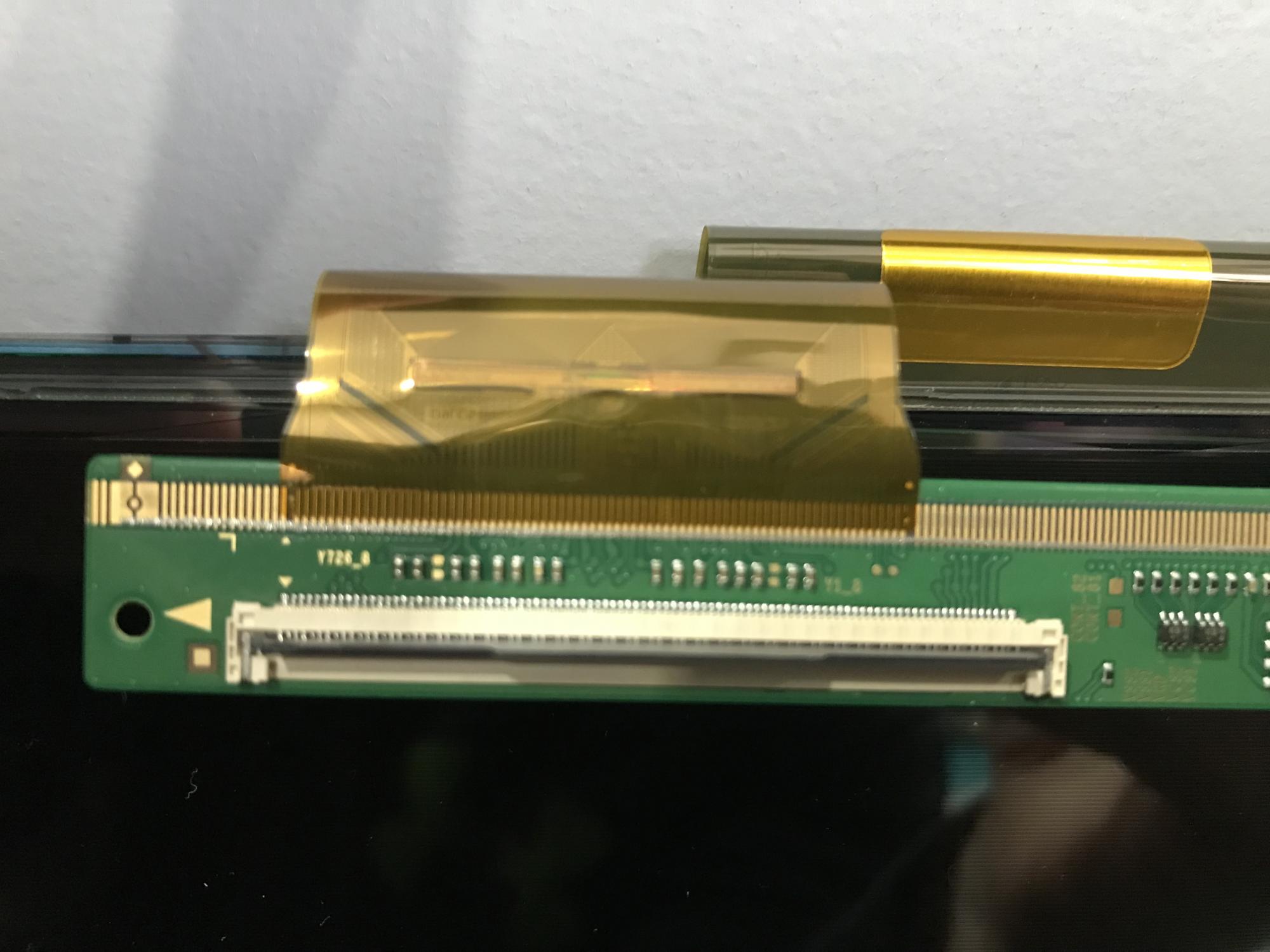

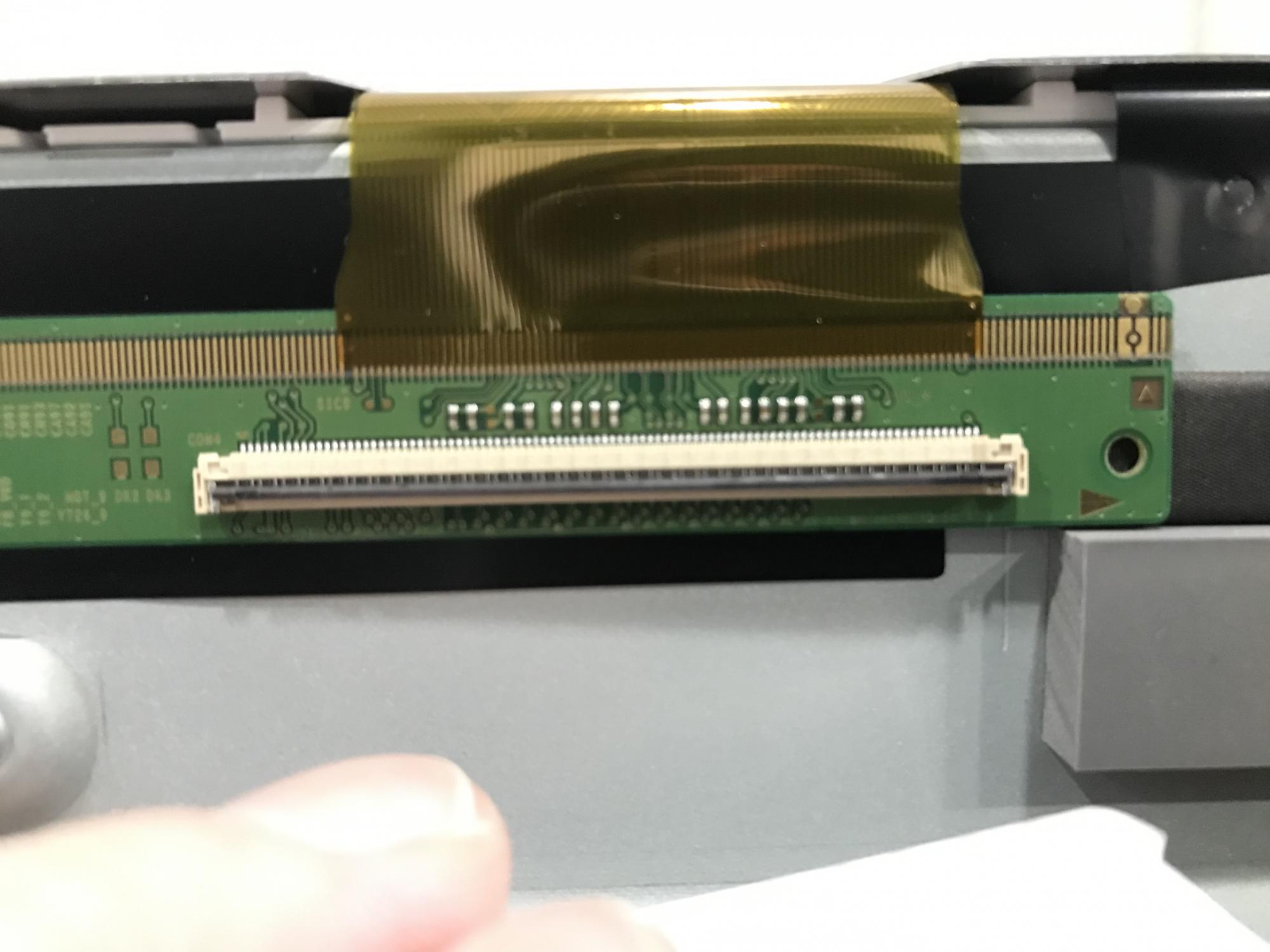

            show us focused high resolution photos on both panels sockets the left and right

                  As far as I know the picture that you have posted is not the screen model. Its the model for the case+diffusers and stuff.
                  Check both left and right side of the screen and you should see a model number printed on 1 of the sides. Then compare both models.

                    Hope the pics are clear enough. Took them with my phone real quick.
                    1st 3 pics are the JS panel and the last 2 are the KS panel

                      both same layout and VCC. should working with out any issue

                          Since you have access to both screens, are they the same? Printed on the buffer boards is a part#.

                            Check the model numbers on the green pcbs directly connected to the screen before you make any move!!!

                              I'm not in front of it at the moment but there not the exact same. That's why I asked if they were compatible.
                              Do you know anyway to confirm other than same pcb model #s?

                                    Update. It may work however I was going to put the js panel into the ks frame. Unfortunately the js panel has cof tabs on the side and will be seen if put into the Ks frame.
                                    So a no go for me.
