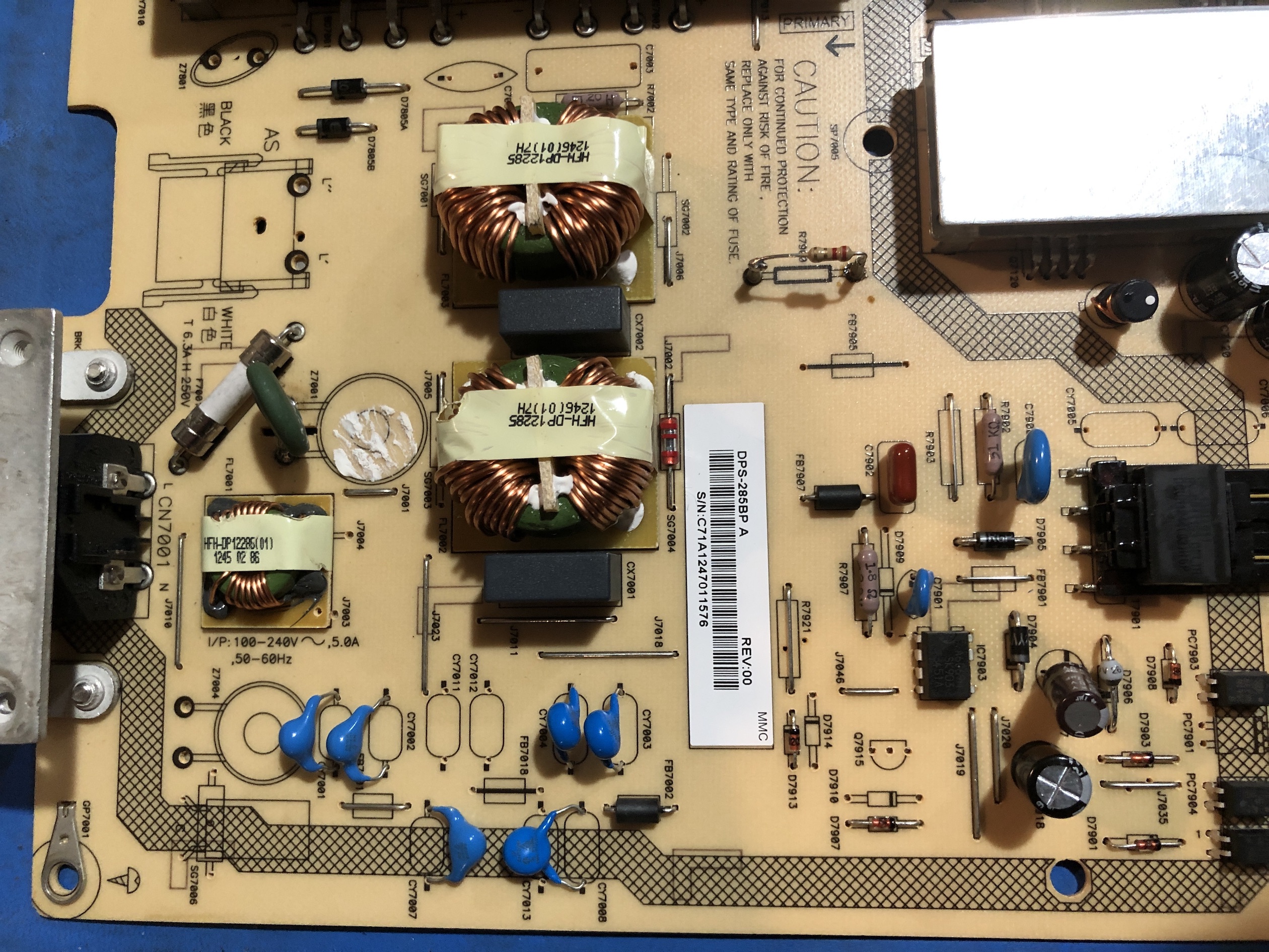

    Sharp TV LC-80LE633U
    Power supply board DPS 285BP Run TKB096WJQZ

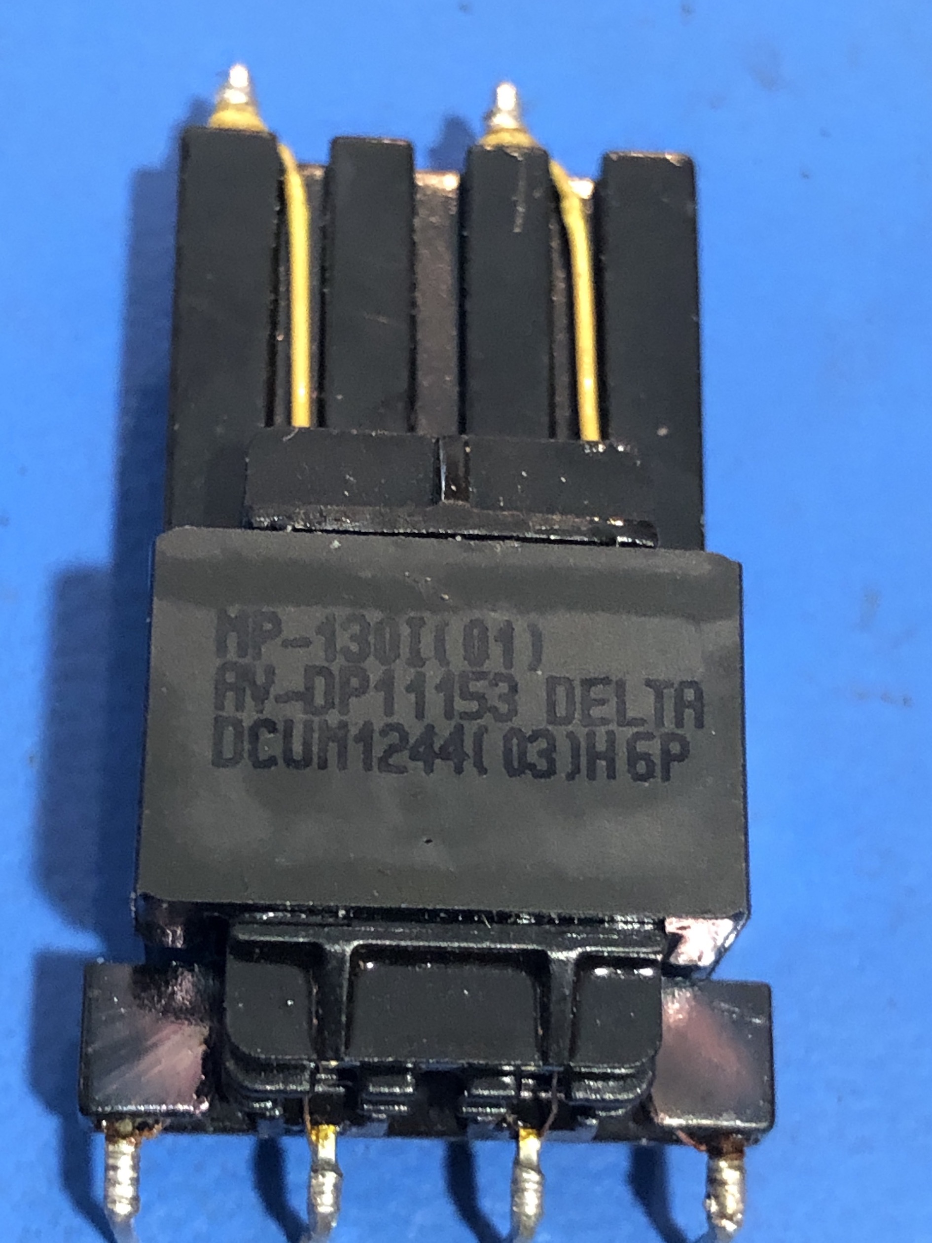

    Standby transformer markings (attached picture)
    MP-130I(01)
    AV-DP11153 Delta
    Dcum 1244(03) H6P
    So an event in the primary exploded the cap (C7901)on pin one of the Standby circuit IC. So after replacing a couple diodes a the 2.2ohm resistor(fuse) I found the transformer inputs are open.
    Anyone know about replacements for this transformer?
    I suspect the original is not available.

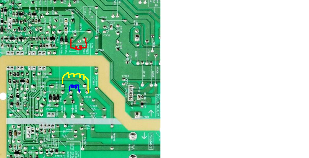

        Re: DPS285BP 5v standby transformer blown
        That's not the configuration, the primary is 2~3, The vcc feedback is 1~4 Pins 5~7 are the secondary.
        Also check R7907, and I would also replace C7907 and C7918

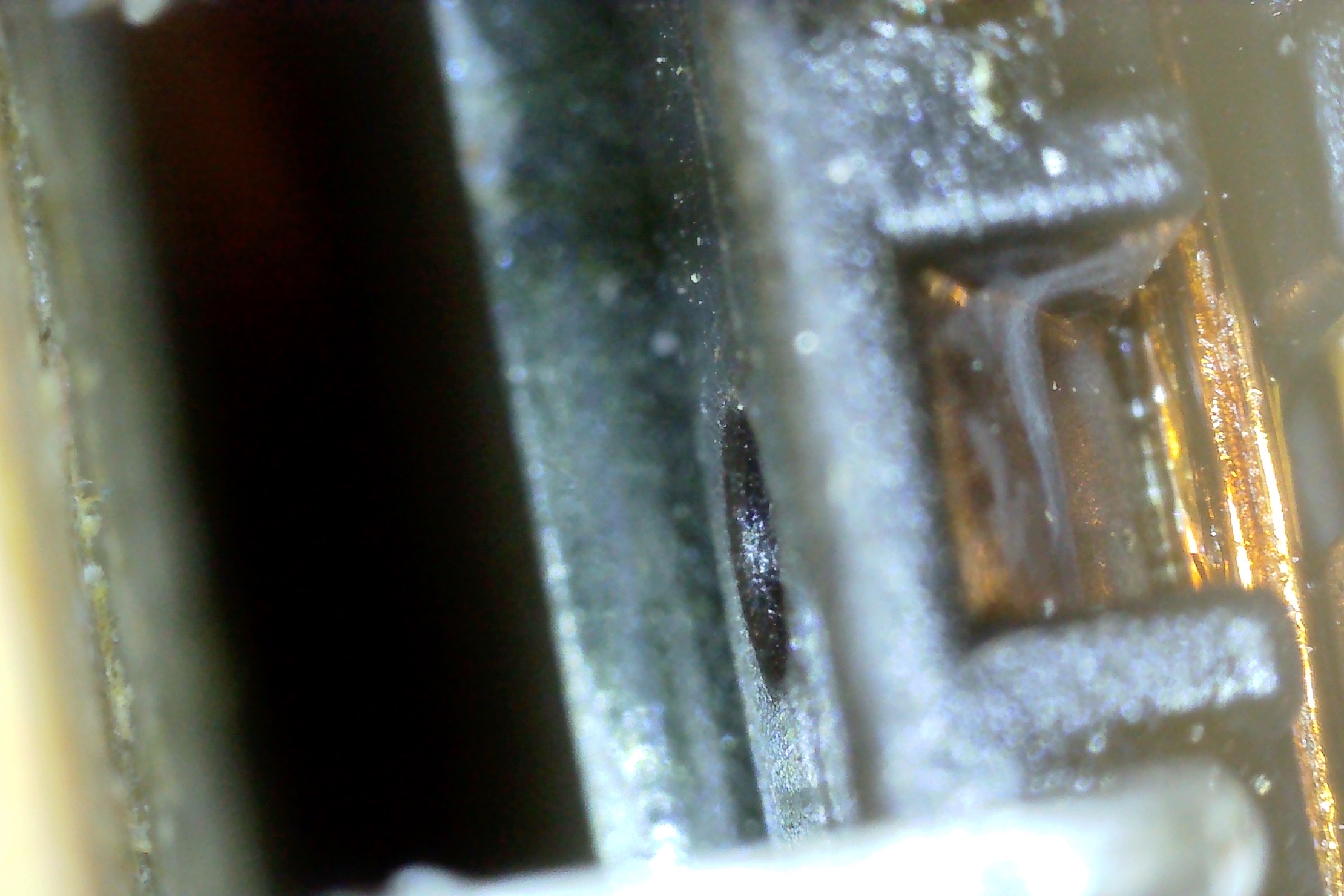

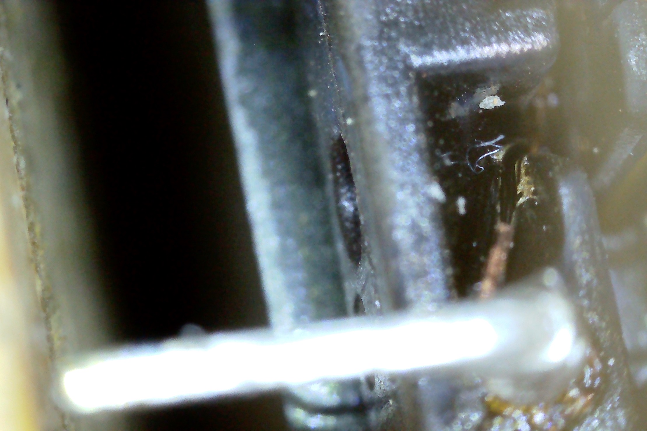

                I used my digital microscope and the coil at pin one is burnt.
                Second photo is good side.
