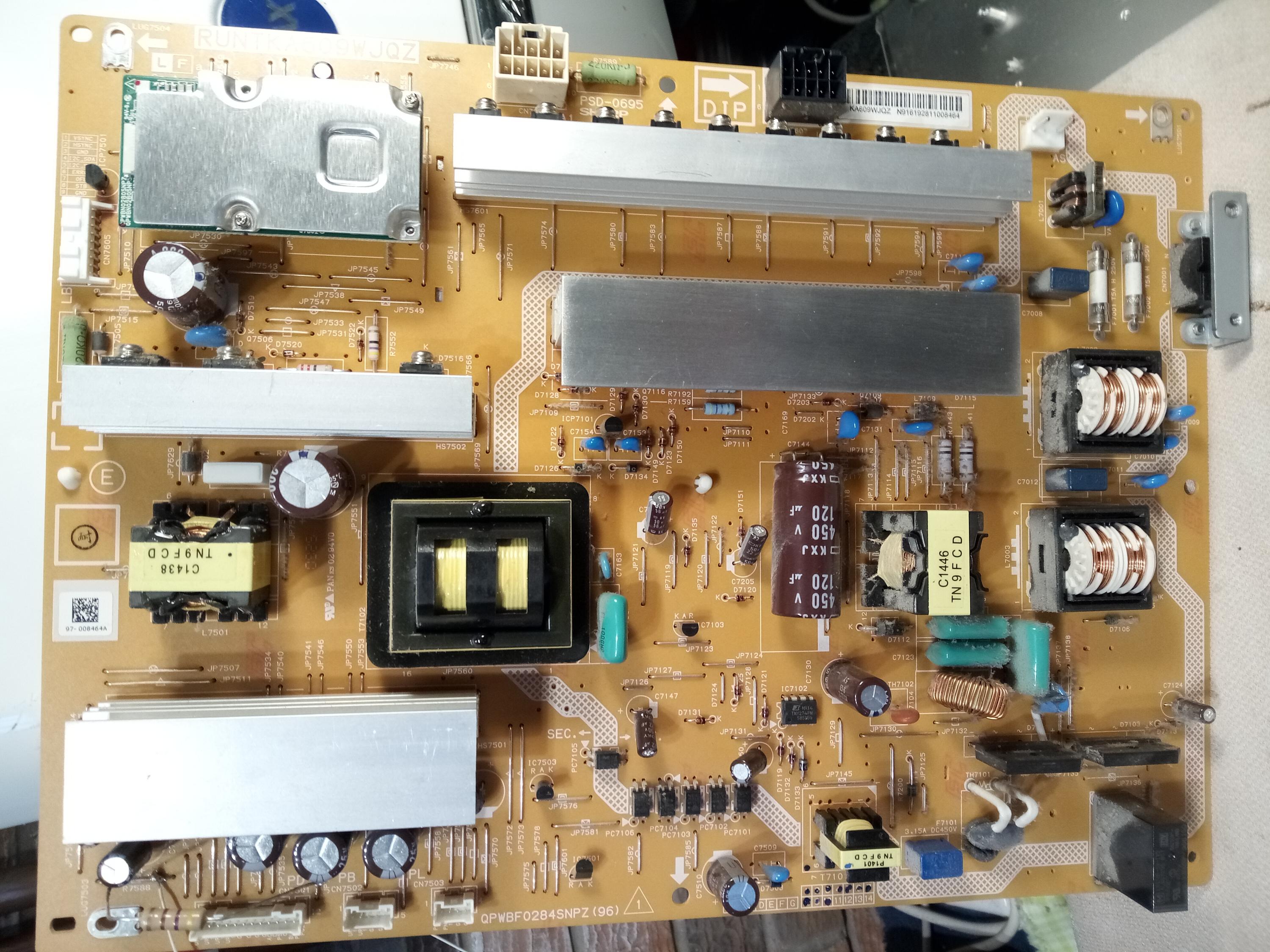

    Hi this sharp was stuck in sby 5v sby volts present.
    after the usual checks i jumped the psu with 470ohm to panel on and 5v sby to power on .
    all supplies came up 12v etc ,
    so after trying many times to get it to start in s/mode vol_ and source, then powering on no luck
    the sby led remains red and not even a flicker from remote control
    i decided to open up to inspect the leds
    i found two s/c and 3 would light fine
    but had lower resistance when checked
    as my meter on diode test mode would not provide enough voltage for them to light i decided they must be 6v types as used on many lg models
    once replaced each strip would light fine with my led tester
    i was very suprised to find 10v across each of the original leds!
    i assumed the leds were either 3v or 6v with psu forced on leds would only flicker
    there are 9 strips with 17 leds on each all strips are individually fed from psu
    with my led tester each strip has 170v across it
    as youve guessed it
    once re assembled without lcd panel and removed 470 ohm and link
    symptoms remain the same refitted lcd panel still the same
    now im at the head scratching stage

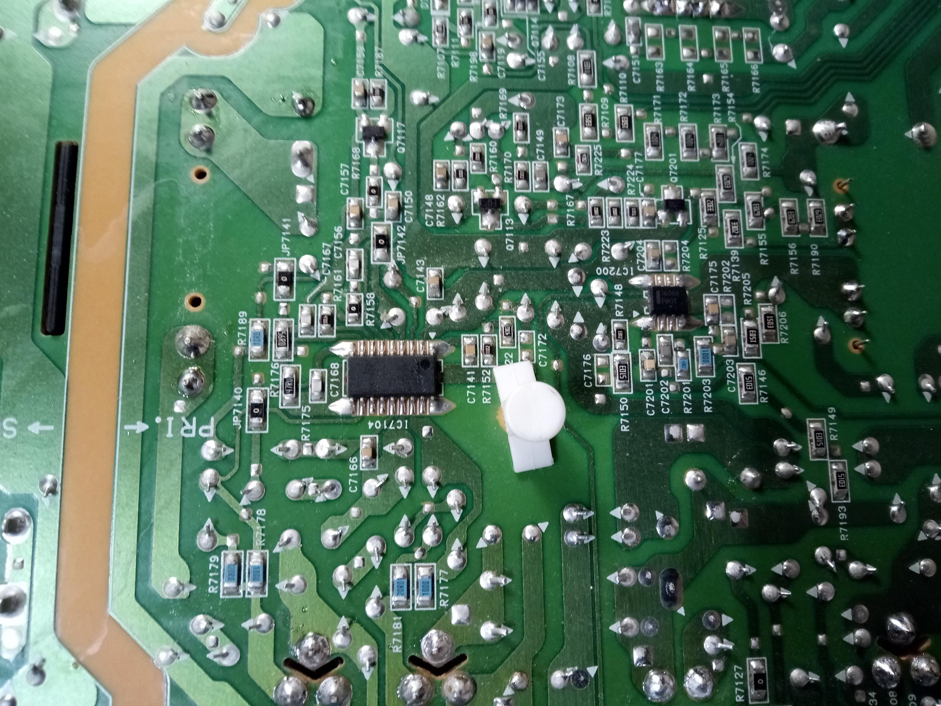

          now i realise this is not the correct cct

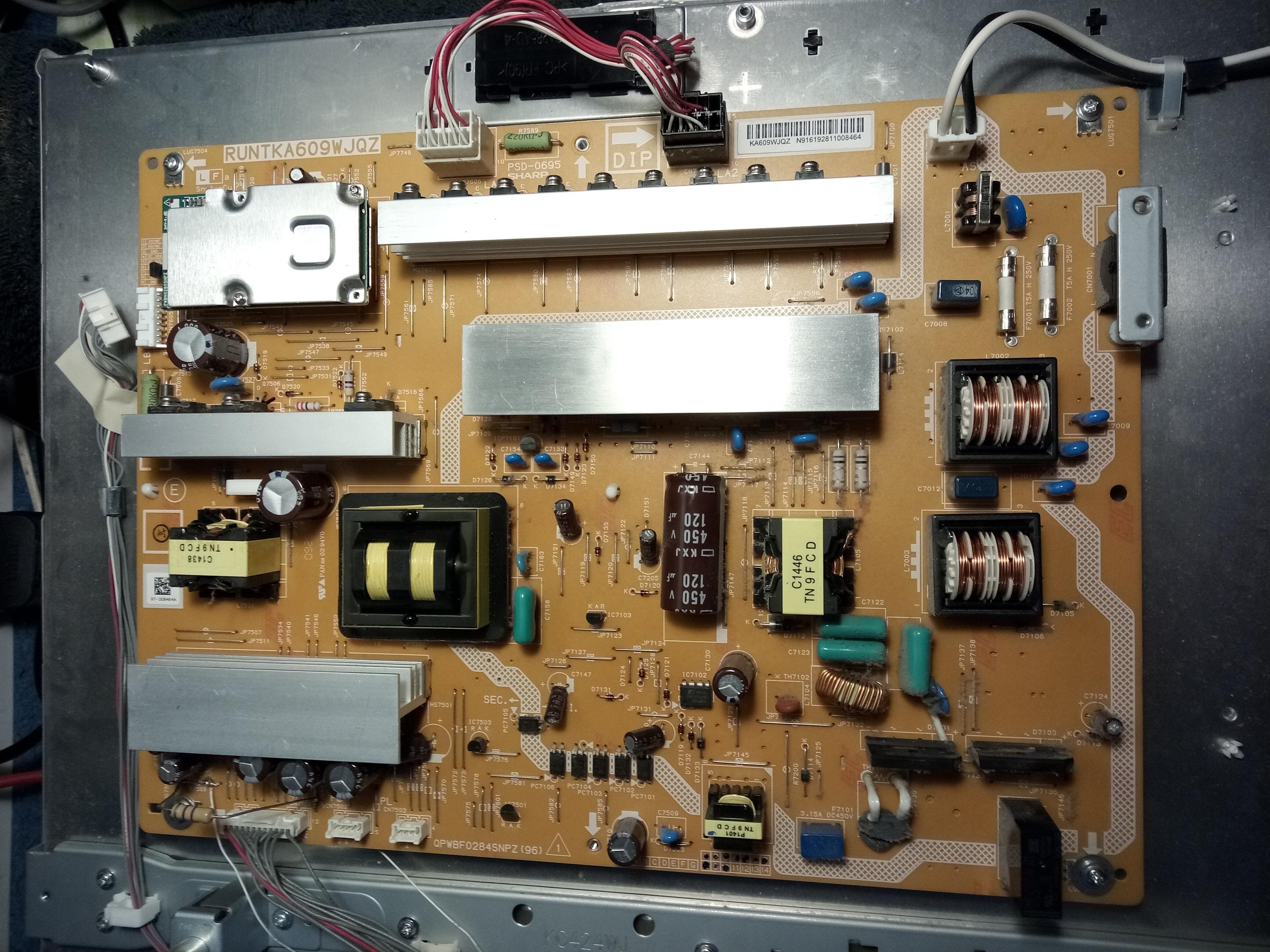

          my board has two plugs feeding the strips one with 10 connections one with 8 connections
          i found d7519 s/c across it
          its a zener .
          lifted one end and diode is good
          my psu is RUNTKA 609WJQZ

              • R_J
                • Jun 2012
                • 9579
                Re: sharp LC40ELE 600E standby only faulty backlight
                I suspect your meter is not reading the voltage across the led's correctly, The drive for the leds has a high frequency component and your meter is reading that as well as the dc value.

                            with psu forced on and p on fed with 5v
                            theres no bl-on from cn7603 pin 2 .
                            so q7509 and q7511 (b/l switch ) off.
                            so no boosted vled volts from q7506
                            the v led volts across c7528 is the same as across c7625.
                            the 13v supply to ic 7506 pin6 is present
                            any thaughts please
                            i keep trying to enter s mode with no luck
                            im wondering if i should try a f/w update this may then allow s/mode entry
                            do you think that may work?

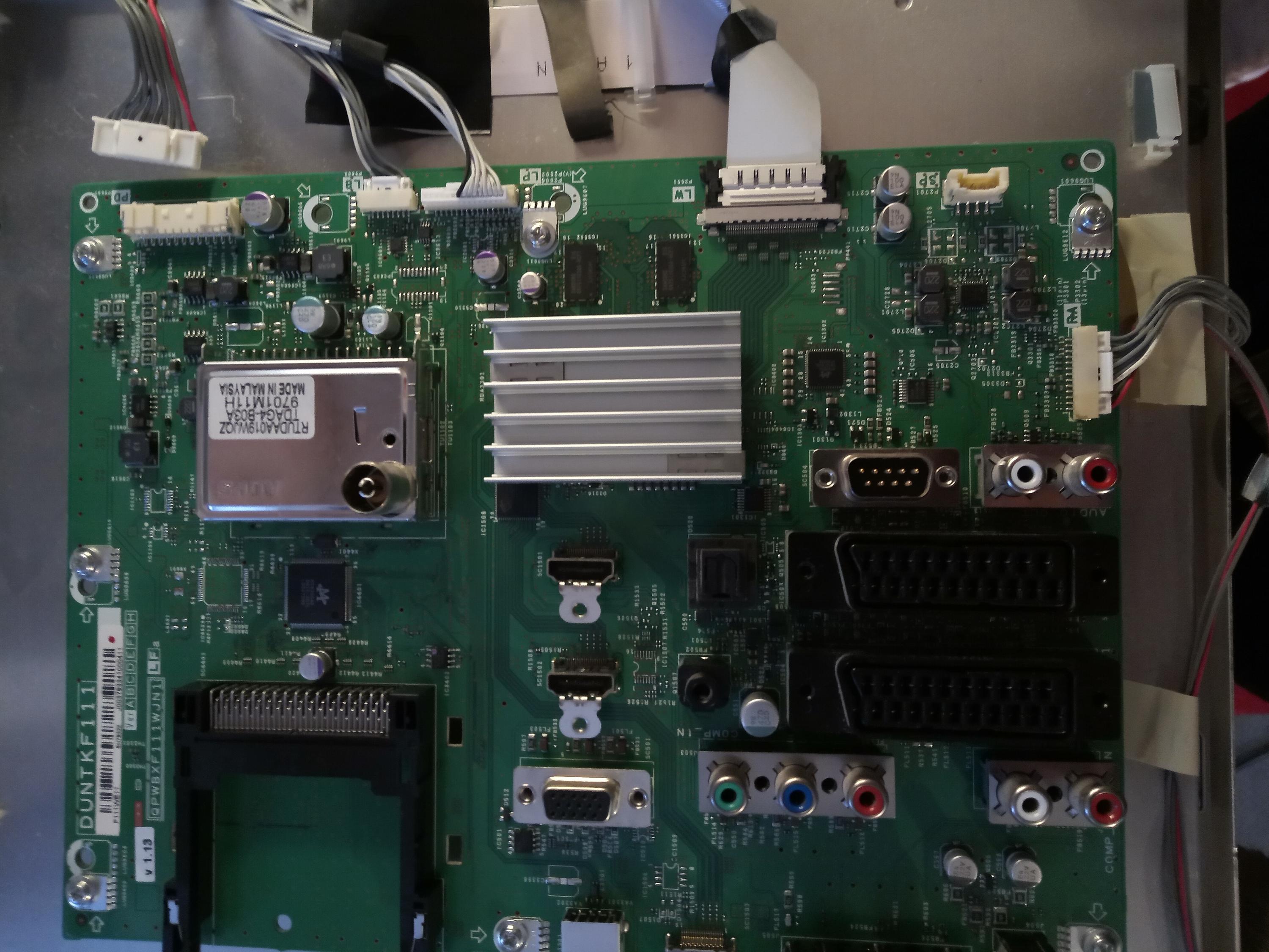

                            • Yanleb
                              • May 2017
                              • 102
                              When you power on the TV set, do you see at least an attempt to power on the backlight? If yes, there's still something the LED driver doesn't like.
                              If you plug in the TV set and it immediately starts to blink the lamp error code, then it likely reached the 5 tries and it is now locked indefinitely in the lamp error mode.
                              You already found my thread about another Sharp TV set stuck in the lamp error mode:
                              https://www.badcaps.net/forum/showthread.php?t=98411
                              On my TV set a sub processor was handling the lamp error, and this error can be cleared by erasing the small eeprom attached to it (IC2004). The difference is that your TV set seems to have the lamp error detection in the main processor, not in a sub processor. This means that erasing the eeprom will clear a lot more data than it did for me.
                              As you said in my thread it seems that the eeprom to erase in your case is IC8455. I would suggest that you backup its content before erasing it. In the case it doesn't solve your problem just restore its content. The BR24S64F is available here: https://www.mouser.co.uk/c/?q=BR24S64F
                              Or you can probably substitute it by another 24C64 compatible eeprom if you don't want to erase yours (after backing it up).
                              Another option is to look around for an eeprom dump of IC8455. You can also make a request for it in the eeprom dump section of this site.
                              As a last resort (I did it a few times), just buy a replacement board from eBay, backup the content of IC8455 and sell back the board on eBay. Just confirm with the seller that the board is indeed working and was not removed from a TV set with a backlight issue.
                              You will lose the shipping fees but it is not that bad. Just be kind and upload the dump file to help people in the future.
