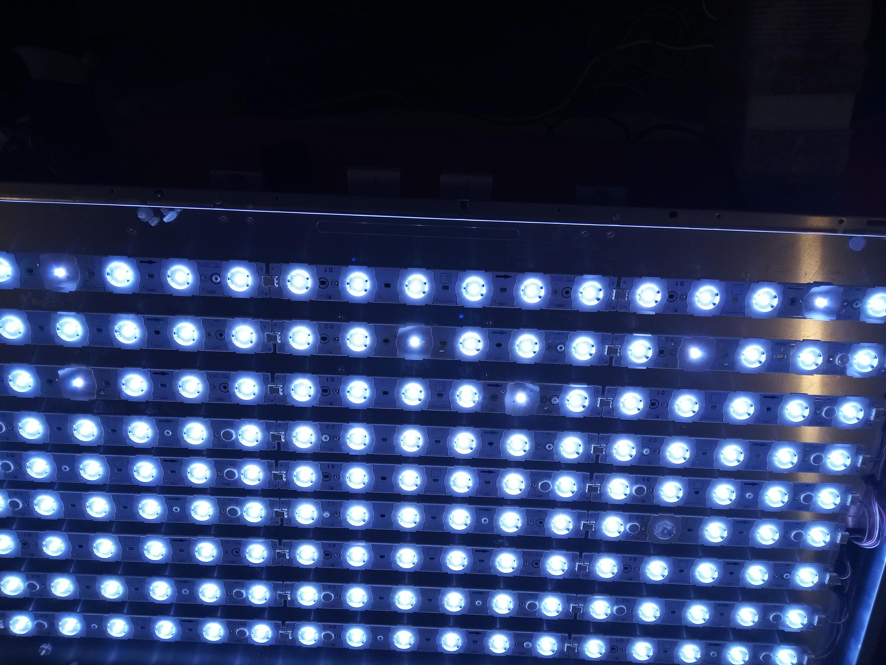

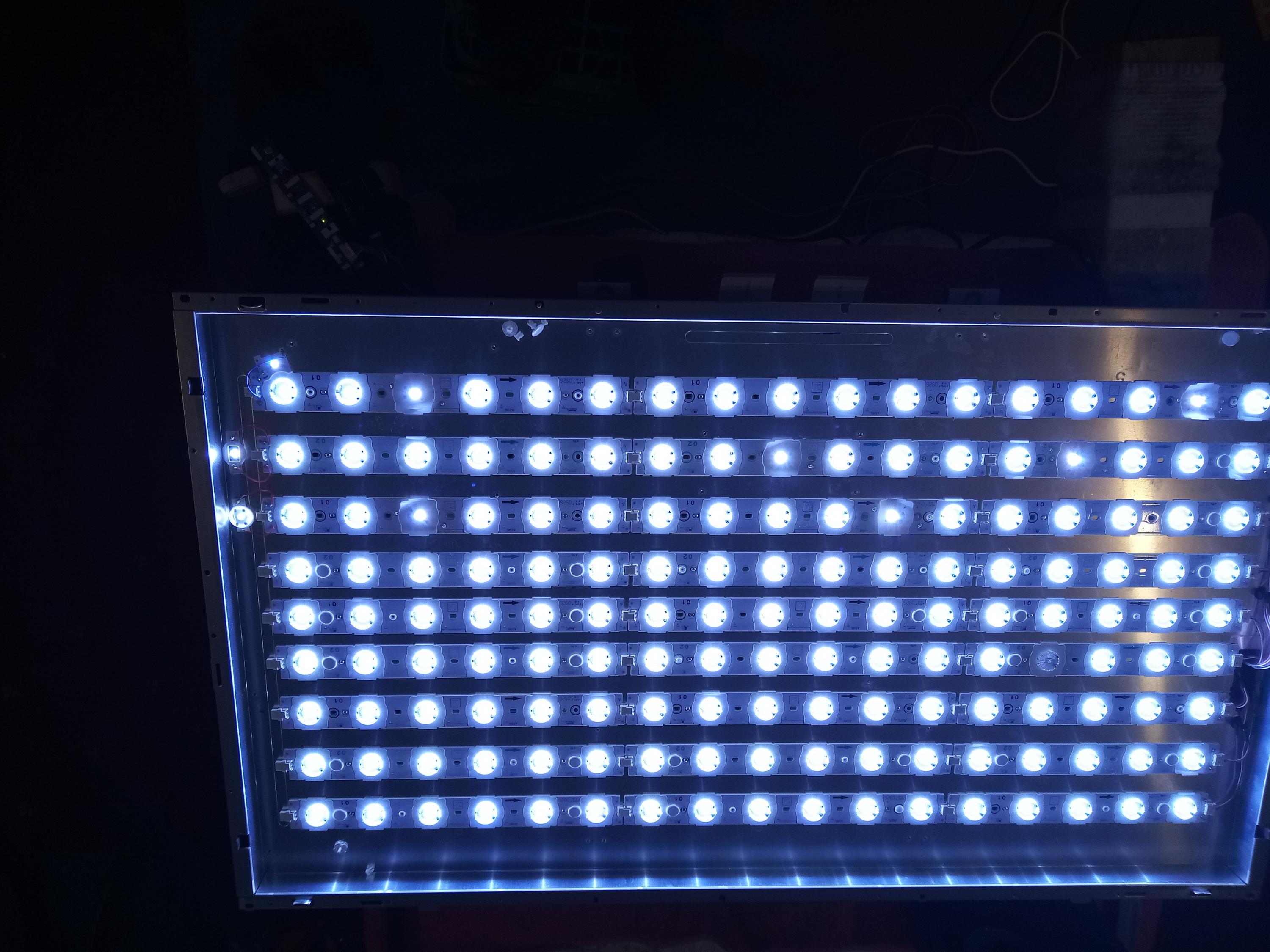

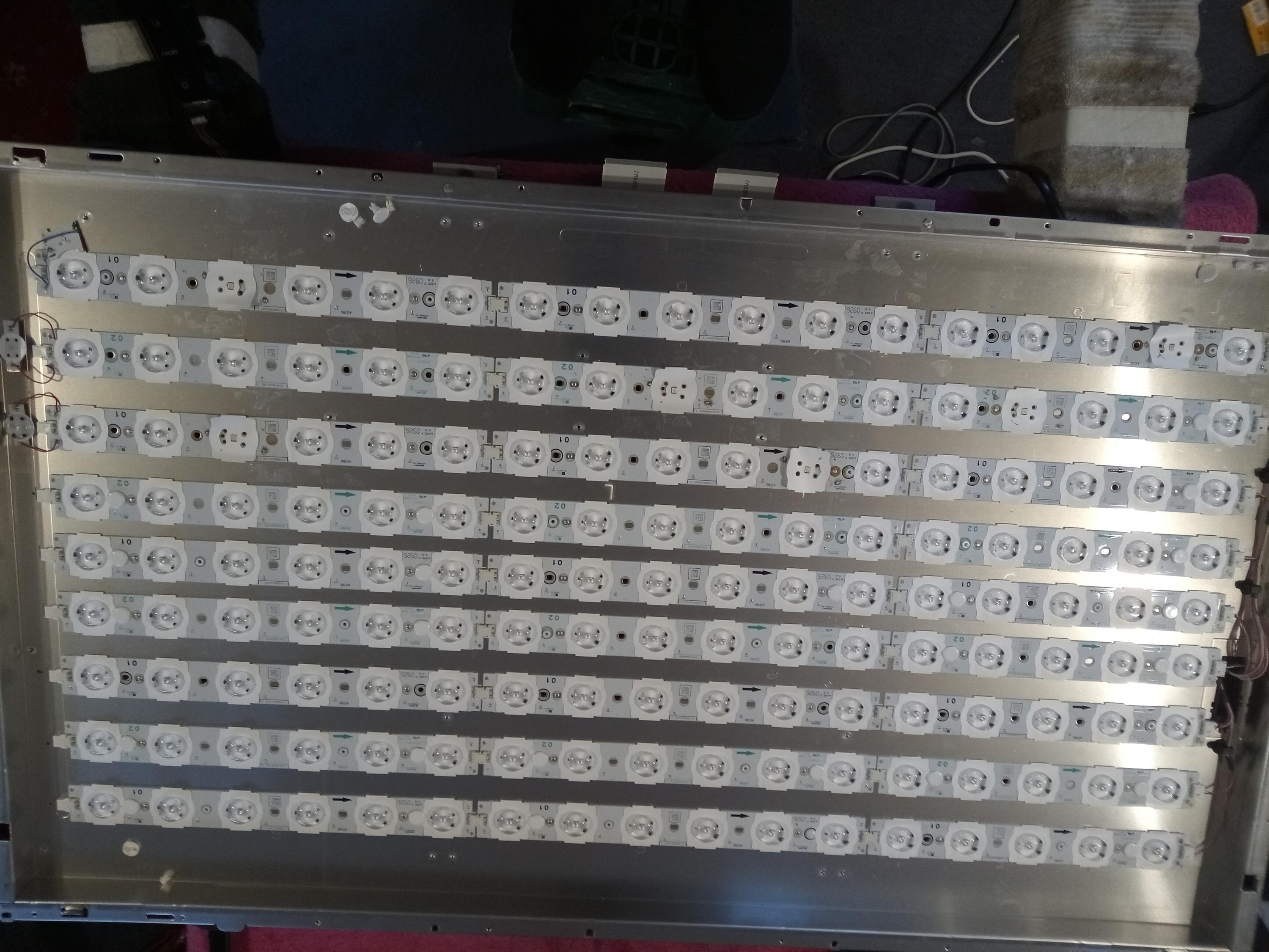

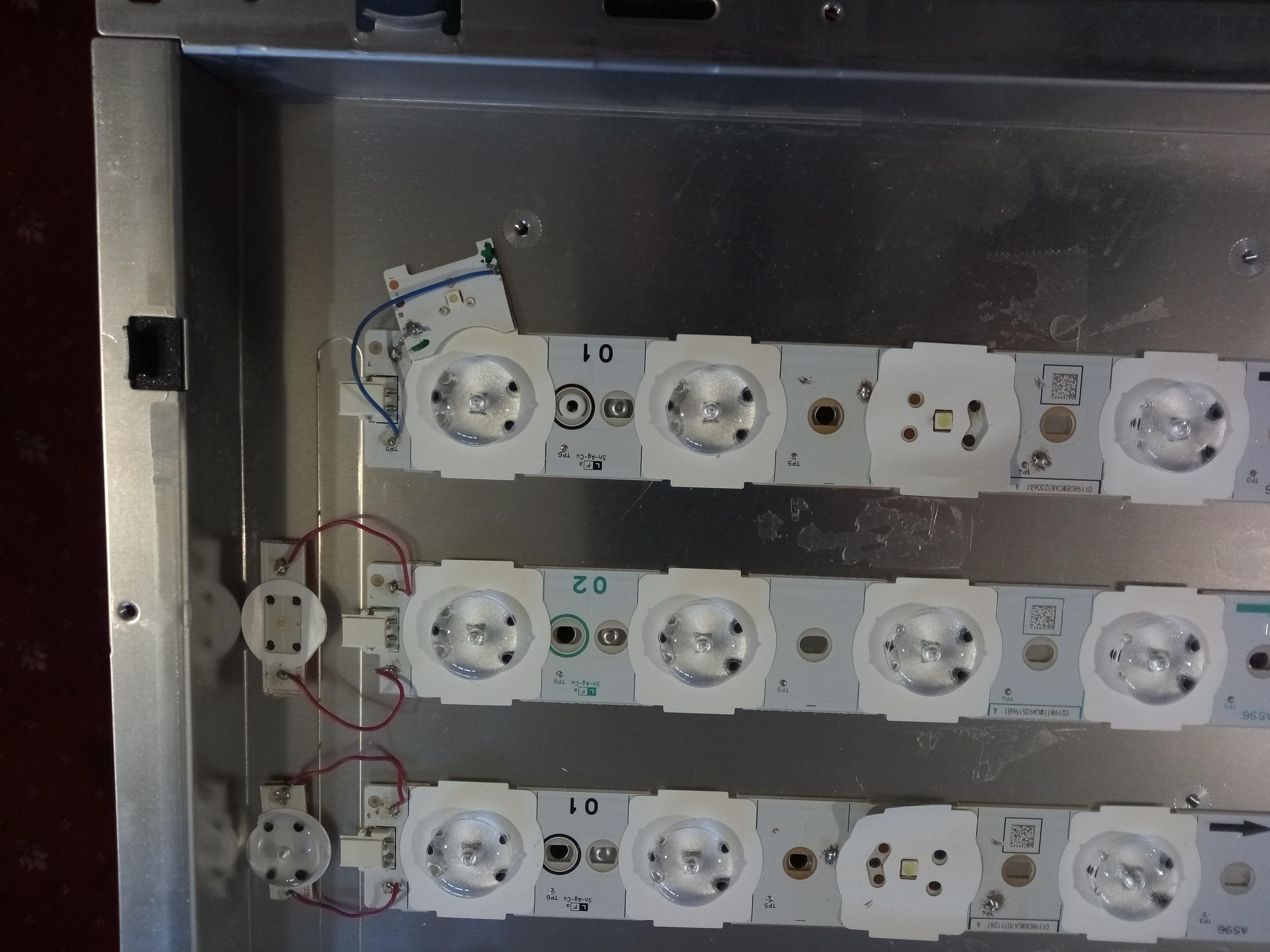

            PROGRESS the 9v leds arrived from China .once replaced ,yes you guessed it same symptom
            and still refusing to enter s mode
            so i removed one of the original strips ,and one of the repaired ones, then fed them from b/l tester to compare volts and current drawn (on test bench)
            there was a 3v difference .
            the repaired strips were 170v
            the original were 173.2 v
            just as experiment i added one 3v led to each of the repaired strips
            and now i can enter s mode
            i have to tidy up strips and glue lenses back on and will run it for hours before refitting screen ,then im hoping i can clear the lamp error detection
            the original leds when tested in tv (not with b/l tester ) have 10v across them and the replacements have 8.9v this makes me think that the original ones are 10v not 9v .
            for the cct to work properly each strip must draw the same current ,and have same volts across .
            and its a very sensitive design that compares each of the 9 strips im now taking a break from this headscratcher .but will update final results ive just noticed one led not lit ,i will look into it and post back
            i may try to buy some 10v leds if they are available.as i dont like giving up
            • jimbofz
              • Apr 2013
              • 537
              • uk
              Re: sharp LC40ELE 600E standby only faulty backlight
              one of the replacement leds decided to go s/c
              just replaced it ,maybe ,me being an optomist ,
              i may have heated it up too much when fitting
              tv now comes in and out of sby no problem ,its now ot soak test
