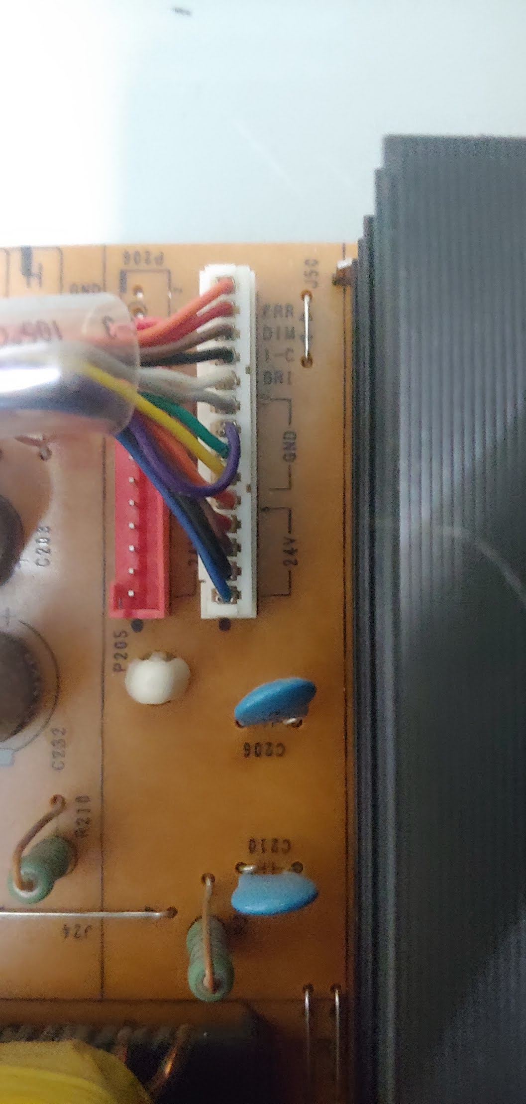

    LG 37LC50C Turns on then off

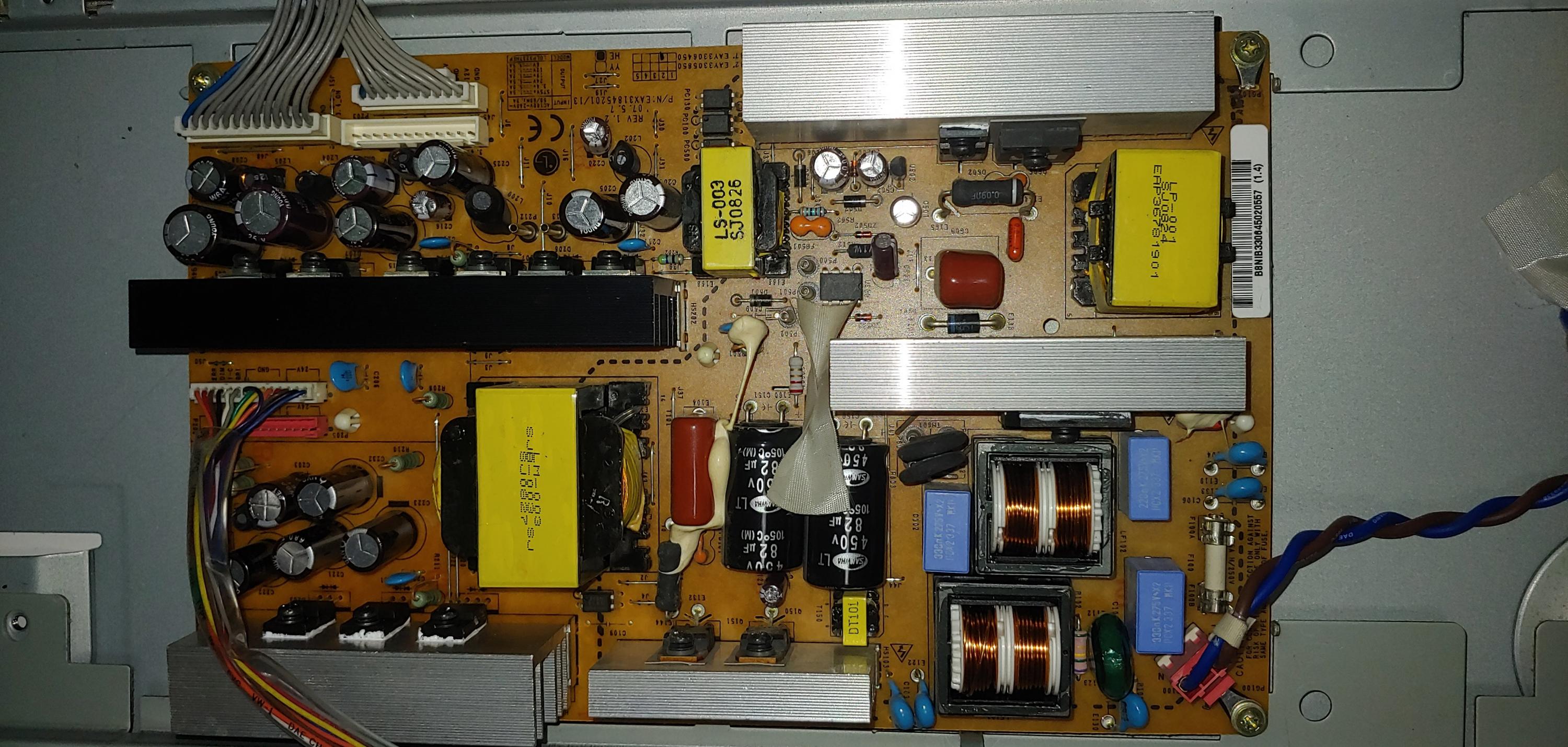

    I have a lg tv here that is one of those commercial tv units. It will power on make a staticky sound then shut off. It does display a picture then it just shuts off what can I do? The psu has good standby voltage as well. I'm wondering if the lamp is dead possibly?

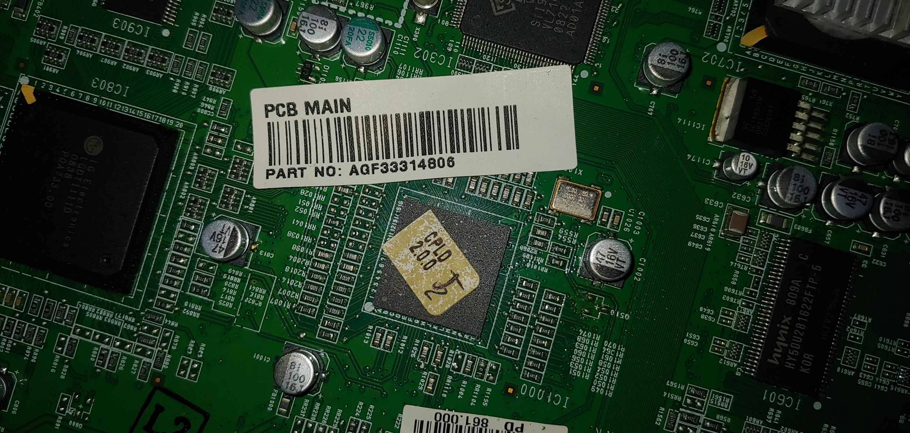

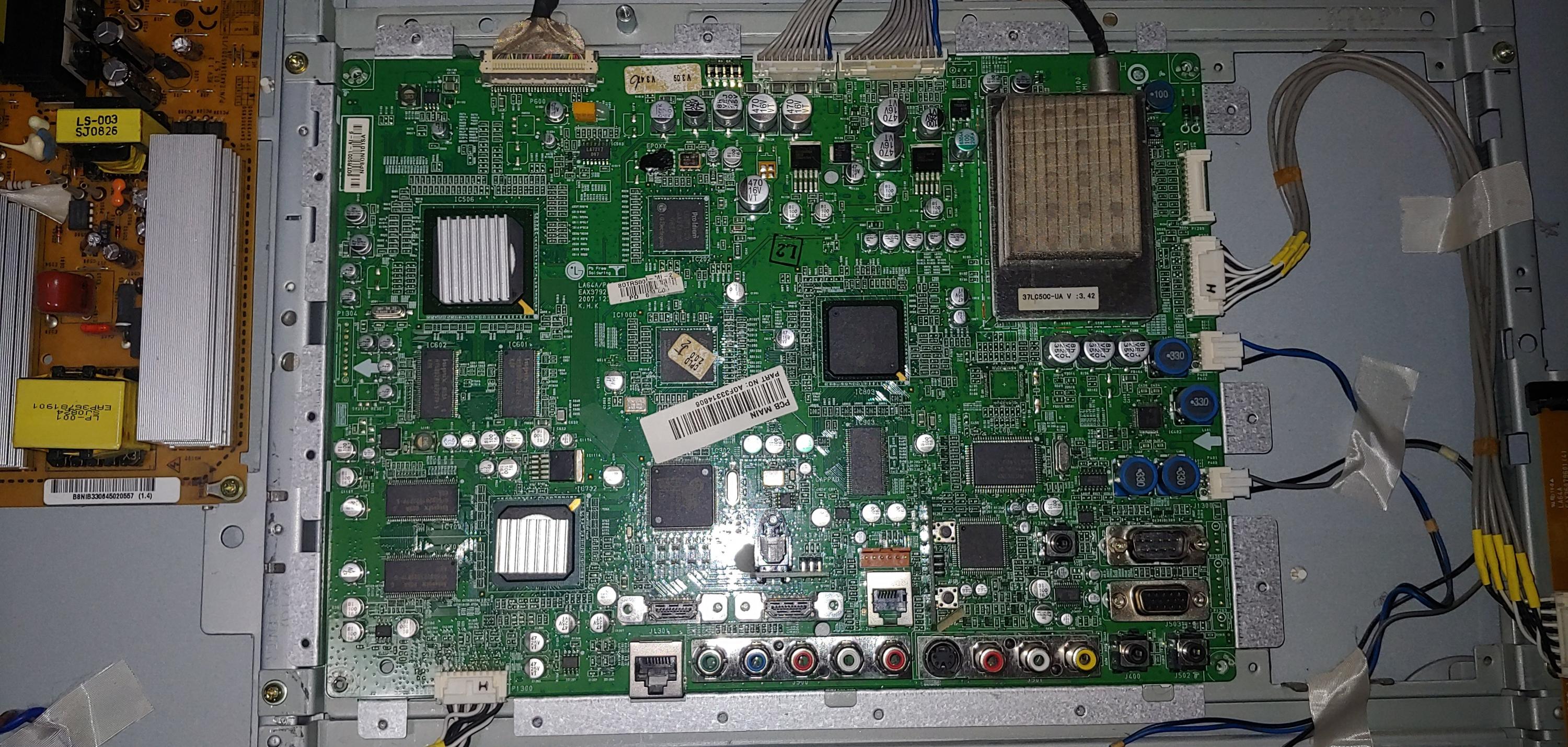

    I think the motherboard has a issue because when I was probing the psu connector accidentally shorted ps_on with 5v standby and it kicked on no issue. I imagine some bga/capacitor issue on mainboard. I'm buying a new motherboard and will report back.

      So I replaced the motherboard to have it do the same thing now I'm thinking it's the backlight inverter is there anyway to test these things.

        Re: LG 37LC50C Turns on then off

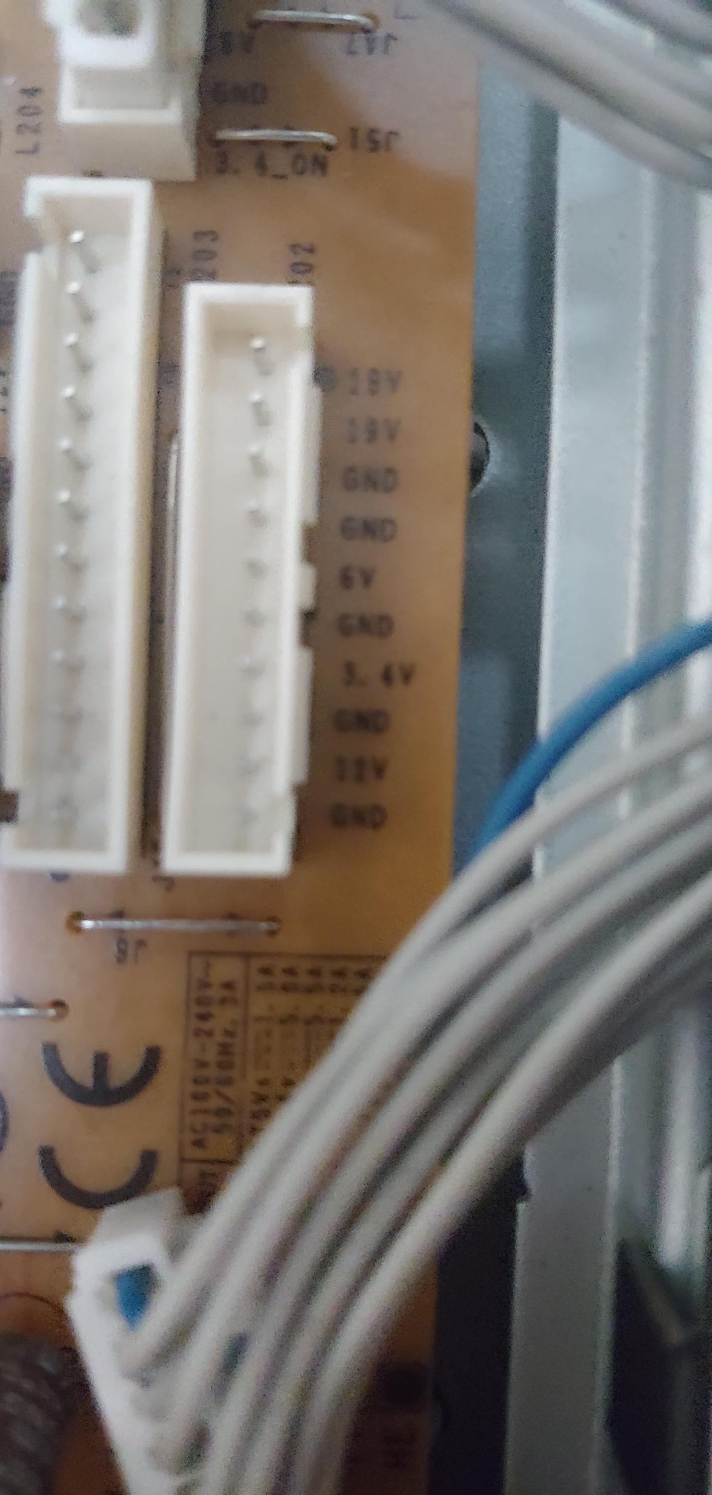

        Did the backlight work with the ps-on test?
        Report the voltages on the inverter cable, 24V and bri, dim and the other two.
        • Super360
          • Jul 2016
          • 243

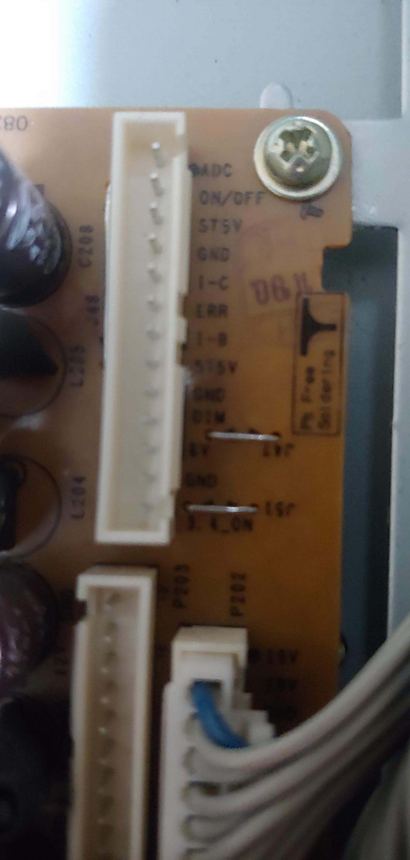

          Yes the backlight turns on with ps_on test.
          ADC= 4.18V
          ON/OPFF= OFF MODE=0.0051V DC 2.74V IN ON MODE
          5T5V=5V
          5T5V=5V
          5V= 0.500V
          3.4_ON= 2V WHEN POWER IS ON 0.055V WHEN OFF
            18V=18V WHEN POWER IS PRESSED ON. 7v when power is off
            18v=18V WHEN POWER IS PRESSED ON. 7v when power is off
            6v= 6when power is on 0.700v when power is off
            3.4v= 3.5v when power is on 0.700v when power is off
            12v= 1.300v when power is off 12 volts when power is on
            • Super360
              • Jul 2016
              • 243
              dim=3.3v when power is on 0v when off
              i-c=5v when on 0v when power button is off
              bri= 1.69v when on 0v when off
              All the 24v are 24v when the power button is pressed on 0v when off
              • Biruslapio
                • Nov 2013
                • 552
                • Brasil
                The voltages are fine except for the 5V pin. You must have noticed that too, Now I do not know if it's actually used by the TV, since there's 6V going to the mainboard, trace to find its source on the PSU board.
                If the backlight stays on during the ps-on test it's not the inverter, the signals (bri, i-c, dim) that the mainboard is sending are normal.

                  Ya I cancelled the inverter theory and now I'm just gonna chuck a used psu into it.

                      I bought a repair kit for this psu. https://www.ebay.com/itm/tkit28-LG-3...-127635-2958-0

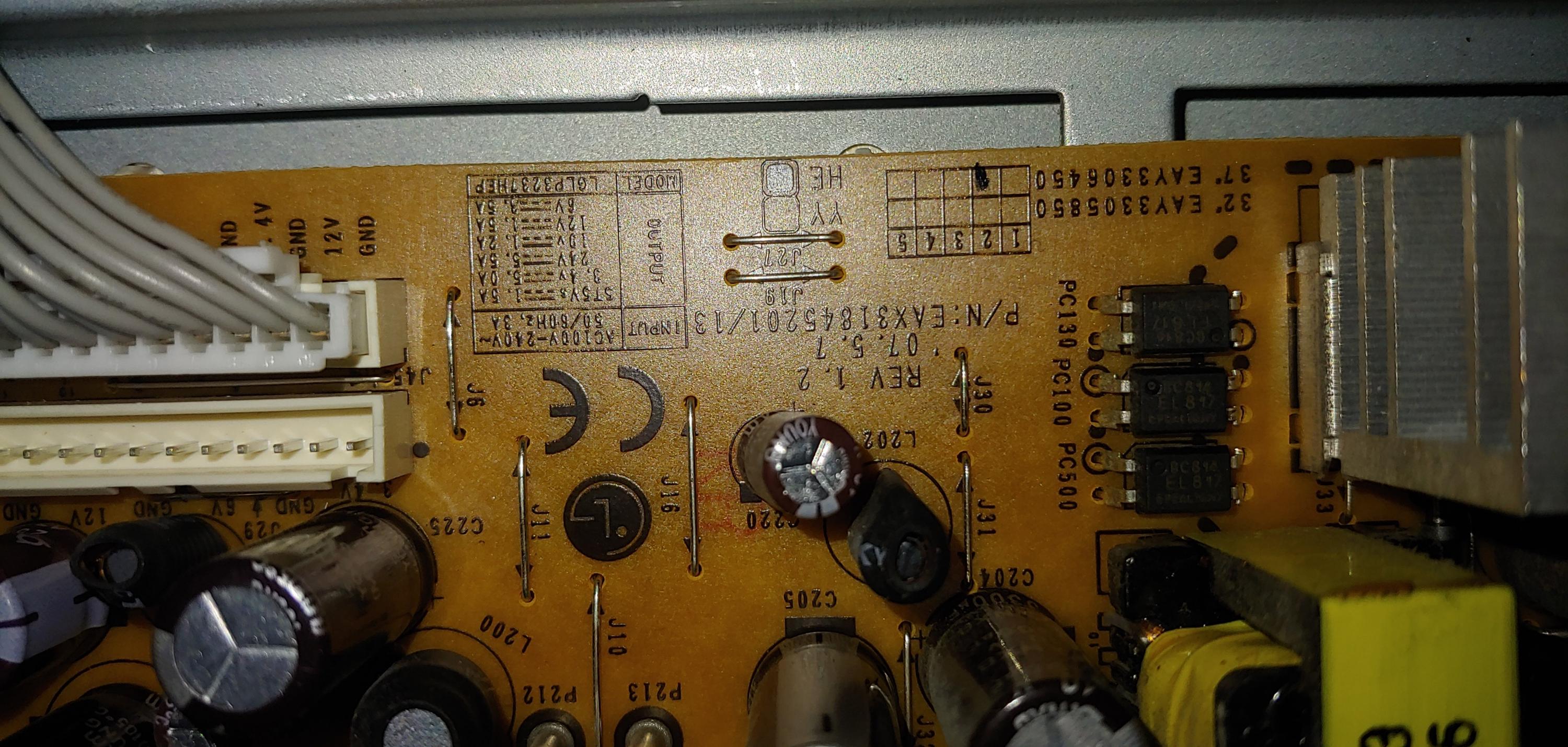

                        C204
                        C205
                        C221
                        C222
                        C223
                        C232

                            How i usually find whats in the repair kits and location of parts is too look on ohm supplies web site, kit kit103 is for your psu (good company i have used them a lot here in the uk)
