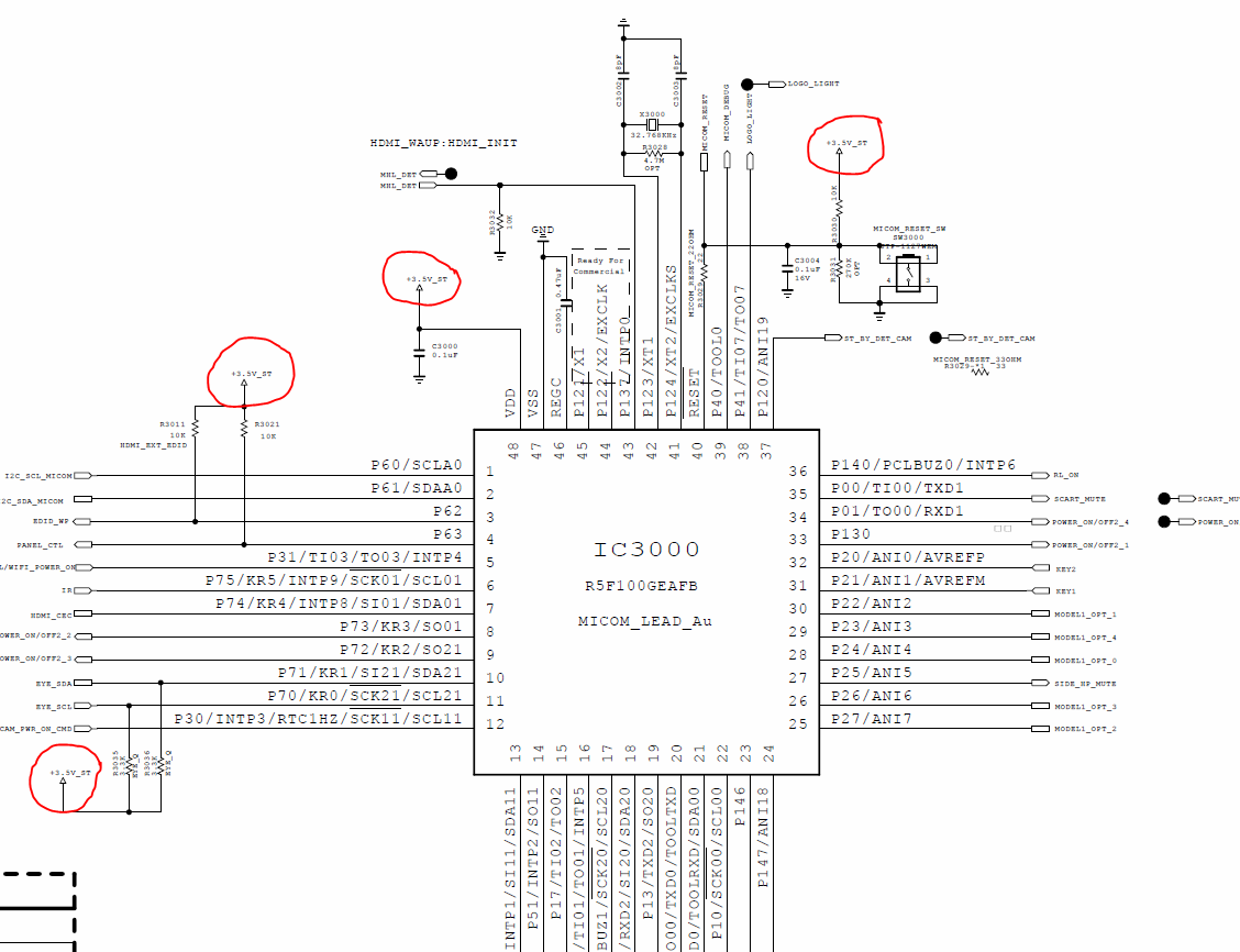

            • lotas
              • Jan 2016
              • 4554
              • Russia
              Re: lg 47LB585V help to identify ic please
              See the diagram for what else the standbay + 3.5v_ST bus powers

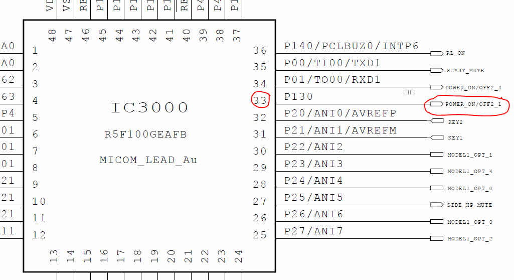

                  You may also have suffered a MICOM (standby controller and it contains the firmware that controls it) 33 pin. gives the command to turn on just on it.

                    #29
                    thanks for advice ,
                    but as tv works fine with 1.5v injected from bench psu
                    i assume ic is not making good contact ,
                    or i may have damaged it with too much heat
                    i have ordered another

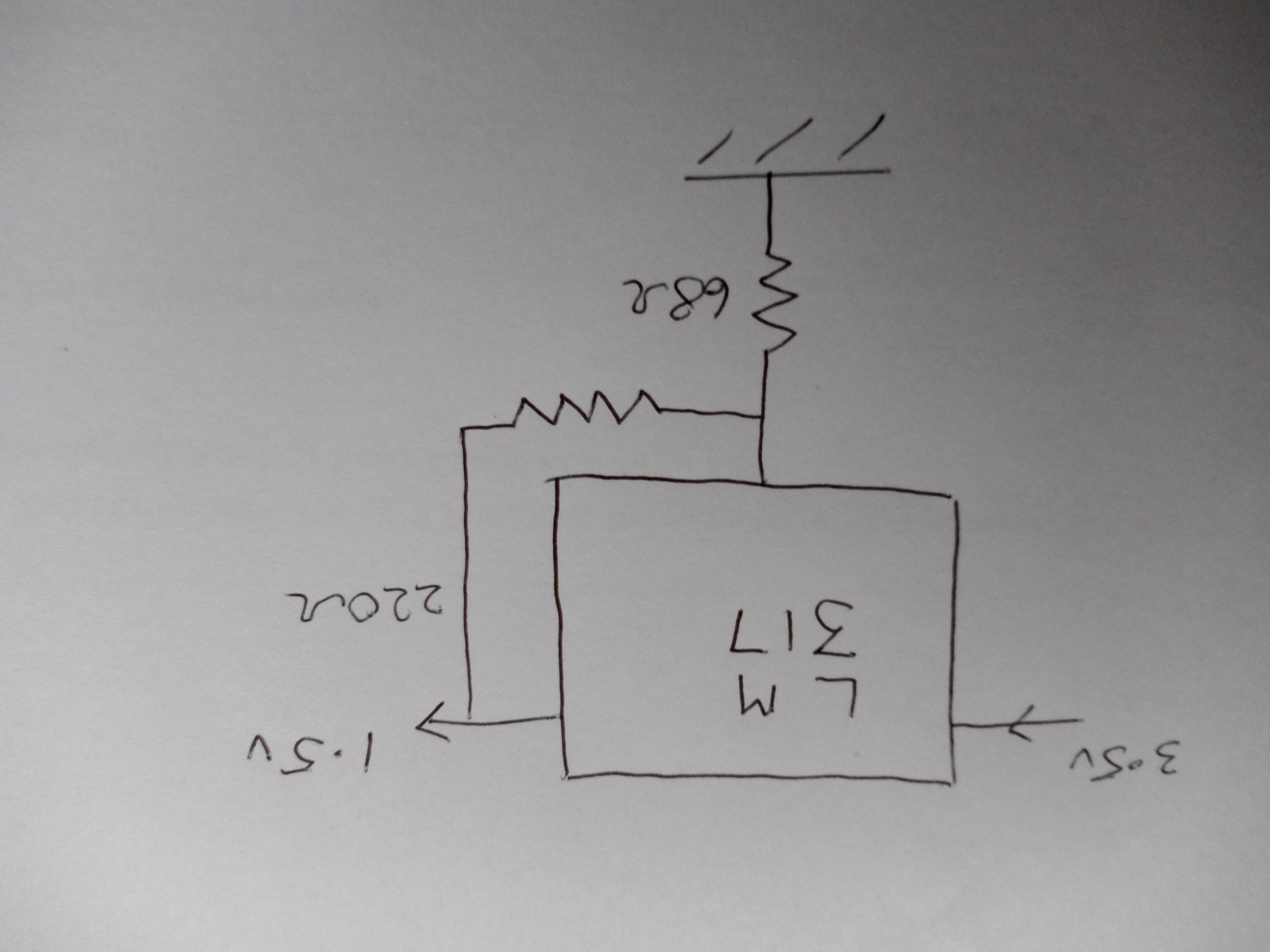

                    • jimbofz
                      • Apr 2013
                      • 539
                      • uk
                      #30
                      while i am waiting for chips to arrive ive been running tv with a LM317 as shown in pic
                      i know the original chip is rated at 3 amp and the lm317 is 1.5 amp
                      the 2 resistor values allow correct 1.5v o/p
                      i just wanted to confirm tv had no other problems ,and it seems fine.
                      the temporary reg only gets slightly warm
                      dont understand why pic is upside down?
