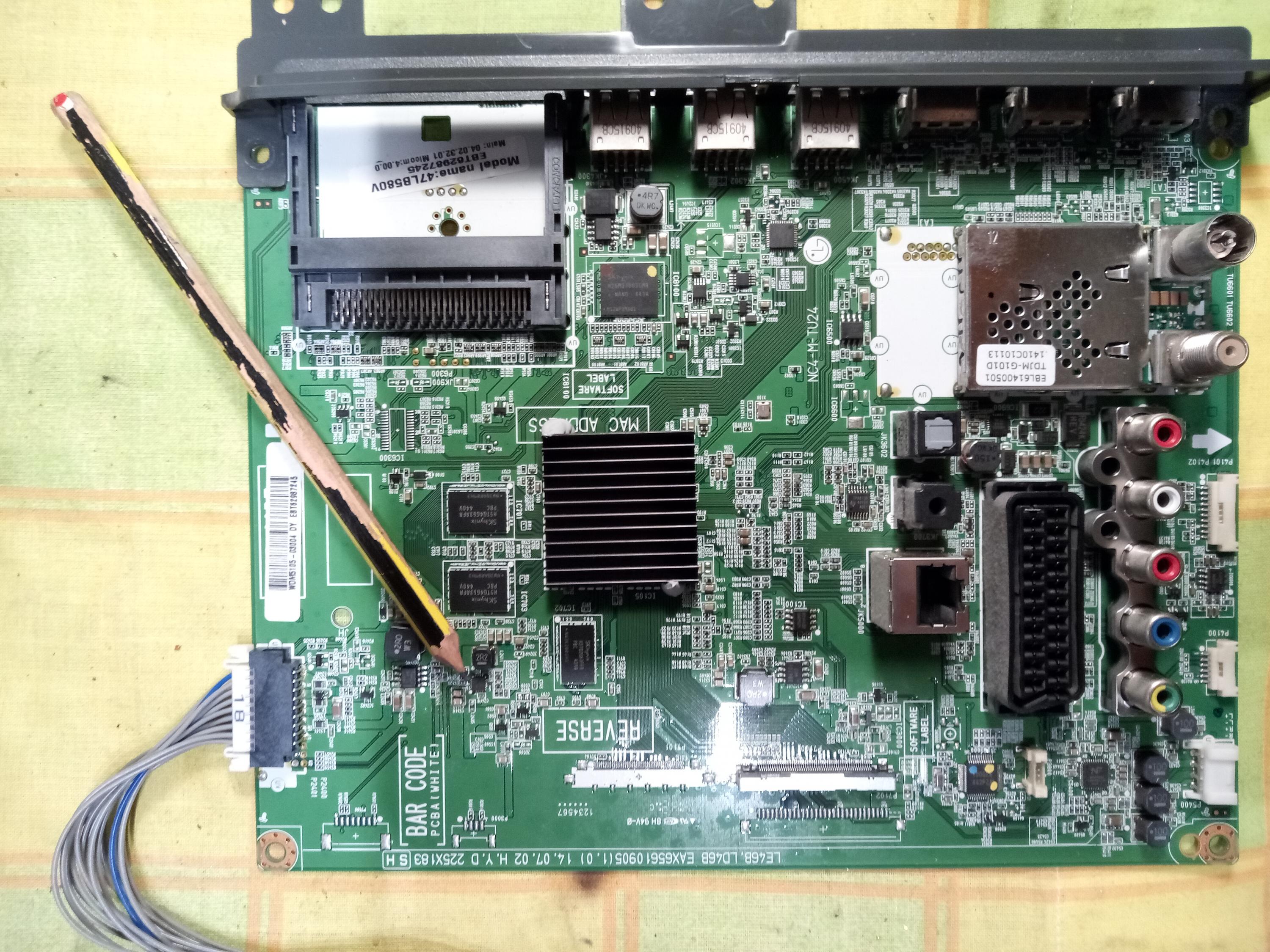

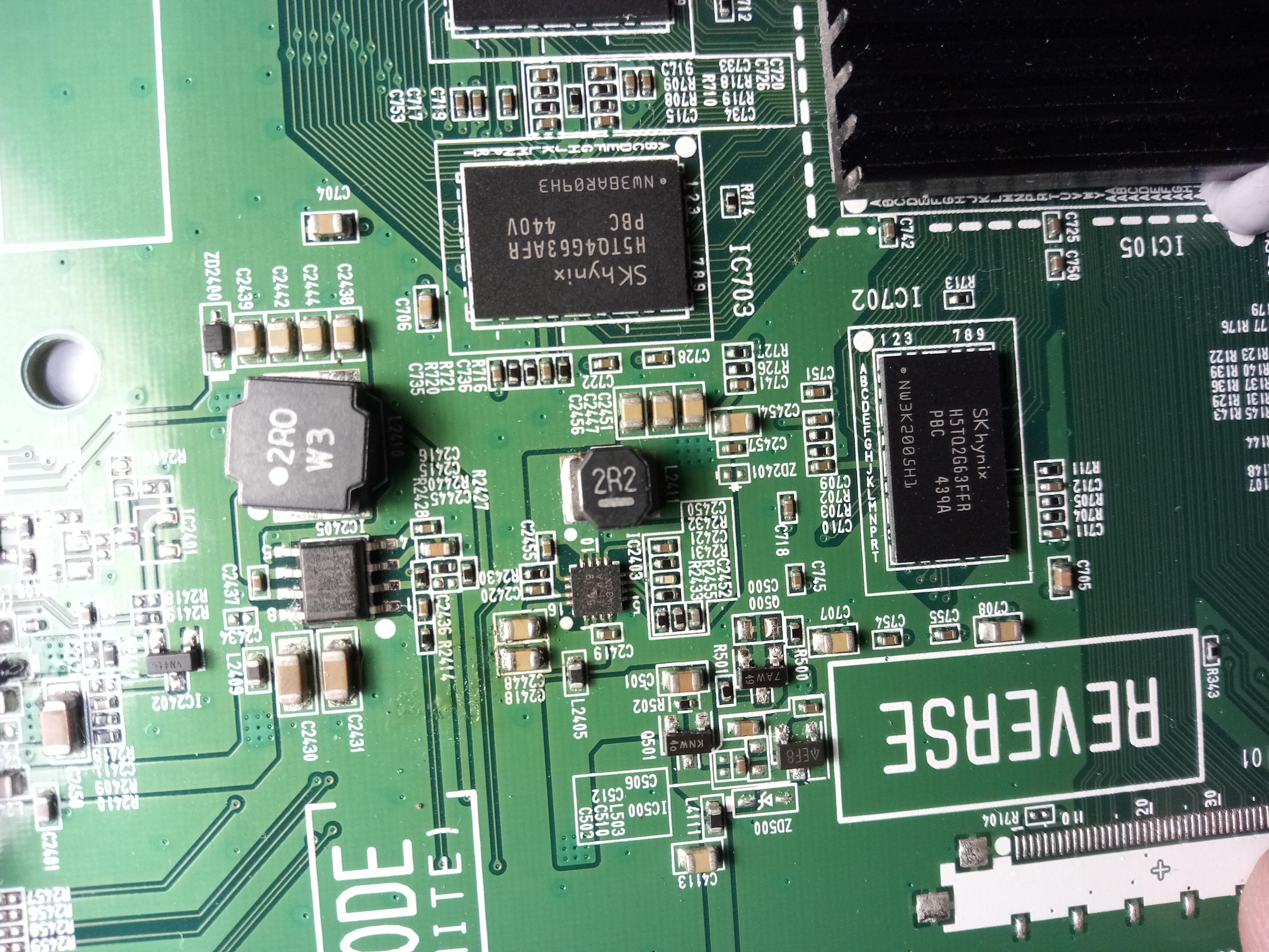

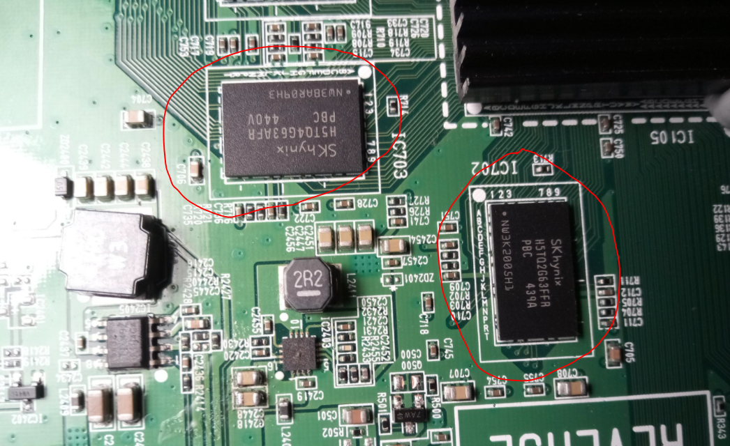

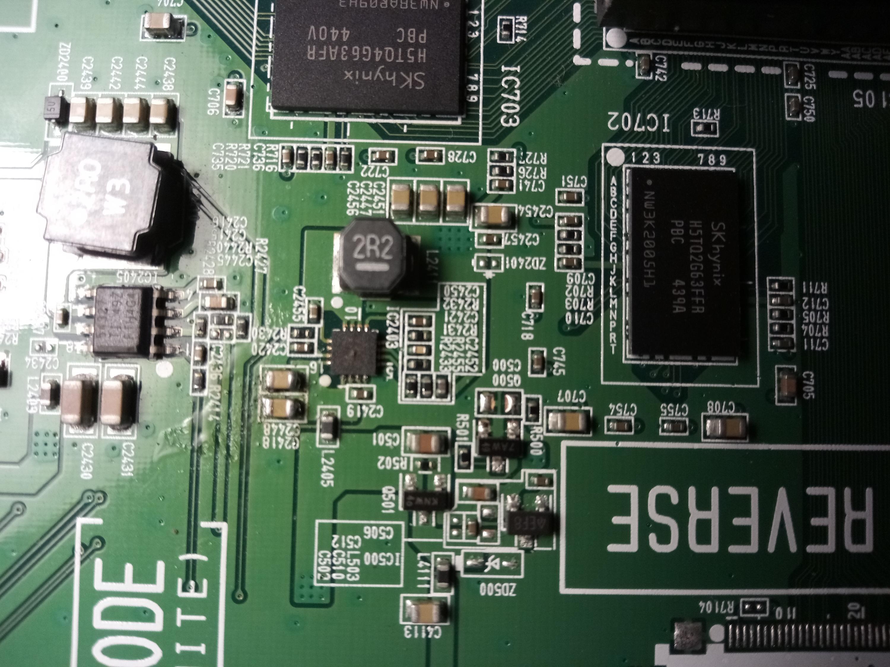

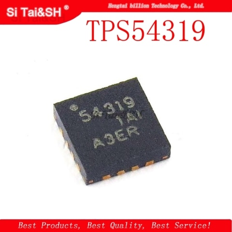

    Hi this lg has a rediculously small 16 pin ic on mainboard cooking
    causing brief flash of sby led then dead its the one next to a coil 2r2
    reference ic2403 i cant make it out looks like:
    5419
    0rAA
    A36X

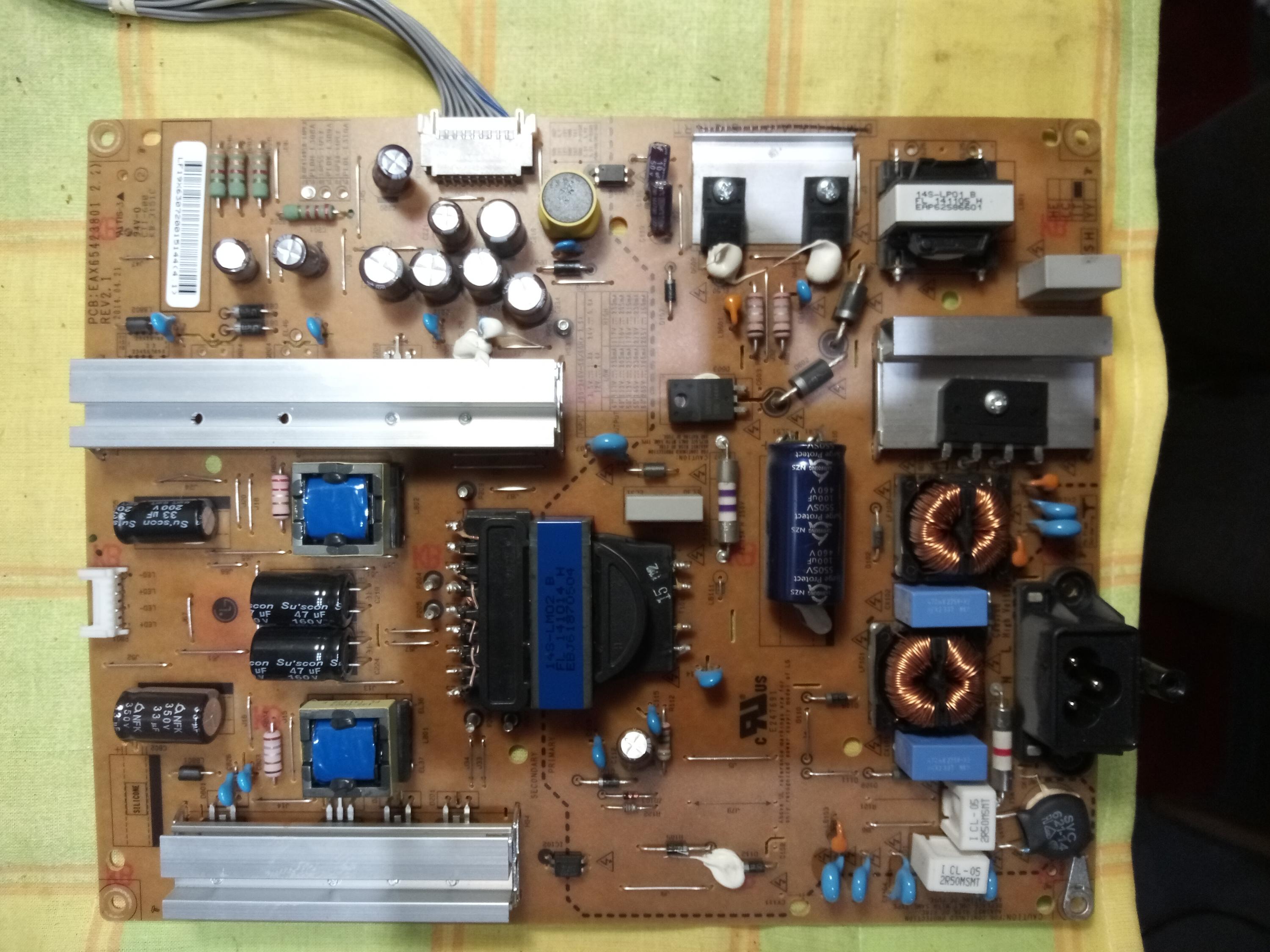

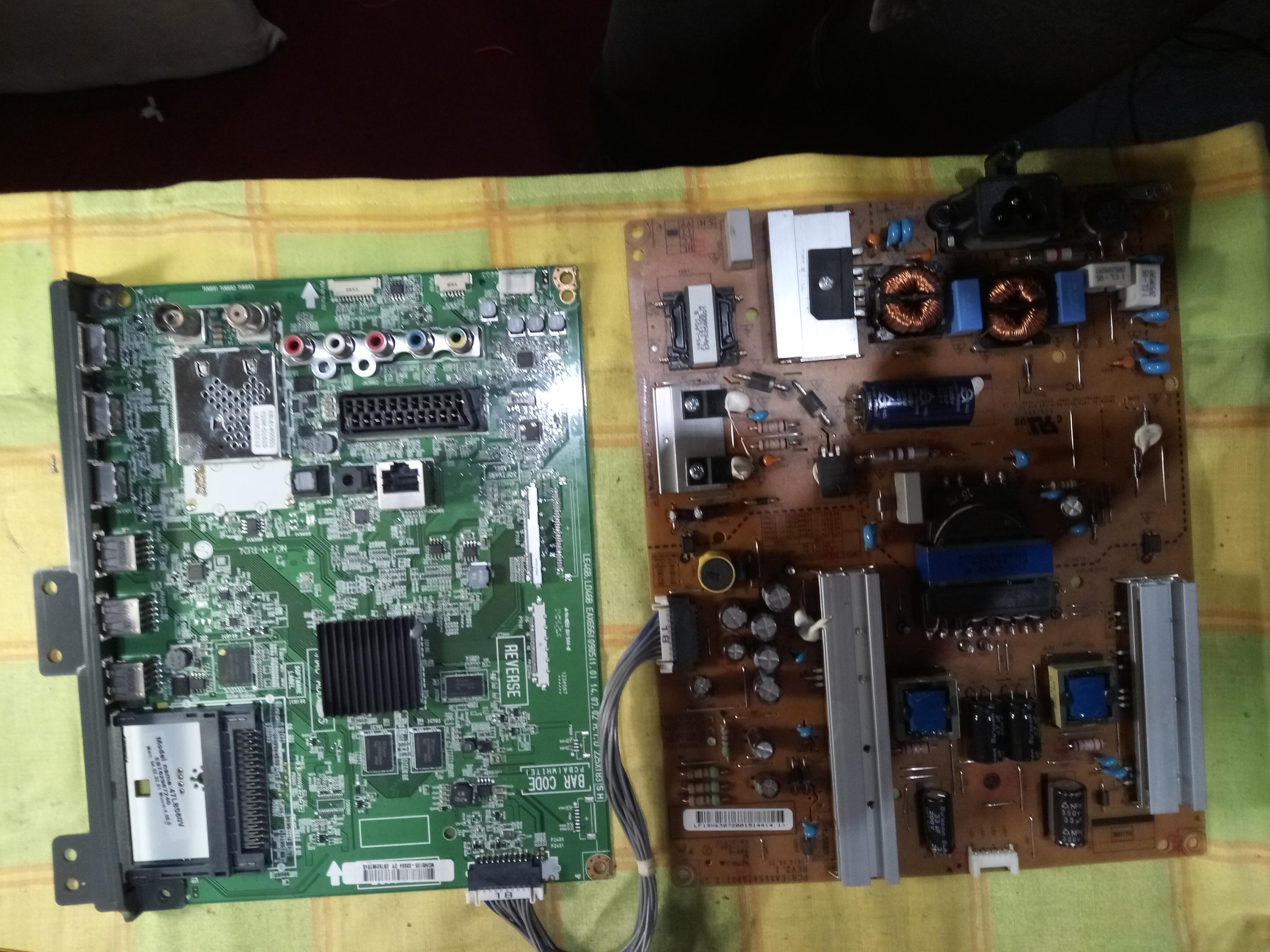

    this tv had bad b/l leds and i replaced all the strips with new
    they tested fine with led tester ,ifound the b/l controller ic s/c bl0202b and q803 s/c these were replaced but leds just flashed on for one second .

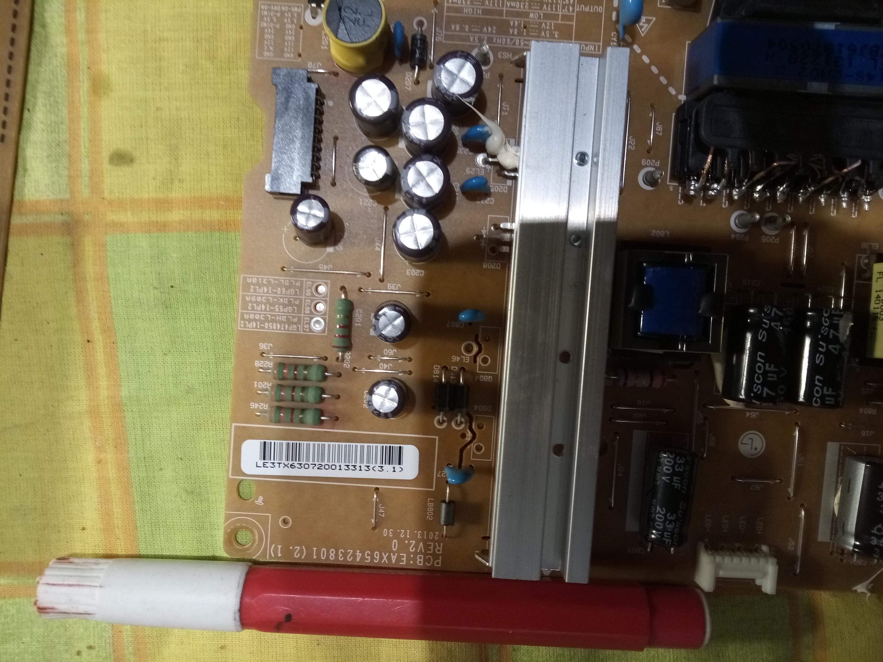

    to save time (big mistake) i ordered replacement psu from e bay
    when fitted it caused the mainboard problem grrr!
    now even my original psu wont start up
    ive tried to find cct for main board i can only find psu cct
    if someone can help me identify the ic or suggest why the rogue psu has caused the problem it would be a great help

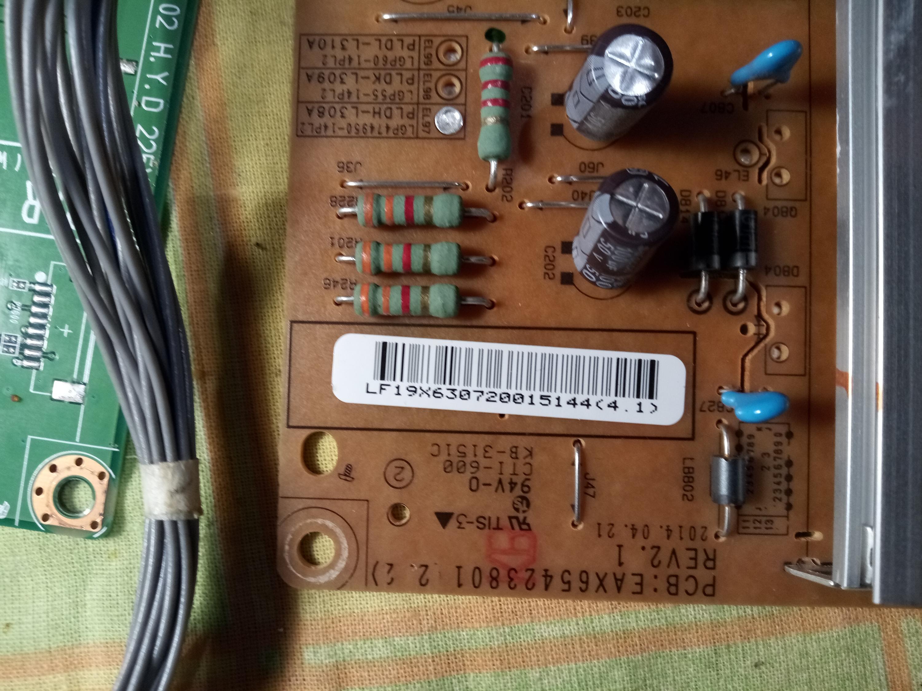

    the rogue psu is:EAX65423801(2.1)REV 2.0
    the original psu is:EAX65423801(2.2)REV 2.1

    Re: lg 47LB585V help to identify ic please
    ic2403 - TPS54319

      many thanks ,now i have somewhere to start ,
      i suspect ,as it gets hot.
      something external to it is drawing current through it

          thanks ,i have s/c on pins 1 and 2 to ground.
          im going to try to replace ,removal no problem with s station but fitting new will be a chalenge,
          im going to force on the psu without connecting main board and see if 3.3v supply is high ,do you think this could be the reason the ic failed?

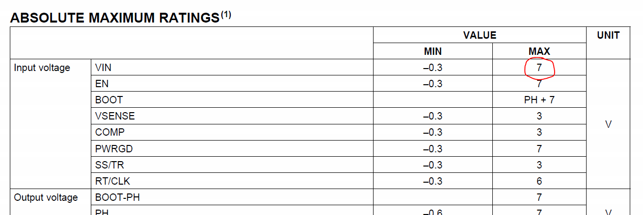

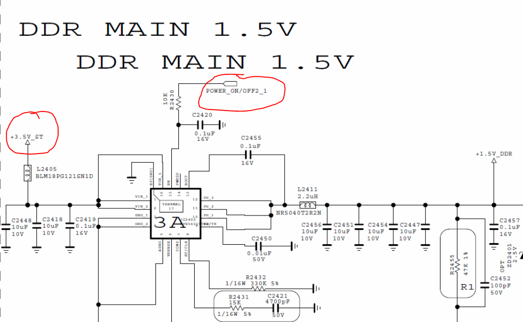

            If it exceeded more than 7v, then the IC could burn out.
            • jimbofz
              • Apr 2013
              • 539
              • uk

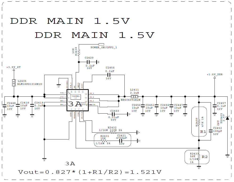

              not looking good .pin 10,11,and12 .the 1.5v o/p s/c
              so protection zener zd2401 was never fitted
              so any number of components could be s/c
              • lotas
                • Jan 2016
                • 4706
                • Russia
                1.5v for power supply of random access memory (DDR).
                  If you lift L2411 are pins 10, 11 & 12 still short and if not is the other end of L2411 showing the short.
                  • jimbofz
                    • Apr 2013
                    • 539
                    • uk
                    thanks for joining in the party mr b
                    when L2411 Lifted it measures 240 ohm .so not short but still a bit lower than i would expect ,what do you think?
                    • dick_barton
                      • Aug 2015
                      • 6643
                      • Wales
                      Are you saying L2411 has a resistance of 240 ohms or the output of the IC (1.5V ) to ground measured 240 ohms.
                      What is the resitance with the meter on one pad of L2411 to ground and again what is the reistance from the other pad of L2411 to ground both checked with L2411 lifted.
                      If the resistance of the IC2403, pIns 10, 11 & 12 is 240 ohms to ground then that would appear to be OK.
                        the o/p of the coil when lifted is 240 ohm to deck ie the 1,5v supply 240 ohm
                        the other side is dead short to deck i know the tps54319 is duff
                        but i would expect a much higher value on the 1.5v o/p side
                        the coil itself is fine very low ohms
                        • dick_barton
                          • Aug 2015
                          • 6643
                          • Wales
                          The 240 ohm reading would appear to be fine and is not a high load on the 1.5V supply
                                Originally posted by lotas
                                ic2403 - TPS54319
                                a question for lotas
                                do you know if:
                                0101
                                5173
                                is same device ?
                                ive found one on a panasonic tx-l32c5b main board
                                  do you know if:
                                  0101
                                  5173
                                  is same device ?
                                  "5173" - This is your G5173.
                                  Check datasheets. Your family should be marked "54319".
                                    wow thanks for quick reply
                                    it looks the same BUT its o/p is: 1.8v not 1,5v
                                    its markings are :0101
                                    5173
                                      5173
                                      Their output voltage is set by a resistor divider.
