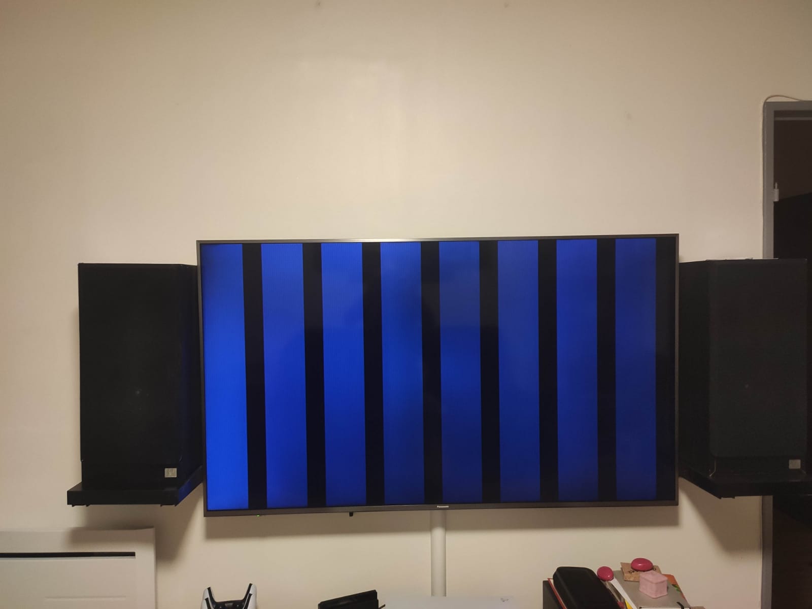

    Hello everyone.
    A friend of mine has a Panasonic TX-65x700.
    Since yesterday it shows the Following symptoms.
    Cold start, black screen, backlight works
    Restart, blue and black vertical bands ( always the same scheme), sound OK, no osd (see picture)
    Next restart, ok image and sound, stable.
    It looks like somethingnneeds to be a bit more heated to run properly.
    I was thinking to open the back, and heat with an hair drier one board after another to find the faulty one.
    Any idea or favorite place to look at.
    Thanks for advices.
    Jm

    Re: Panasonic TX-65x700 start problem
    I would start with power board. Look at caps for bulging tops.
        Problems with the el. capacitors are the past..It's more probably a bga soldering isuue or a dc-dc converter issue on tcon or frc.. post pictures of back with no cover, and each board except the power one, locate each possible dc dc conv. starting with the linears using datasheet, then warm them before turning on and see the image..

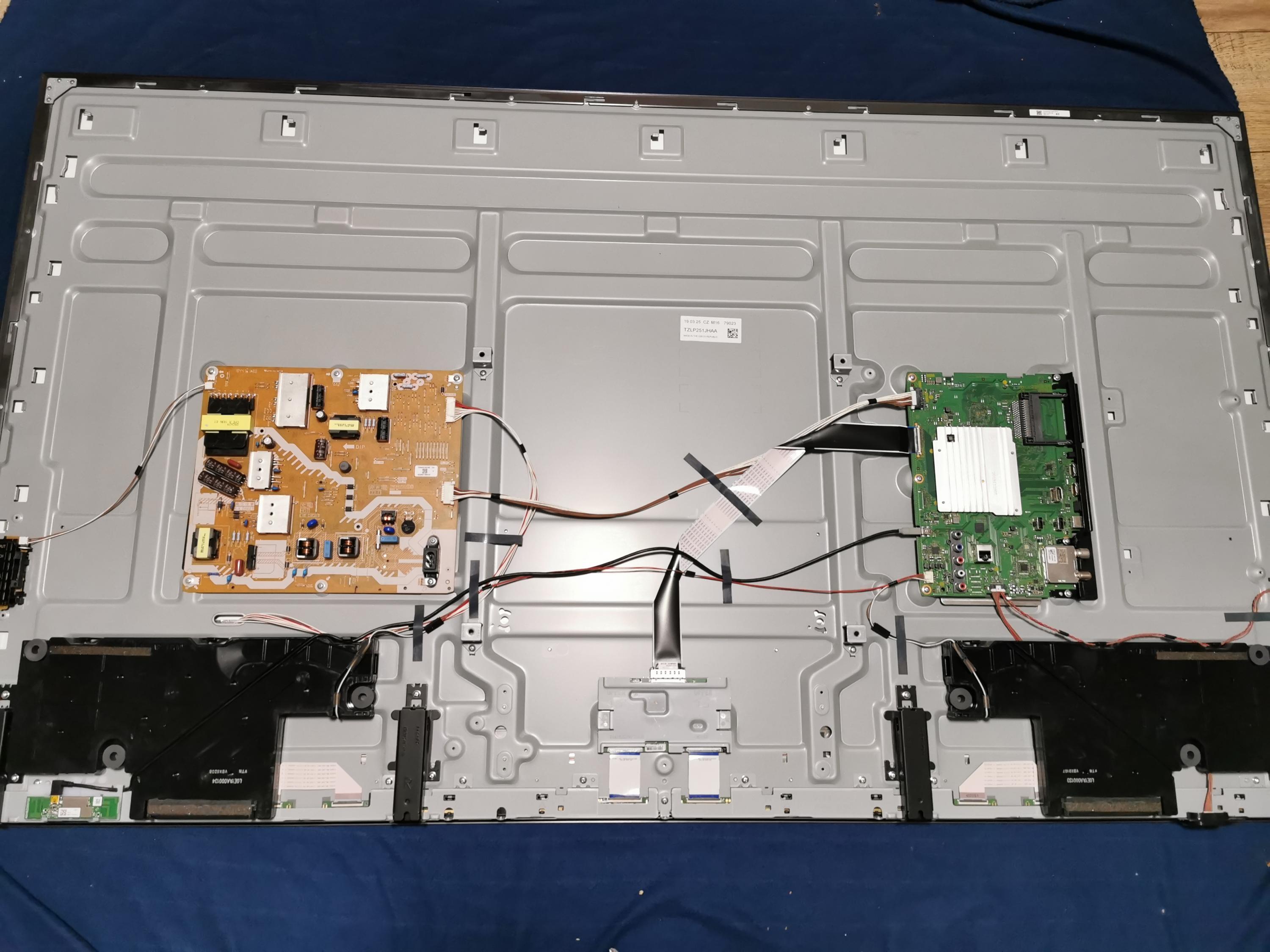

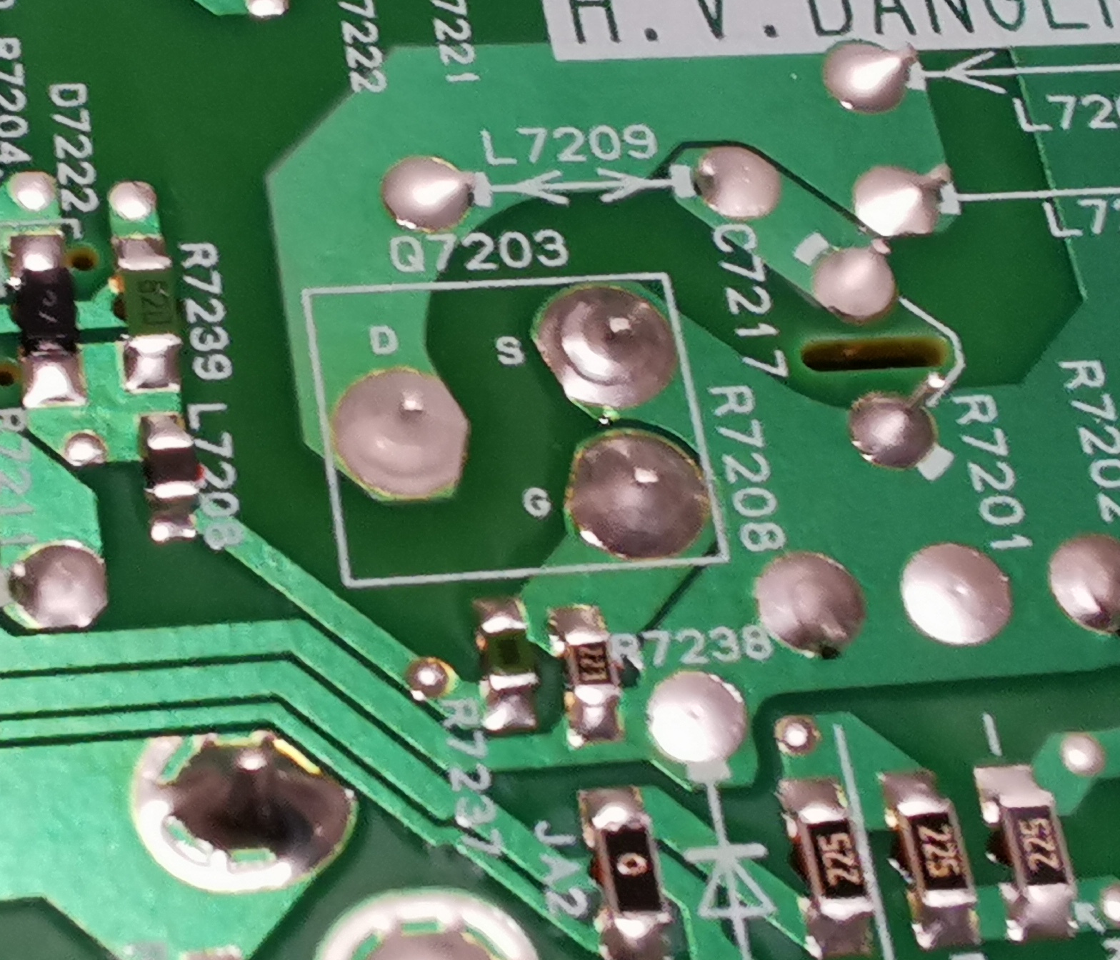

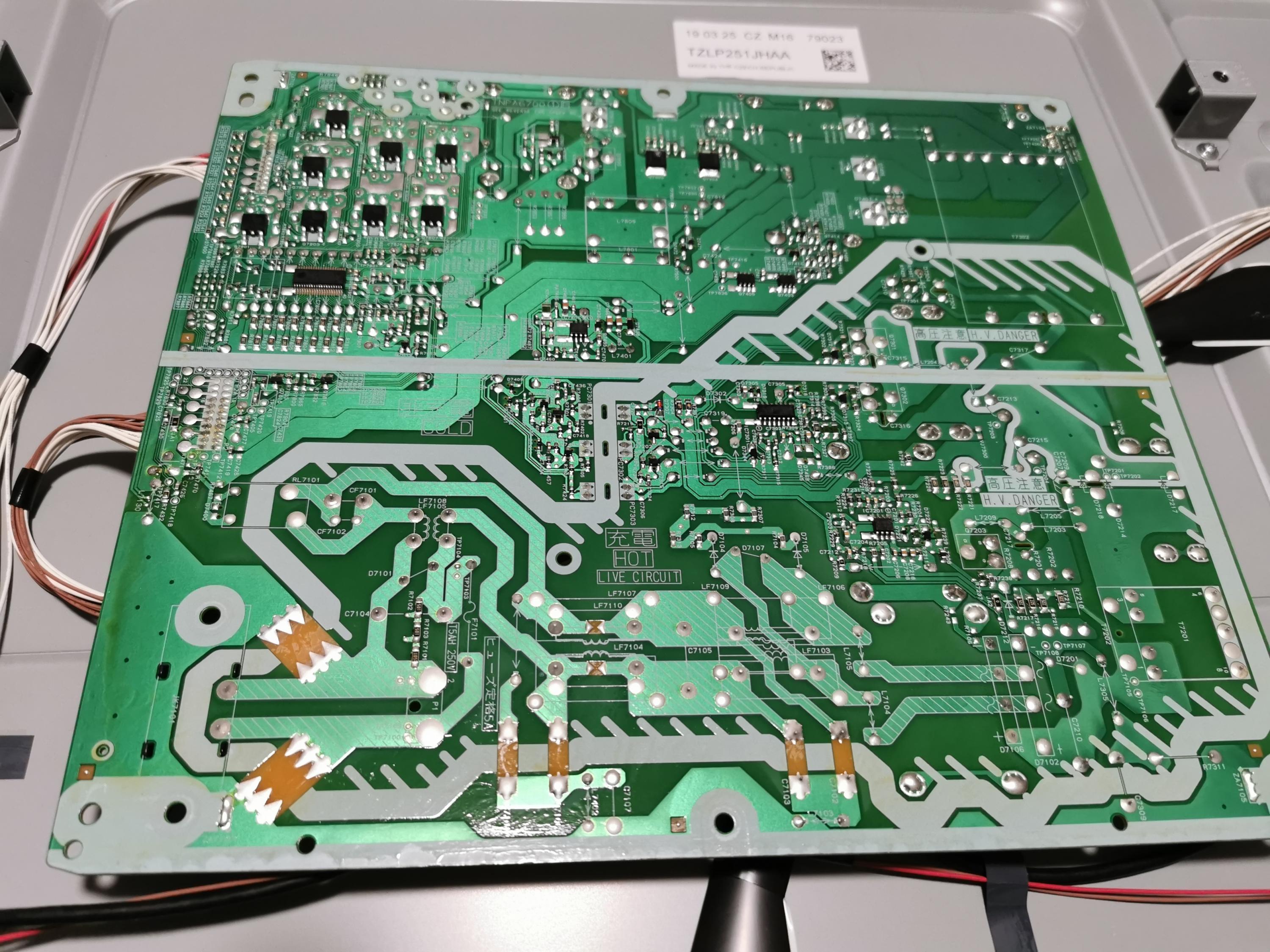

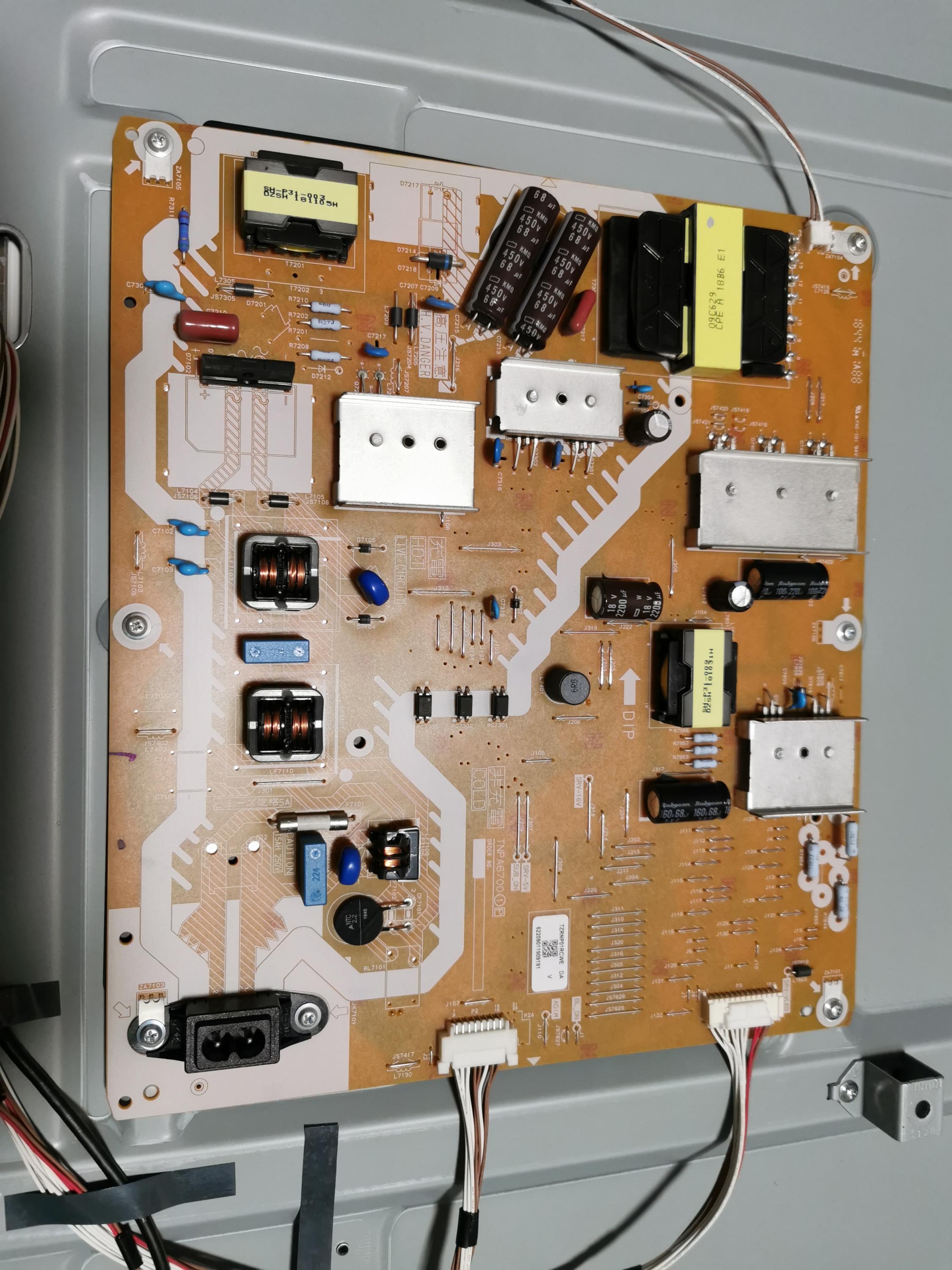

              I've been able to open the beast.
              Here are some pictures.
              Rapid inspection did not show any big issue, but, on the back of the power board some soldering are clearly damaged.
              especially on components on heatsink.
              As the problem seems to be heat related, i guess that this can explain symptoms.
              I'll renew all "suspect" soldering and let you know the outcome.
              Best regards
              JM
                Don't think that is the problem. But resoldering can't hurt. Try warming mainboard and see if start up changes.
                  Hello
                  Resoldering did not change the problem.
                  I've made a vidoe of the starup process with the 3 phases.
                  https://youtu.be/WmgrGgEntKc
                  Heating the main board did not changed anything.
                  What i can tell also, is that if I leave the tv off for 15 min, it will go to the 3 restart phase needed to have it working.
                  If then I just switch it off and restart, then it works immedialtly.
                  After some minutes off it goes back to the toubled startup.
                  I'll make a test with the T-CON (heating) to see if it comes from there.
                  any other test I can make to try to locate the fault ?
                  Best regards
                  JM
