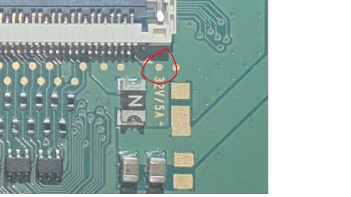

          Re: JVC 49cf890 - Fire TV - no picture but sound
          post 2 picture 3 under the ribbon cable connector there is a fuse marked N what votage do you get on each side of that one meter lead on metal tv chassis then test voltage each side.
          Will check this when i find some free time

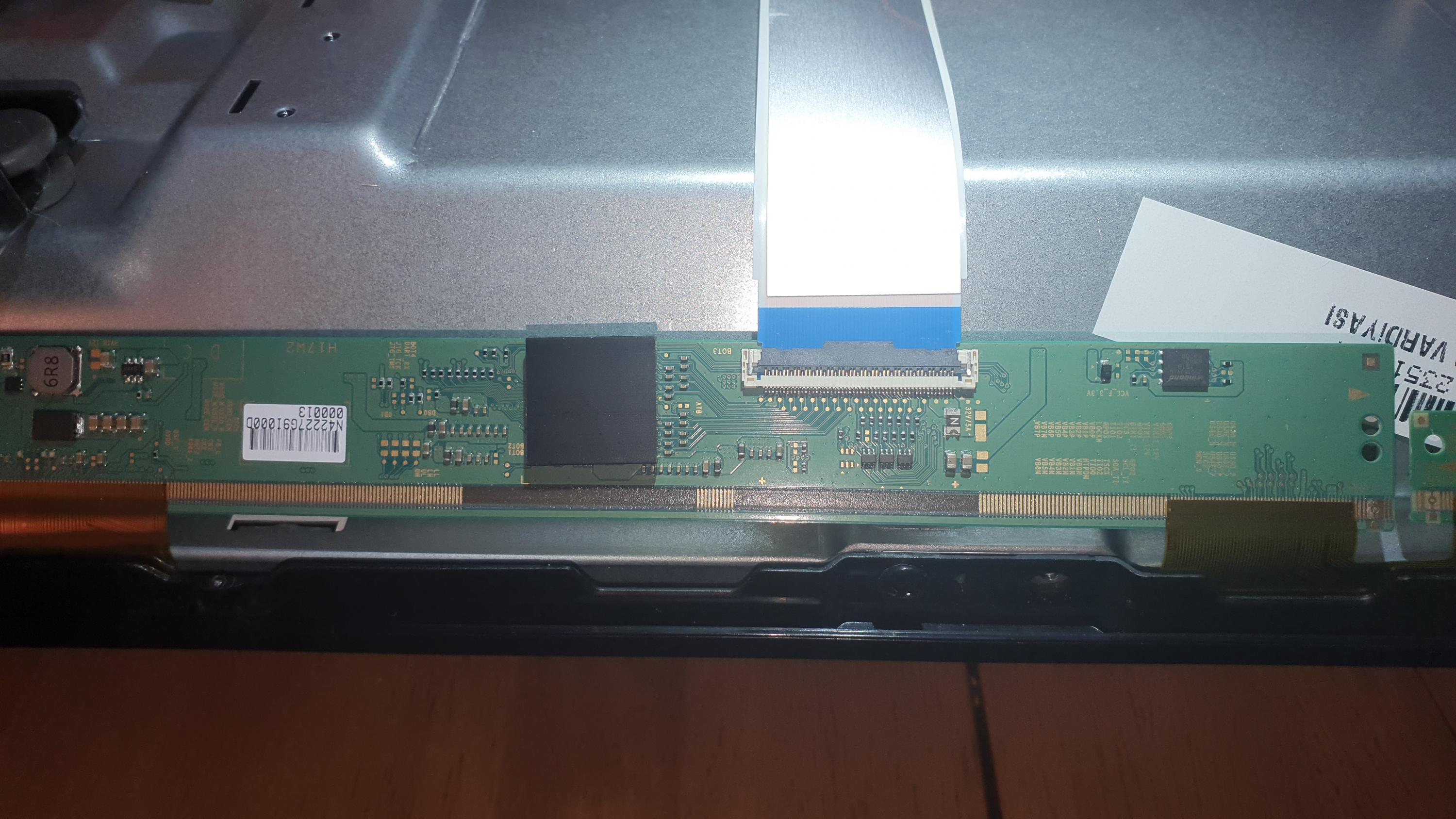

                Actually i do not get backlight flash only. The backligiht is working and i can see it from the back holes. Unfortuanetlly cannot upload video as this forum does not accept .mp4 video formats. I wll upload clear photo of the backlight connector in few mins....
                • Dobsuk
                  • May 2020
                  • 127
                  • England

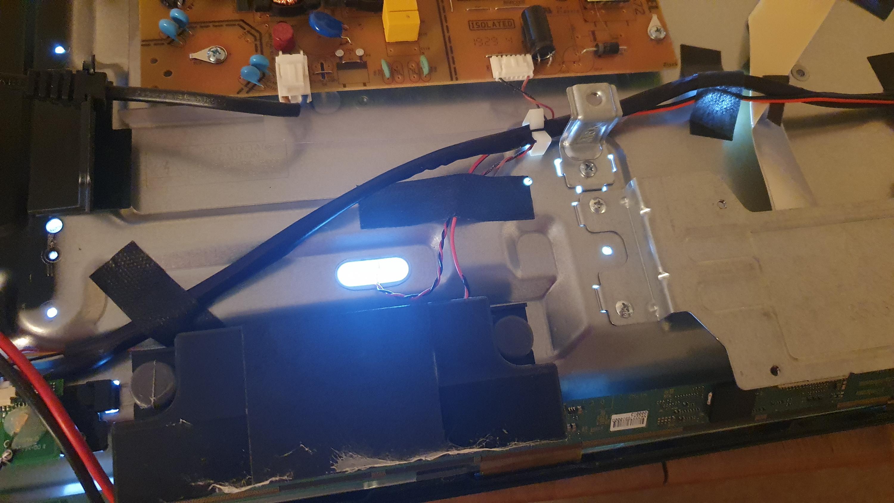

                  Ok, here we go and some photos of the backlight connector. I believe that should be:
                  I have got -123V on that connector and maybe you can see that the backlight is on.

                    #29
                    12.3V both ends on that fuse

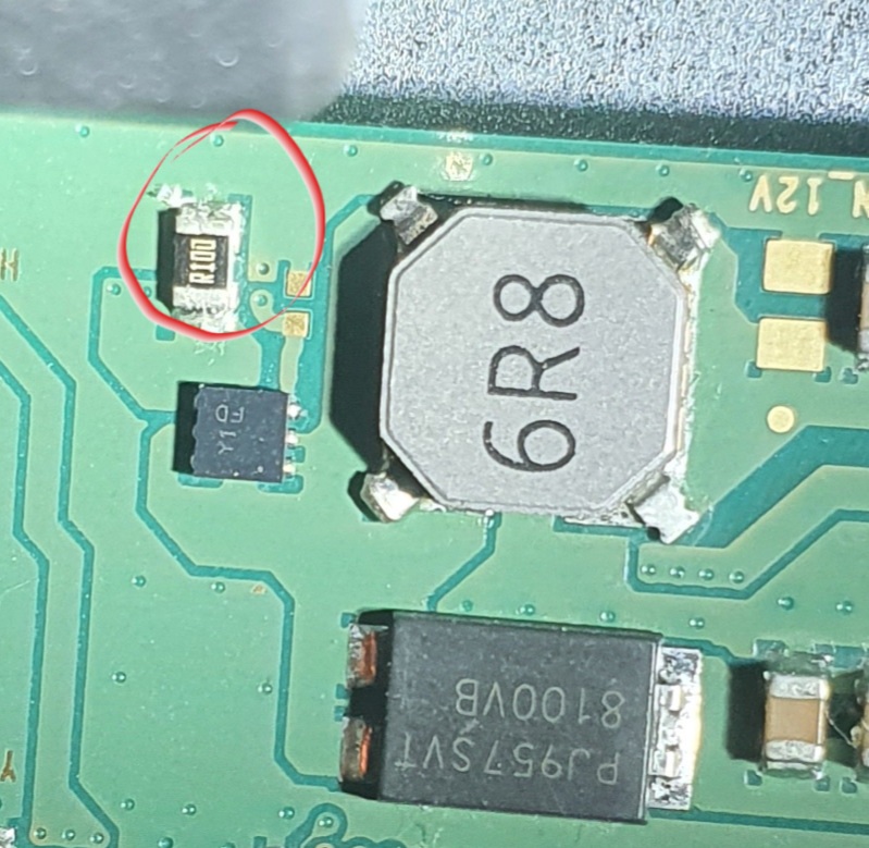

                          #32

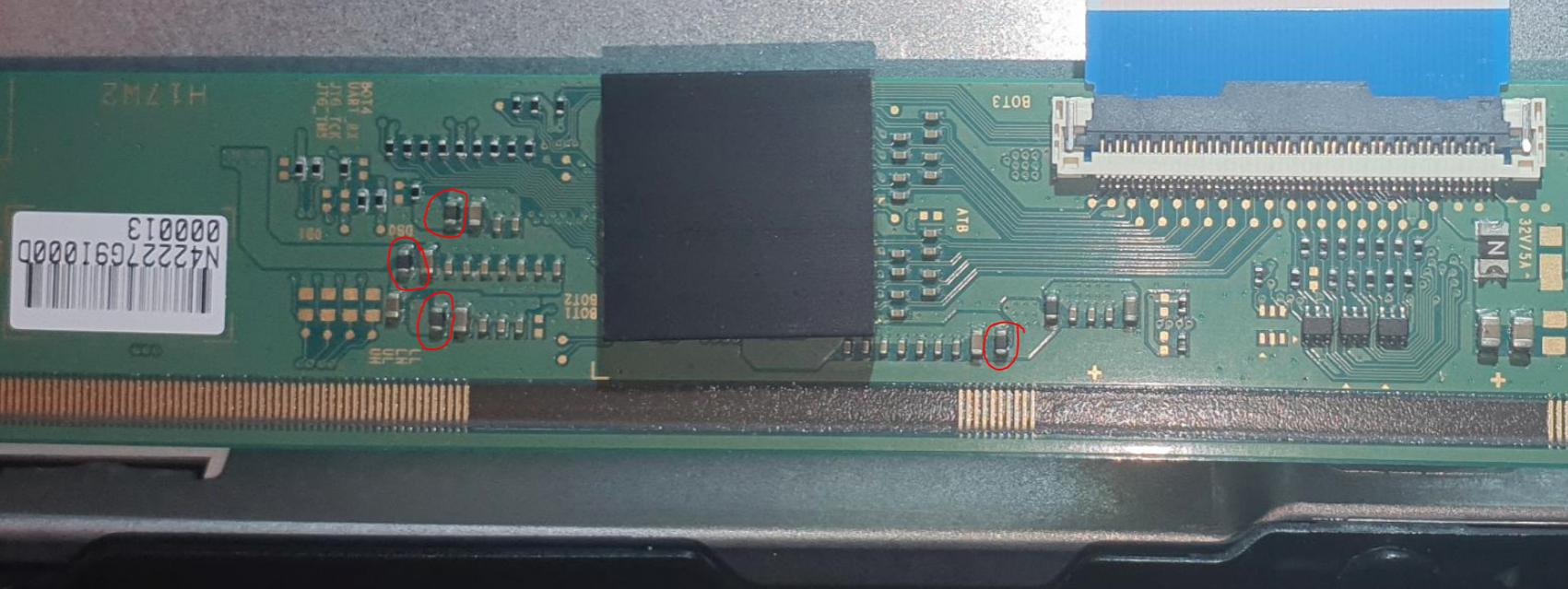

                          I checked all resistors - all looks good except that R100:
                          I have got short both ends. Is that resistors also?
                          Can you advise which voltages i need to check please?
                          Thanks.

                              #34
                              R100 - 0.1 Om

                                  You do not need to check the resistors, but the blocking ceramic capacitors (they should not have low resistance, short circuit). Check what resistance across induktors is relative to gnd.

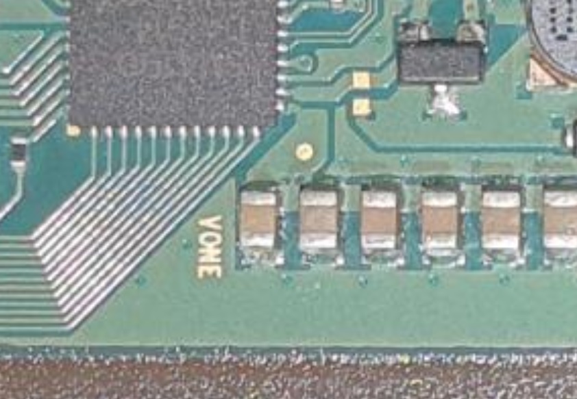

                                        #39
                                        Voffe - 0V
                                        Vss - 0V
                                        Cannot find Vone and VCC AVD. Found VONE here but not sure which point to measure:
                                        Also found few Vcc point but not AVD.
                                        On this 32V point i have got 0V
