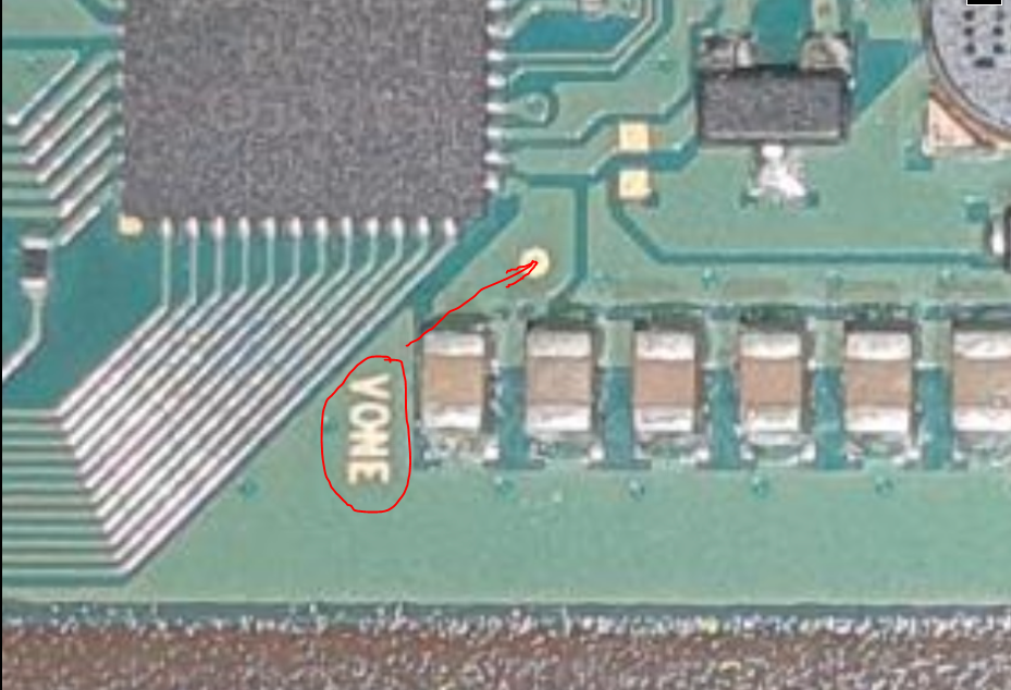

    Vone test at the round spot or caps next to it. The other is just fuse designation.
    Vone around 25v. Test both side of fuse with N on it for 12v

      Re: JVC 49cf890 - Fire TV - no picture but sound
      Originally posted by Dobsuk
      Voffe - 0V
      Vss - 0V
      Cannot find Vone and VCC AVD. Found VONE here but not sure which point to measure:
      Also found few Vcc point but not AVD.
      On this 32V point i have got 0V
      32V is not a dot, this is the designation of a standing fuse ("N" - 32v at 5a)

        #43
        Vone - 0V
        All Vcc points are with the correct voltage. +- 0.1 but maybe because of my multimeter. For example Vcc_1.6 is 1.7 on my meter.

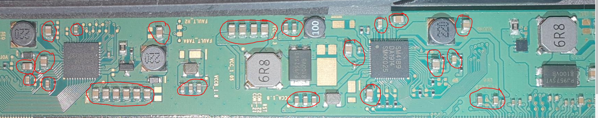

          I wrote to you, check, ring all ceramic capacitors with a multimeter for a short circuit.
          • Dobsuk
            • May 2020
            • 127
            • England
            #45
            I did that already. No shorts...

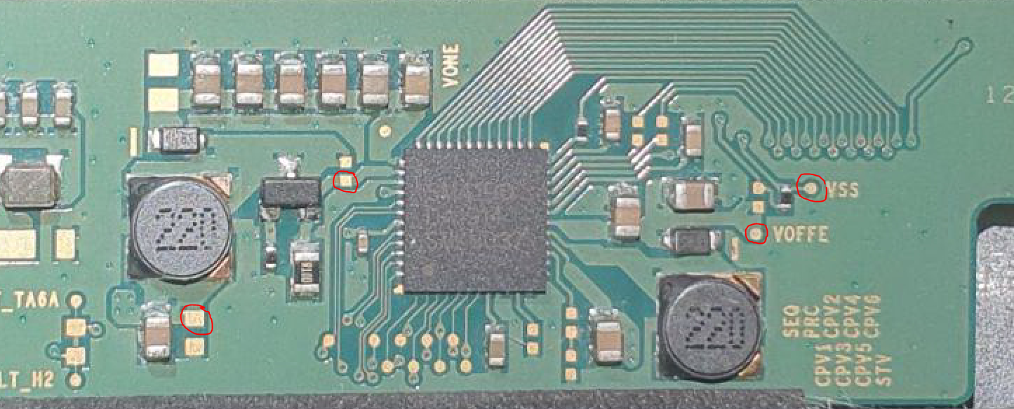

                        #51
                        Voffe - 0V
                        Vss - 0V
                        Vone - 0V
                        Vcc_1.6 -> 1.7
                        Vcc_1.05 -> 1.1
                        Vcc_1.8 -> 1.8
                        Vcc_3.3 -> 3.2

                          #52
                          There also is an AVVD test point on left side of your main chip.
                          • Dobsuk
                            • May 2020
                            • 127
                            • England
                            #53
                            Excuse my incompetence but i cannot see any AVVD test points

                              #54
                              Post #35 first picture between label and caps look like AVVD. If you have no voltage there, I would say you have a bad power chip.
                                Happy New Year to all. Sorry but I was away for few weeks.
                                AVVD - 1.7V
                                  It will be sold as spare. Thank you all.
