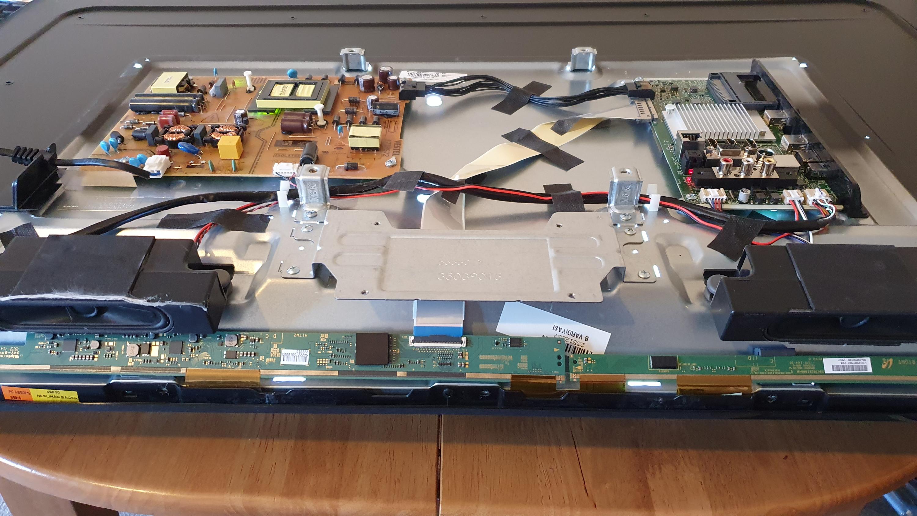

    Hi everybod. I've got that kit now JV LT-49CF890. It is been a working and just black screen while they were watching tv. So, it looks the backlight is working as i can see it working when switch the tv on, i can hear and the sound from the menu. I think it is already in factory settings. Any suggestions before to proceed with disassembling guys? Some tricks or ideas what to look for when remove the back cover? Thanks.
  • Dobsuk
    • May 2020
    • 127
    • England
    Re: JVC 49cf890 - Fire TV - no picture but sound

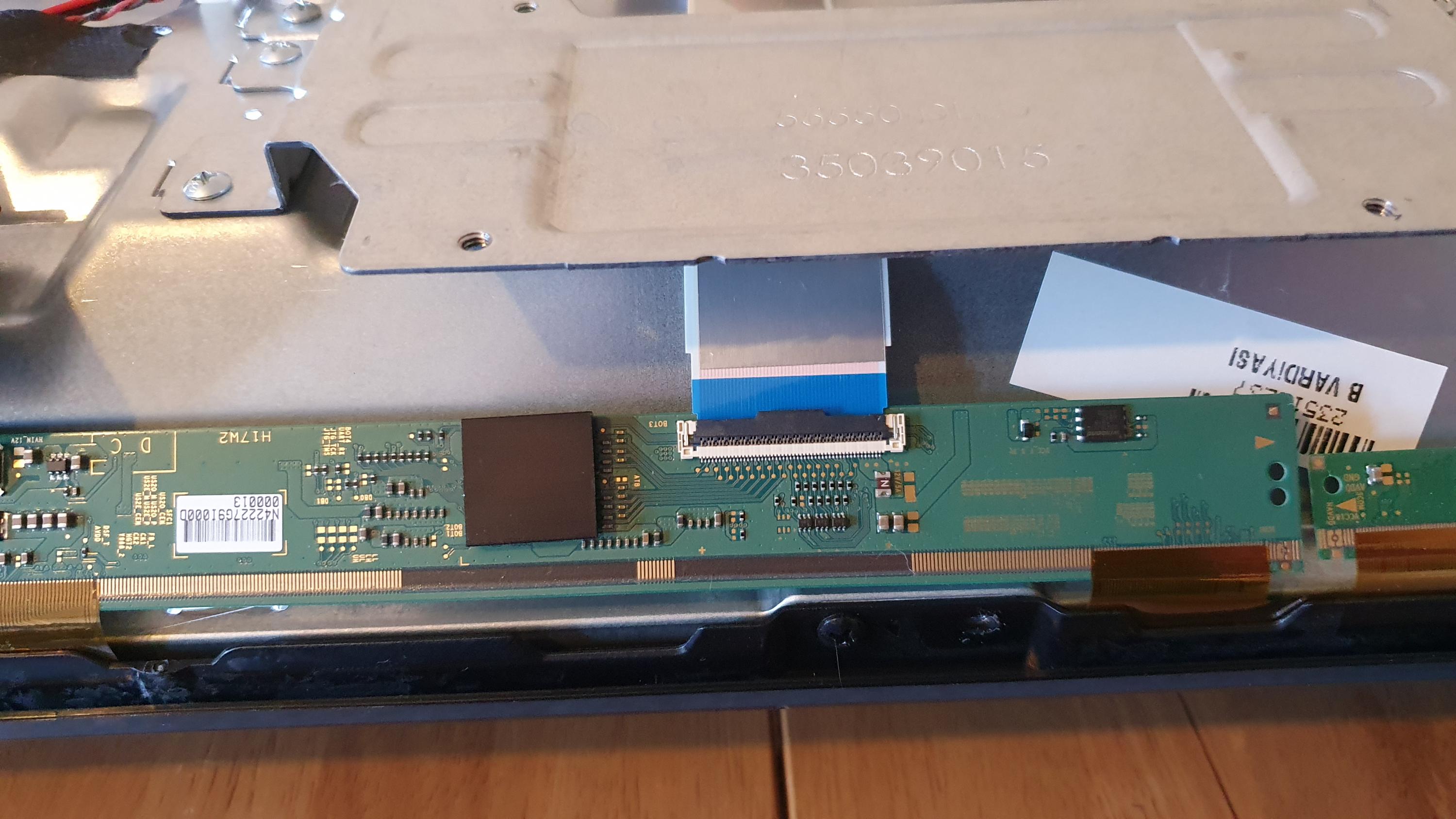

    Tadaaaa... no T-CON board or not in the way i expected to see
    Nothing changed if i disconnect the ribbon cable from the main board. Nothing changed if i tap on the ribbon cables connected to the display. So, shall i buy new main board or maybe the fault is in the board attached to the screen?

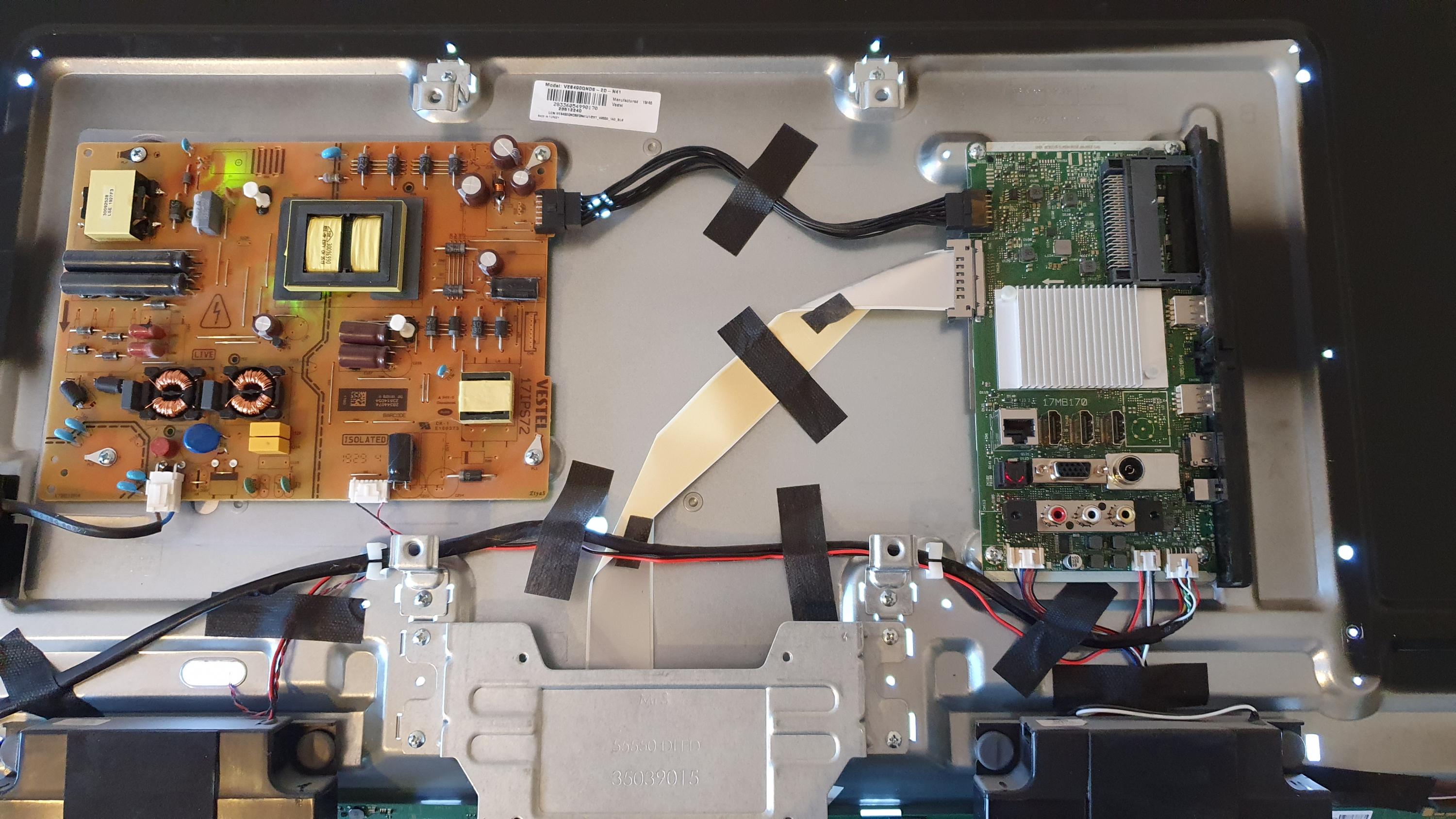

      on the power supply is ther a pin that says bl-on or somethink like that as thats the back light on voltage what voltage is on that pin when tv fisrt switched on and when just a black screen.
      there is a repair kit for these boards with no backlight issue these are the parts too check
      Q17
      U9
      D27
      R78
      • Dobsuk
        • May 2020
        • 127
        • England
        Backlight is working. I can see it when i switch the tv on.
          sorry missed that bit,
          have you checked the led strips incase a led is shorting under load.

                    Need to check if you have power on your t-con. Fuse good. Check for various voltages at test points.

                      post 2 picture 3 under the ribbon cable connector there is a fuse marked N what votage do you get on each side of that one meter lead on metal tv chassis then test voltage each side.

                        Briefly or ? You can see BL seeping through holes in the metal panel base, if you open the back of the TV.
                        Do you have Video ? if the Screen is black : press Menu button, so you know you (should) have an image, and use Flashlight on the screen to detect the faint image.
                        No Backlight : it works briefly and shuts down : Most likely dead LED is disconnecting the circuit : Buy new set ( using the Model printed on the Strips) , or , if you have same hue and brightness LED - Replace.
                        No Video : This is Main - Tcon - Panel line. Involves electronics Troubleshooting usually. Clean the LVDS connectors. Check that Main receives Power ( as printed on the PCB, near PSU-Main connector) by checking pins or detecting onboard. Check the T-con Fuse , Check Panel long boards .
                        According to results you can decide on electronics or new board path.

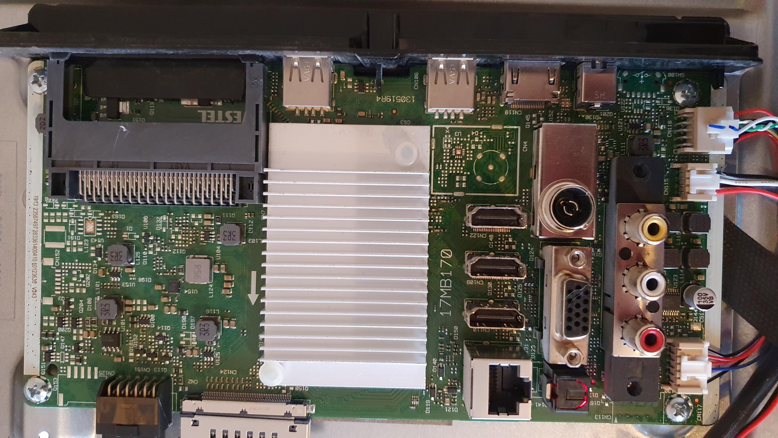

                          Thanks, will check this later. Anyway i ordered new main board as they were about 16GBP But will check and that fuse.

                                My money is on a bad T-con. But there's a reason I don't bet.

                                    Still a t-con. True there not just board swaps, but can be repaired.

                                      I believe the t-con is on panel strips.
