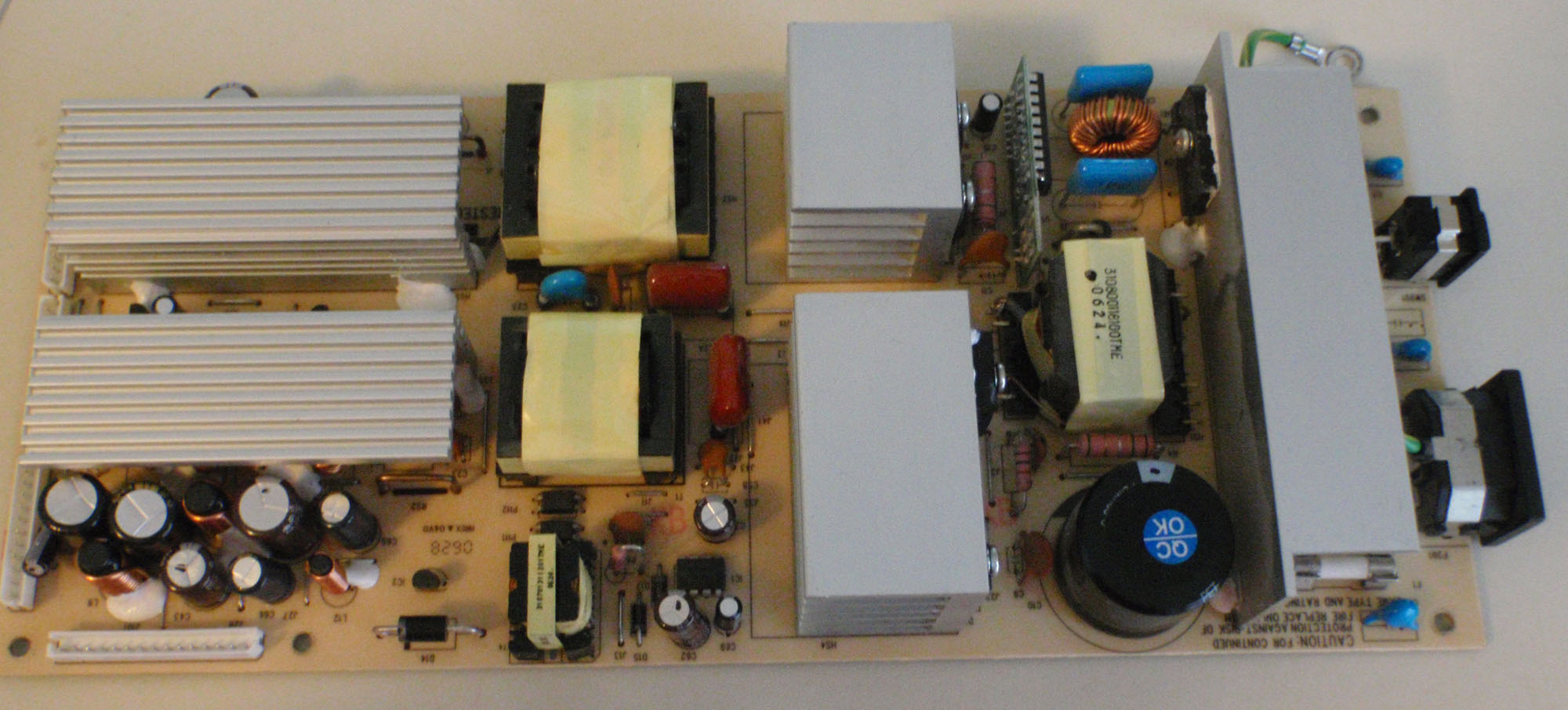

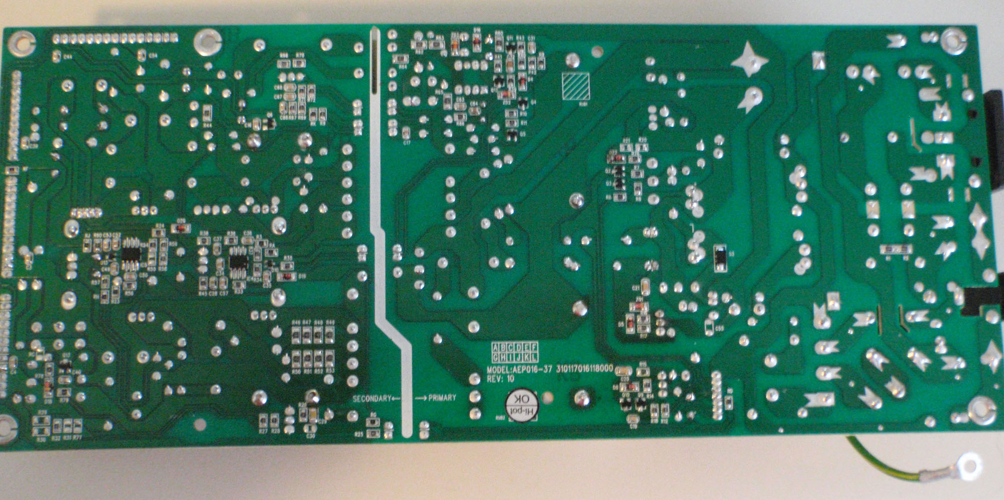

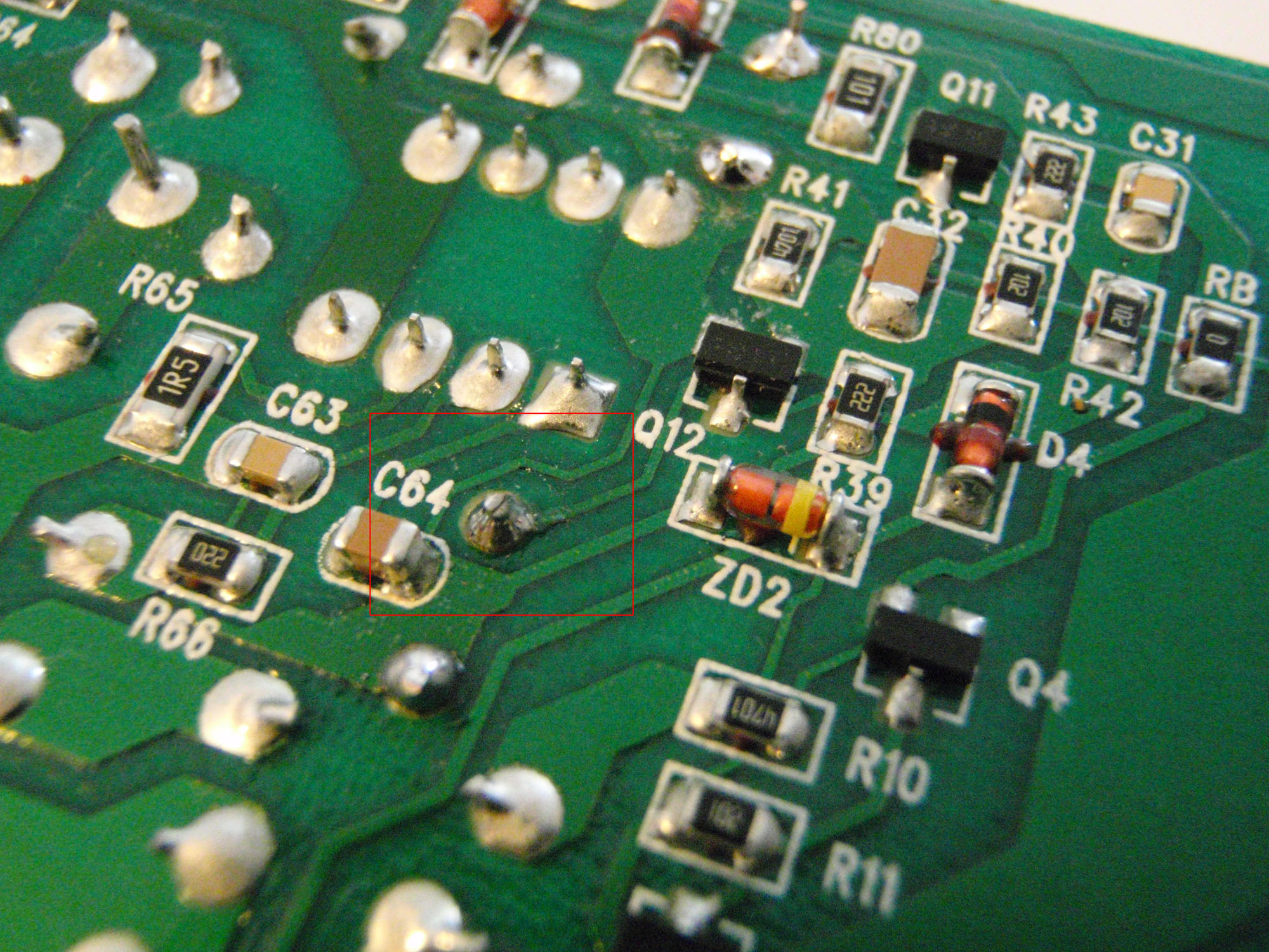

                                  I have an Olevia 237-S11 which uses the same power supply AEP016-37.
                                  The power supply uses a combination of United Chemicon (UC) KY series and Elite caps. Found several high ESR, out of spec Elite caps so I replaced all the Elite caps. Left the UC caps.
                                  Unfortunately, I believe I found the source of my intermittent problem too. In my case, the tv would sometimes run for a day or two and other times just a couple of hours. When it stopped running, it would power off (no sound, no video, no dim screen), but I could turn it back on immediately. Through experimentation, I determined the problem is heat sensitive. Last night, I found a lifted trace at C33 when I was replacing the Elite brand capacitors. I should have addressed it then instead of proceeding with replacing the cap at that location; I exacerbated it when I desoldered and soldered the new cap (see the attached image).
                                  I haven't had a chance to repair it yet, but hopefully that will take care of it. I'll report back when I get a chance to repair and test the results.

                                      Re: Olevia Syntax Brillian 537-B11 tuning itself off + image going blank
                                      Are you going to resolder or run a jumper wire? I would love to see a picture of whatever repair you decide to do.
