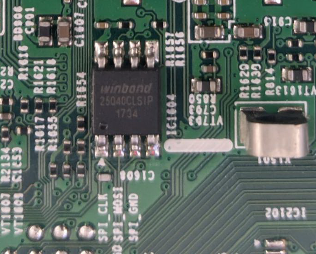

Un50mu6070 Mainboard issue

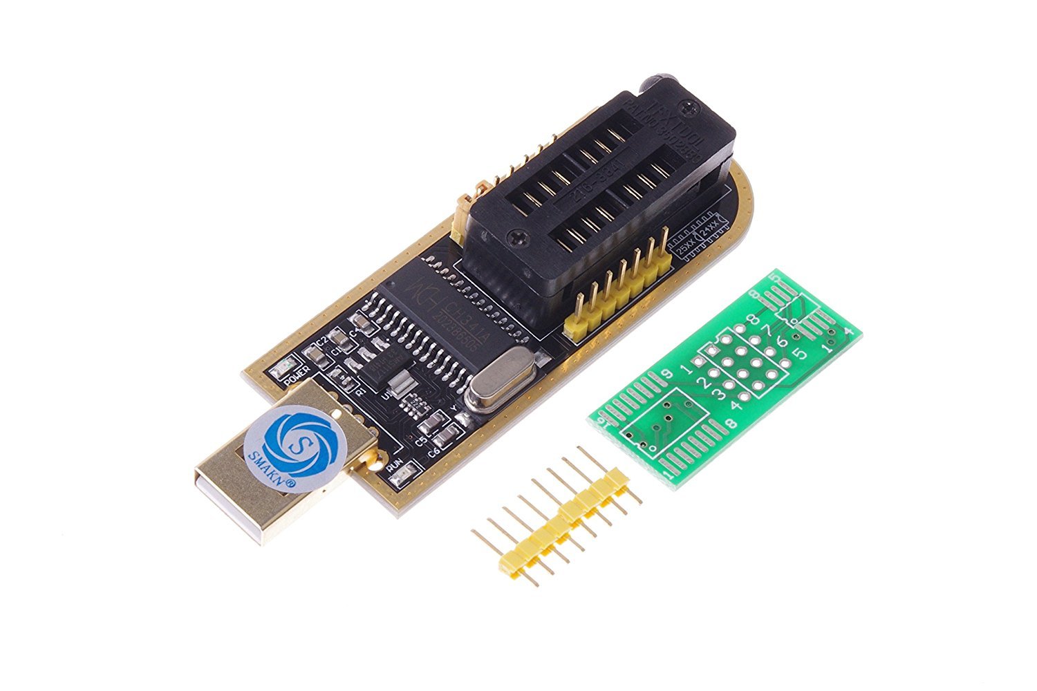

    I just got a cheap ch341a to start with.

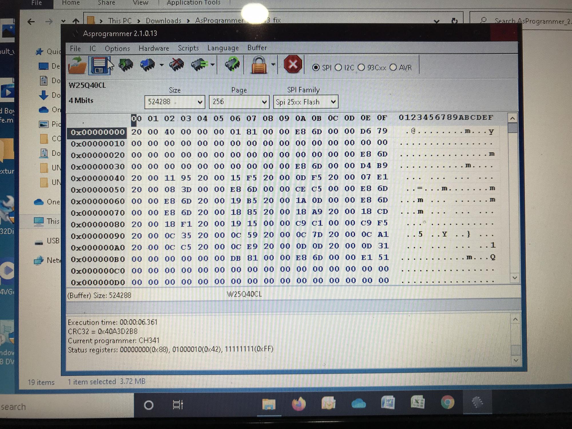

      Re: Un50mu6070 Mainboard issue
      And what soft do you have for the programmer?
      Here is the latest version of "Colibri" for the CH341A.
        I’m using AsProgrammer. I’ll try colibri and see if that makes a difference
              Ok. Tried again using your version of colibri, and asprogrammer. Still not working.
              Everything says successful but nothing
              I tried dumping my eeprom that does work and writing that but nothing.
              Thinking it may be the chip itself is just bad and not reusable.

                    #29
                    In the program:
                    1. Click "Detect Chip" and select W25Q40CL and "Select IC".
                    2. Click "Unprotect".
                    3. Click "Erase IC" and "Yes".
                    4. Click "Open File" and select your corrected Dump.
                    5. Press "Program IC" and "Yes".
                    6. Click "Verify IC".
                    7. Press the down arrow to the right of "Unprotect" and select "Edition SREG", put a check mark on S7, S3, S14, S9 and press "Write" and "Yes"
                    7. Close the program. Ready.

                        #31
                        Thanks Lotas, but still won't work.
                        I did exactly as you wrote.
                        I also tried another chip I found on another mainboard I had laying around and same results.
                        I made sure the registers were 0x88 and 0x42.
                        I must be doing something wrong.
                              Try this dump

                                #35
                                When dismantling and installing the 25Q40, were they not damaged, did the adjacent components move?

                                  #36
                                  I thought that also. So I switched back the eeprom I took from the 55” tv it still works fine.
                                  Also I tried to dump the working eeprom I have and write it but It's still not working. Getting frustrated with it

                                      Storyteller12 What is your CH341A programmer, there are several types of them (black, green ...) post a photo of it.
                                      • Storyteller12
                                        • Jun 2020
                                        • 624
                                        #39
                                        Im using this programmer

                                          #40
                                          Refinement of the programmer
                                          In the process of working with the programmer, some shortcomings were revealed,
                                          one of them: it is not possible to clear / set the QE bit in the second status register.
                                          We read the datasheet, for example, on the W25Q64FV chip, and find the Quad Enable (QE) punt,
                                          which has a warning:
                                          WARNING: If the / WP or / HOLD pins are tied directly to the power supply or ground during
                                          standard SPI or Dual SPI operation, the QE bit should never be set to a 1.
                                          To fix this flaw, you need to disconnect the legs #WP (pin 3) and #HOLD (pin7) from VCC
                                          and connect them to VCC through 4.7 kΩ resistors.
                                          I propose a step-by-step instruction for finalizing the "black programmer":
