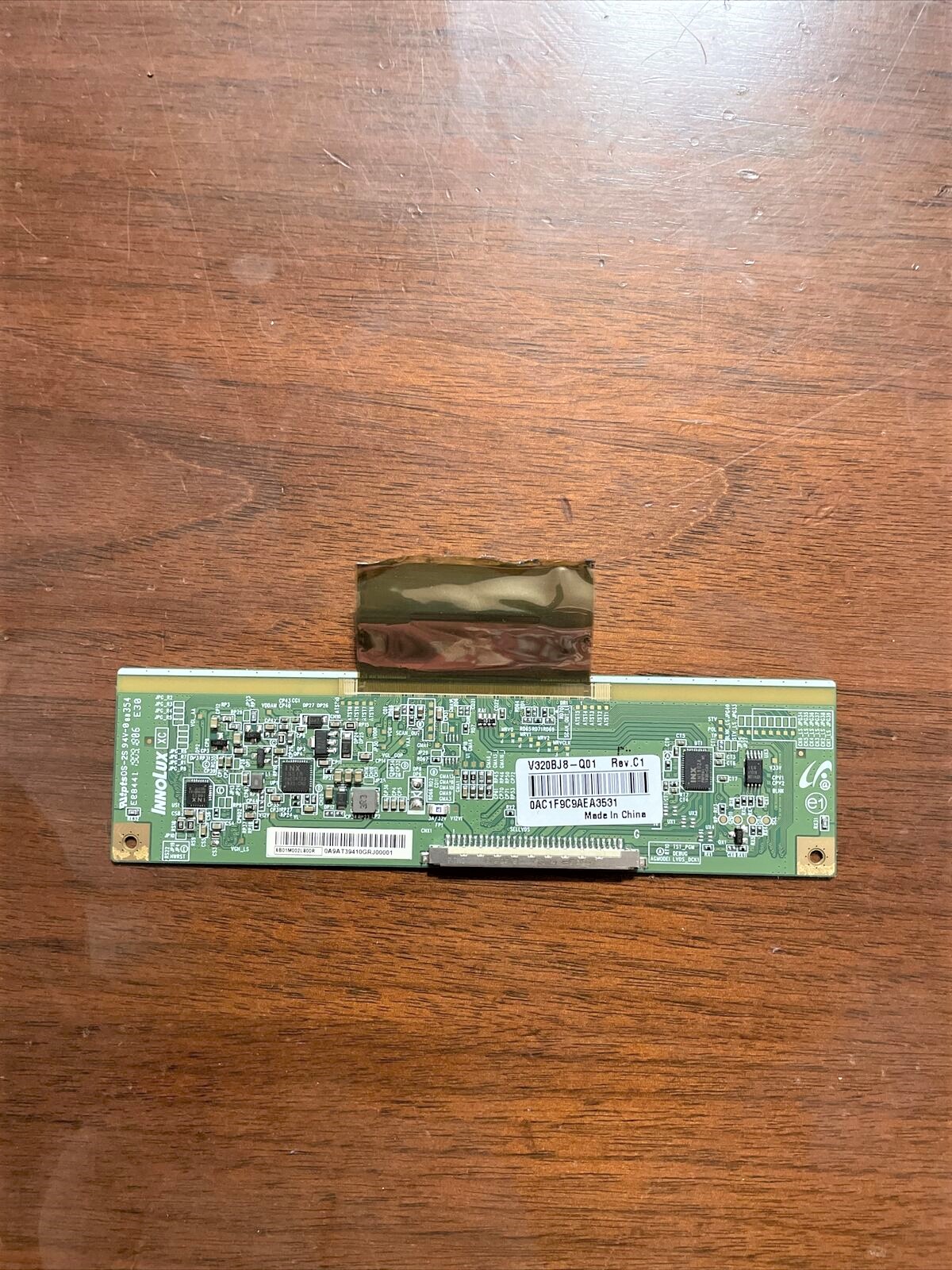

    Can anybody tell me what type of glue or adhesive I need to reattach the ribbon cable from the screen back to a replacement t-con board on a TCL 32S331 TV? What is the process and where can I get the materials and or the tools to do this? Thanks in advance!

    pictures please ..

      The first picture is the defective t-con board already removed from the tv.
      The second picture still has the ribbon cable attached that goes to the panel. I got this picture from Ebay.

        https://www.youtube.com/watch?v=epc4Uj37TMc

          Is there a way to do this without the machine in the video?
            The machine uses a microscope for alignment and then adheres the ACF tape using heat and pressure. You're free to copy that any way you like.

              Thanks diif! Any suggestions? I've been looking for ACF tape but the only place it's available is China, as far I can find. I have found a t-iron attachment on Amazon. Are there any other tapes or adhesives that can be used in place of ACF tape? Looking forward to your reply. Thank you!

                No, only ACF tape can be used. It's conductive in one direction. https://www.silmantech.com/whats-acf...-does-it-work/

                  Are there any places to get the ACF tape in the United States? It will probably take about a month to get it from China.

                    Will this work?
                    https://www.amazon.com/gp/product/B0...ref_=pd_gw_unk

                      No, it's not conductive in the way ACF tape is.
