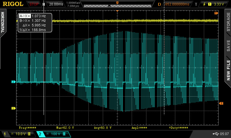

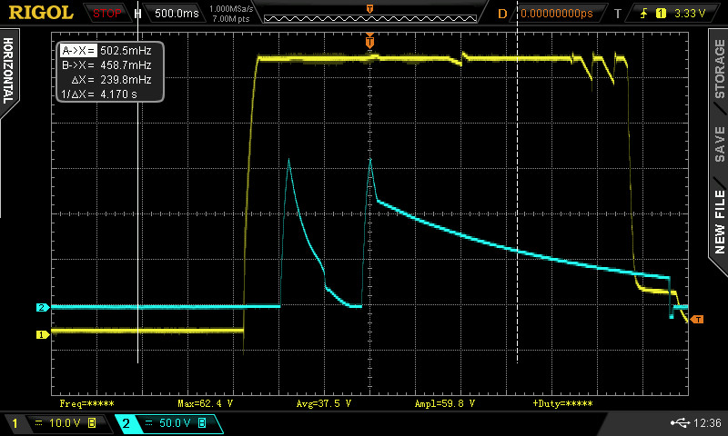

    Hey guys,

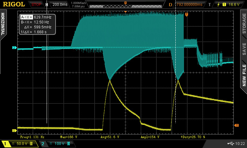

    I was given an LG 50PK550 plasma that tries to turn on then turns off right away. The guy before me bought a new power supply board which did not fix it so he included the spare board with the TV.
    When I power up the TV, the relays click, then there is a quick flash of grey on the screen and at the same time I can hear the panel prime but then the panel goes out. The TV stays powered up for a short time, during which I can hear a faint ticking from one of the transformers on the power supply board. After a few more seconds the relays click and the TV shuts down. Pressing the power button again repeats the cycle.
    I tested Vs, Va, and 5V going to the Y-SUS, all of which are good until the TV shuts down fully. I checked the 5W ceramic resistors on the power supply board and they are all good. I also checked all of the other large resistors on the power supply and Y-sus board.
    Disconnecting the Y-sus from the power supply causes the TV to stay powered up until the power button is pressed. I reconnected the Y-sus board and removed both of the buffer boards. The TV shuts down right away again. Problem must be on the Y-sus.
    I hooked the scope up to the Vs rail to be sure the voltage wasn't dropping out and it was solid. I then checked Va. Va is solid while the panel tries to prime but then has downward spikes corresponding to the ticking from the power supply board. I assume this is due to there being no real load on the rail and it is just having trouble regulating. This cannot be the issue anyways since the Y-sus does not use the Va rail.

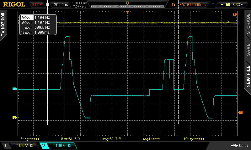

    I scoped VSC on the Y-sus and captured a waveform. The blue trace is VSC and the yellow trace is Va. You can see VSC come up to the rated 150V but die out, spike back up, and die completely. VSC dropping out corresponds to the panel going dark after the initial flash. You can also see the downwards spikes on Va, but they happen after the problem with VSC has already occurred so I do not think they are relevant.
    Does anyone know what could cause VSC to drop out? Or any other ideas what to check?
    Thanks!

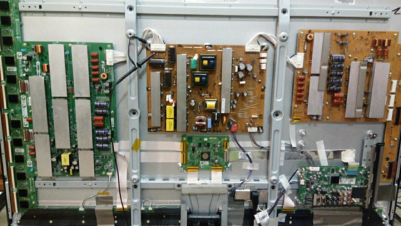

      I don't know if this motherboard in your photo has the same notorious BGA problem as other 50PK550 models sold worldwide with the big heatsink had, but since it did not shut down during your testing, it probably is good, an AUTO-GEN test can rule this board out.

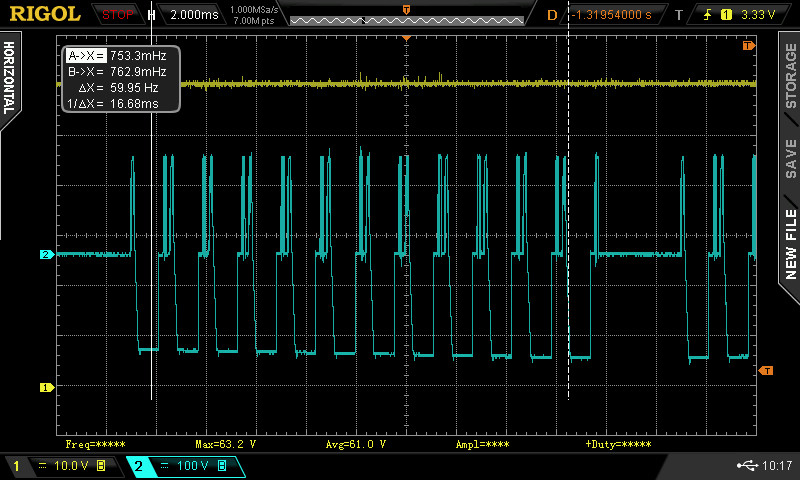

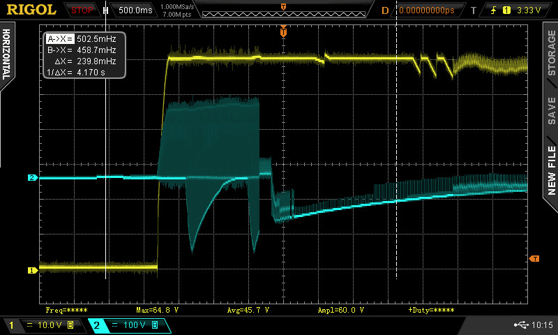

        Fair enough, it may not be the Y-sus based on that test.

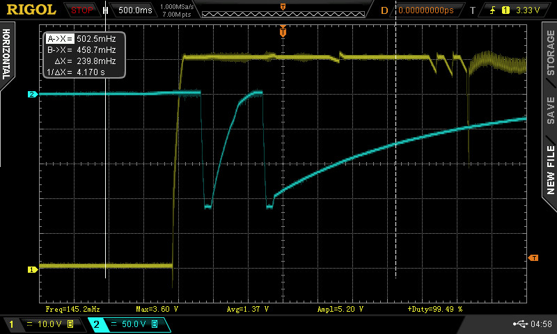

        Attached are waveforms of -Vy and ZBias. The yellow trace in both waveforms is Va for reference. Both signals have exactly the same behavior as VSC did. They come up to voltage, and then die out right away.
        Since Vs is stable the whole time, the logic board must be dropping some enable signal to the Y-sus and Z-sus boards. Do you know of any way to tell if this is due to a fault with the logic board or the logic board seeing some signal it doesn't like from the Y-sus or Z-sus?
        When you say motherboard are you referring to the logic board that runs the display signals, or the main board with all the video inputs on it? I'm not sure what the AUTO-GEN you mentioned is.

                        I previously found the training manual for a 50PK750 which seems to be the same as mine. All of the circuit boards are the same as the ones in the manual.
                        I checked the FG5V, FG10V, FG15V, and FG24V on page 73 and they were all good for the second that the TV is trying to start. None of the solder joints look questionable either.

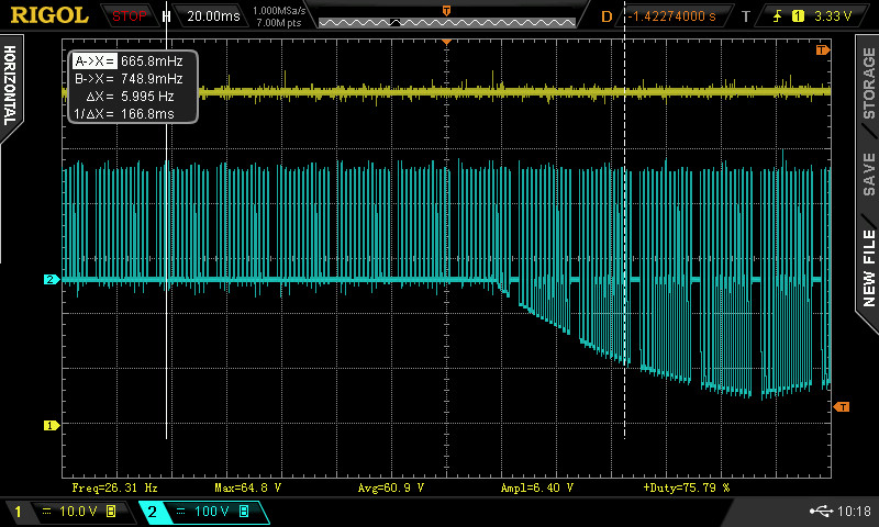

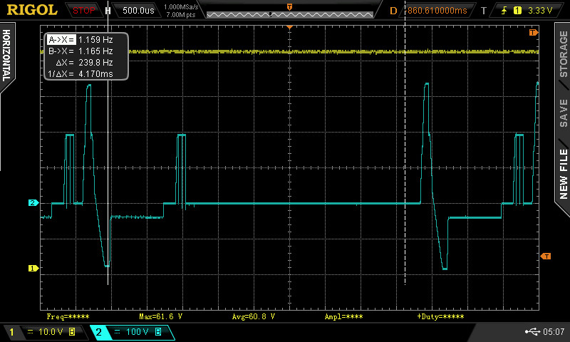

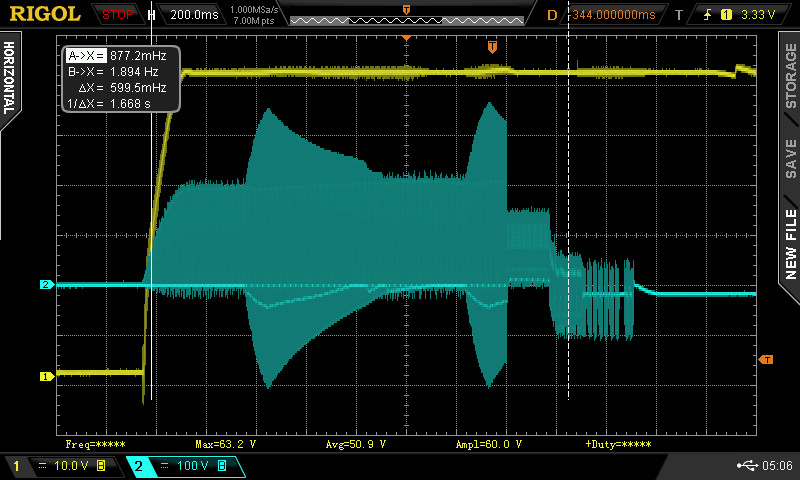

                        I also probed the floating ground and captured some waveforms. The first 4 waveforms show the floating ground in blue, and Va in yellow. The last waveform shows the floating ground in blue and VSC in yellow. When VSC is at it's proper level, the floating ground signal looks good. So the generation circuitry must be ok.
                        There has to be some signal going to the Y-sus board to kill all of the generation circuitry. Page 77 shows the pins of the ribbon cable going from Y-sus to the logic board. Pins 1 and 2 are labelled Error and CTRL_EN. The manual says Error should be 13.57V while the TV is running. I get 0V. The manual says CTRL_EN should be 0.09V while running. I get a 5V pulse before the TV tries to turn on and then it is 0V the rest of the time. So the CTRL_EN signal looks ok. It seems like the error signal is incorrect though. Maybe this indicates that there is in fact an error on the Y-sus?

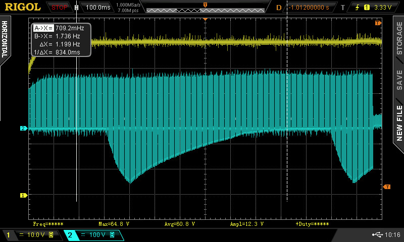

                                The 4 attached waveforms are of the Y-scan signal. Page 63 of the manual shows this signal at different timescales and my signal does not seem to match it. I get the same sort of signal but I am missing the group of 3 pluses at the beginning of each burst. The third waveform is of the gap between the two bursts where the 3 peaks should be. I have one peak like the one shown on page 64, but nowhere is there 3 consecutive peaks like is shown in the manual. Could this point to the issue?

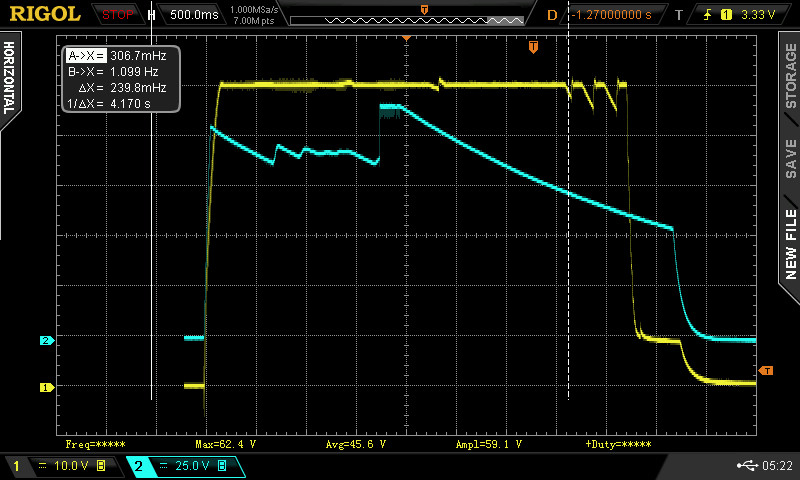

                                    I took a closer look at the ERROR signal on the Y-sus side and the pin from the connector goes straight to an unpopulated resistor on the board. So they are obviously not even using the ERROR signal on this TV. The CTRL_EN signal was behaving as expected from the manual so I don't see any problem there.
                                    It is really difficult to track down exactly what is causing it to shut down, especially with no schematics available.
