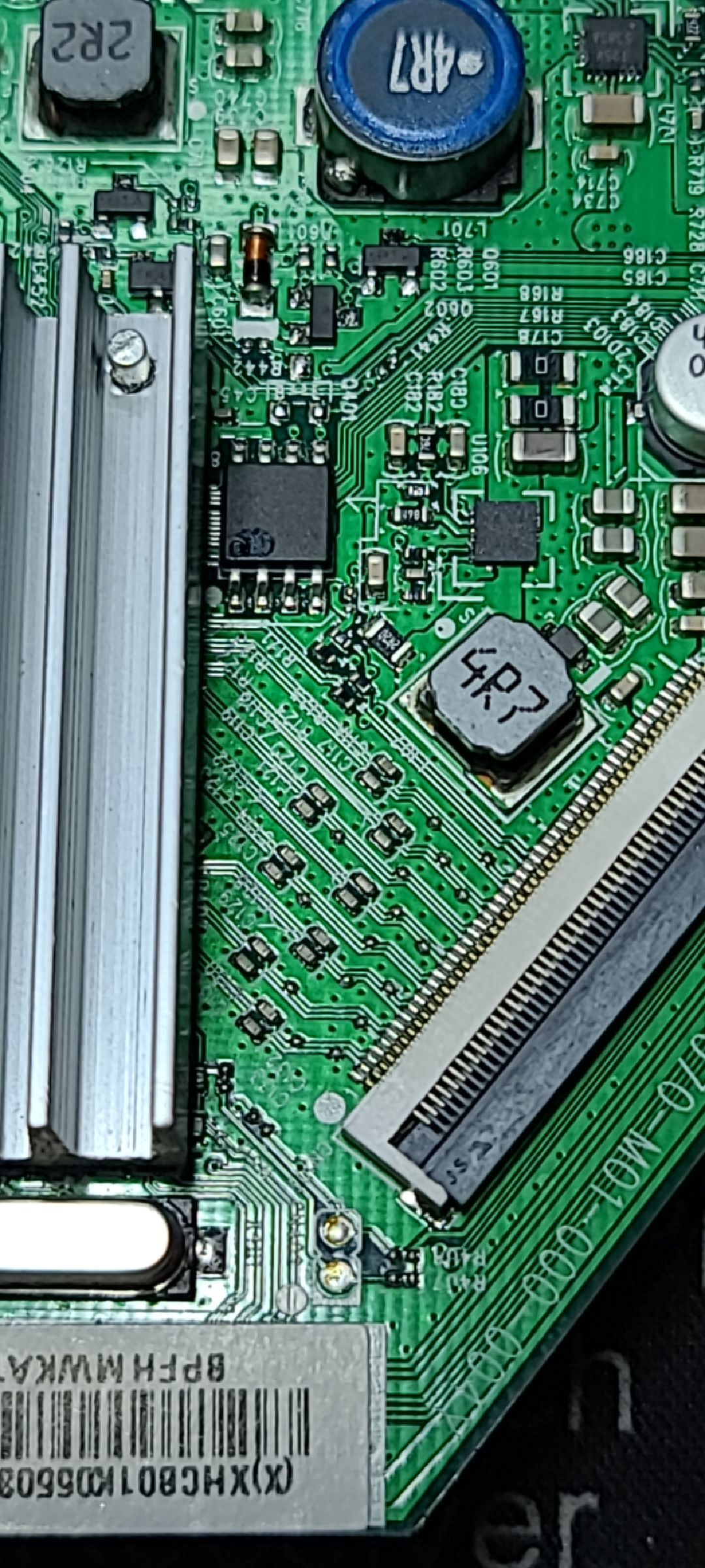

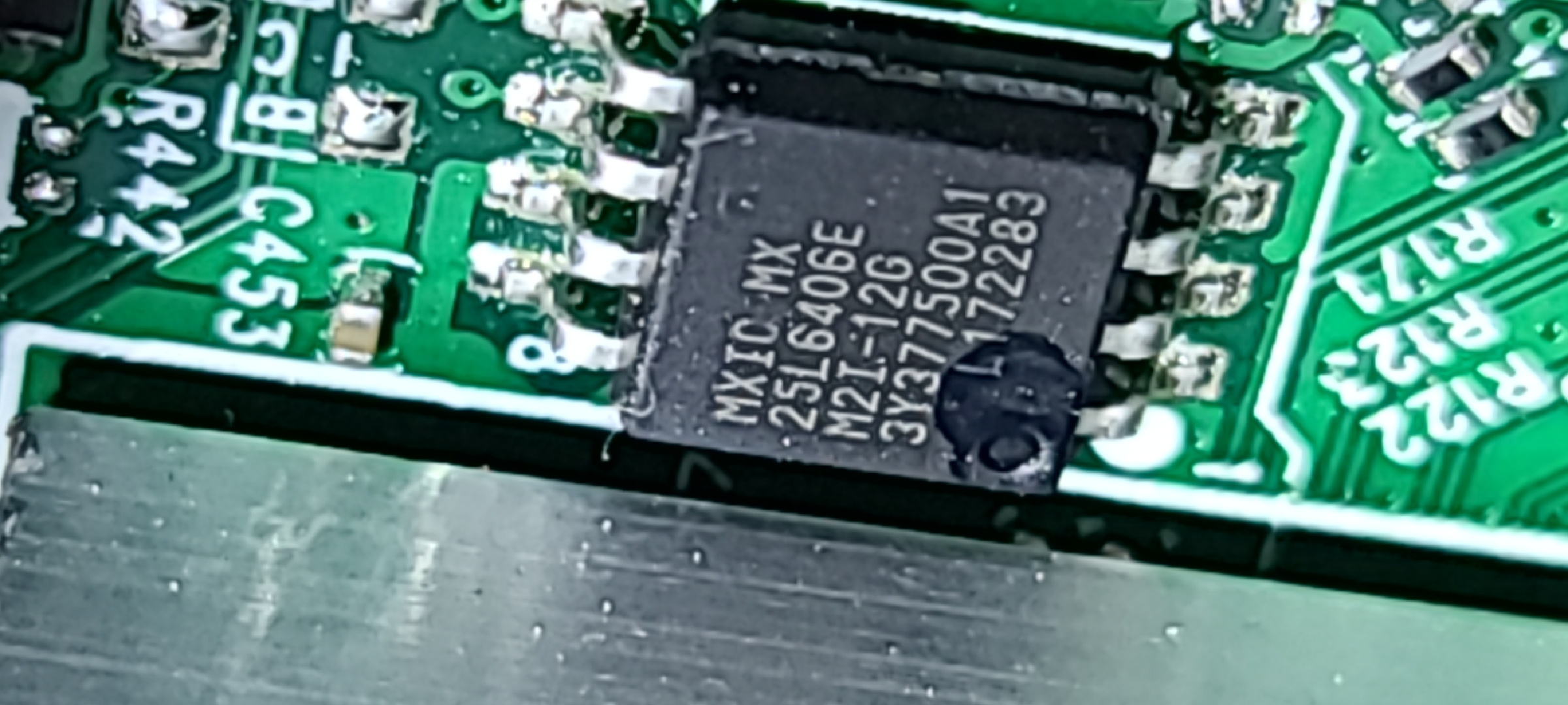

                      So i was bored and went back to looking at this tv when I came across this..

                        @DXseekerMO any chane your looks the same?

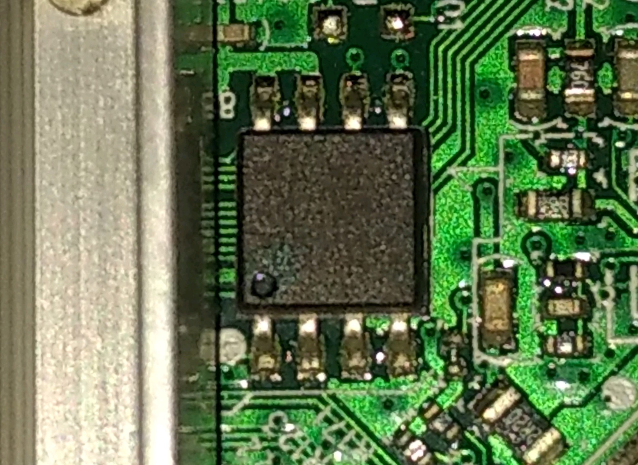

                          Re: Vizio D55un-E1, bad Q9100, C9100 & R9111, parts ordering questions
                          Sorry I didn't reply to your previous message, it's exterior house and porch clean-up time in these parts lol.
                          Here's a pic of mine, it isn't blown out like yours but do note the discoloration in the same area.
                            That looks like the marking commonly seen on the main EEPROM on a PCB, either a dot of varnish or paint is used.
                            Remove it from the board and read it to verify if it is actually blown.
                              Now that you say that, I see it lol Well thatsgood news and bad lol.
