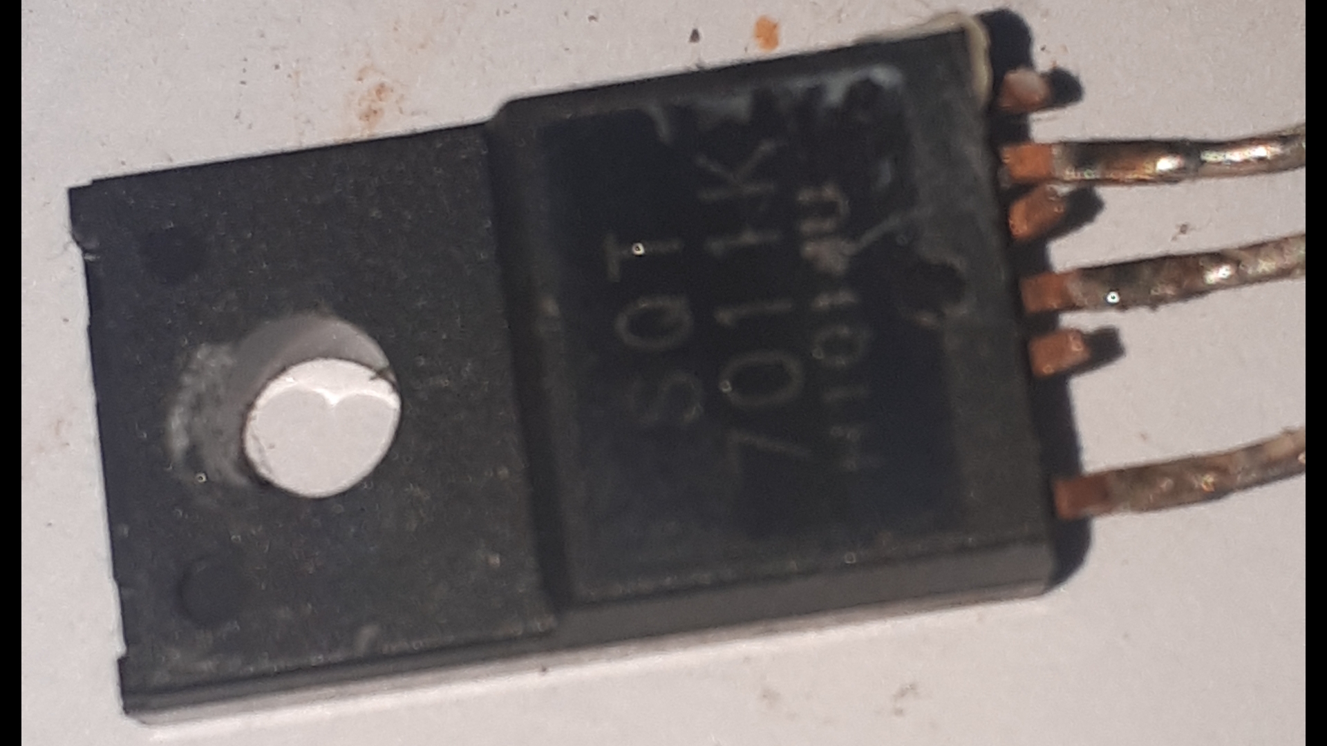

    Just a quick question...
    I've removed the 6 pin mosfet from a Samsung psu & I haven't got the same one, could anyone tell me any others that I could replace it with please?
    Tia

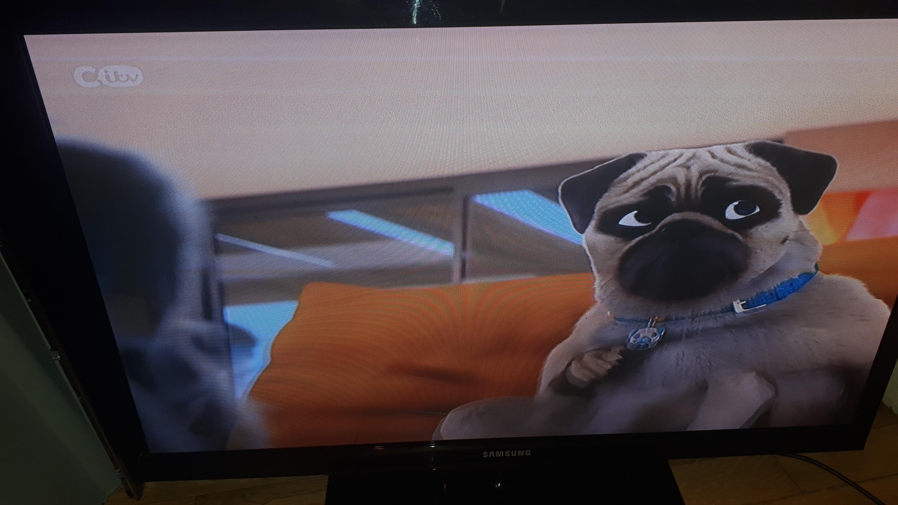

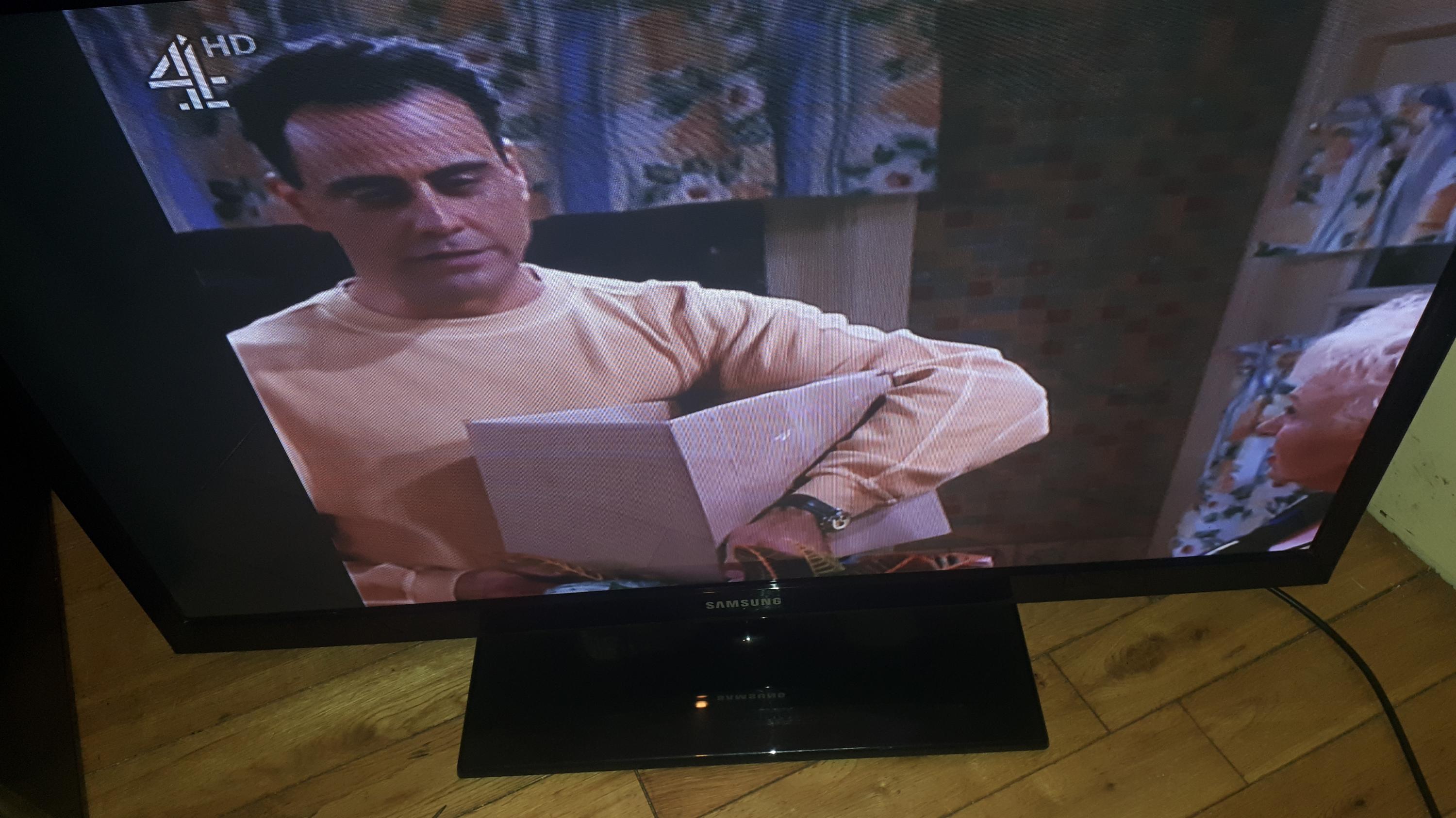

    Update
    It's ok, I replaced the board with another board from a similar model .. seems to be working ok but the only thing is when I flicked through the channels the picture on channel 4 was too far to the right, I will upload a photo, it seems to be the only channel that it's happening on ..
    Tia 👍

      Re: MOSFET SQT7011K equivalent replacement
      If you had googled it the part is an ic not mosfet! Mosfet normally have three legs you would have found it to be a STR-W6053S
