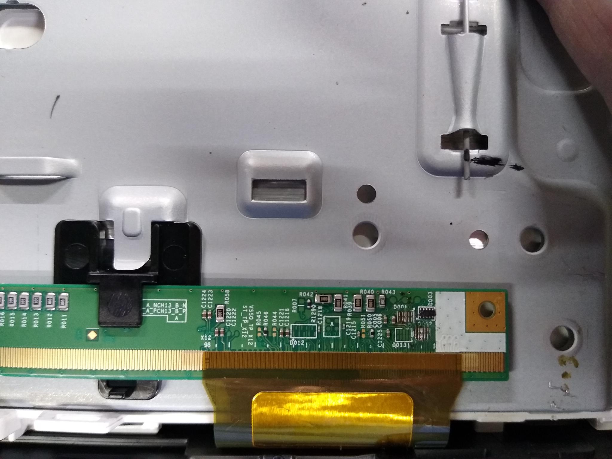

                  Re: Samsung QLED Q60R constant reboot issue
                  this QN55Q60RAFXZA was rebooting.
                  backlights stayed on when power cable to main was disconnected.
                  i reconnected the cable.
                  pulled ldvs cables... set stayed on.
                  turned up volume... had sound.
                  remote turned the set on and off normally.
                  tried each ldvs cable one at a time... set stayed on.
                  reconnected both ldvs.. set reboots.
                  i removed panel circuit board cover and let it run with both ldvs cables connected.
                  felt around the boards until i burnt my finger.
                  found diode pack hot.
                  removed two hot diode packs.. restored the tv to a working state.
                  they are very tiny
                    Good job.. now it would be important to replace them, them are protection tvs diodes, them has at least more or less 40-50v rating because them are to protect clock signals i guess, normally clock signals have peaks of vgl to vgh so about -7 to 30v.

                            Uhoh, now I notice very faint black horizontal lines on the entire panel. Not terrible but noticeable. Any idea of where I can find replacement diodes?
                            • skaja
                              • Dec 2021
                              • 3
                              I managed to resolve the ‘fixed horizontal lines’ by putting a half inch piece of tape on part of the panel led ribbon. This video helped me although it’s not exactly the same issue. Good luck future readers.

                                        I had the same issue with my set, 55" QN55Q6DRAFXZC. It would show the samsung logo and reboot. In my experience with bad panels if the LCD had an internal short usually it wouldn't display a logo so i suspected something else was up. I whipped out the thermal camera and discovered d001 was getting toasty (140c+) and under the microscope you could see factory flux black and bubling out from under the chip. Simply knocked off the diode pack with a blob of solder on my iron and TV is back to 100%.
                                        Diode number is 4262H
