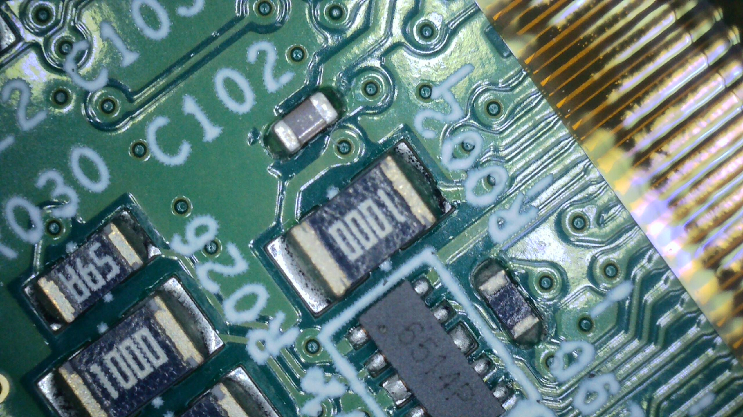

    Just wanted to say that i had the same problem. Diode d001 is shorted in the right part of screen. I removed it and tv is working fine. Thank you

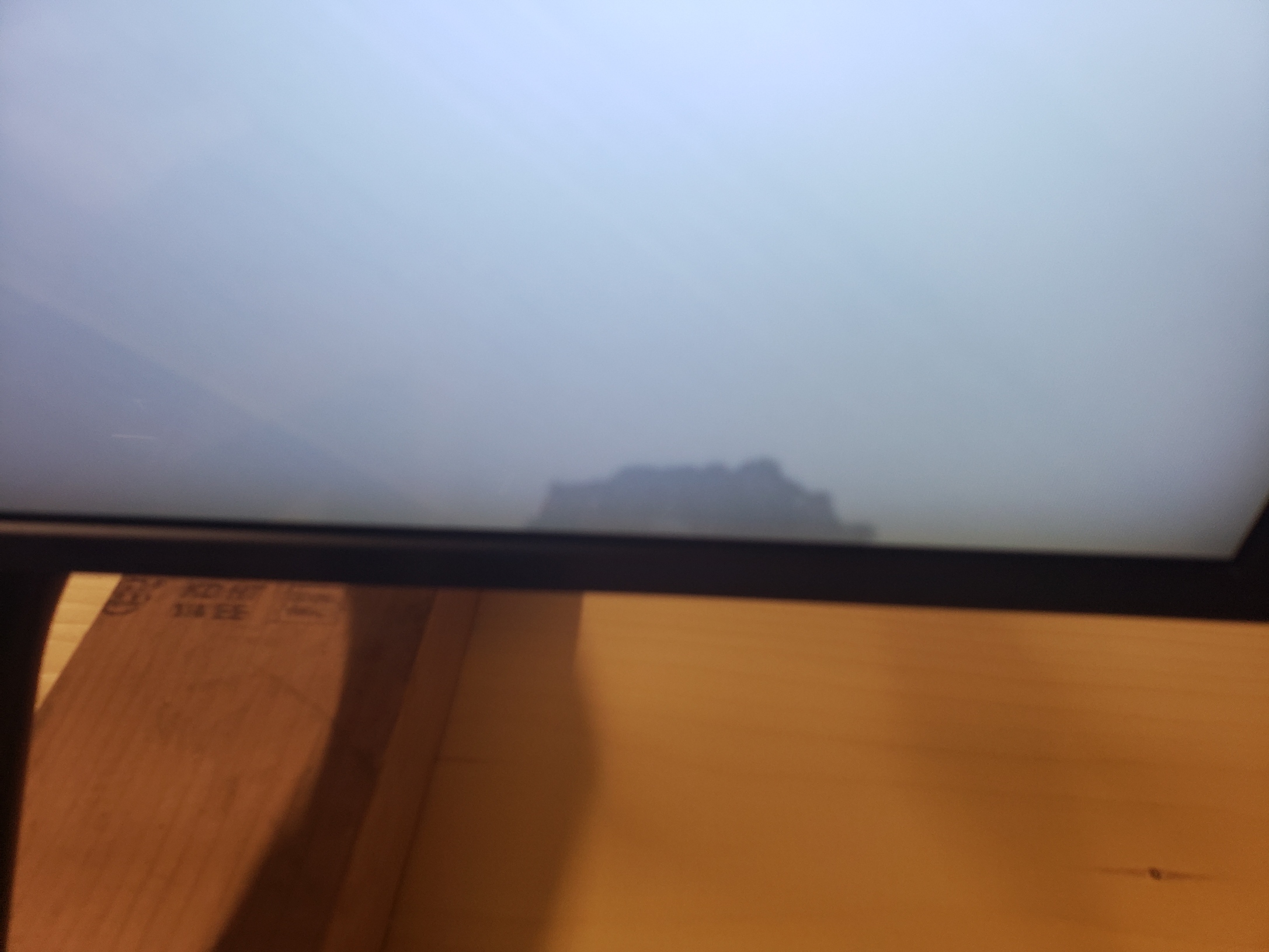

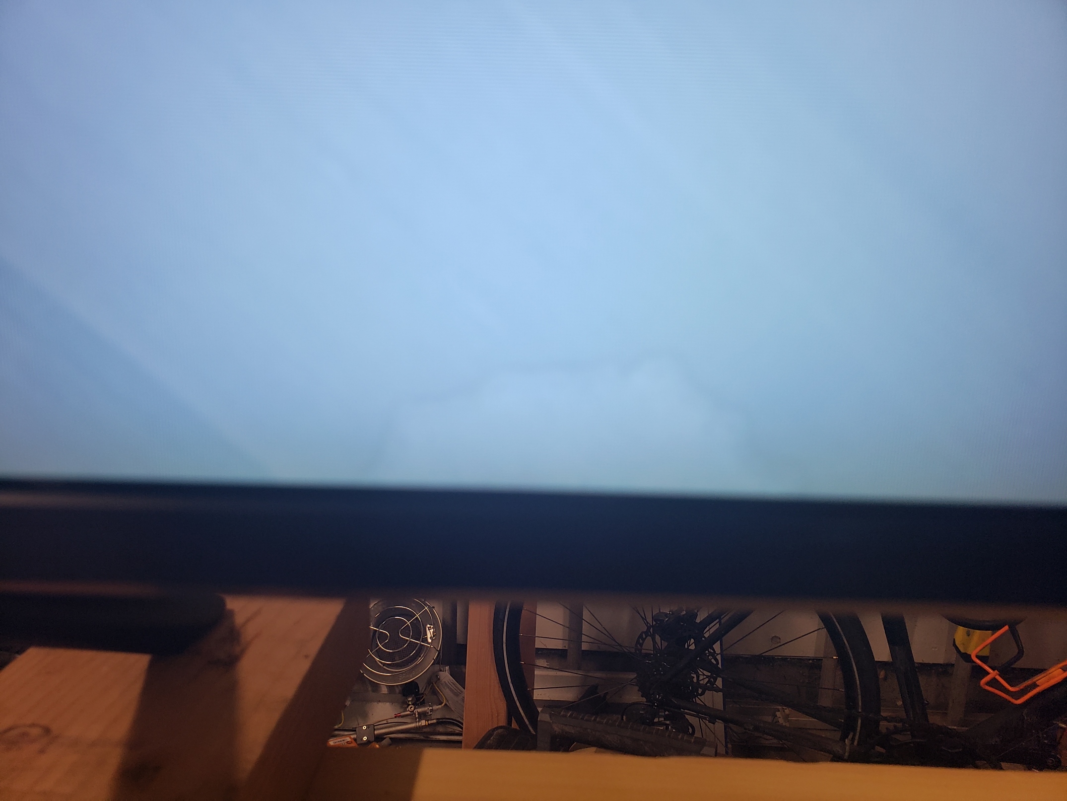

      This saved me a lot of time. I got a set for peanuts from a fellow who had given up on a QN65Q60R that was boot looping. He had attempted to block traces on the LVDS cables and had concluded there was a short on the board. With the help of a infrared thermometer and temp probe I was able to identify a single 6514P ESR protection diode. third in from the left edge. I did a bit of a hatchet job trying to remove it but as soon as I was done I plugged it back in and the TV turned on and stayed on with the full image restored, no lines, artifacts, etc.
      Save for a 'water spot' near where I was working in the lower left corner. It might be flux (yeah, I know) or simply IPA I was using to clean. The use of an air compressor to dry probably exacerbated things, pushing the material up the COF cable. (Frankly, I didn't even know fluid could travel, apparently along the inside, of those cables) I've tried to gently heat the panel from both sides and carefully apply some negative pressure by shop vac - so far without any luck. The spot might just be getting smaller on its own but it's only been a few days. If any one has any advice on how I might ameliorate my blotch, I'd appreciate it. Otherwise, thanks a million for this thread. It was a marvelously simply fix.
      One last question for y'all. What is the best explanation for this failure? It seems the diode failed in the open state with high resistance either direction versus a shorted diode. Was this simply a defective component or did it fail while actually protecting data lines from ESD, power surge etc.? It won't be an easy component to solder back in place and I guess I'd like some peace of mind if I decline an attempt. Thanks!
      Note the blotch changes tone with viewing angle / pics taken at same time

        I had the same issue and also repaired by replacing with 6514p from Digikey on a Samsung. I have since repaired another tv (nec 55”) by simply removing both of the esd diodes and NOT putting any back in their place. I use heat tape on the cof cable strip and a terry cloth damped with isopropyl under the strip to soak heat and avoid lifting the pressed and glued strip. Then generous amount of flux and chip quick solder to knock them off then follow with iso then more flux and desolder wick to clean up remaining solder. Many TVs don't seem to have these diodes and the newer ones that do have them tend to fail easily.

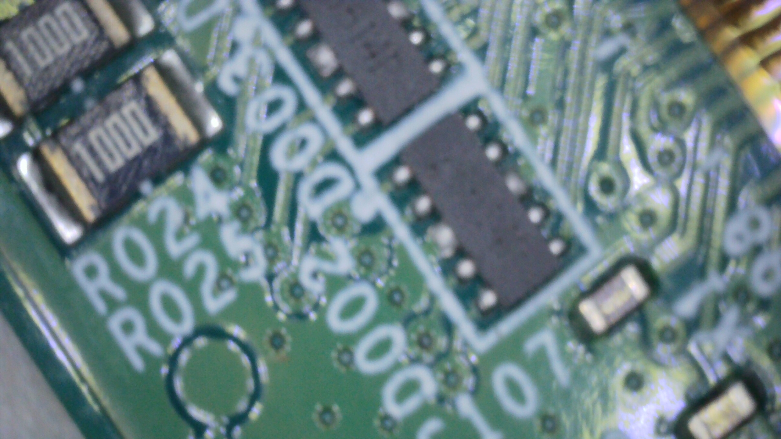

          Hi. My tv (QN55Q60RAF) has the same rebooting issue. The cluster of diodes that contains D001 is extremely hot on the left side of the LCD panel.
          I am inexperienced in soldering and removing components - what kind of equipment would I need to attempt removal? And are there any tutorials out there that could help me? I've images of the hot cluster below. Thanks!

            I used OnSemi part SZESD7004 and that Did not work. I guess the 6514p seems to have an additional diode on the 3,8 pins.. maybe that's the difference? Anyway I have those on order, just now sure why the OnSemi parts didn't work.

              Do you have a part number for these diode pack anybody? I removed the D002, the TV was working fine then I installed the OnSemi ESD7004, someone recommended on a different post, and now the TV is rebooting ago, though the pack is not getting hot.
              We removed it and there is no need to install anything else, everything will work fine, these diodes do more harm than good.

                  I guess the 6514P is bidirectional and the one I used is unidirectional? Can't think of why else it wouldn't have worked. Can't imagine they just added clamping diodes just because. The fact they failed, tells me these are taking heavy hits, so running without them may not be very smart - I'm guessing Click image for larger version

                      Confirming that uClamp 6514P works fine to replace the defective IC. ESD7004 (non-bidirectional) DOES NOT work.
