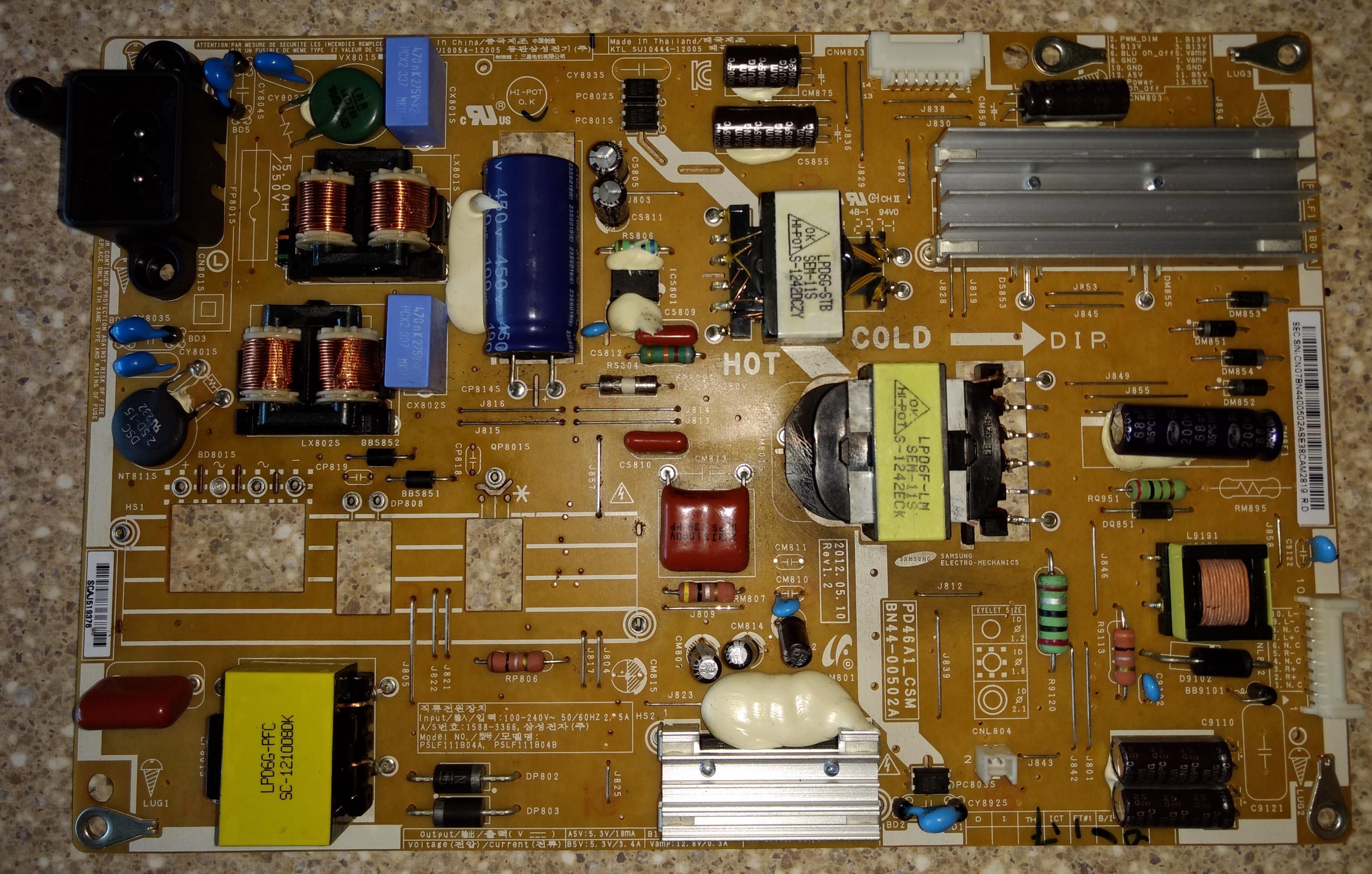

    Hello everyone!
    I'm needing a schematic for a Samsung Power Supply part# BN44-00502A. Can anyone help me with this? I checked the usual suspects, Electrotanya etc. and have had no luck.

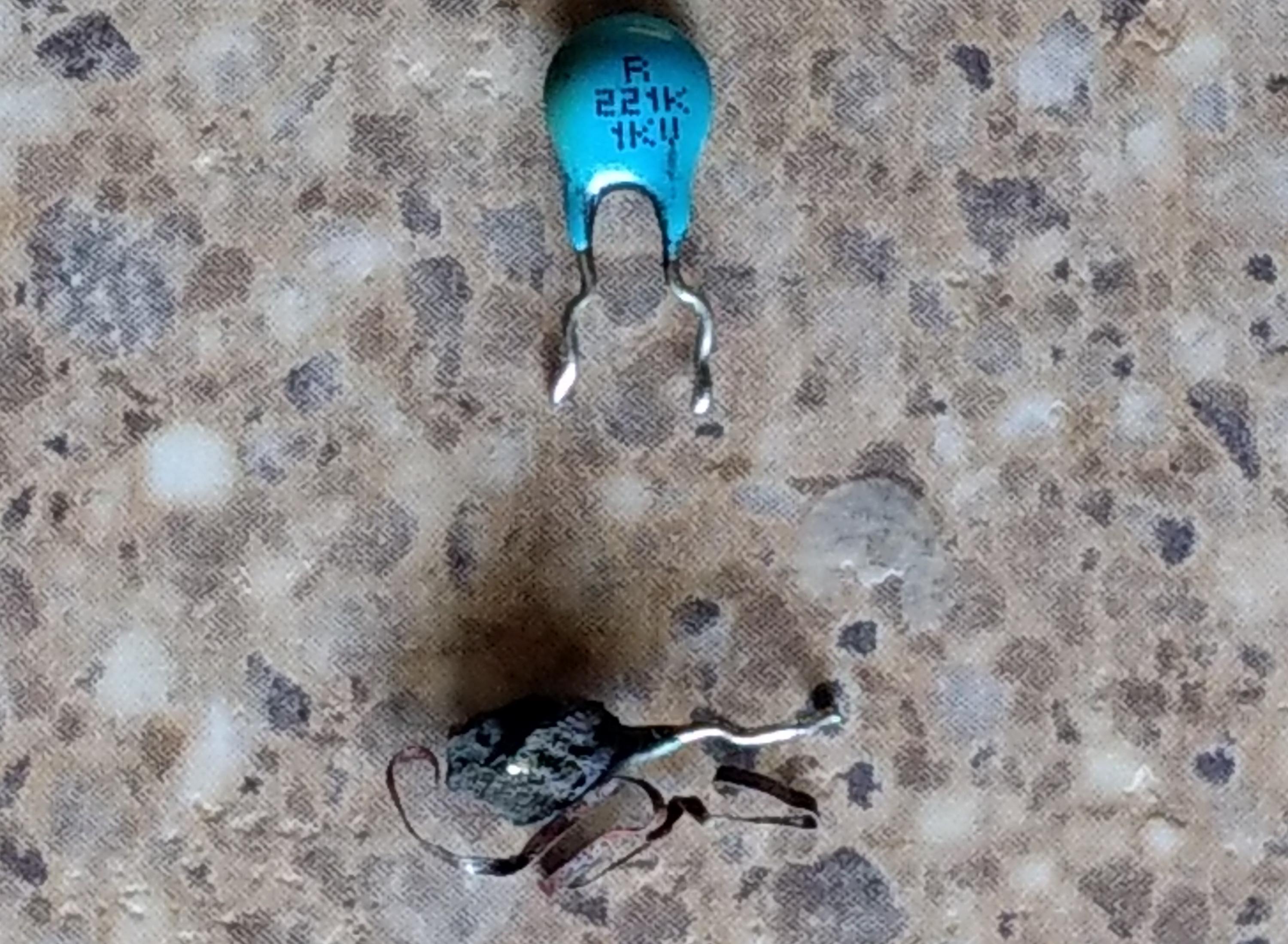

    In particular I need to know if capacitors CP818 and CP819 are the same value?
    CP819 appears OK (at least not short anyhow), but CP818 was blown to smithereens. There's no getting a value from that one! It looks like it even caught fire as there was a smoke trail and soot on the board from that cap up!
    Thanks!

    There`s no schematic. Found a repair kit on ebay, if the cap values in the picture are the real values then they are the same https://www.ebay.com/itm/154313170055 ,its worth checking the other parts listed in that kit to find what made that cap go up in smoke

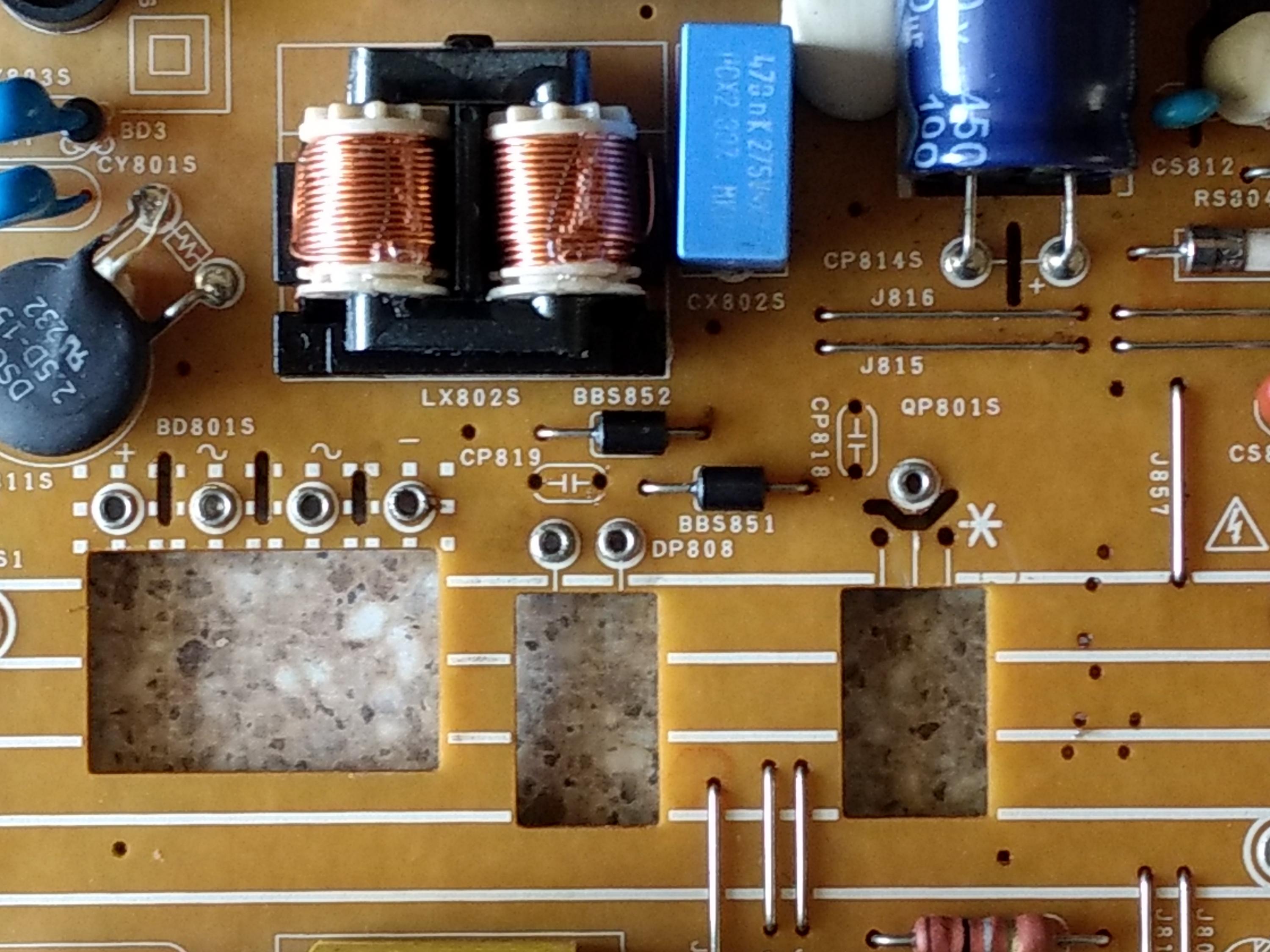

      Of the components that come with this kit here's what I found on the board:
      Fuse FP801S was open
      The Rectifier Diode BD801S had good diode readings (about .5) on three terminals and did not reverse bias on any of them, but from the - to + terminal the reading was .950, a bit too high so it will be replaced.
      QP801S was shorted across all three legs and will be replaced.
      Diodes DP802 and 803 tested ok.
      Diode DP808 did not reverse bias and tested at .420, but will be replaced for safety's sake since it was closest to all the carnage.
      Capacitor CP819 tests OK. Capacitor CP818 was trash. Both will be replaced with ones I have in-stock.
      Diode D9102 tests ok
      Resistor RQ951 tests short in-circuit. Diode DQ851 also tests short and does reverse bias in-circuit, but both are in-circuit with transformer TM801S. As I'm installing the kit I'll probably de-solder and lift one leg of each to verify.
      I'll likely replace ICP801S due to the carnage near QP801S, and because legs 5 and 6 test short to each other.
      I'm not sure if I will replace IC9101 unless there's an issue with the backlights after the repair. I'm pretty sure this is the LED Driver IC.
      My only remaining question: On the blue plastic caps does it matter in which direction they are installed? They aren't polarized like an electrolytic are, correct?

        The caps are ceramic and non polarised

                  Ok, I installed BD801S, QP801S, DP808 and CP818 and 819...and I have a result.....kinda.
                  Immediately after installing the PSU into the TV I turned it on and it looked good, so I went in to the other room to get an antenna lead. When I came back the TV was in the process of re-starting on it's own. It then stayed on for about 10 minutes.
                  The next thing I know I hear a faint but rapid "clicking" noise. The TV shut off and tried to re-start but turned right off. The stand-by light turned on solid, blinked 2 times, came back on solid, repeat.
                  This is a very similar scenario to the PN51F8500AFXZA I just worked on with a bad PFC Mosfet. It turned on but there was a clicking noise coming from the PSU. I re-did the solder joints and it worked OK for about a week.
                  I started thinking about common denominators between the 2 TVs. Both "repairs" were done with an old soldering iron tip that wasn't in very good shape at all. This has me wondering if the solder joints are contaminated.
                  So this may be a dumb question.....but here goes. Could contaminated solder joints be causing the problem? On the surface they look good, but I can't see inside the joint to tell. I tried to keep the iron's tip as clean as possible, and I used flux too so I thought the flux would help keep the joints clean.
                  Boy I feel full of stupid questions a lot here lately, but at least the TV turned on and the screen is good!
