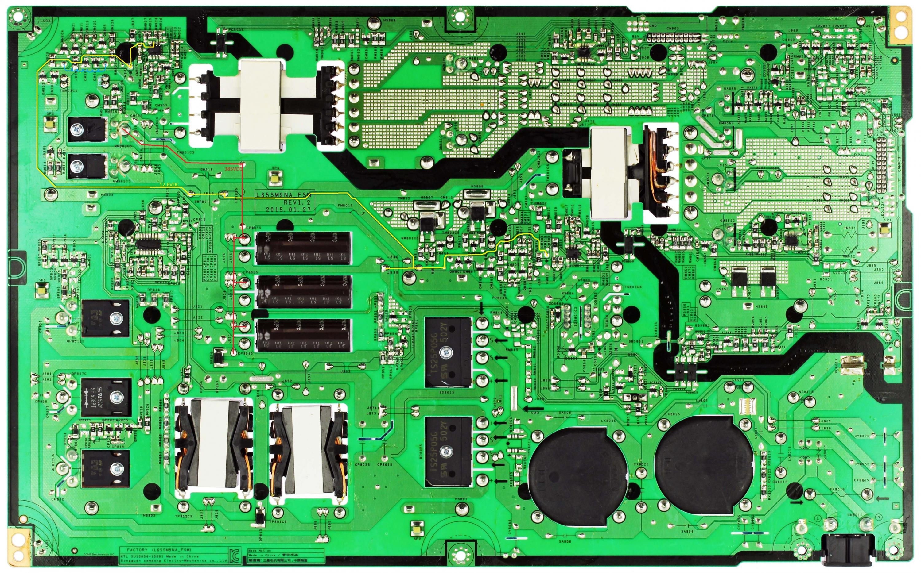

65js9000 power supply bn44-00818a
  • thuss
    • Jul 2012
    • 321
    • uk
    Re: 65js9000 power supply bn44-00818a
    Originally posted by Storyteller12
    Double check all the parts your mate replaced and make sure he replaced them with the correct ones. Also I’ve gotten knock off parts before from eBay/ Amazon. It’s always good to order from a reputable place to make sure your getting genuine parts.
    Sounds like the problem is coming from the primary side for sure though.
    My mate said he used a adp3110a and for the primary mosfets fdpf20n50 and for the secondary stf80n10f7 from a very reliable company. Maybe the adp3110a isnt up to the job.......

      Have you tried unplugging the main board from the power board and plugging the tv in to see if the backlights light up and stay lit?
      • R_J
        • Jun 2012
        • 9588
        Originally posted by thuss
        Sorry about late reply both bridge rectifier ac value is 242v
        Both rectifier dc values is 249v.
        The primary cap cp803s value whilst on standby 364 v dc whilst on 396 vdc
        Ok good, You have good standby 5.3v and also the PFC circuit is working,
        The voltages you are missing are the +30vdc and the B13v, correct?
        If this is correct, check what the VCC voltage is for ICM801, check across CM801 (10µf/50v)

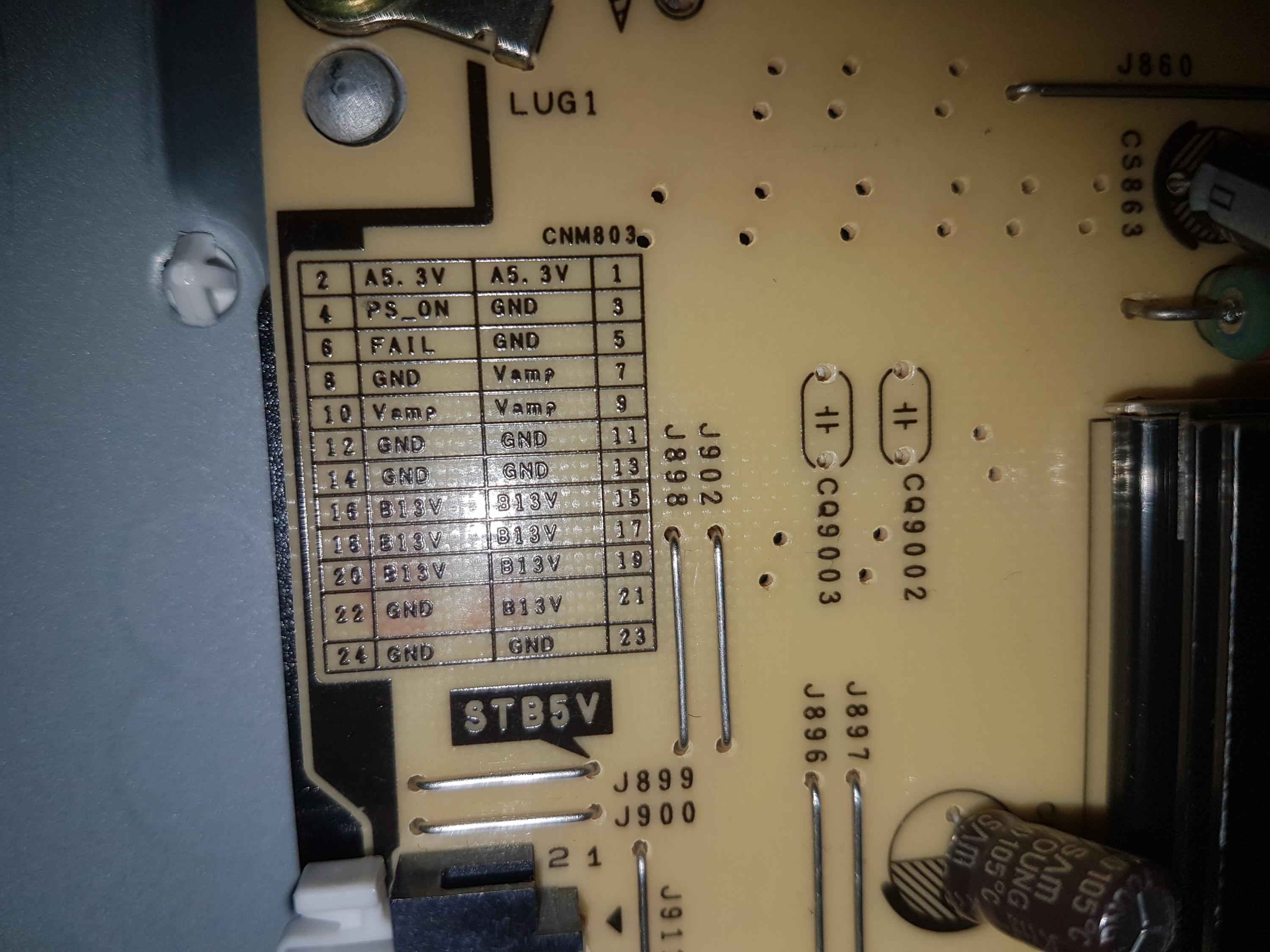

              The B13v can be measured on the connector CNM803, pins 1,3,5, or 7, The 30v should be on J860 or the component hole of RM994 labeled Vdrv The 30v is the supply for the backlight circuit.
              If the main board is disconnected from this power supply, the backlights should come on (if the led's are ok)
              After looking at the board, legend, The Vdrv may only be 30vdc
                Yes thanks will do- i got all the voltages on cnm803 my pin numbers are a bit different?
                Vamp was 18.3

                        Check the VDRV voltage please
                        • thuss
                          • Jul 2012
                          • 321
                          • uk
                          #32
                          j860 0volts also the the vdrv pin hole 0 volts also all my b13 voltages are present
                          Vcc across cm801 was 15.6vdc
                              It's hard to trace the circuit using the board pictures. Have you checked FP903S fuse? is this the one that was blowing and was replaced in post #1?
                              Next to the fuse there is a jumper J849, this jumper should have 15vdc, it is the vcc for the sem3110a
                              I thought the B13v and the Vdrv, was from the same power supply but it is not with this model.

                                  #36
                                  Yes that is the fuse. fuse is reading 50v ac and the jumper 43v ac and -23.5 fluctuating in dc .very strange
                                  You are using the wrong ground to measure the voltages. You see that big thick black line, that separates the primary from the secondary.
                                  These components are in the PRIMARY so you must use HOT ground. and these are DC voltages not AC.
                                        Your right he used a different meter and there is 15.6v on j849 and as you stated 395vdc on the fuse.
                                        There is no vdrv on connection cn803 the 5v and 13v are there on pins 1,3 but thats it. Thanks
                                        • R_J
                                          • Jun 2012
                                          • 9588
                                          #40
                                          The A5.3V comes from TS801CS, & B13V comes from TM801CS, It is TM901CS that supplies the Vdrv. So recheck that the ic is installed and soldered properly and check all the gate drive diodes & resistors for QM901CS & QM902CS, also check that the drive transformer TM903CS windings are not open. Also check CM906CS, if you don't have a cap checker, make sure the cap is not bulged, if it IS, it is likely open, it provides the ground return for the transformer.
