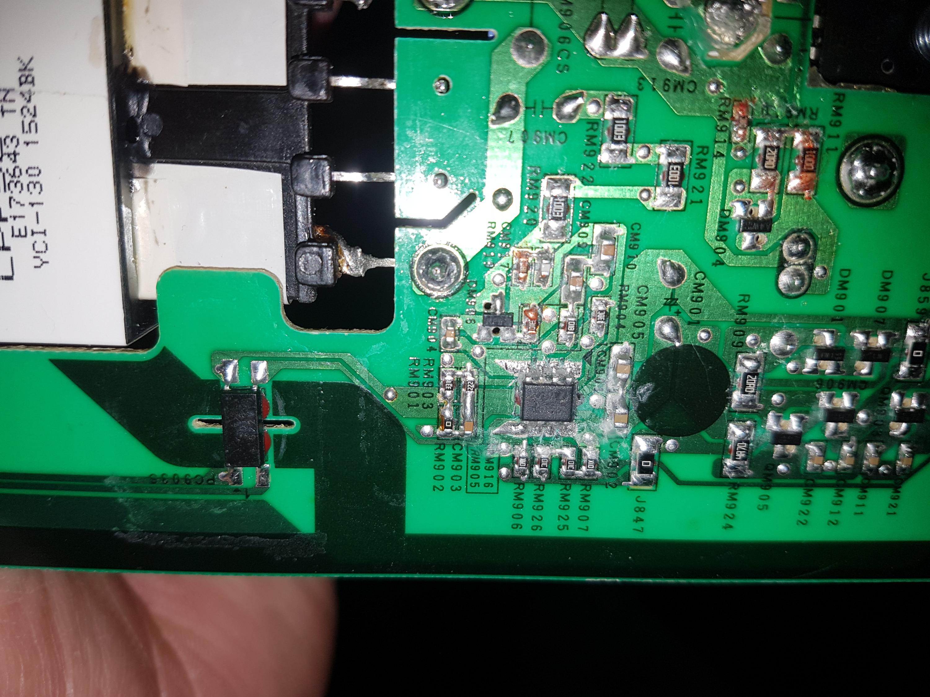

    As per the other threads my mate has changed the 3110a chip, fuse and the primary and secondary mosfet he also replaced a couple of smd resistors a 1000 marked resistor and a 01c resistor.

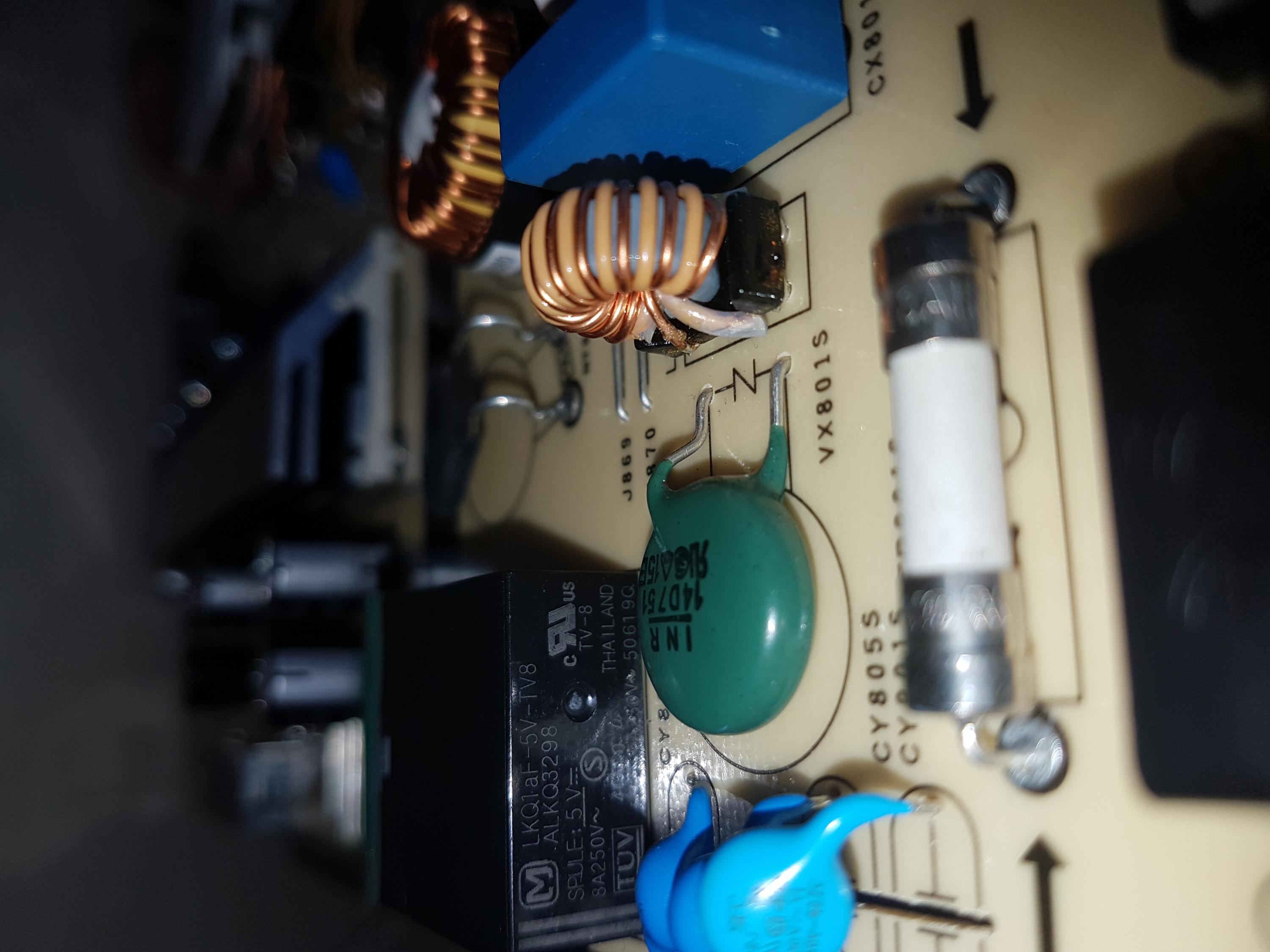

    One last question with ref to the the photo with the transformer what is that whiteish coloured component left of the transformer? Its reading continuously in comparison to the other similar components on the board.

    The white thing to left of the transformer is a standoff, to reduce/remove the possibility of a short if the board bows.

          One thing that was mentioned by my mate is that prior to replacing smd rm914 its pads with nothing in place were reading 100ohms and still reading 100 ohms after he installed a 01c resistor (10k).

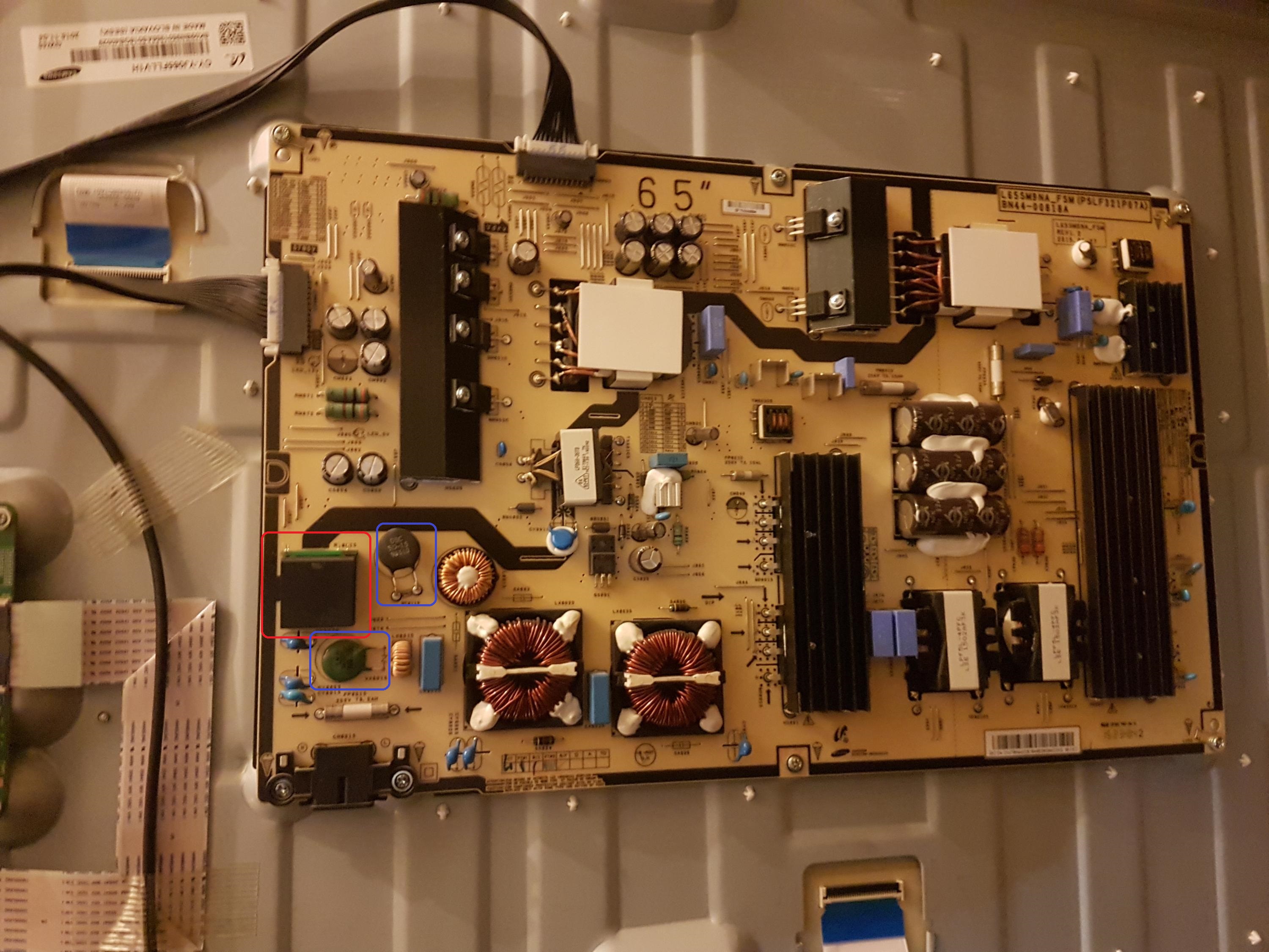

            Have you checked the inrush current limiter.in the blue box. I can't quite make out the number on the board.
            What is the the item in the red box.

              He did say that was strange but he couldnt work it out. He has removed the 01c smd res and rechecked it- it is fine and also the mosfet closer to the rm914 which is fine out of circuit but the outside 2 legs are reading short in situ

                  Sorry, meant the component numbers on the board.
                  Have you checked the inrush current limiter in the blue box.

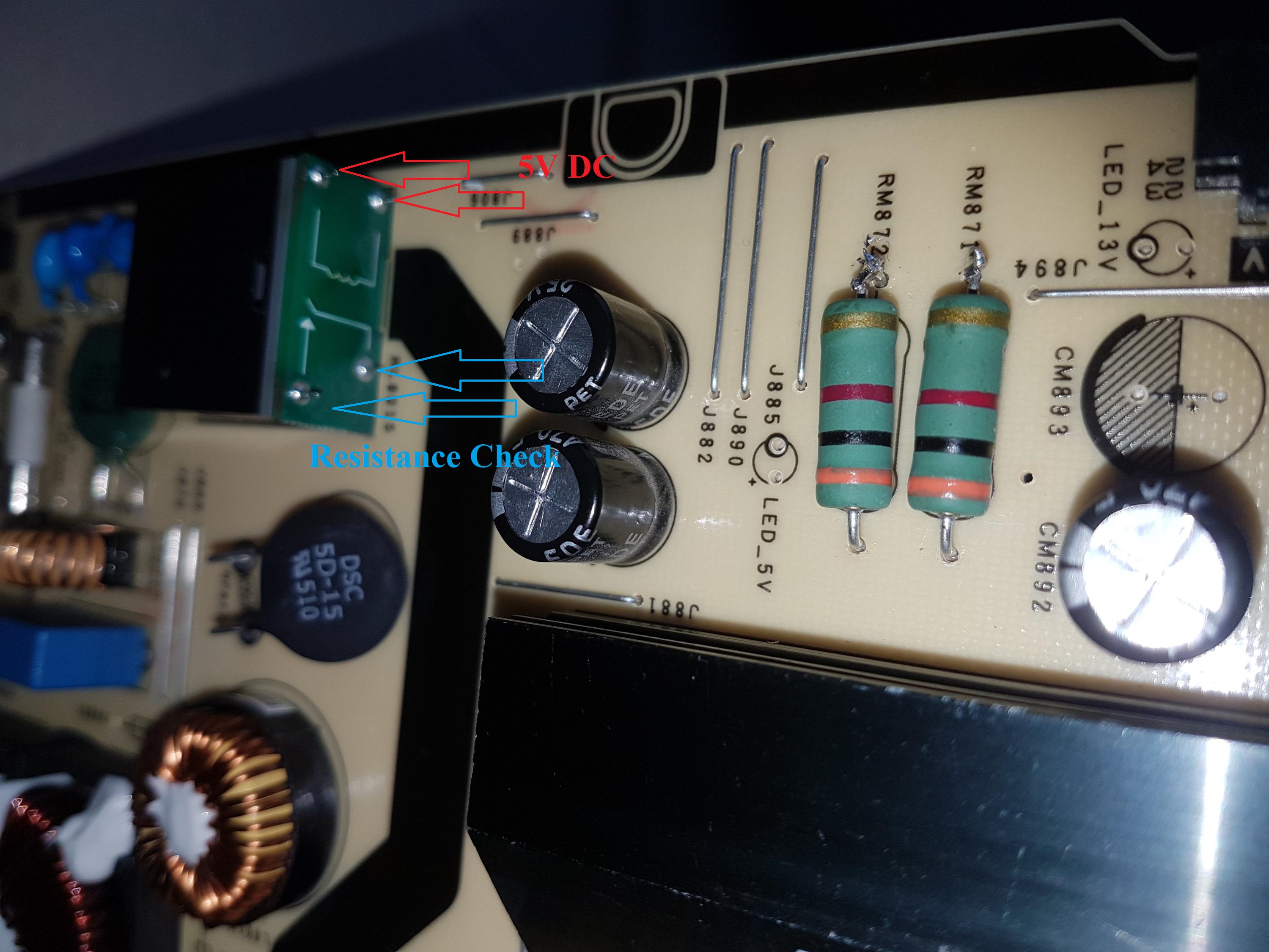

                    Yes he checked the ones you highlighted in the blue boxes. The red box please see attached photo its alkq3298 a relay

                      Re: 65js9000 power supply bn44-00818a
                      Do you know if it's being activated. Can you hear it click over?
                      Is the relay connected across the varistor. If it's like some other sets I think initially the line current passes though the varistor and brings up the standby voltage which then swithes the relay to short the varistor and allow full line current to flow through the relay contacts.

                        On the reverse side of the relay the two pins on the lhs slightly diagonally place are reading continuous but not with any other legs. The rhs legs do not read. Yes can hear it click and it is connected to the varister with voltages of 125

                          If it clicks then it must be operated. If I read you correctly the left side with the slightly diagonally placed are across the varistor. The RHS will be the supply to activate the relay so there must be some voltage being applied.
                          It appears to be a 5V, 8A relay.
                          With the set power off can you supply 5V to the RHS (coil) and use you meter set to ohms to check the resistance of the LHS contacts.

                            Sorry cant do- as my mates taken all the equipment but the varisters/ blue boxes you highlighted all had 125v on them but will get it checked again - ive read on the yhtead its the boost circuit that could be at fault?

                                    As for RM914, with it removed you are measuring RM811 (100Ω), one end of RM811 connects through TM802CS to one end of RM814, the other end of RM811 connects directly to RM814.
