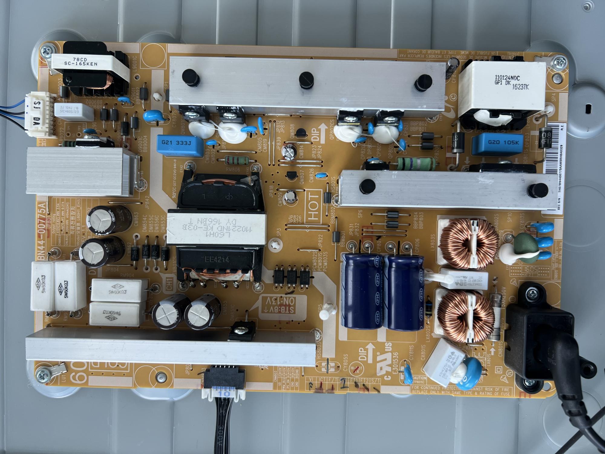

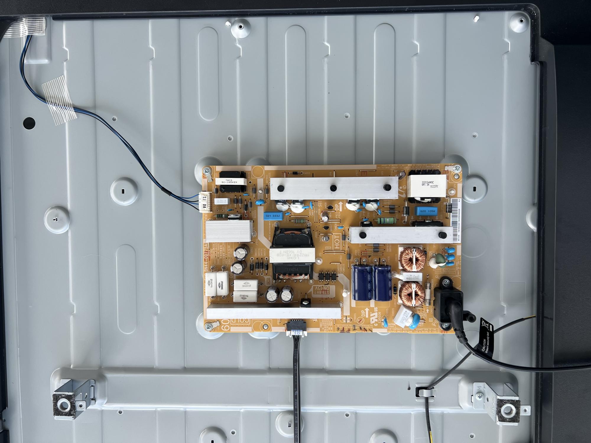

            Hi guys
            I'm working on similar Samsung TV UN60J6200AF.
            When I plug in power cord, the red light lights up.

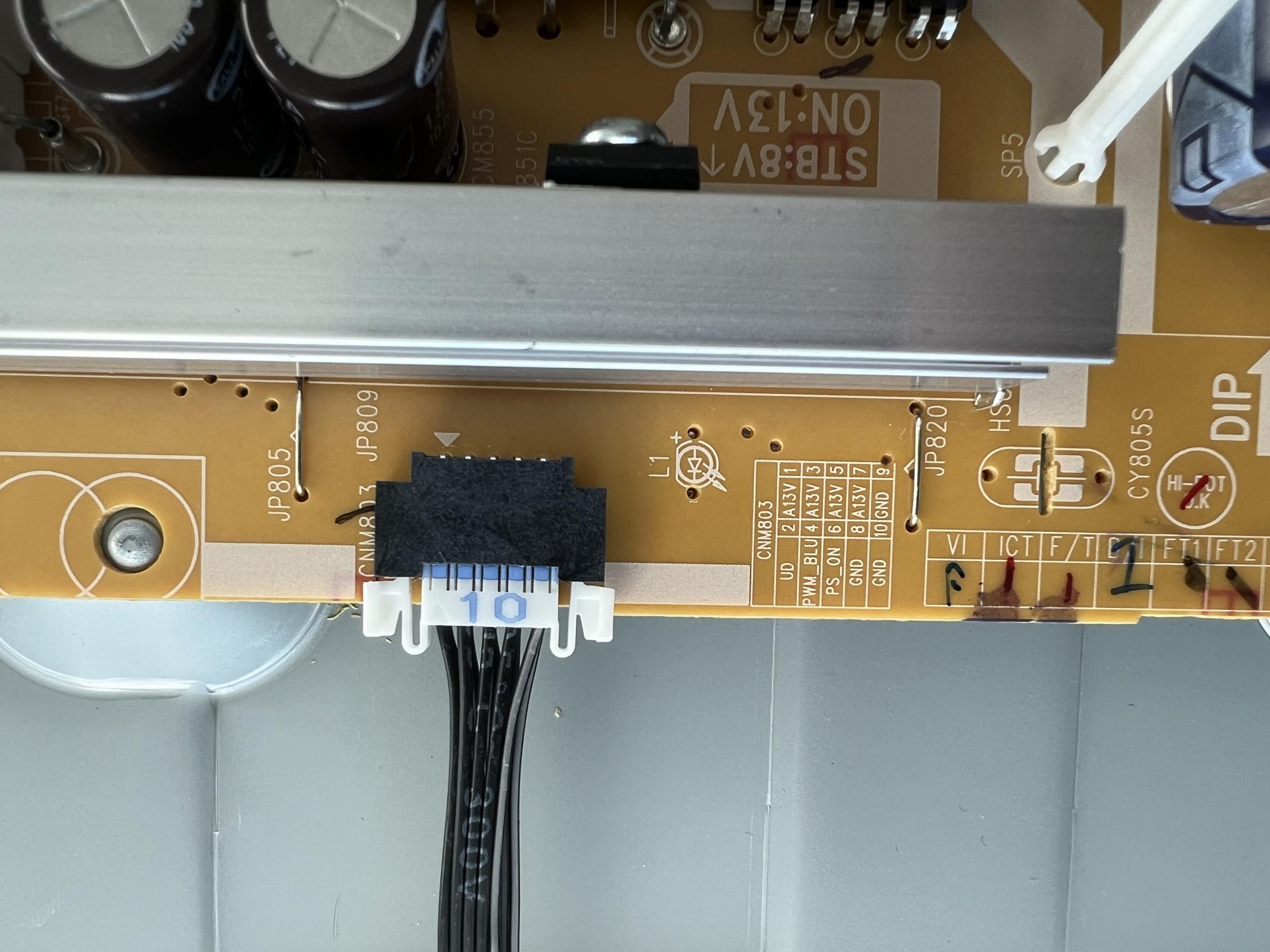

            I measured on the power supply board, and even without pressing the power on button in getting on CNM803 (which goes from Power supply to Main board):
            UD = 2.3V
            PMW_BLU4 = 3.3V
            PS_ON = 4.4V
            A13V = 12.75V
            I looked at the manual and all the voltages are correct.
            When I unplug the main board from the power supply, LED lights are supposed to come on. However, non do come on.

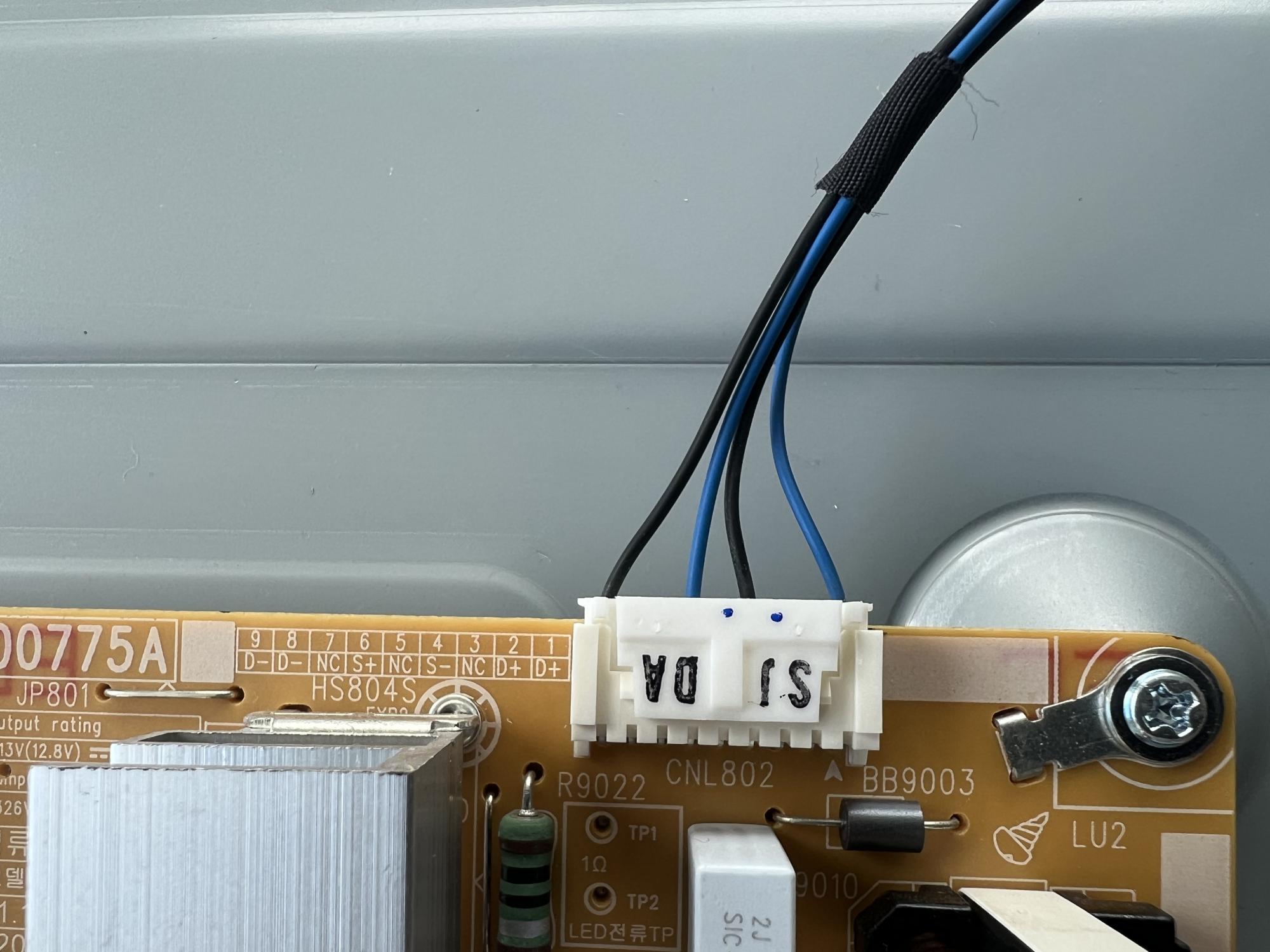

            I then measured at the LED connector CNL802:
            D+ to D - = 419V
            And yes, that's 419VDC lol.
            Is it safe to assume all my LEDs are burnt? Also CNL802 only has one positive and one negative connection. I'm assuming all the LED strips are connected in series.
            Should I try to light up the LEDs with a tester next to verify they work?
            Any other ideas what to try? Why is the DC voltage so high, is that normal?
            This is the first time I have ever opened up a TV, but it's a lot more fun than just junking it.
            All your help is much appreciated.

              check LEDs with tester. I think they are all burnt. 419 vdc s too high.check for a mosfet on solder side, i think D- is not directly grounded.

                Re: Samsung TV - no backlight, except when mainboard disconnected
                Thank you, I will check LEDs today.
                Correct D- is not grounded. Non of lines on the connector are grounded, which I thought was very strange.
                But why do you think i immediately have fully operational voltage even when on standby mode? Bad main board perhaps?
