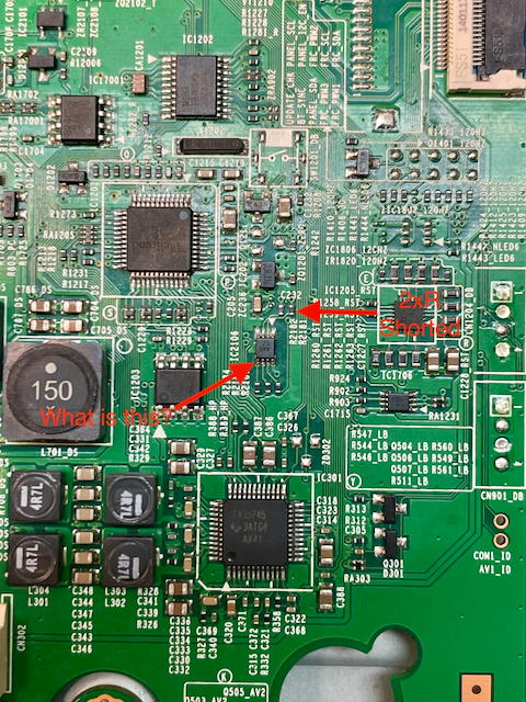

                              • Henke
                                • Oct 2022
                                • 41
                                • Sweden
                                Re: Samsung TV - no backlight, except when mainboard disconnected
                                Thank you for the inputs.
                                I found something strange. A component marked with "AA5"
                                Can't find what that is..I also found a couple of shorted resistors around that component. I marked 2 of them in the picture (there are a few more).
                                How do you now what values those should have?

                                  measure resistors in ohm mode, my meter reads most under 10 ohm resistors as short in continuity mode but they are not, if resistors are in parallel then the resistance will be half the marked value, instructable there for determining values: https://www.instructables.com/Readin...esistor-codes/
                                  • Henke
                                    • Oct 2022
                                    • 41
                                    • Sweden
                                    i measured i ohm mode. In this case they are not in parallel (i know that formula), they are going to separate legs on that AA5 IC. They are so tiny that it seems like they don't have any numbers on them.
                                    • nomoresonys
                                      • Jan 2013
                                      • 12210
                                      • U.S.
                                      not exactly sure but if all those other tiny resistors dont read short, then you might have found the problem or at least part of it, but how to find their value is a good question if not marked.
                                      • Rajnhl
                                        • Oct 2018
                                        • 94
                                        • India
                                        resister never short. they open dead or their value increses.
                                        AA5 ic looks like eeprom 24cxx type.
