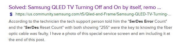

    Re: Samsung UN65LS003 BT/Wifi issues becoming more widespread
    Originally posted by NizNoz
    I'm back at work.. will check when I get home later.. but I can seem to access any menu without the box connected. Perhaps I'll try getting into the service menu.
    The only voltages I checked in the box where between the SMPS and main board. They were fine as far as I could tell.
    Also, I noticed “Serdes” error counts. I have no idea what that is, but have seen some mention of Serdes in the context of fibre optics.. so maybe implicating the box?
    Whilst the the link require a Samsung account, the summary suggests it's the fiber not the box and haven't you already changed the mainboard in the OneConnect box?
      Thanks diif! I'm registered on the site and have searched for serdes in the past with on luck.. Even googling that specific post returns a "you do not have sufficient privileges" error. Could you past a bit more of the discussion?
      Weird thing is that all the USB, Ethernet, HDMI ports seem to work fine. I haven't tried audio, and antenna ports though. I didn't change any of the One Connect box boards, only the main board inside the set itself. I tested the DC voltages going from the SMPS to the One Connext main board which wa fine.

        #43
        You've changed tv boards and the one connect and the problem persists.
        Change the cable.

            #45
            Found a bit of a workaround (for now). From one of the screenshots I posted I noticed a second Watchdog Option. “Serdes Watchdog”. After disabling this the system seems stable. All weekend without a reboot.
            So I’ve been running media through all the OneConnect ports apart from digital audio and coax.. No problems, hangs or resets. Any thoughts on what this means diagnostically?
