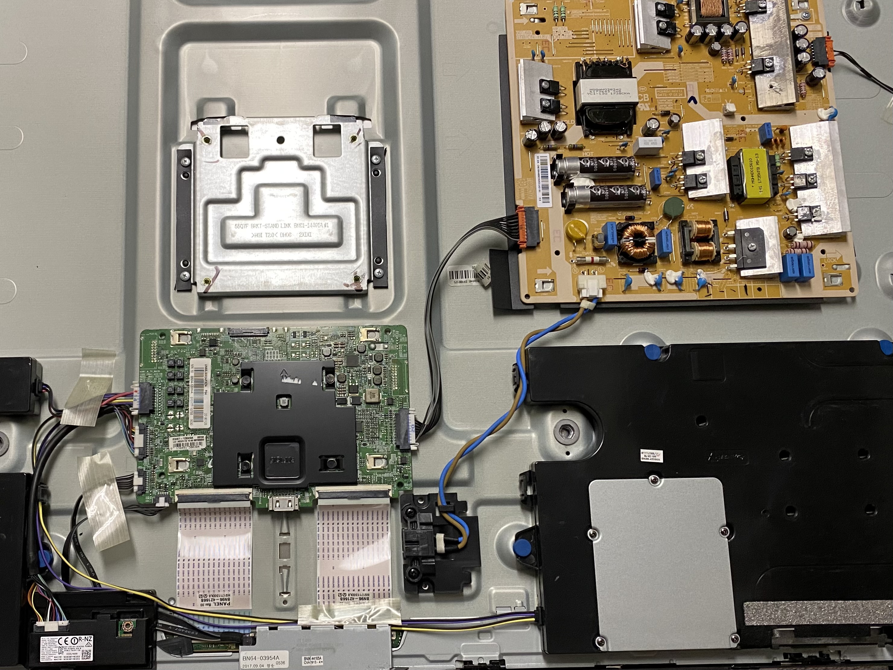

    Here's a pic I took of the three components I've focused on.. wifi module bottom left, main board, center, and power board top right. Not sure if there's much that can be seen from this.. Not sure if this should concern me at this point.. but there are some fingerprints on the heatsinks that I didn't put there...

          The one connect allows other connections to the "frame" (ie. hdmi). Do those work? You probably need to provide close pictures of each board for the forum to help further... this is so people can see the component and voltage labeling clearly.

            As far as I can tell, all the functions of the OneConnect box seemed to work- HDMI, USB, ethernet. When I have a chance I'll take clearer pics of each board. Here's the service manual..

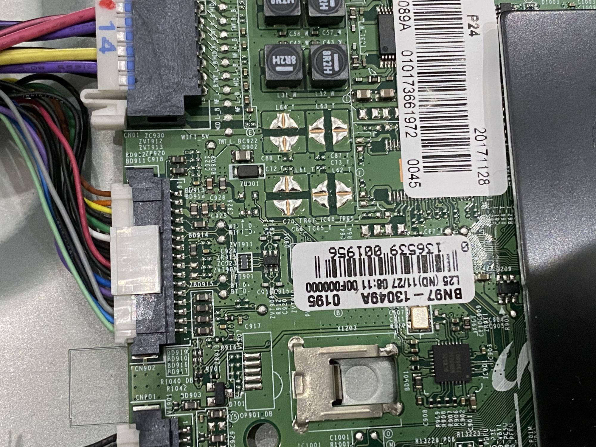

                    Close ups of the main and power board.

                      Attempted some readings (black lead connected to metal interior frame, red on pin. Plugged in)
                      During Standby (CNM803)
                      Pin 1: 3.394v
                      Pin 2: 0.0v
                      Pin 3: 12.84v
                      Pin 4: 0.016v
                      Pin 5: 12.88v
                      Pin 6: 0.018v
                      Pin 7: 12.88v
                      Pin 8: 0.018v
                      Pin 9: 12.88v
                      Pin 10: 0.019v
                      Pin 11: 0.00v
                      Pin 12: 0.018v
                      Pin 13: 12.90v
                      Pin 14: 0.018v
                      Pin 15: 12.88v
                      Pin 16: 0.002v
                      Pin 17: 12.86v

                        you probably also need to same "chart" with the set turned on. Further you need to provide the corresponding labels for each pin. At first glance, pin 1 is some sort of error-count which appears to be set (ie. high voltage... but just a guess). The rest look normal... but again at standby, usually nothing is really being powered.
                        further, page 42 provides a check of the wifi module... have you gone thru that check? You also indicate that your remote does not currently work... right? Do you see the bluetooth pairing signal on other devices (ie. tablet) to indicate that the set is at least sending out a proper pairing signal?

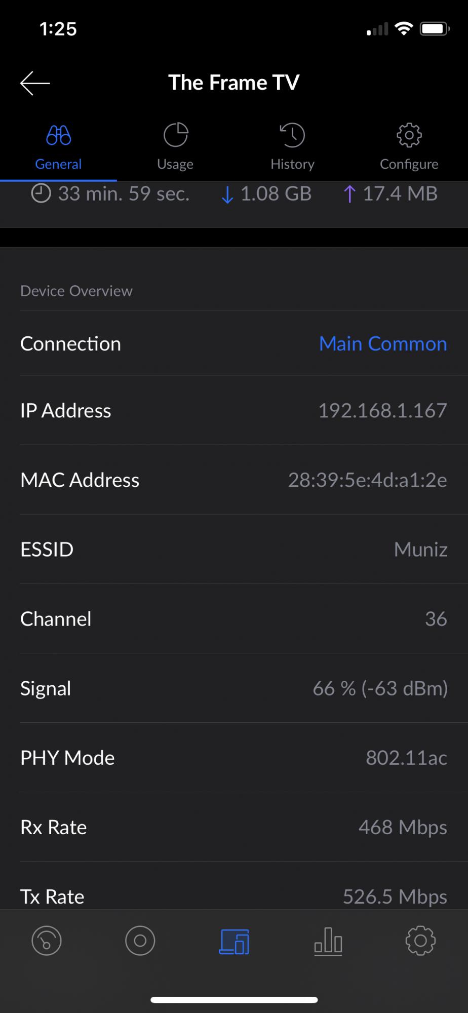

                                        Re: Samsung UN65LS003 BT/Wifi issues becoming more widespread
                                        The previous voltage table was prior to turning on wireless. Both voltages during standby and with TV on.
                                        Previously, when wifi wasn’t working, the TV would show no wireless MAC address. Now wifi is working and shows a MAC address. I think I remember it connecting to 2.4ghz channel though.
