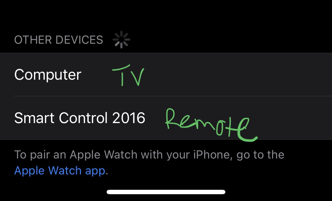

      Here's a pic of what my phone saw when I put remote into pairing mode, and the tv shows up as “computer”. The other pics show the status as issues become worse. 1st: All working, 2nd: Bluetooth lost, 3rd: Both wifi and Bluetooth lost. I don't have pics of where wired MAC was missing (I hope I didn't imagine that.)

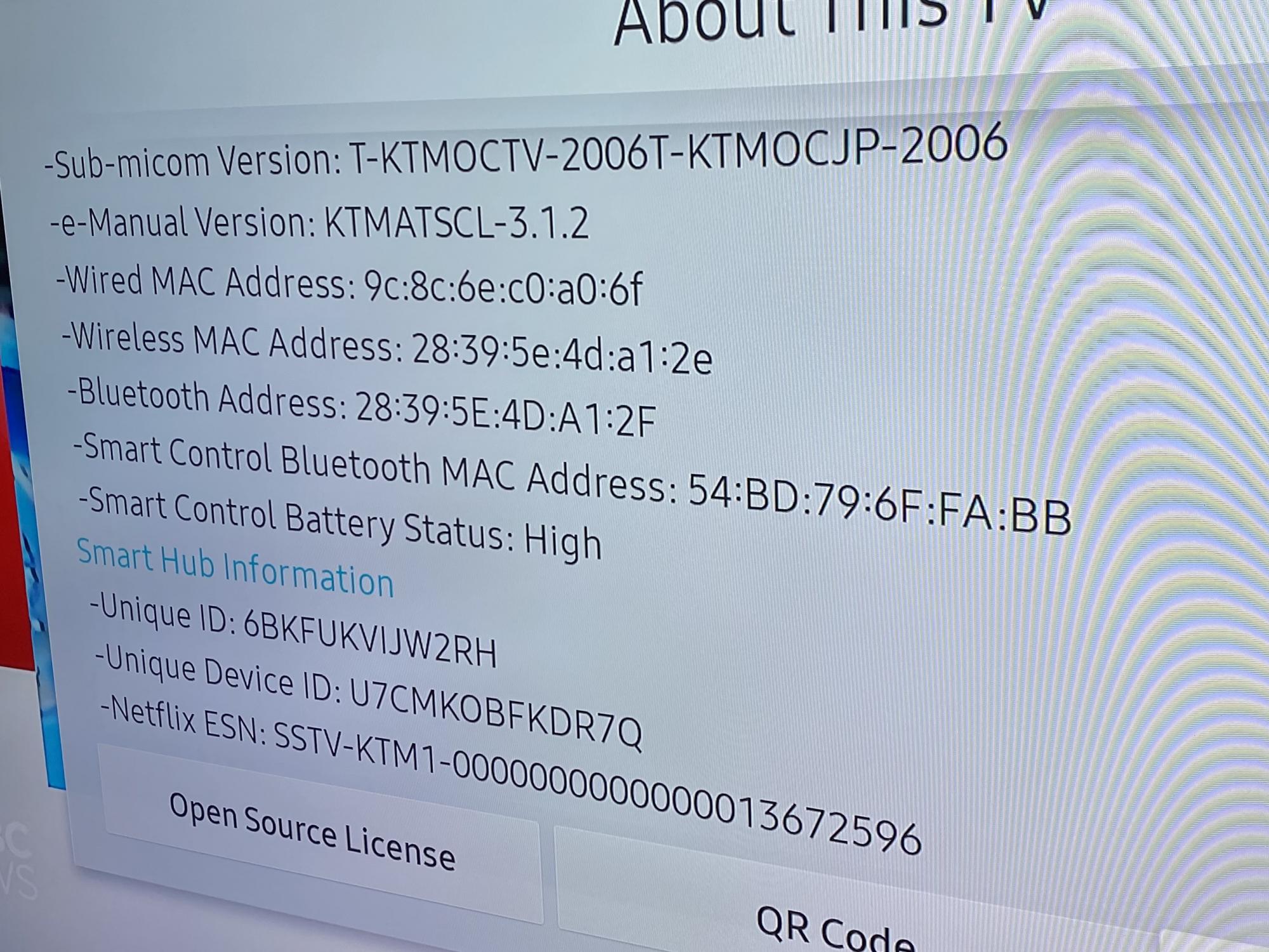

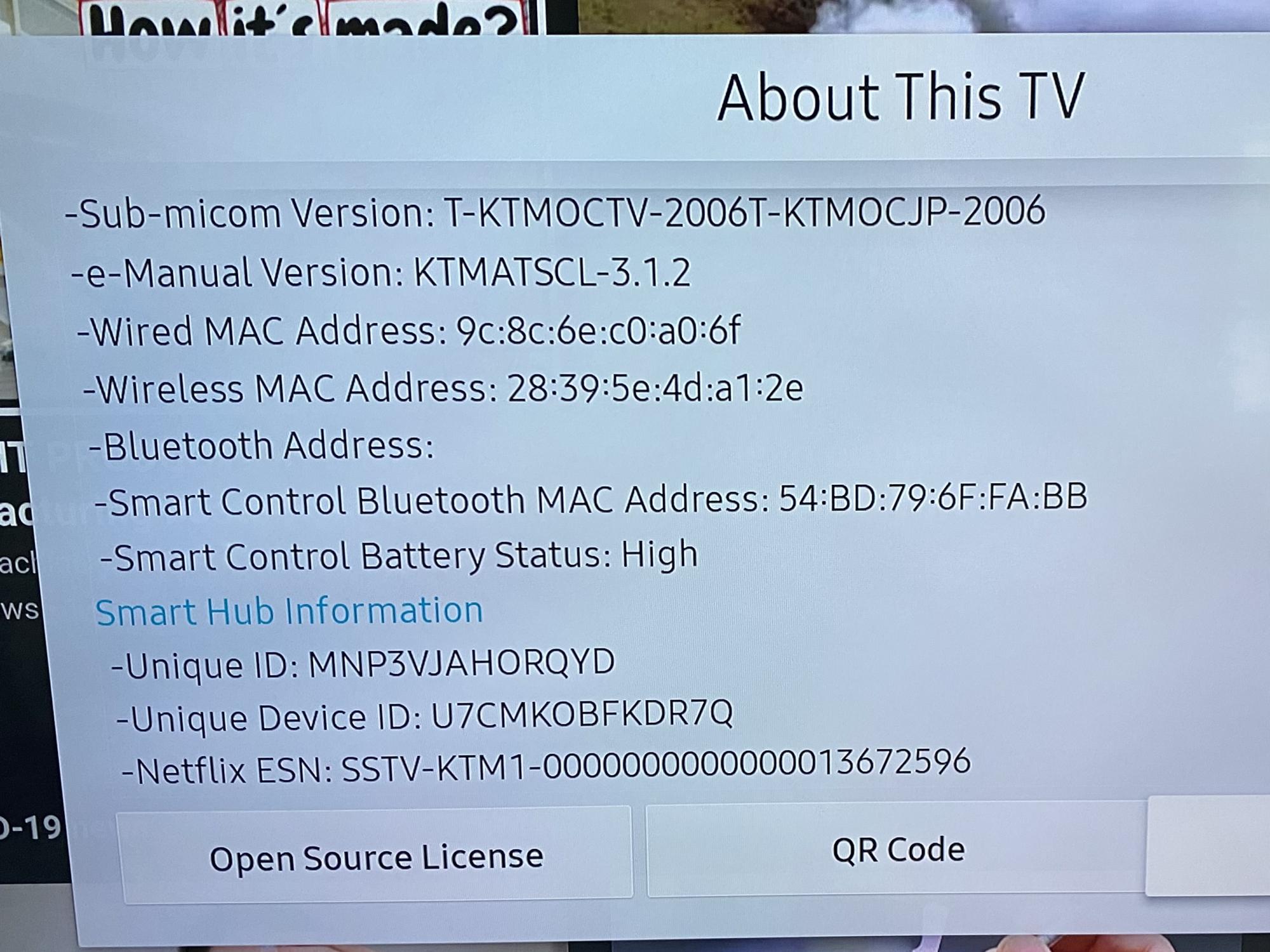

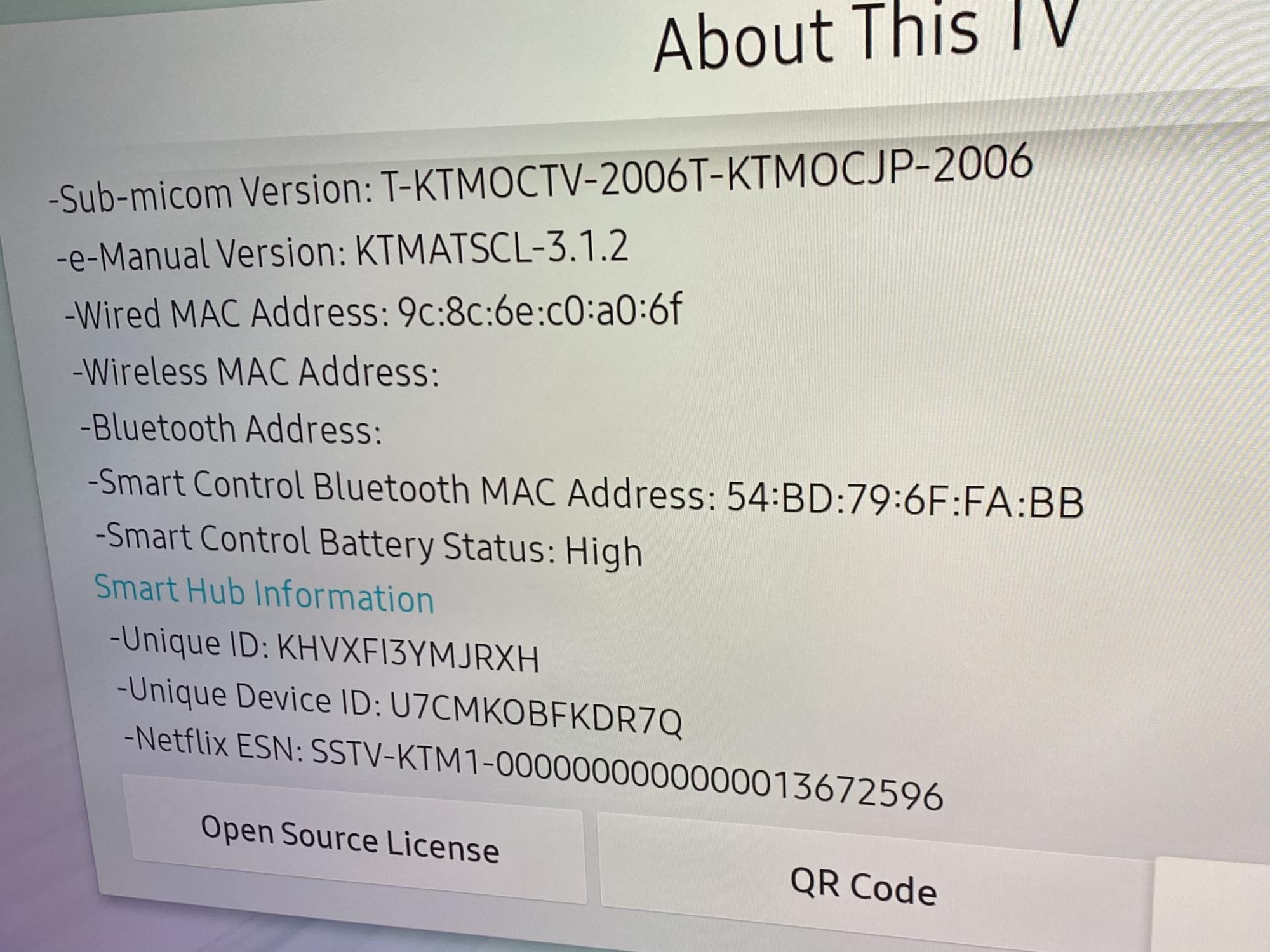

        hmmm... probably getting past my understanding (especially in this tv area), but network problems / adapter interfaces can cause the operating system a lot of problems so it wouldn't surprise me when things go south, that the system (unix / android / ??? ) could get hung and reboots to get out of the problem temporarily or otherwise.
        Probably, the best mode would be to get some form of stability.... probably wired with the wifi / bt interface unplugged and see if the system is stable. Your comment about the back removed might be a good clue. You could try a small usb computer fan or otherwise strategically place to see if it helps. You can also try some "hair drier" type heating (carefully) at locations around the wifi board and main board to see if things go south faster. Might point to a specific component... usually a large IC / processor chip which typically have solder / ball failures in lots of sets. The thing is that you have two mains and wifi that you say follow the same issue pattern which as you suggested might be some form of marginal powering / heated component there in. When you loose your wifi or bt pair, how are you getting it back, ie. what sequence of operations are you following?
        Of course, as you have read, the SM indicates missing MAC addresses points to a bad main board... "usually". I guess the other question, is where did you get the main and wifi board from?

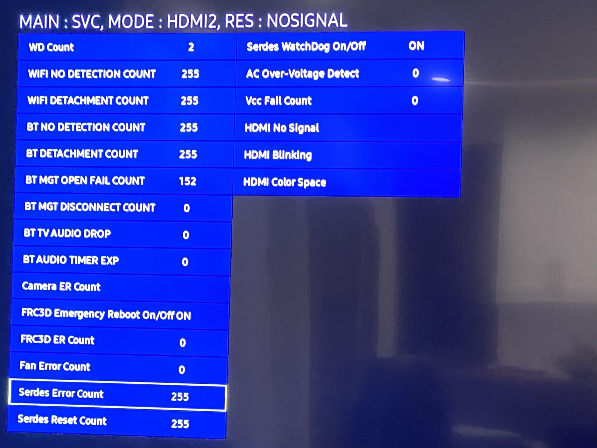

          I did actually check the error counts. Tons of BT and wifi counts. And something called “serdes”. I'll see if I can consistently reproduce the issues. As far as how the BT and wifi get back online? Seems random to me..

            edit: the WD count appears to be a "bad thing".
            edit: serdes... might be some sort of memory subsys... I see from quick search that some links show rambus system which I believe is a bus structure for handling significant comms and memory operations.

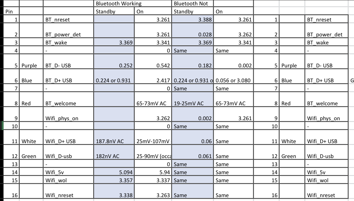

              An update on the table. Sorry, I didn’t realize a bit of the top was cut off before. You were right about the pins with “zero voltage”. There’s something going on, but in mV (AC?). Believe it or not, but the wifi still hasn’t dropped in over 24hrs while the BT drops more frequently now.
              This isn’t really proof of anything, but I wonder.. the heat sink on the main board is definitely hotter as the screen stays on. (Bear in mind I don't really know what's 'too hot for a sink') I was watching the BT_D+ USB pin while I sprayed the sink with aerosol circuit board cleaner. After a few minutes the voltage rose from 0.5v to 2.5v and the remote paired automatically.
              The wierd thing is that this is the REPLACEMENT board. Is it possible there’s the same issue with both the old and new boards? Maybe because of their age? (Built in 2017.)
              How does it unpair and pair? Usually automatically, with no input from me. I’ll try the remote and it works.. then it stops working and is unable to manually pair. Then I’ll try it again and occasionally it pairs ok.
              A google search for Serdes (error count page) seems to show a releationship with optical fibre transmission. So might indicate issues with the OneConnect connection? The interesting thing is how close this is to the heatsink that I think is so hot.
              A note on BT_D+ USB: When the remote is working it's around 2.5v.. then it randomly spikes to 3v at which point the remote stops working. Other times it's sitting around 0.5v when it's not working.

                Update: Woke up and tried using remote. Didn’t work although heat sink was very cool. BT_D+ USB Was at around 3v, but later went to 2.3v and I was able to pair.

                                          Also, I noticed “Serdes” error counts. I have no idea what that is, but have seen some mention of Serdes in the context of fibre optics.. so maybe implicating the box?
