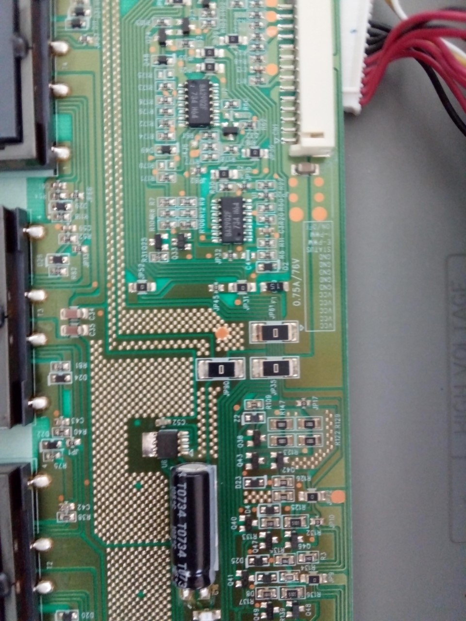

        Re: 42pfl5432d/37 no picture but have sound
        '15' is the fuse code for 0.75A rating.
        If you look at those white fuses that are showing 18V, if you trace out the connections, they will all lead back to 24V pins on the connector.

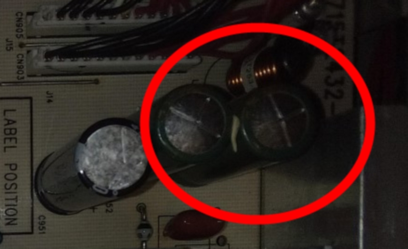

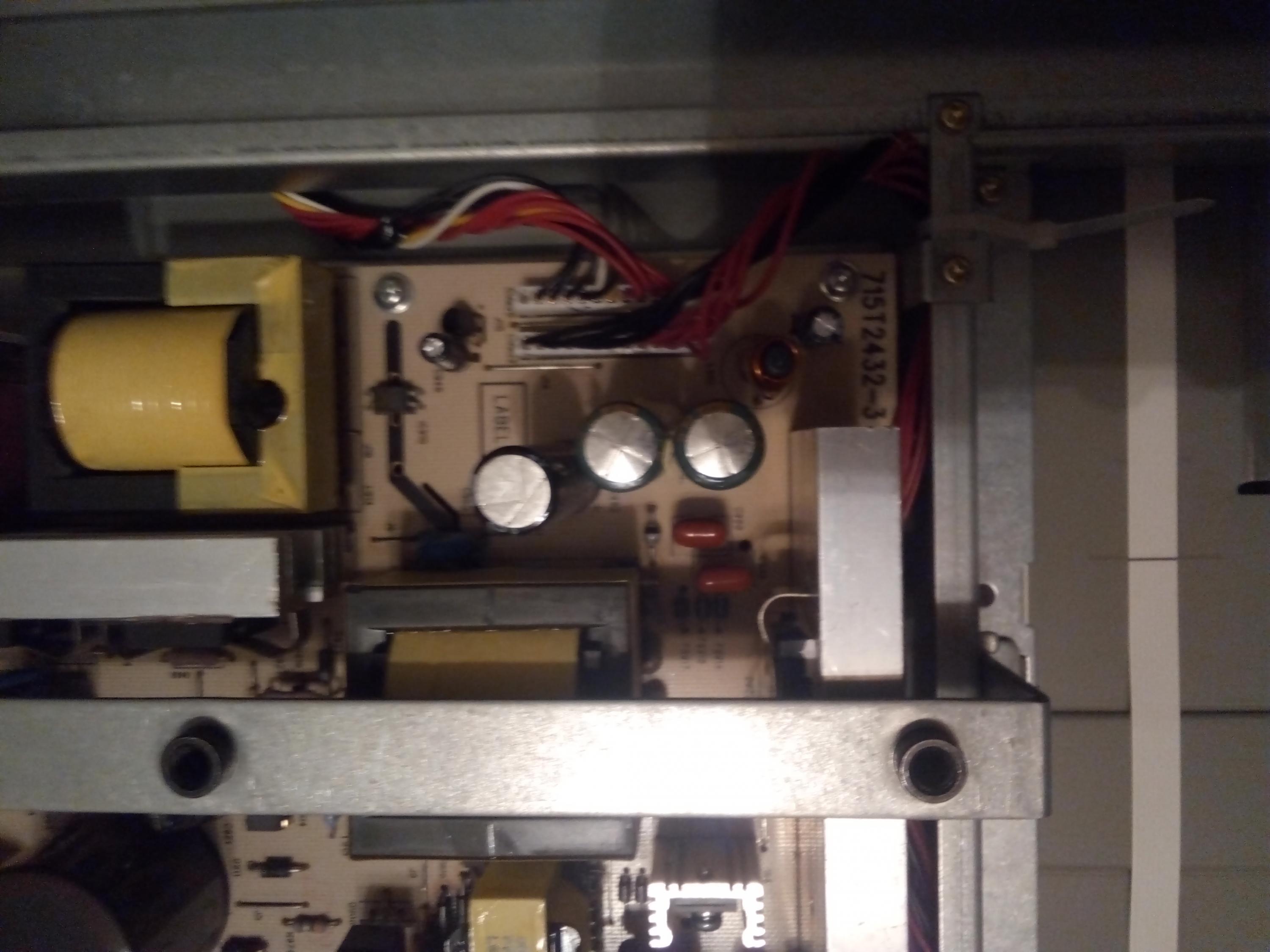

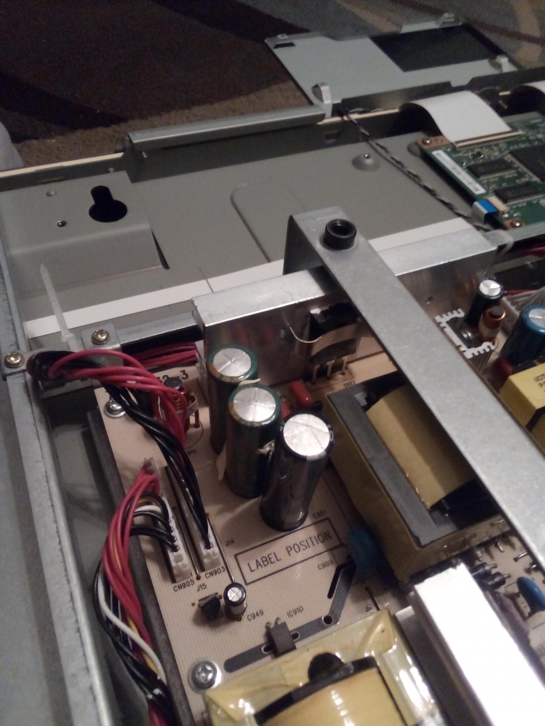

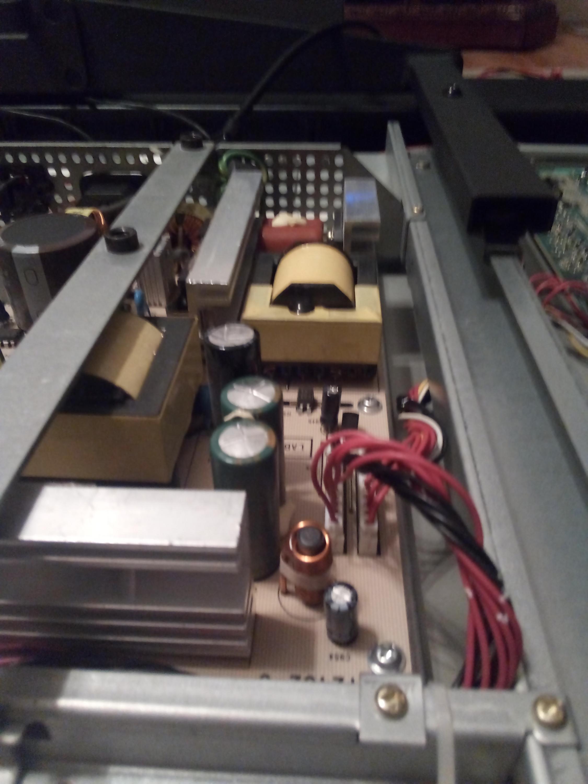

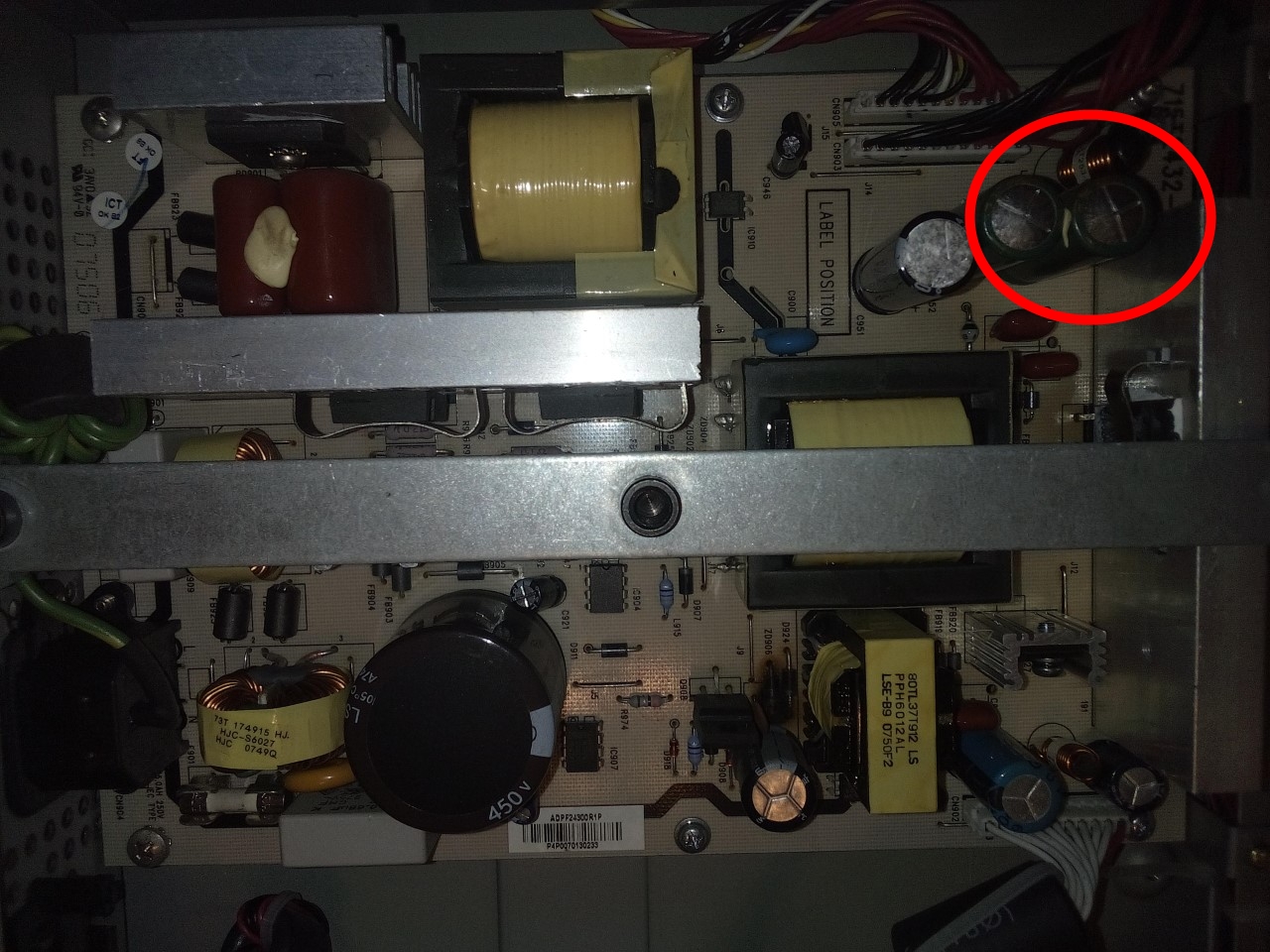

              I just look at your power supply board, I see two caps for the 24V power supply have domed tops, Can you inspect and verify them and provide clearer pictures?

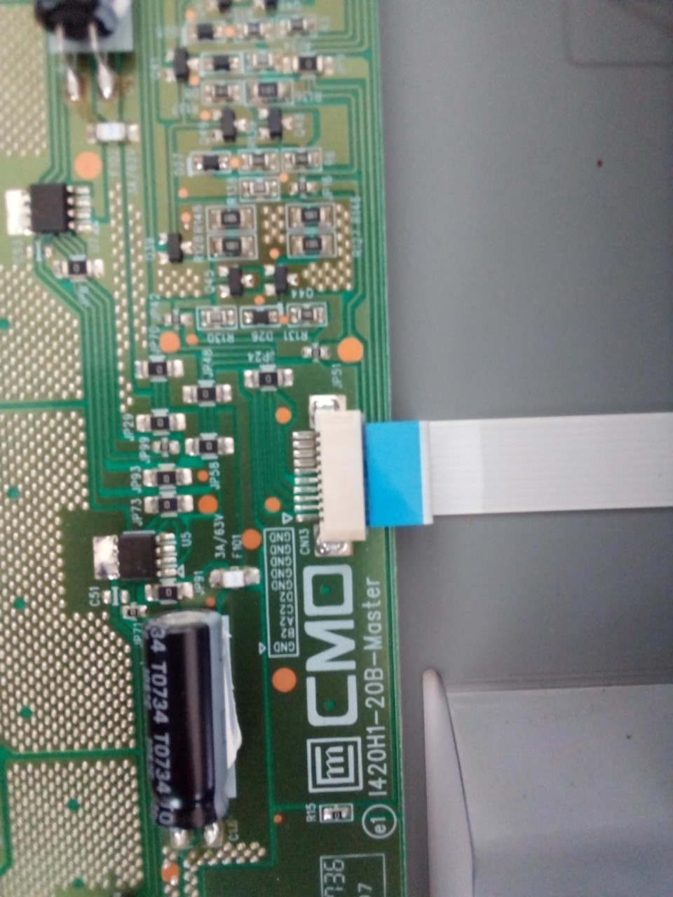

                Here are the pics voltage drop somehow at white fuses
                On main inverter board. It gets 24-25 v on all 5 pins at connector
                  The tops of those two green caps do not look flat to me.

                      #30
                      Originally posted by dsm482
                      Yeah but if am getting 24-25v coming in at connectir,
                      Thats means they are putting out.?
                      The voltage is dropped at 4 white fuses but not fuse 15(f1) next to connector
                      Not going to work as design at heavy load, the inverters can easily draw 5A or more. I would replace all 3 of them that is what I would do first. When cap is domed up like that the ESR will be high and the capacitance can also drop down in value too, you can also have bad cap with no sign of bulging at all but it can have high ESR.
                      If you look at the traces from each white fuse back to the 24V power connector, you will see it all connected through a bunch of '0' jumper (black device with '0' printed on top), to lose 6V on all 4 fuses, it means there is high resistance paths on all 4 fuses feeding lines, one way to find out is to trace Voltage from the 24V pin connector along the traces all the way to each fuse to see where the Voltage drops out occur.

                              here are pics.
                                The bulging caps need to be replaced. If you had a scope you would see that there is likely very high ac ripple on them on top of the 24vdc. This high ripple (noise) can effect how digital circuits operate or in this case don't operate.
