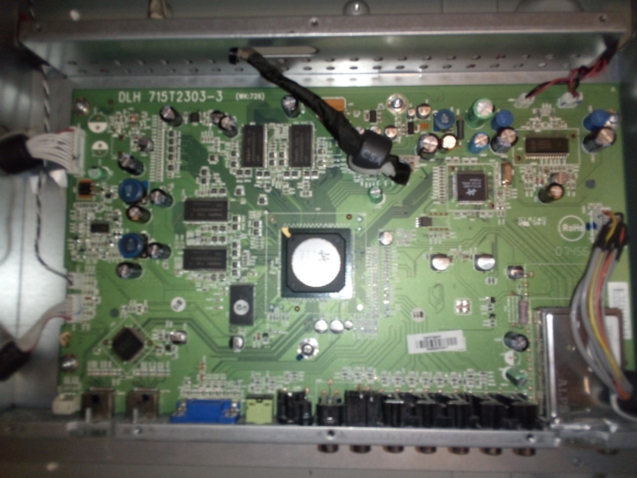

    I got a questions for the TV.. Where is the last guy that runs this forum he helped me last time..
    I got no picture , but I do have sound.
    I took the TV apart..
    Inverter boards look good no Caps blown.
    Also Power supply looks decent with the caps, they were replaced once.
    I checked power at inverter board , the main and slave both get 24.9 volts steady power.
    Tcon board above I looked at looks good.
    The Main board was replaced with new unit from broken TV new.
    Looks like new, and HDMI ports are like new.
    Touch confused, why I dont have picture and nothing is pooping out at me?
    Any suggestions??

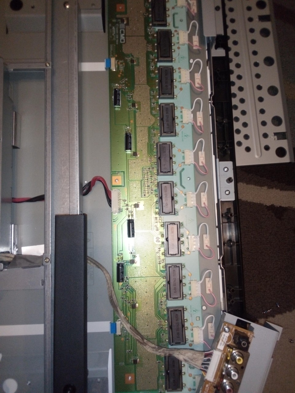

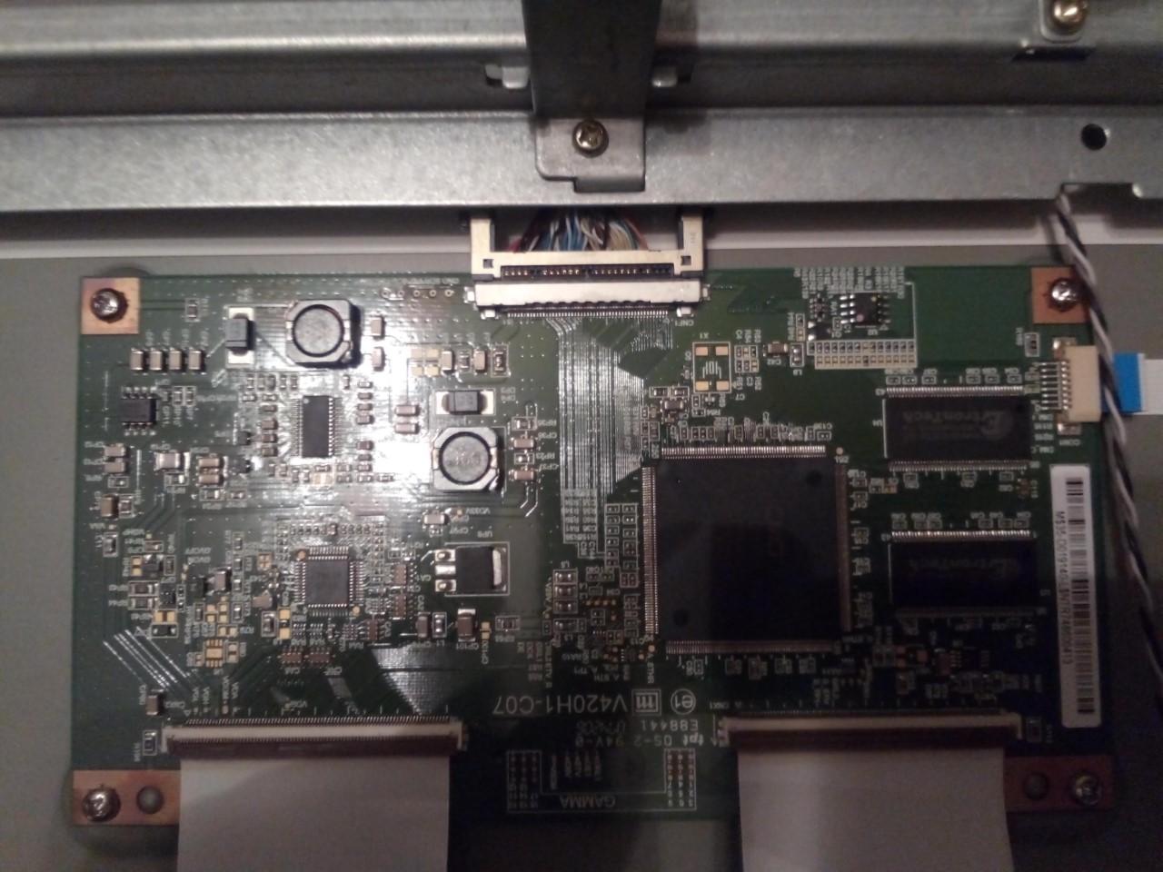

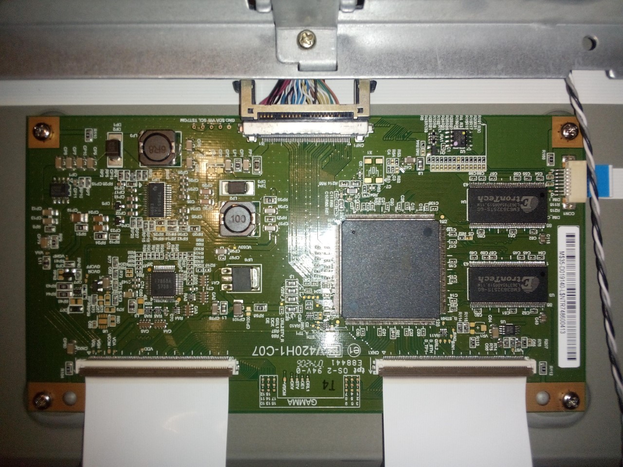

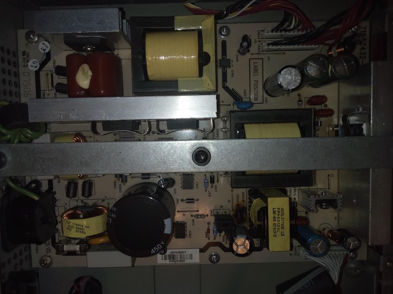

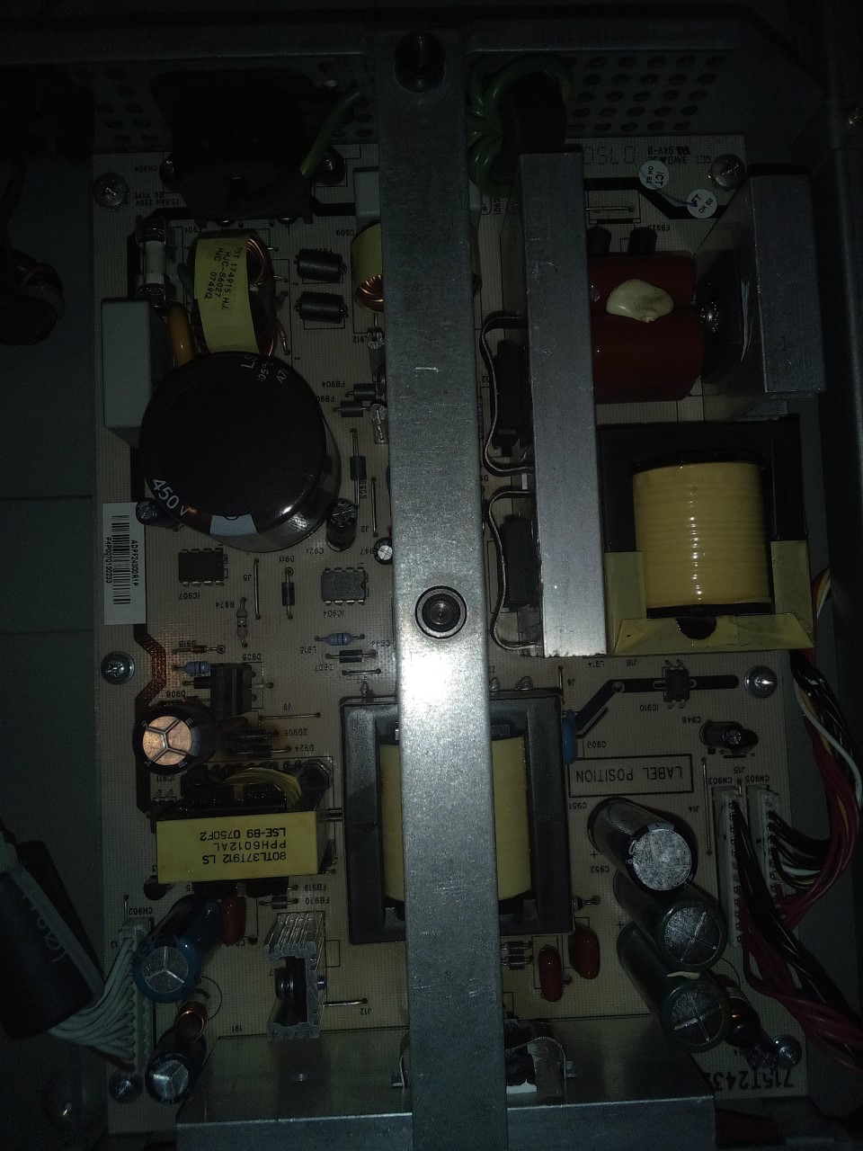

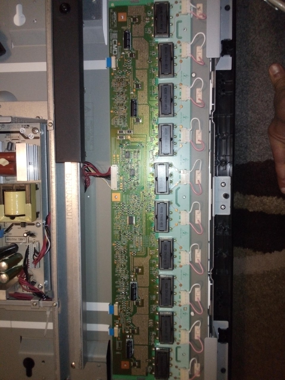

        Ok here are the pictures..
        The power supply board had the caps replaced and is powering 24v to inverter boards.
        Those burn that look like diodes, were supposedly checked from a TV repair... I assume power Supply is good, since I got power going to Tcon and inverters.
        Inverter Board Test I did.
        Main and Slave are getting 24V confirmed at the pin connector.
        On the Main I found one fuse F1 that one gets both sides 24v
        I cant located the other fuses, there should be 2 on each inverter board according some posts. Help?
        I really need to locate these since that would make sense the inverter boards are bad
        TCon board test I did. these are the pinholes
        Gnd =0V
        SDA= 3.32V
        VIN= 12.20V
        SCL= 3.30V
        TSTPGM= 0V
        I also loacted
        Voltage Regulator AME 8815 AECS 250 0733
        I listed the pins from top of TV downward.
        Pin 1= 2.49V
        Pin 2= 0V
        Pin 3= 3.28V
        Dont see the other one some have two with three pins on mine Tcon I only see 1.
        any help appreciated.

          Re: 42pfl5432d/37 no picture but have sound
          You likely have a bad inverter or maybe a bad ccfl, Just because you have 24 volts going to the inverter, doesn't mean it is working. Start by checking the inverter transformer secondary resistance and compare the readings to see if one is different.
                  The ccfl's are what produce the light so you can see the picture, they are located in the panel behind the lcd screen
                  The transformers are those large black components connected to the white connectors that connect to the ccfl's in the panel. Now this is with the TV unplugged... Check the resistance (ohm meter) of the transformer at the connections that go to the white plugs.
                      Have you tried shining a flashlight at the screen to see if you can see an image? or do you have backlights? or do the flash on for a second then go out?
                      The T-Con does have a fuse, it is near the lvds cable labeled FP1, Check the voltage on both sides of the fuse

                          First check if you can see a faint picture on the screen while shining a flashlight (or other light) on the screen, (when the tv is on and you can here sound) If you can see a picture, then you know the t-con is working,
                          You can check if the T-Con is getting voltage at the fuse (labeled FP1)

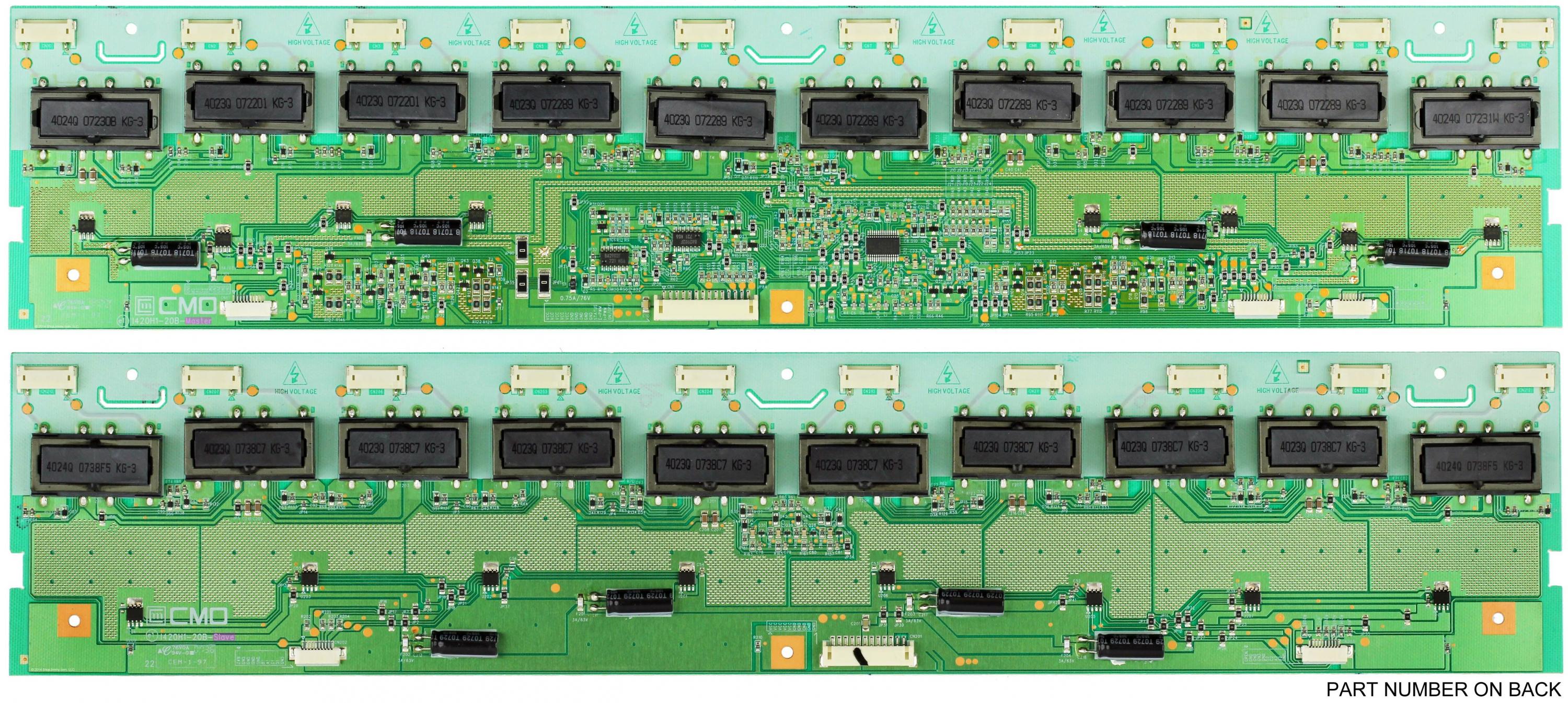

                            There are FIVE fuses on the Master inverter board,
                            F1 is a small Black fuse 0.75A 76V.
                            F101, 102, 103, and 104 are White fuses 3A 63V, there are loacate next to each one of the black Lytics caps.
                            Slave Inverter board also has Four White fuses F201, 202, 203, and 204 next to each black lytics caps.
                            Pictures provided by SHOPJIMMY.
                              I tried flashing a light didnt see anything.
                              Ccfl going to panel i unhoked the white connector from inverter board.
                              Resistance to panel is open on all of them.
                              Resistance to inverter board side connector is at 5.7-5.9 range on all of them both sides
                                If you didn't see any image using a flashlight, it could be that the T-con is not working, Check the voltage on the T-con fuse.
                                Also check the fuses on the inverter boards as budm suggests

                                  Voltages
                                  Tcon fp1 fuse both sides 12v
                                  Main inverter board
                                  F1 fuse 24v both sides
                                  F101 18.3v to 18.6v both sides
                                  F102 18.5v to 18.5v both sides
                                  F103 18.6v to 18.7v both sides
                                  F104 18.8v to 18.6v both sides
                                  Slave inverter board
                                  F201 24.8v to 24.8v both sides
                                  F202 25v to 25v both sides
                                  F203 25.1v to 25v both sides
                                  F204 25.3v to 25.3v both sides

                                      Those fuses are fed by 24V so they all should be showing 24V, not 18V. May be recheck your measurement again.
                                        ccfl's are florescent tubes, they will not measure any resistance, As for the transformer resistance 5.7-5.9 ? is this Ω or KΩ. If they are all the same then they are likely ok.
                                        Usually even if the t-con or the lcd has an issue the backlight should still work.
                                        You say the main board was replaced, was the tv working with the new main board and now you have this issue or did the tv fail and you replaced the main board and still have this problem?
                                        Main inverter voltages are low? like budm says they are fed from the 24 volts so should also read 24v
                                        There is also another smd fuse on the main inverter board (near the white plug's legend) 0.75A/76V (labeled 15?)
