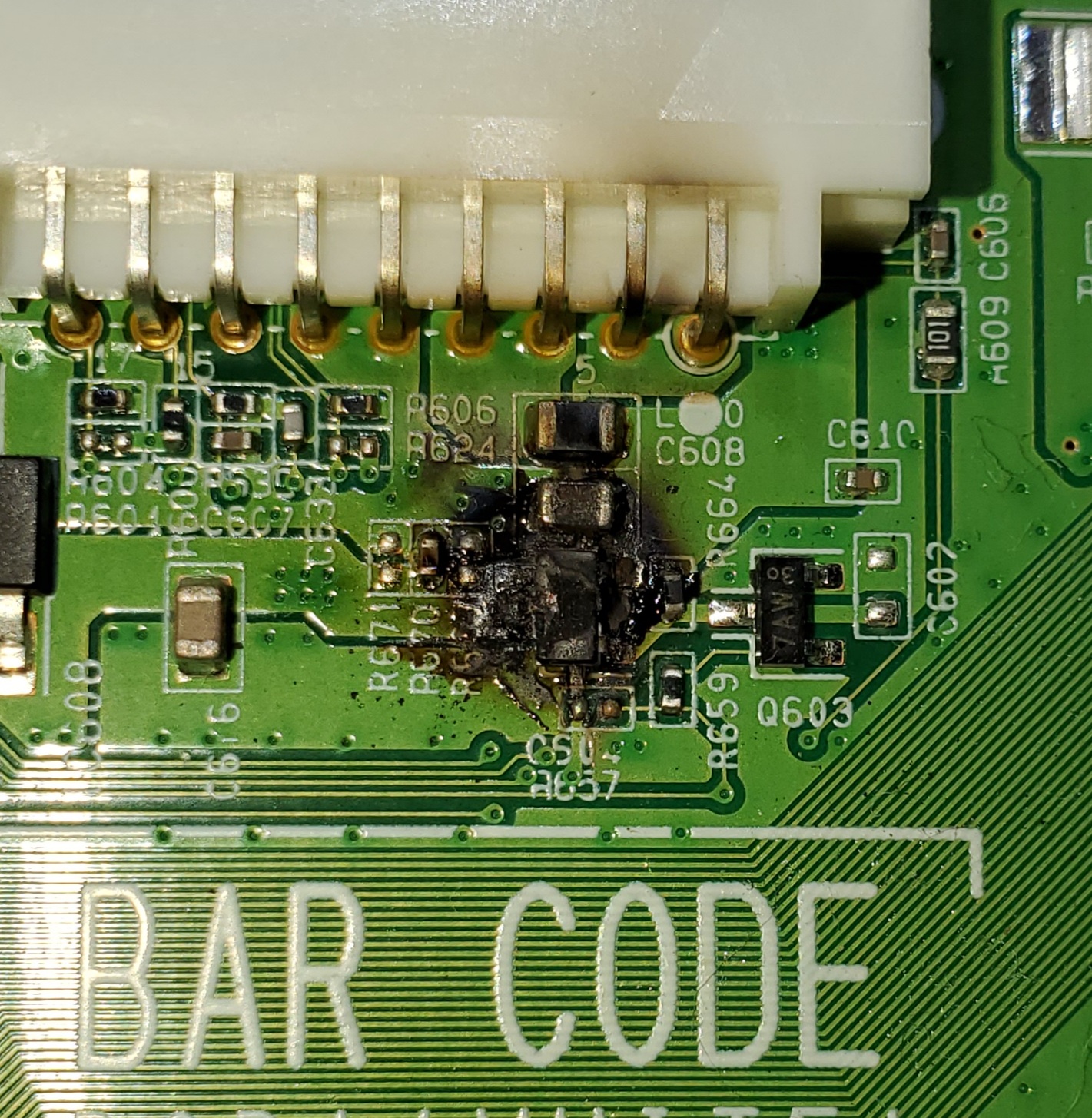

    Picked up this 60" LG today that has a broken hdmi port and and exploded diode? Maybe? Looks like i can fix the port but the other part that got very hot, quick, i dunno.. anyone know what part or parts, im missing ? please advise...

    Check the part number of the board itself on shopjimmy you might get lucky and find a high res pic that will shed some light on the part layout in that area.
      Re: LG 60PN5300 Broken hdmi Exploded part id help!

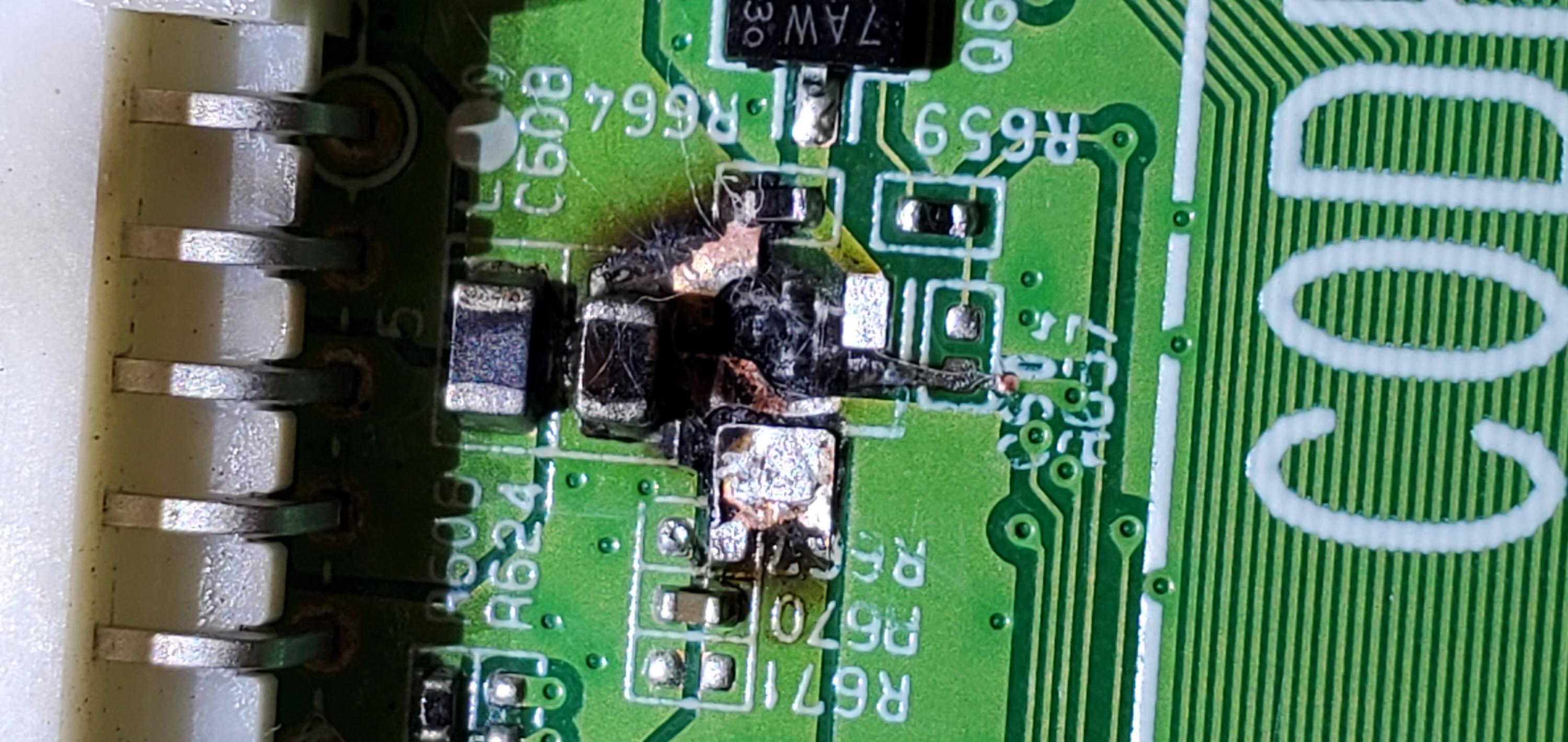

      Q604 = ZXMP3F30FHTA Mosfet

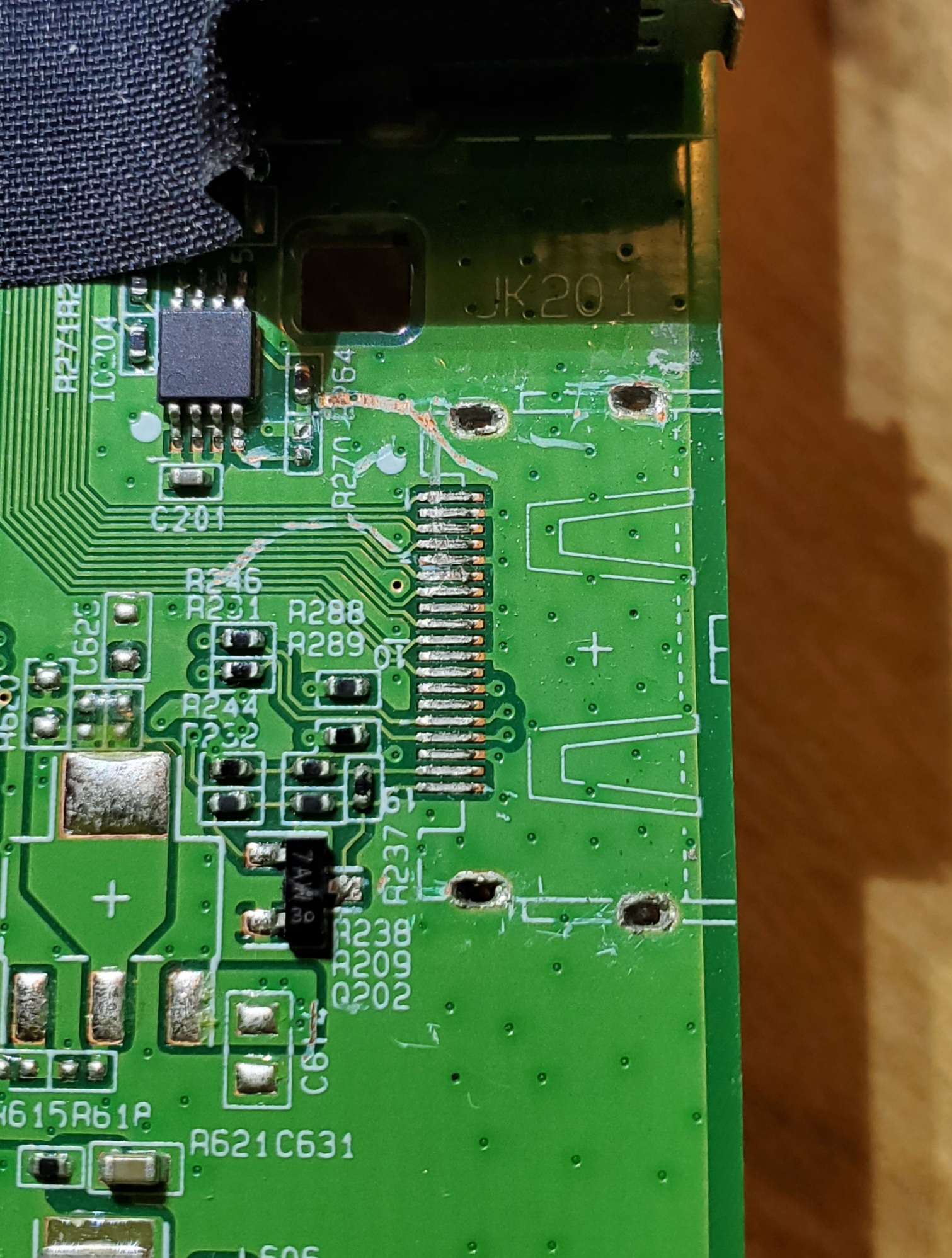

        Thank you for the part help. well i put the hdmi port back on and replaced the mosfet. Tv came on for a few seconds and then the mosfet burned up again.
        do you think the hdmi port damage is the cause or something else?
          Pic of port before i put it back on
