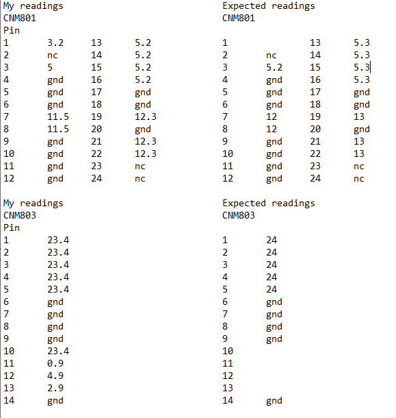

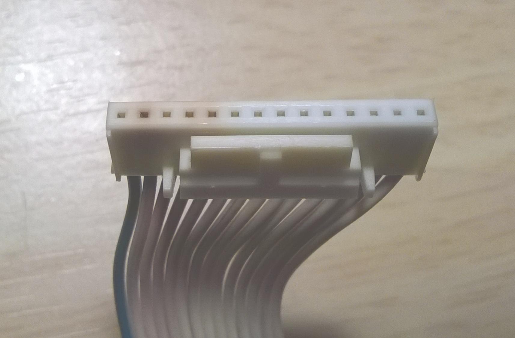

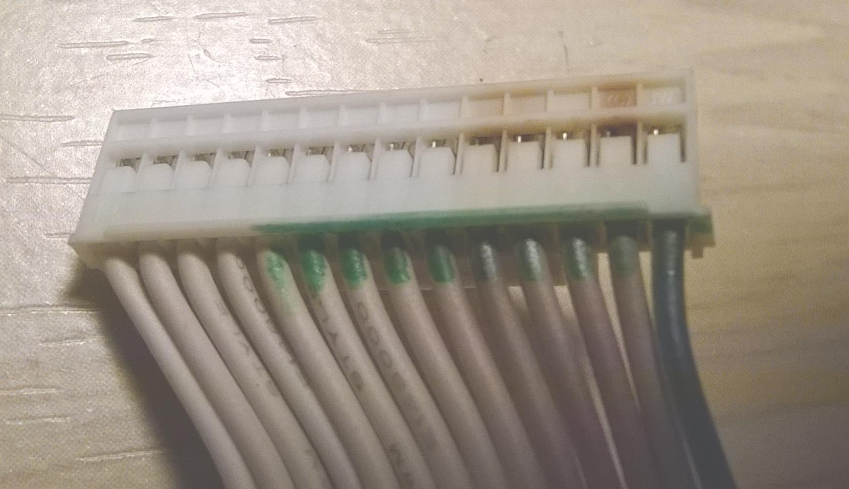

    TV works normally for about 10 minutes then the picture freezes and then the TV goes into a restarting loop. All the voltages seem ok and all the caps on the power board look ok and test ok with ESR meter. Inverter board to power board lead has burn marks at the power board end as shown in pictures. No signs of burning on the inverter board and caps test ok. Not sure if this is a problem but Diode DM804 (schematic D2) on the power board reads as shorted in circuit but disconnecting one leg it reads normal. Disconnecting the inverter board makes the TV stay on permanently with all voltages testing as in diagram. Any help would be greatly appreciated.
  • dick_barton
    • Aug 2015
    • 6642
    • Wales
    Re: Samsung LE37R88BDX/XEU BN44-00157A Turns off after 10 minutes
    On the surface those reading look ok except you have 24V on CNM803 pin 10 which I suspect is in error.
    You could try a can of freezer spray ( or inverted can of air duster spray) to cool down the EEPROM or BGA IC's on the mainboard and see if that helps.
    DM804 is in parallel with a 0.2 ohm resistor so would read short when still connected to the board.

      Yes I made a mistake on the voltages it should have been a ground on CNM803 pin 10.
      There's a big heat shield covering the chips so I put a computer case fan on top and powered it up and it doesn't shut down anymore. So something is getting too hot.

          Hope you took care of the connector problem.
