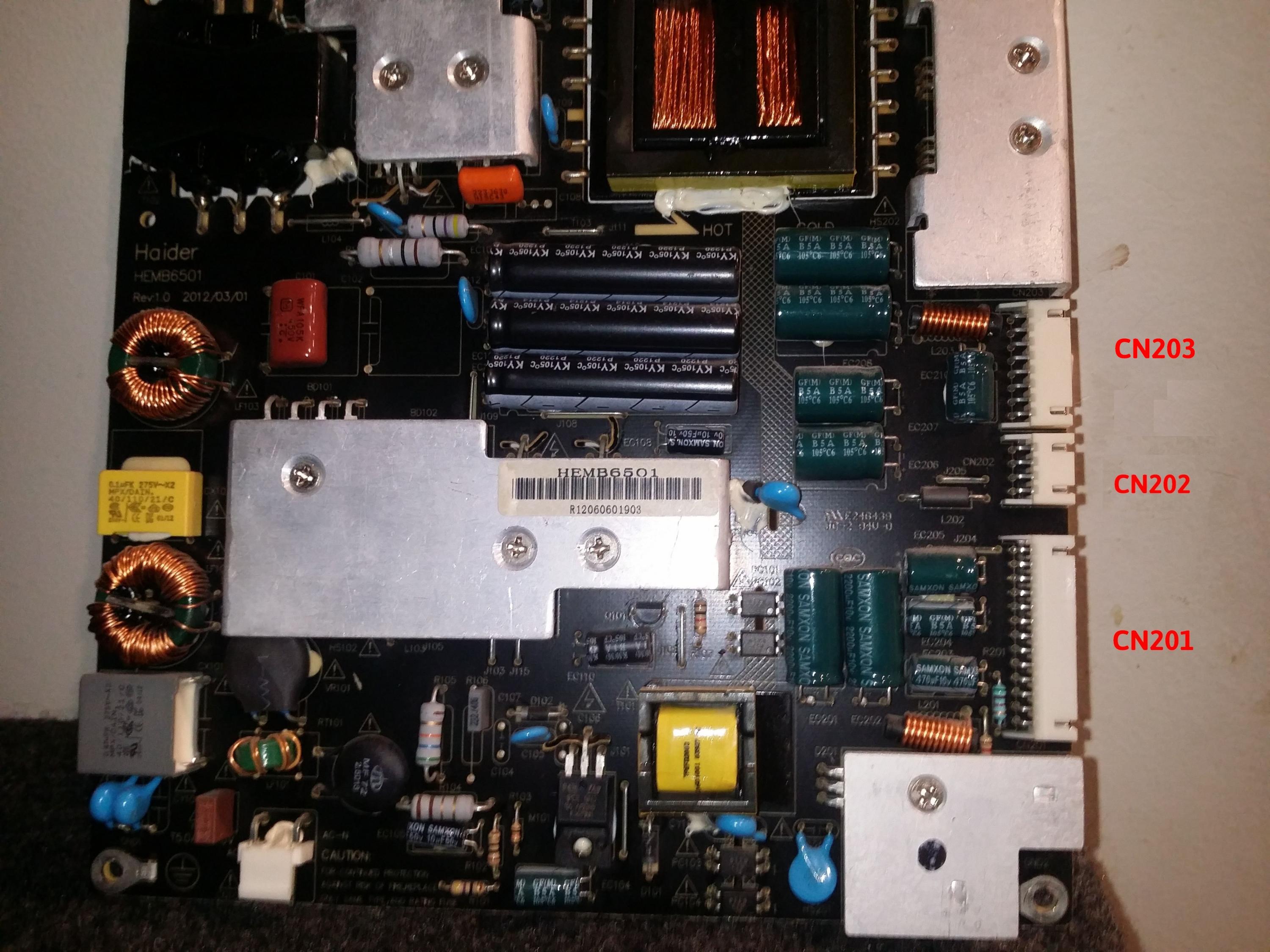

Soniq E40S12A-AU Stuck In Standby
  • Eggbert43
    replied
    Re: Soniq E40S12A-AU Stuck In Standby
    Ok, so my cheap LCR Tester (TC1) arrived & I have been playing with that instead of measuring those voltages we spoke of sorry; I may still need to take those voltage readings at the CN connectors, but first:
    After getting some suspect readings with my TC1 from some of the components on the Power Board, I unscrewed the board to look at the back of it, & there is something in particular that looks wrong to me. I have circled the area in question on the attached images & would really appreciate your thoughts.....
    The two +12V Pins On CN201 seem to have a big chunky bit of solder attached to them; plus, are the two +12V pins supposed to soldered together like that?
    Please see attached; either way, I will be replacing some of the capacitors on this board next....!
    Leave a comment:
  • dick_barton
    replied
    Re: Soniq E40S12A-AU Stuck In Standby
    That's correct with meter set to dc.
    Leave a comment:
  • Eggbert43
    replied
    Re: Soniq E40S12A-AU Stuck In Standby
    I see, thank you for clarifying....
    So, with the set plugged in & switched on, I put the black lead/plug to ground & the red to each pin of the connectors?
    Leave a comment:
  • dick_barton
    replied
    Re: Soniq E40S12A-AU Stuck In Standby
    You really need to take voltage readings as suggested in post #10 to see if that will give a clue to what is going on with your set.
    eg
    Connector CN1
    Pin 1, legend name, voltage
    Pin 2, legend name, voltage
    etc
    Leave a comment:
  • Eggbert43
    replied
    Re: Soniq E40S12A-AU Stuck In Standby
    Could a problem with the T-Con Board be causing this particular problem??
    Or should I be looking elsewhere...?
    Leave a comment:
  • dick_barton
    replied
    Re: Soniq E40S12A-AU Stuck In Standby
    It looks like its the Local Dimming signal cable from led controller to Tcon
    In Local Dimming backlight, LEDs under the LCD panel are divided into many small zones. Using content-adaptive backlight control, the brightness of each zone is adjusted according to different display content. A local dimming backlight allows the display to have “darker blacks” and “brighter whites”.
    Leave a comment:
  • Eggbert43
    replied
    Re: Soniq E40S12A-AU Stuck In Standby
    The first image is upside down sorry, the one where the board is exposed.....
    Let me know if any close-ups might help, thanks....!
    Leave a comment:
  • Eggbert43
    replied
    Re: Soniq E40S12A-AU Stuck In Standby
    CN2 goes down to the very bottom centre & plugs into something I haven't inspected yet?
    There is some sort of board running horizontally along the bottom. Took some effort to expose; please see attached photos...!
    Any thoughts?
    Leave a comment:
  • dick_barton
    replied
    Re: Soniq E40S12A-AU Stuck In Standby
    Capacitors are not so easy to test especially in circuit since they have other components connected to them.
    I would be more interested in what voltages you have on the white connectors CN1 and CN3. Where does CN2 go?
    Leave a comment:
  • Eggbert43
    replied
    Re: Soniq E40S12A-AU Stuck In Standby
    I have ordered the exact component tester pictured in the above attachment/post, but whilst I await delivery, I did my best with a basic Multimeter:
    In an attempt to do as you suggested & check the supply voltage to the LED Board, my only idea was to test the Yellow Capacitor labelled 'NXH 35V 560uF' on the LED Board.
    When Resistance Is Set 20K, the capacitor's resistance reading climbs to 1.31 but refuses to climb higher.... But when I unplug the Power Board from the LED Board & repeat this test, the capacitor's resistance reading climbs to infinity as expected.....
    The resistance reading climbs to infinity for all the electrolytic capacitors on the Power Board. I am yet to investigate the various other/smaller components etc
    Does this tell us anything, especially the bit about getting a different resistance reading when the Power Board is unplugged?
    Thank you
    Leave a comment:
  • Eggbert43
    replied
    Re: Soniq E40S12A-AU Stuck In Standby
    Thanks for that....
    My parents did yep, I was only 8....
    Leave a comment:
  • dick_barton
    replied
    Re: Soniq E40S12A-AU Stuck In Standby
    Ebay sell cheap component tester which are pretty good.
    This one is OK but there are cheaper ones available. They will test your diodes and capacitors.
    So you left poor old wet Wales for a sunny climate.
    Last edited by dick_barton; 04-02-2021, 09:06 AM.
    Leave a comment:
  • Eggbert43
    replied
    Re: Soniq E40S12A-AU Stuck In Standby
    Yeah thought that might be the case.....
    So when you say check the supply voltage to the led board, do you mean check that yellow capacitor?
    I'm not sure how to check capacitors so I will do a little research & get back to you, thank you.
    PS: I was born in Llanyravon, Cwmbran. Been in Perth since 1989 though
    Leave a comment:
  • dick_barton
    replied
    Re: Soniq E40S12A-AU Stuck In Standby
    I would check the output voltages from the power supply. I believe that the Samxon capacitors are notorious at failing. Pehaps one of the supplies is falling after switch-on.
    Also check the supply voltage to the led board.
    The flash makes it a little difficult to make out everthing on the boards
    Last edited by dick_barton; 04-02-2021, 07:44 AM.
    Leave a comment:
  • Eggbert43
    replied
    Re: Soniq E40S12A-AU Stuck In Standby
    Sure, let me know if you need something zoomed in or something better etc
    Leave a comment:
  • dick_barton
    replied
    Re: Soniq E40S12A-AU Stuck In Standby
    Can you post some good clear photo's of your boards.
    Leave a comment:
  • Eggbert43
    replied
    Re: Soniq E40S12A-AU Stuck In Standby
    Yeah thanks, I did watch Part 2, but nothing similar corresponded with my Soniq.....
    Was quite a different issue also; in terms of the symptoms etc
    Leave a comment:
  • dick_barton
    replied
    Re: Soniq E40S12A-AU Stuck In Standby
    The problem with the set was given in the second part of the video. Looked like a poor connection at the Tcon end from the mainboard and a blown fuse on the Tcon.
    Leave a comment:
  • Eggbert43
    replied
    Re: Soniq E40S12A-AU Stuck In Standby
    Thanks mate, downloading video now
    Leave a comment:
  • dick_barton
    replied
    Re: Soniq E40S12A-AU Stuck In Standby
    May be worth your while watching the following Youtube videos.
    https://www.youtube.com/watch?v=QbOYO32uL1A
    Leave a comment:
  • Loagz
    Soniq S55V14B-AU Stuck in Standby
    by Loagz
    Hi, I'm hoping someone can point me in the right direction....
    I have a S55V14B TV and it suffered a board failure. Main board part number: 222-655036003-30. I couldn't find a board with the exact part number so I've used what looks to be the same board however the part number is slightly different. 222-655036002-30.
    After installing the main board the stanby light came back on, however it wont turn on. I spoke to Soniq Australia and managed to get a copy of the firmware but no service manual. They don't have one. I asked about the different part numbers but they...
    11-15-2021, 02:13 AM
  • nubie
    Gigabyte B460M DS3H blown standby regulator, hot 5v(?) Regulator
    by nubie
    Please help me ID the blown chip and point me where the short might be.
    I have a L1085DG that is getting really hot and a blown up standby regulator (I assume, one leg is ground, one leg is 5v standby, the other has 180 Ohms to ground.
    The L1085DG is in the front corner of the board. With no standby power I am using a jumper to get the PSU powered on.
    Anything I should check first for a short?
    Edit: I can look again but I don't think the USB are shorted, on back or the headers. The USB2.0 are powering up my portable monitor, so I don't think...
    01-05-2023, 06:06 PM
  • samsonn
    Soniq S55V16A-AU stuck in standby
    by samsonn
    I've got a 55" Soniq LED TV which is stuck in standby mode (initiator LED on, but no picture/sound/backlight). It will intermittently start working again for a few days or weeks, but it has been months since the last time it turned on. I've seen a lot of similar issues with Soniq TVs that were fixed by updating the firmware, but I need to turn it on to update the firmware so no luck there.
    I've taken the back off and visually inspected it but everything looks fine. No exploded capacitors or signs of overheating etc. All of the 1117 regulators on the main board were outputting...
    06-28-2020, 02:33 AM
  • lego1234567
    LG 32LB1R - stuck in standby mode
    by lego1234567
    Hi. I have the following problem with my TV. After connecting to mains, the standby led (red) turns on, but TV is not responding to remote control or buttons on TV. After some measurements, I found out that +5 V standby voltage is present, but I dont have ON/OFF signal coming in to turn PSU on. It stays at zero volts. After looking at the schematic of the mainboard, I should get ON/OFF signal coming in at the R1402 resistor, but it stays around +3,5 V. So I removed it and I was able to turn on TV with buttons on TV, but not with remote control.
    What could be the problem ? Thanks...
    01-21-2024, 03:39 AM
  • Stunt
    Hp Laptop Stuck on Hp protected by hp sure start screen
    by Stunt
    Hi guys i've got an Hp laptop Zbook 17 g5 Stuck on Hp protected by hp sure start screen.
    I have tried almost every bios available on various platforms about this laptop but the problem is still the same.
    I even successfully build my own bios using the one from the Hp website but the problem the laptop still getting stuck there.
    Even if i try to press Esc key nothing happens. I tried f10 it doesn't go to bios still stuck there i just saw entering setup menu on the bottom left corner of the
    screen that's it and stuck there. I left it until the following day and i still...
    09-02-2025, 01:51 PM
