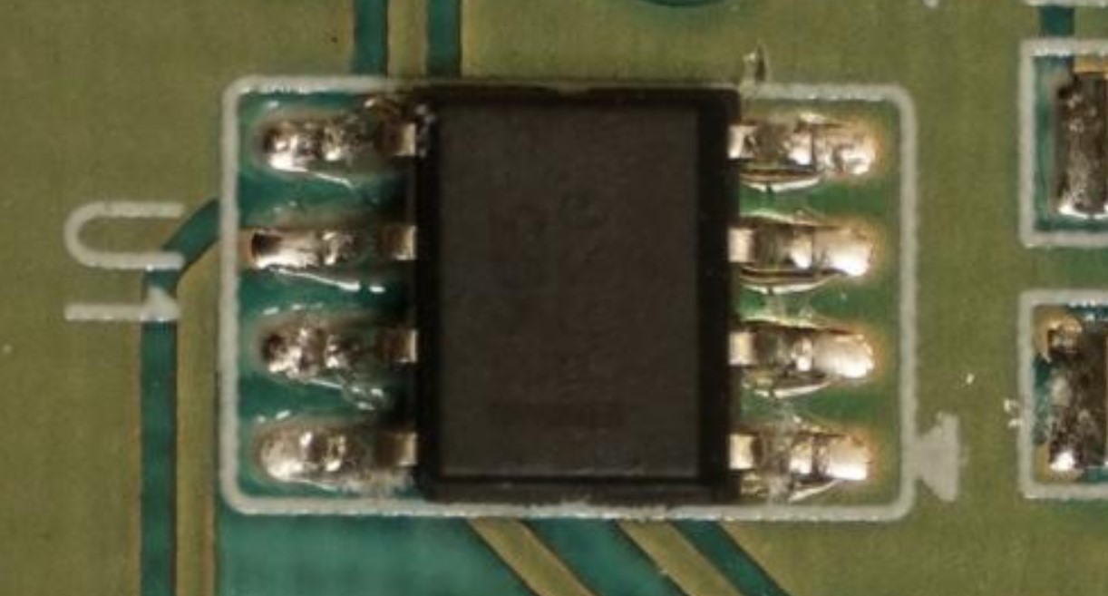

      Re: Sony KDL-46EX500 2 blinks, then 6 blinks
      The fault does appear to be on your inverter board.
      If pin 6 is more positive than pin 5 then the output pin 7 goes to 0V.
      If pin 5 is more positive than pin 6 then the output goes towards VCC
      So that IC does appear to be working.
              Is there a poor solder connection on pin 5 of U1 or it is just the photo.

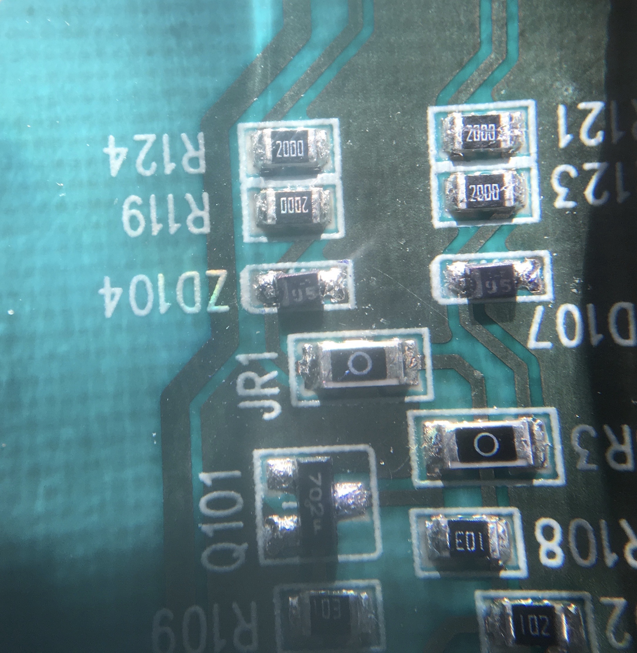

                No, it is ok, it is just the photo.

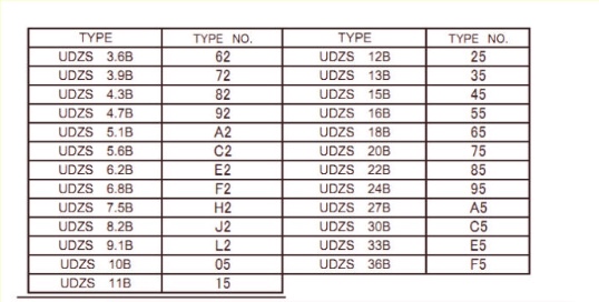

                But I see strange results for the zener diodes ZD104 and ZD107
                What I read on them (very hard !) is "95" or "U5"
                When I test them with the T7 (no desoldered), I get:
                7.18V___ on the ZD104 and
                23.3V___ on teh ZD107.
                When the TV is on, I measure :
                12V on both on them !
                I think I'll try to desolder them tomorrow... because I have to leave now.
                Many many thanks !!!
                    May be worth checking Q101 with your tester.
                    I tried with bad results. It is a 702 Mosfet, and the tester only sees the diode between source and drain, but nothing on the gate...
                    Is it faulty or is it due to the fact that it is soldered...
                    Before desoldering ZD104 and ZD107, I'd like to know their type.
                    And I did not find that on Google...
                    What a mess
                      The 702 mosfet appears to readily available on-line. You really need to lift it out of circuit to test it.
                      Do you have an LED tester which can test zener diodes?
                                ZD104 and ZD107
                                • chrisl32
                                  • Feb 2021
                                  • 39
                                  • france
                                  #56
                                  Thank you kasfamily. So 24V zeners .. I'll continue my tests.
