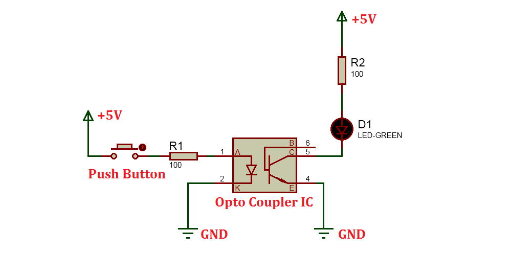

                All electrolytics caps in that area (and more) checked.
                I'll try to check the optocouplers tomorrow with this kind of circuit :
                • chrisl32
                  • Feb 2021
                  • 39
                  • france
                  Re: Sony KDL-46EX500 2 blinks, then 6 blinks
                  The 4 optocouplers checked OK :
