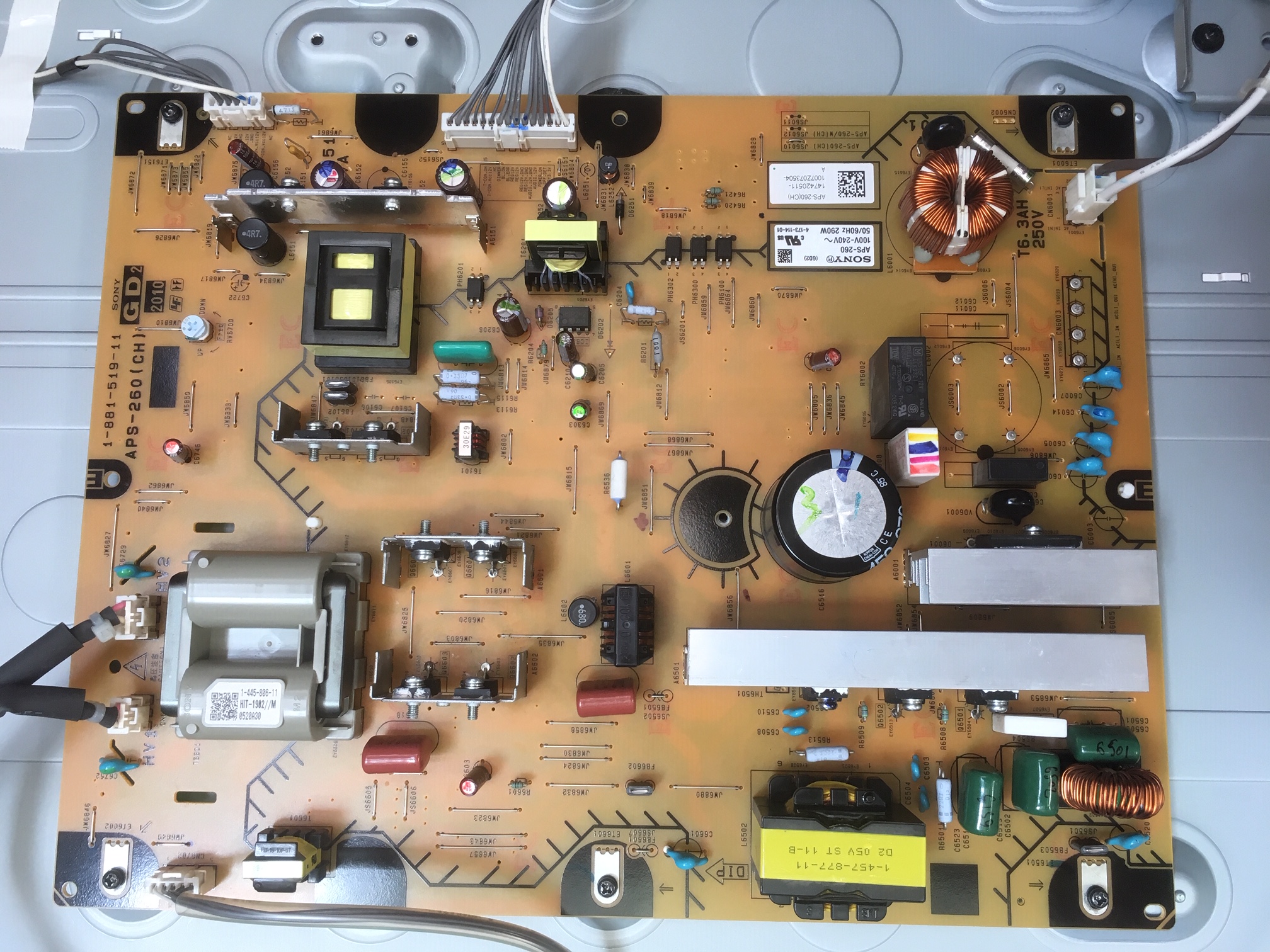

    The TV has is 7 years old. I checked the capacitors with a Fluke 115 after desoldering them. I also have a small component tester (Multi-function tester T7), that I did not use ... my bad :-(
    I also just want to remind that the issue on this TV came after a lightning surge...
    The buzzing is a "physical" buzzing coming from the T6801 transformer.
    Just to know, before changing all capacitors, can you give an internal impedance value telling the capacitor has dried ?
    It will help in the future for other cases ...
    And for now, I'll check the capacitors again with the multi-function tester and report.
    Thanks again

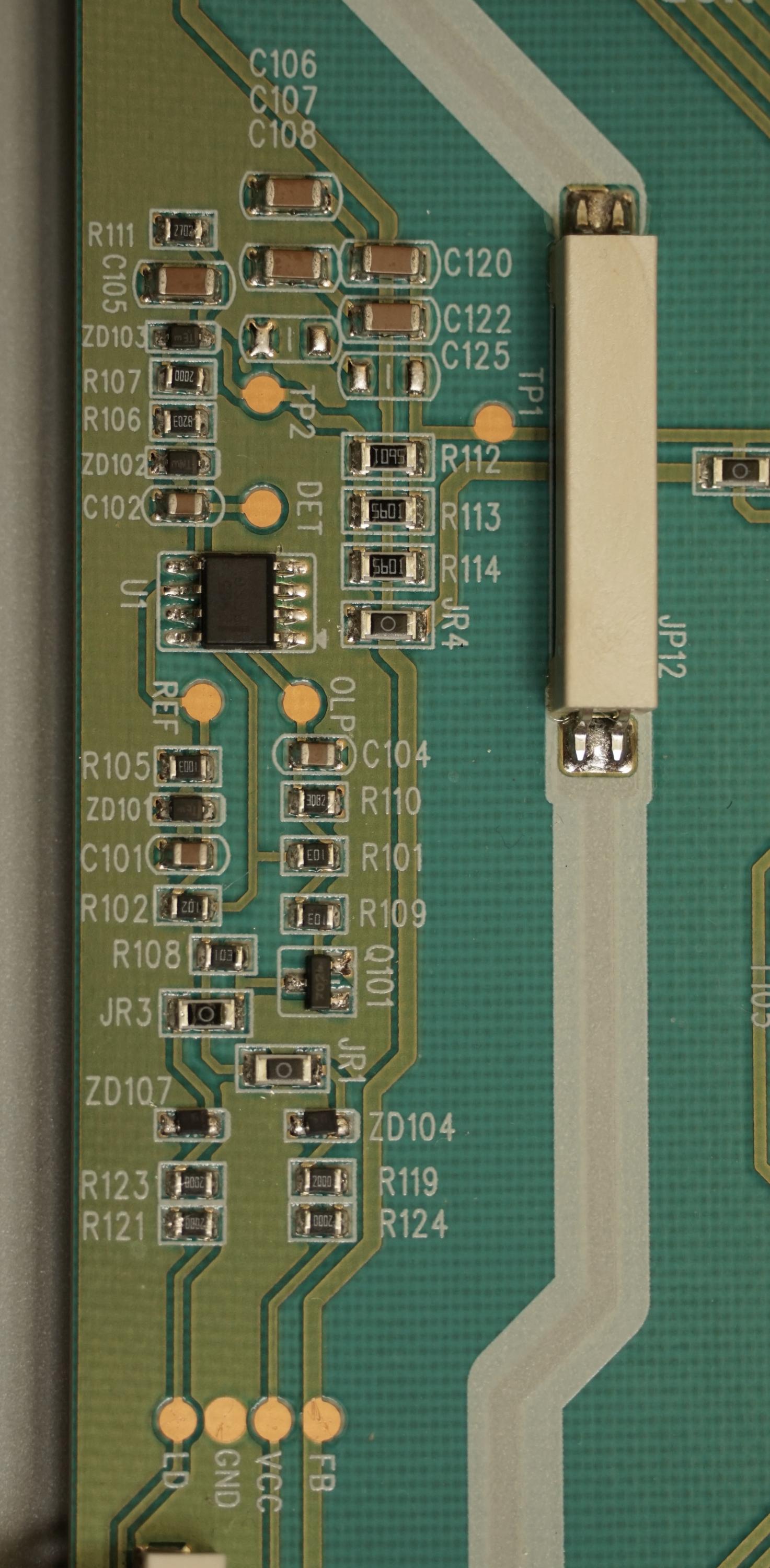

            Have you lifted the panel to check if any one of the CCFL tubes are dimmer than the rest?
            What is the part number of U1 on the inverter board.
            There are a few 0 ohm resistors around it I would check out.

                    what is the part number of u1 on the inverter board.
                    2903
                      If you mean JR1, JR2, JR3, JR4 on the inverter board, they are OK.
                      I also checked the others ones on this board...

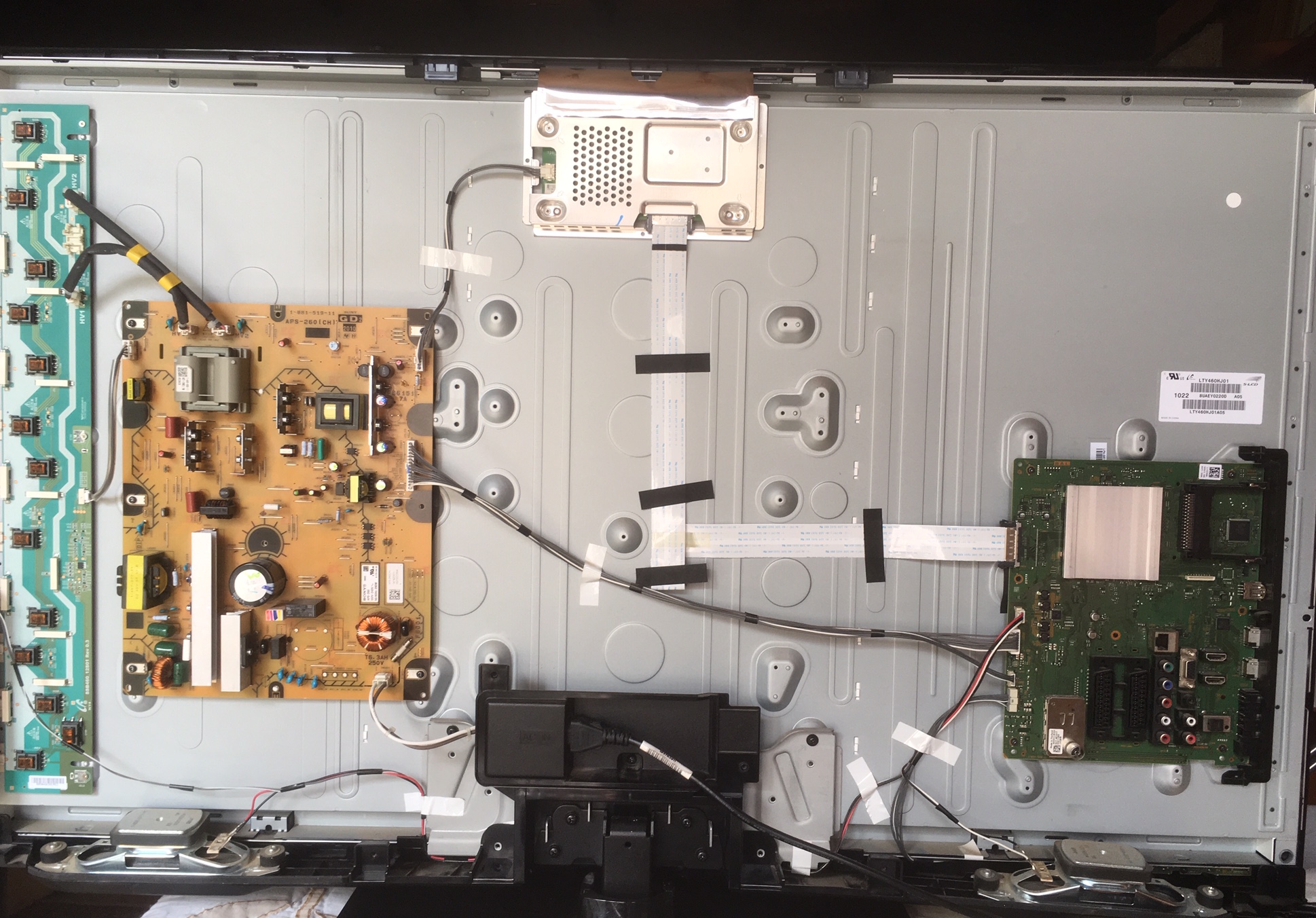

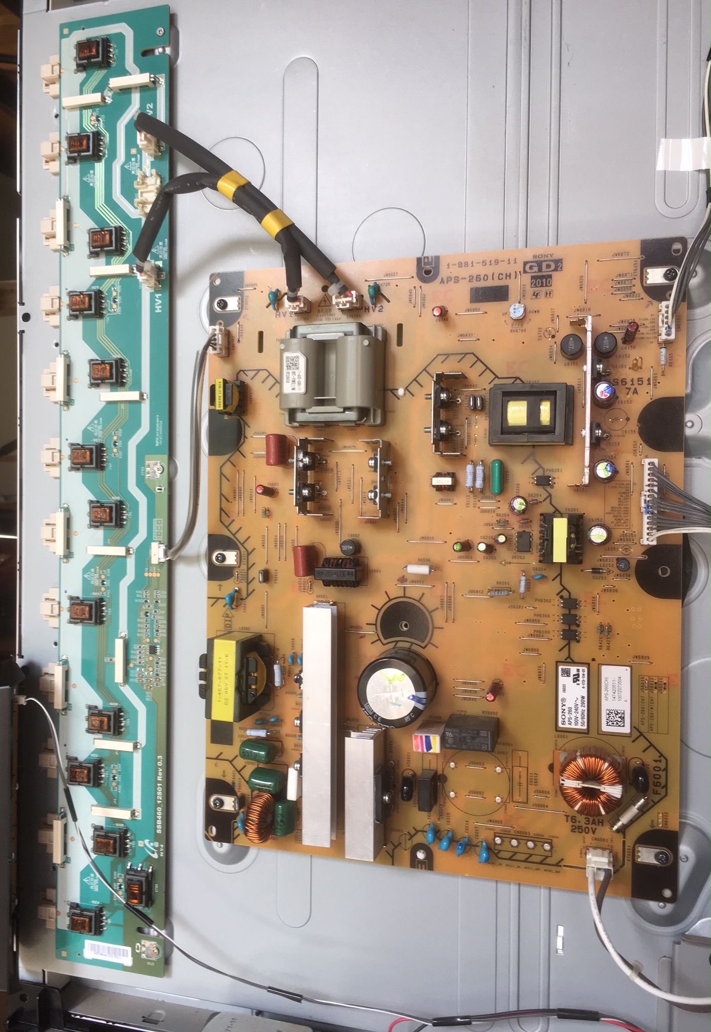

                            Re: Sony KDL-46EX500 2 blinks, then 6 blinks
                            I am sorry, I forgot to attach photos in my first post.

                              This photo shows the reality well concerning the very weak intensity of the SONY logo during its very brief appearence (less than 1 second during the transformer buzz).

                                  Check C6618. If it's faulty then it may be responsible for reducing the drive signal to T6801 giving way to a lower HV1 & HV2 voltage

                                    Thank you dick_barton
                                    i checked C6618 :
                                    with T7 tester :
                                    C=976 nF __ Vloss=0.1 % __ ESR=0.23 ohm
                                    with Fluke :
                                    C= 980 nF
                                    I really have no luck ... all my tests show good components !

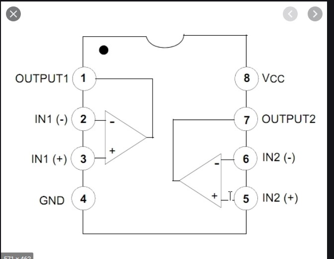

                                      I think the IC on the inverter board may be an LM2903. Low-power dual voltage comparator. Check the voltage between pins 4 and 8 to see if it has a supply voltage.

                                        Good idea.
                                        But I get 12 V

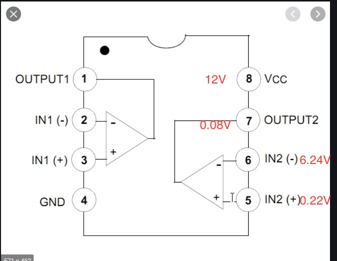

                                          I checked the other pins :
                                          1, 2 3 and 4 are connected to ground
                                          8___12V
                                          7___0.08V
                                          6___6.24V
                                          5___0.22V
                                          These values are NOT changing wether T6801 buzzes or not.
                                          Is this normal ?
                                          I'll try to follow the tracks around the LM2903 to see what is going on ...
