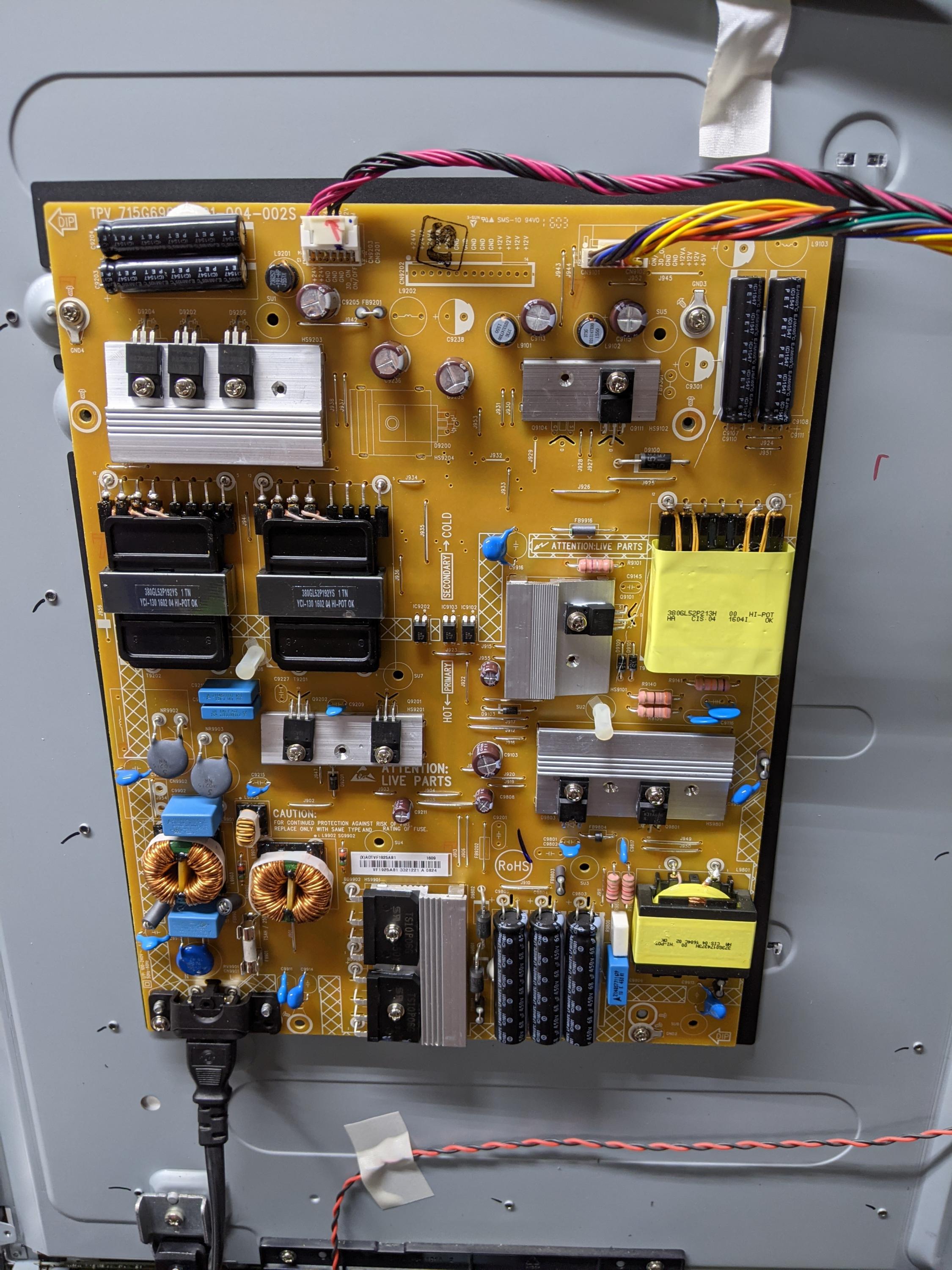

    I figured it was the power board based on the the standby light going out rather quickly. I ordered a board from Shop Jimmy and I'm at the same spot. Currently the standby light comes on and fades away. The light on the main board is red, when the power button it pressed it turns purple and stays purple.

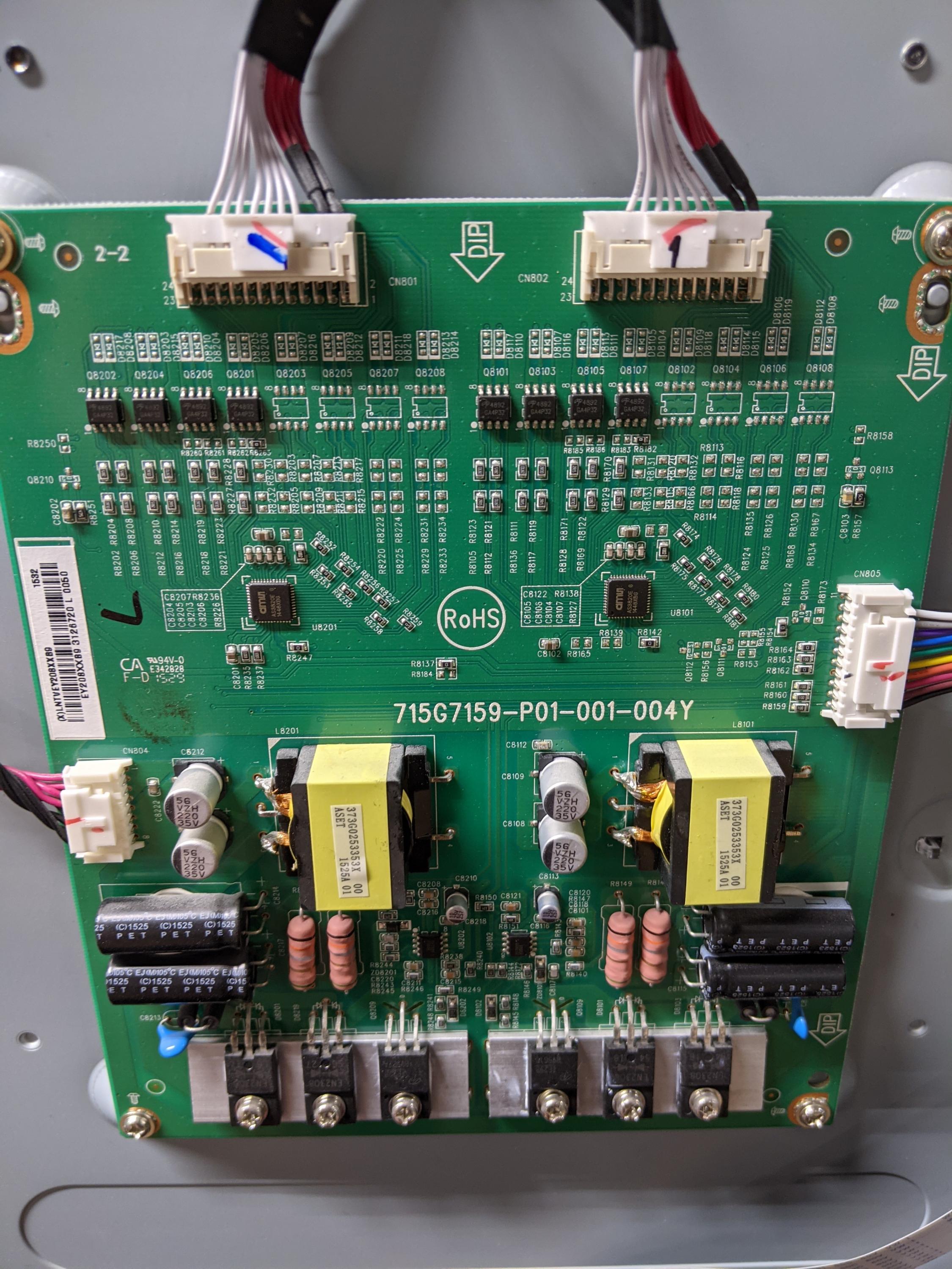

    L9201 (Wire runs to the LED Driver)
    (24+) Meter shows a reading and it flashes out quick

    CN9101 CN 9102 Power Connector from power board to Main Board
    Pin 2 Pin 1
    ON/Off DIM .07 3.29
    3D on 0.00 3.65
    Ground
    Ground
    12 VA 19.30 19.29
    12 V 19.28 19.28
    12 V 19.28 19.28
    12 V 19.27 19.28
    5V 5.11 5.11
    I'm at a lost as I replaced the power board and it made no difference. There appears to be power to the main board. There is no video, no image with flash light test and no sound.

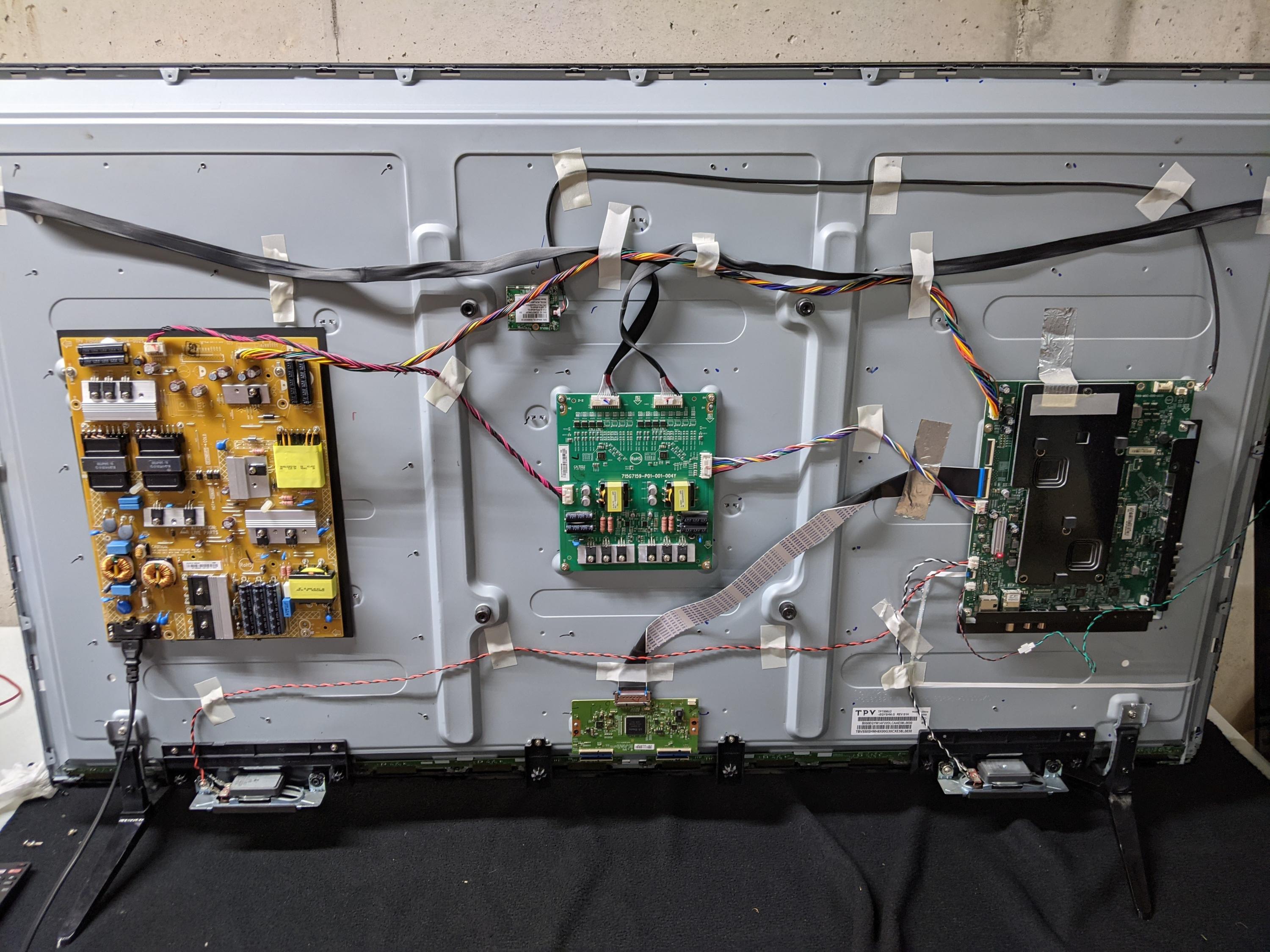

    Re: Vizio D55u-d1
    Need good clear straight on pictures of each board and one of the whole back as to see how they are all connected. If you have a stand alone tcon board, check for 12 volts on each side of the fuse, black neg. probe on metal chassis pos. probe on each side of fuse.

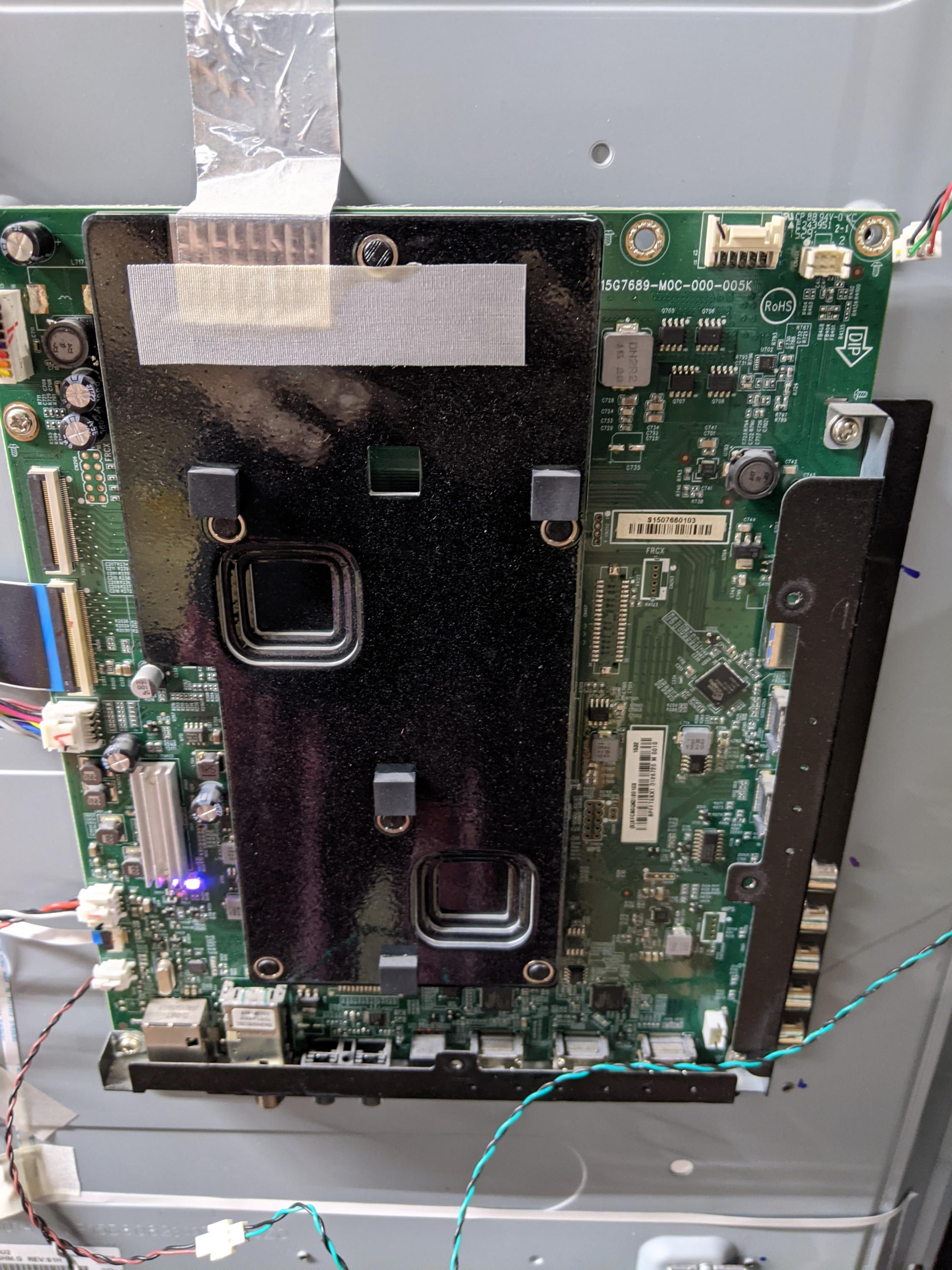

        Broken solder joints at BGA's on main board is pretty typical

          Alright I pulled the main board out today. Ran a heat gun over the back for about 15 minutes. Let it cool and put it back in. It kicked on the backlights. I didn't notice and image appear.
          Pointing toward a main board issue now. I don't really want to put this in my oven to flow it. Doesn't appear to be many of these boards available.
