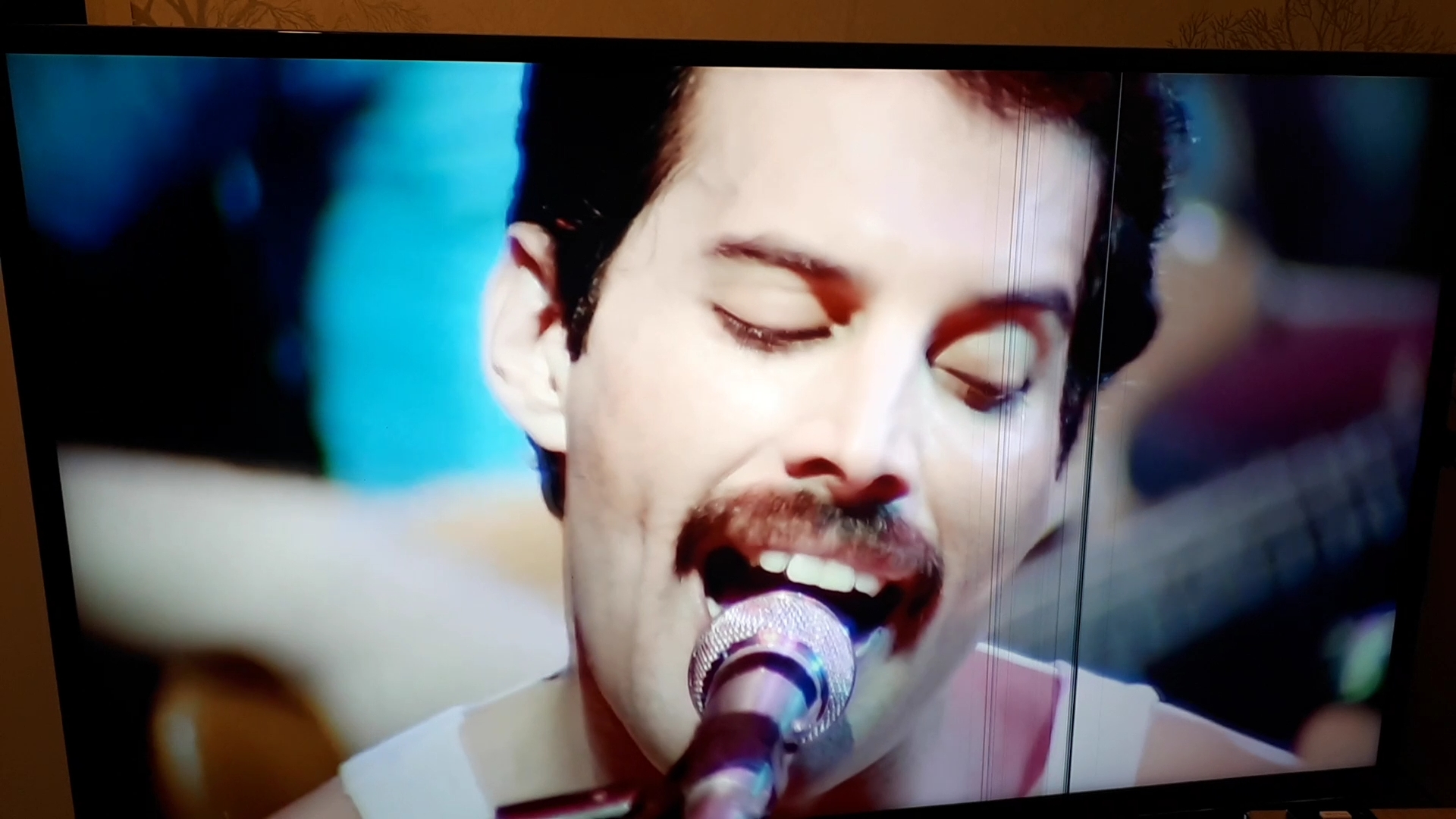

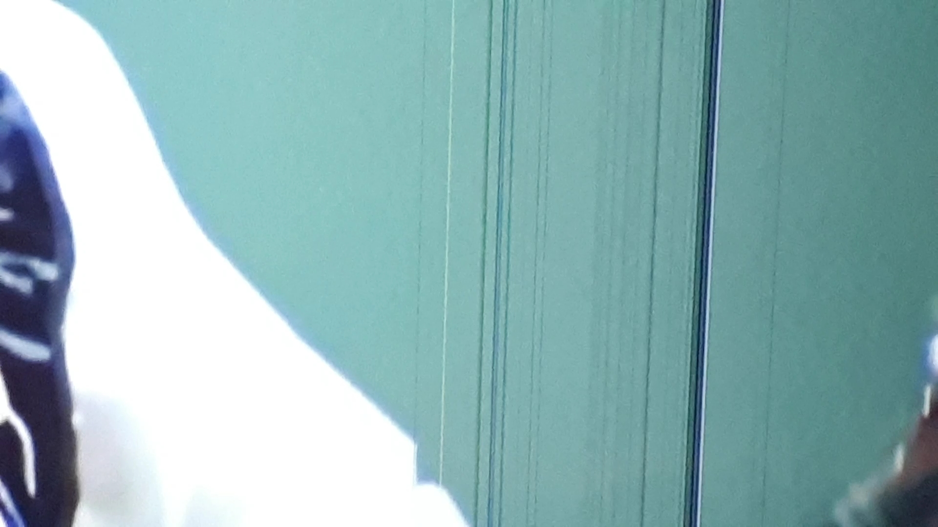

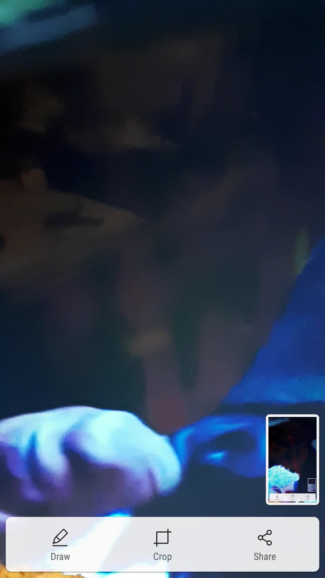

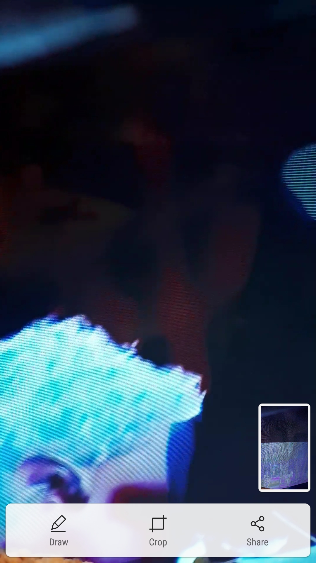

    This is my latest problem, I have a Hitachi 50HYT62U-K tv. I was informed off the previous owner that it had been squirted with water.
    I originally thought it was going to be a right off and I would be stripping it, but I've messaged around with it and I've had a good picture on it earlier.

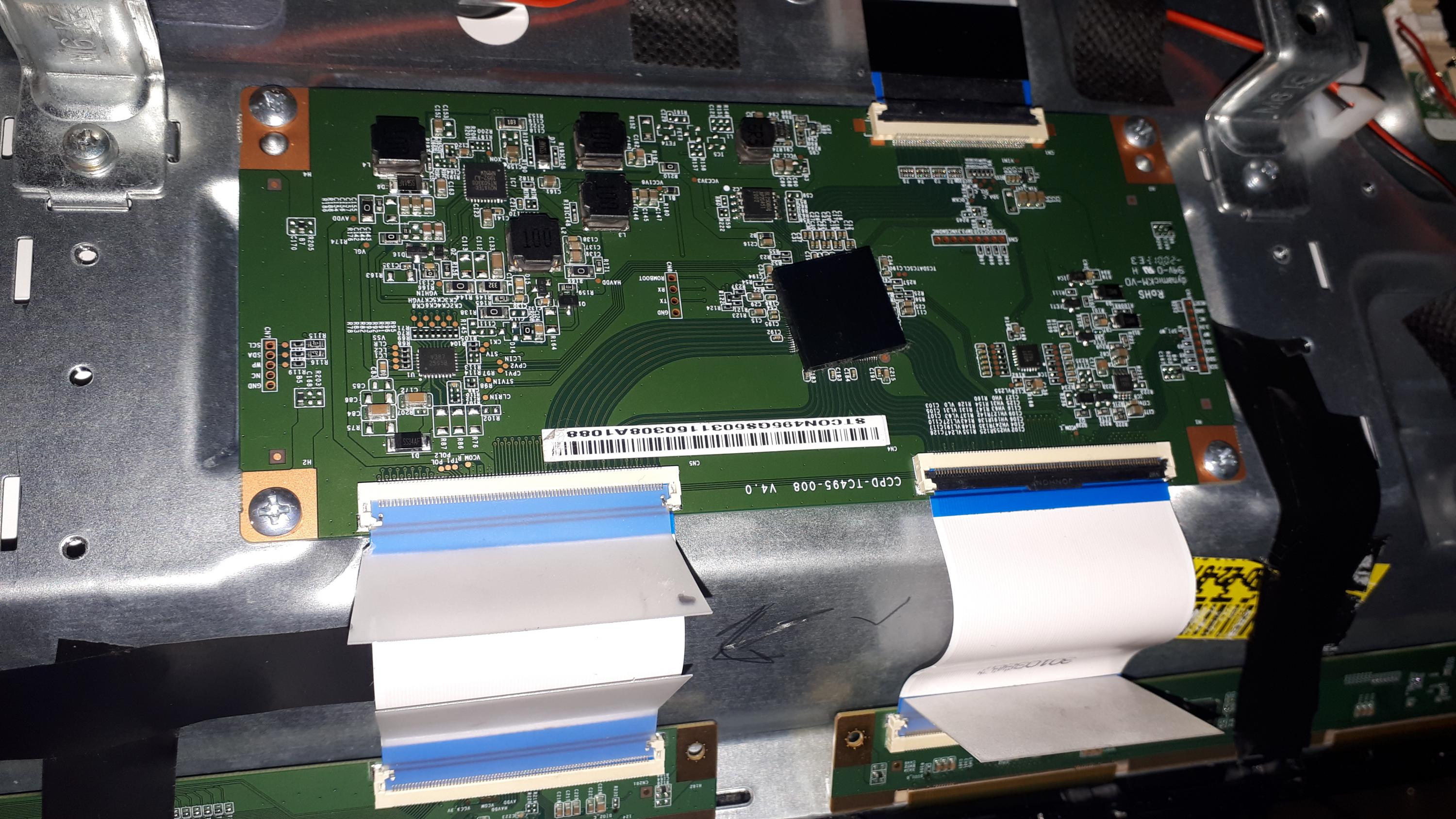

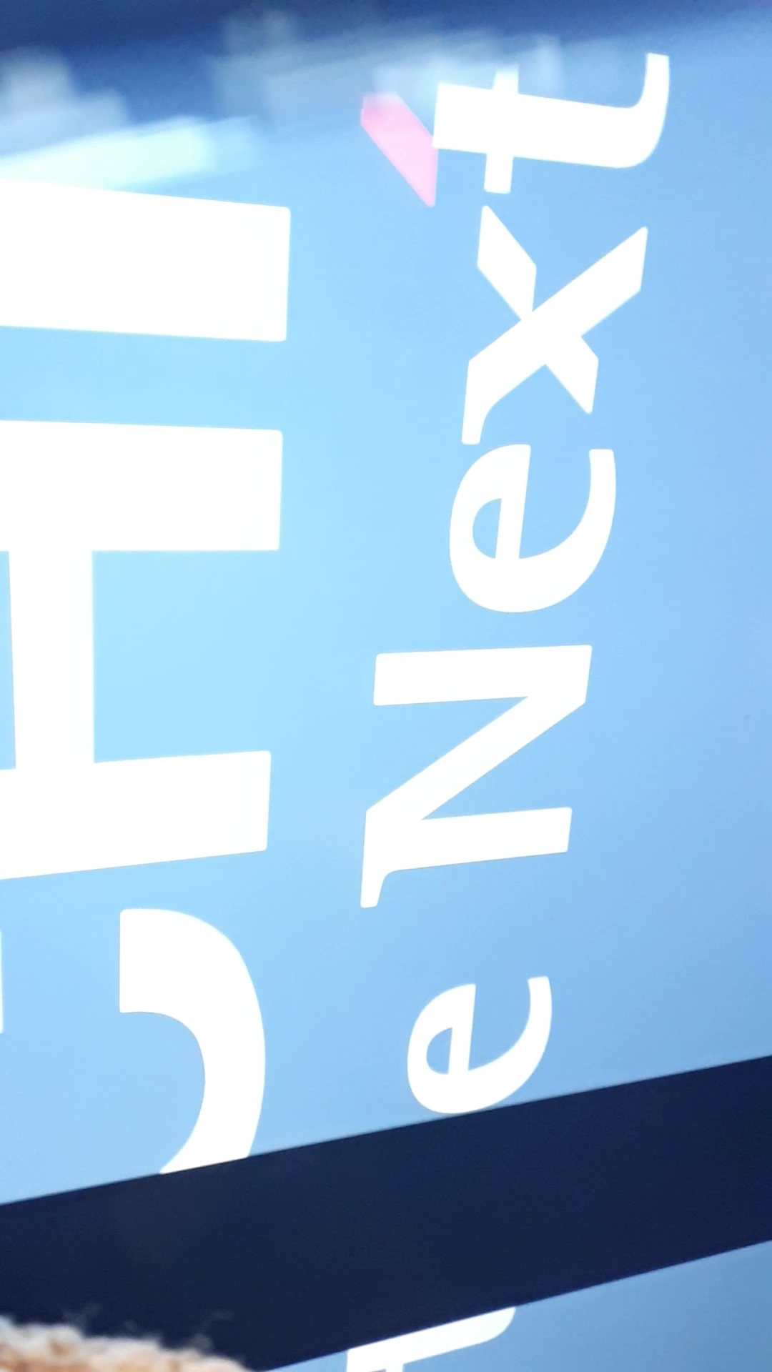

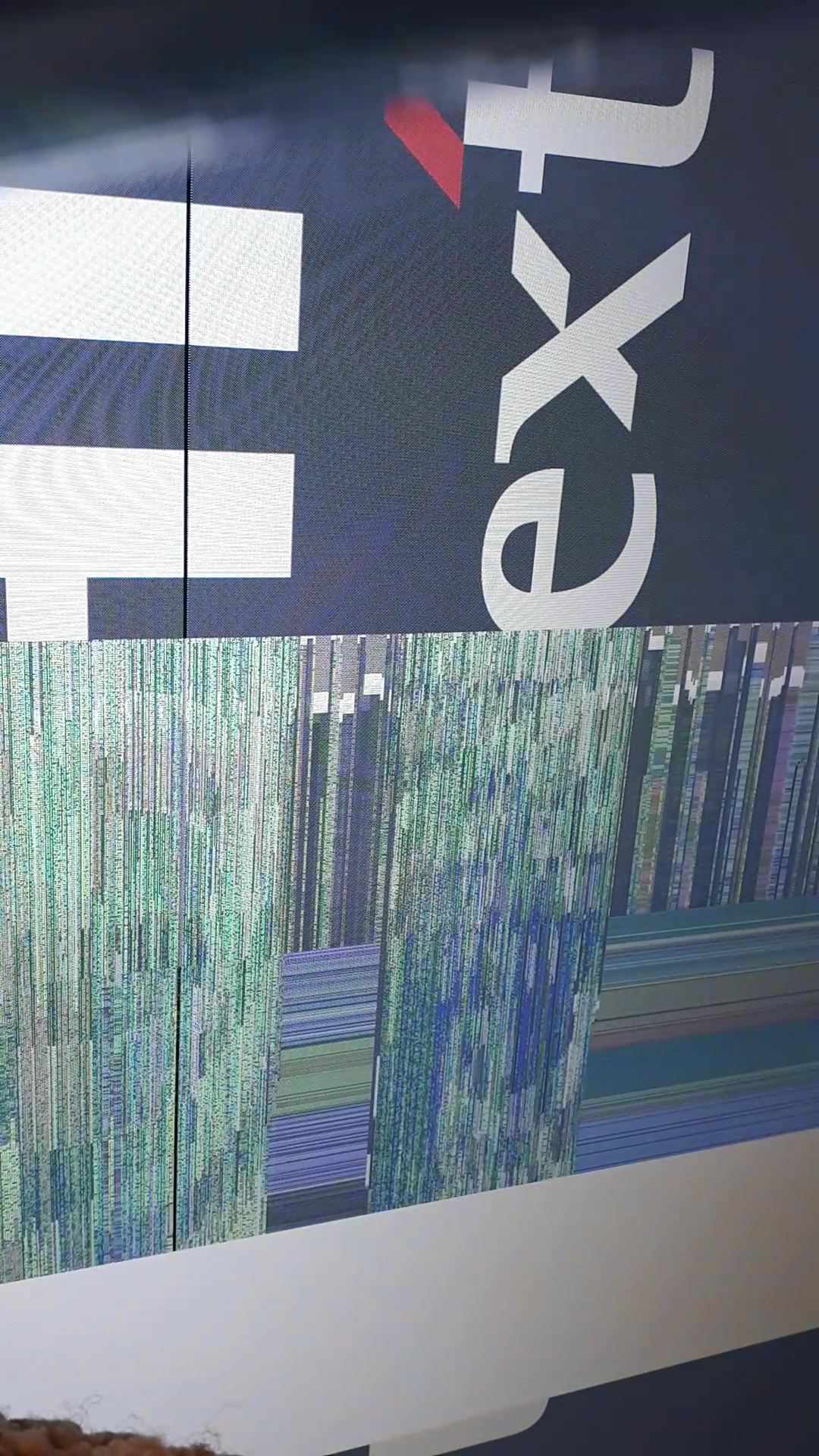

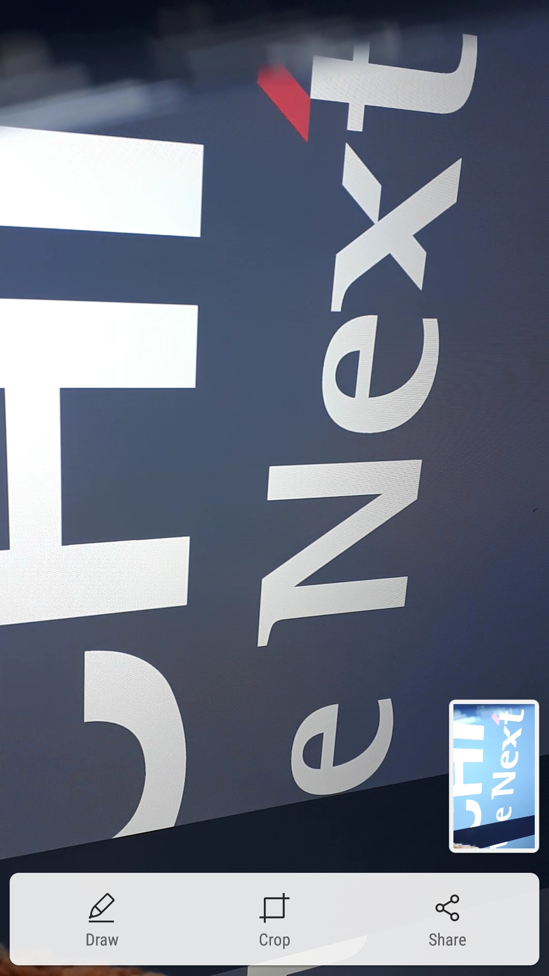

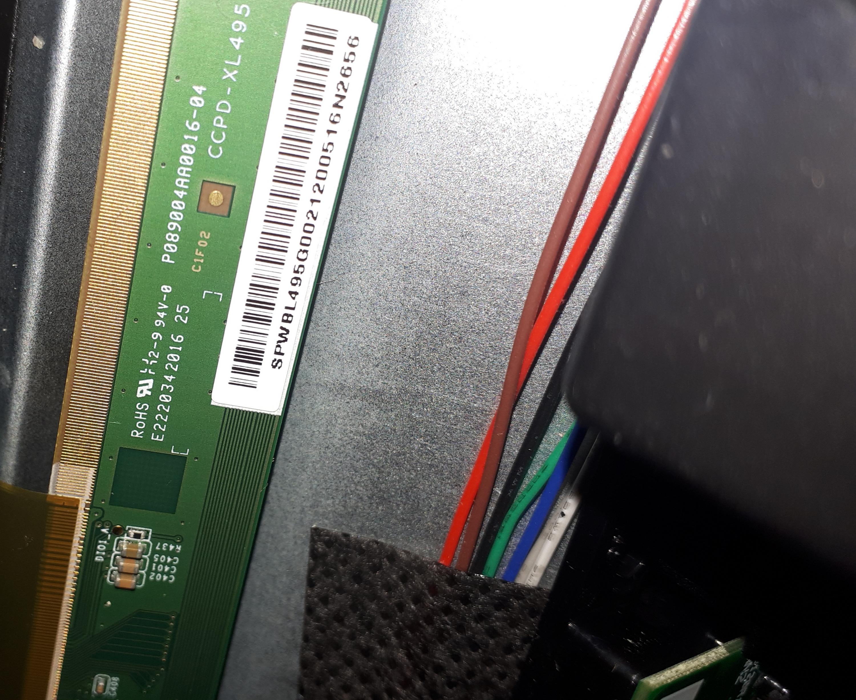

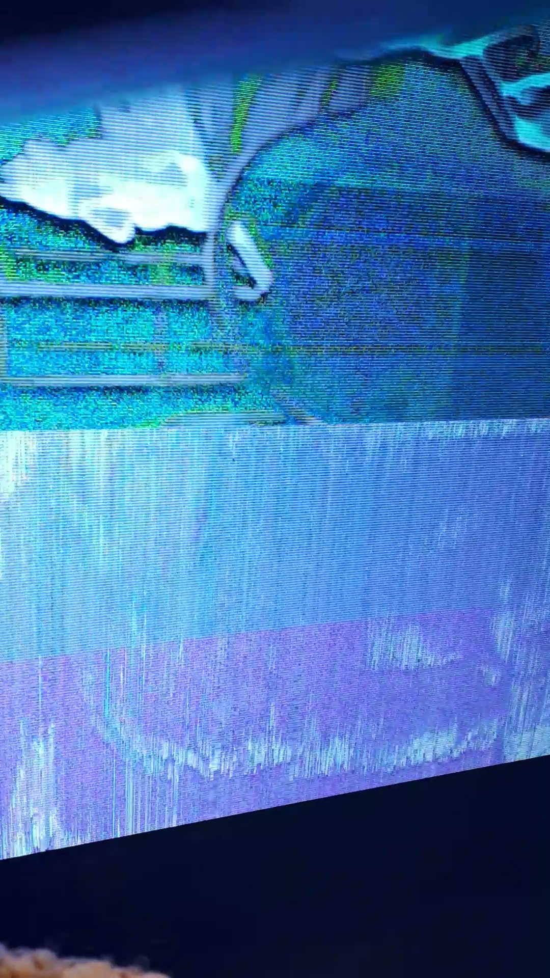

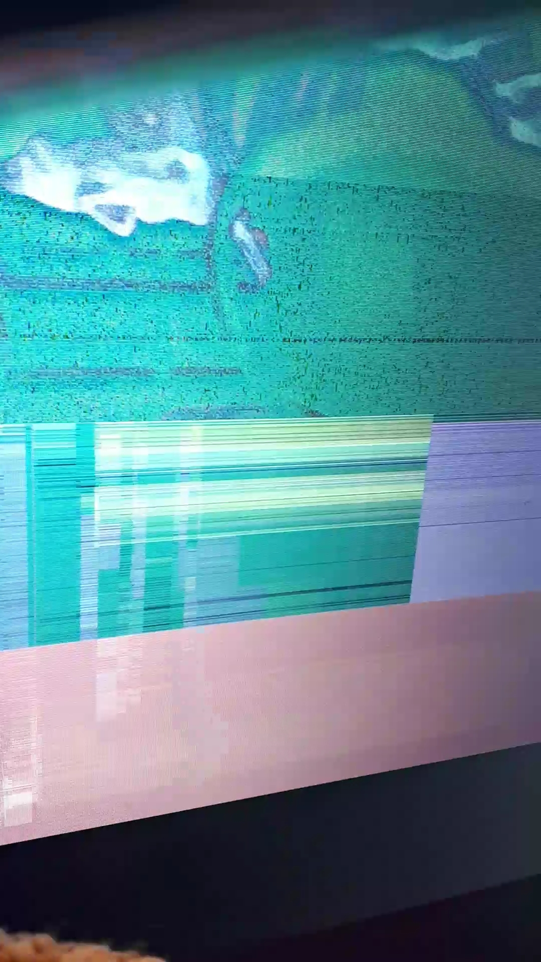

    I have got the problem down to either the tcon board, ribbon cable or driver/buffer board (Not sure what they are called) . I have messed around with it with hammer hands & I've managed to snap 3 of the clips that keep the ribbon cables in place on the tcon and driver boards so I've been using plastic strips to try keeping pressure on the cables , when I turn the tv on and rub along the ribbons I've had a split second of a good full screen picture. I will upload screenshots of the video I took while doing this. I would be really grateful for any help on this.
    Thanks for your time

    Guess the place to start would be a replacement tcon, a lot of times they're pretty reasonably priced.

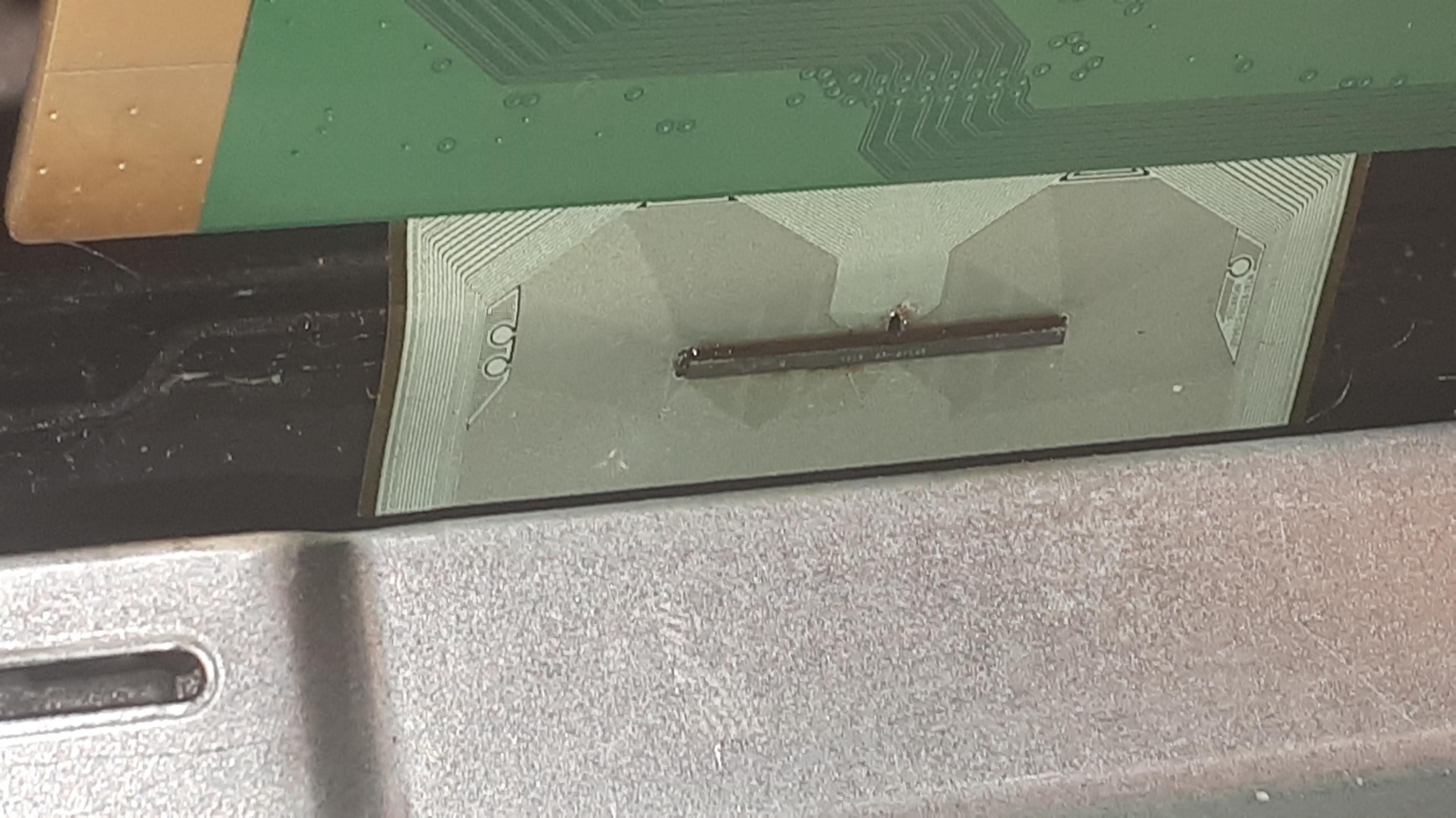

                I have found the problem (or probably caused this problem) ... The ic on one of the ribbons that feed the screen from the tcon board has burned out, melting a small hole in the ribbon, I definitely had a full screen picture on a couple of occasions when messing around with the driver board ribbons, but I'm sure I saw a brief smoke signal while doing this, now I know the screen is kaput unless there's a way of renewing the ribbon.

                    This may work if you're up for it. Example of cof bypass there, might need to find one that gives a better step by step process but there's a lot of such videos on youtube: https://www.youtube.com/watch?v=YacI7hWWKJw
